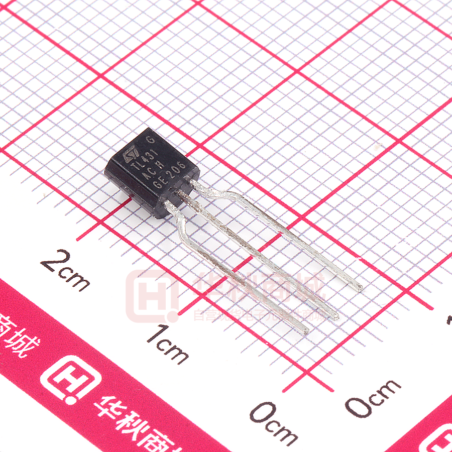

TL431 Programmable Voltage Reference ■ ■ ■ ■ Adjustable output voltage: 2.5 to 36V Sink current capability: 1 to 100mA Typical output impedance: 0.22Ω 1% and 2% voltage precision Z TO92 (Plastic Package) Description The TL431 is a programmable shunt voltage reference with guaranteed temperature stability over the entire temperature range of operation. The output voltage may be set to any value between 2.5V and 36V with two external resistors. The TL431 operates with a wide current range from 1 to 100mA with a typical dynamic impedance of 0.22Ω. D SO-8 (Plastic Micropackage) Order Codes Part Number TL431CD/CDT SO-8 TL431ACD/ACDT 0, +70°C TL431CZ/CZT/CZ-AP TO92 TL431ACZ/ACZT/ACZ-AP TL431ID/IDT SO-8 TL431AID/AIDT TL431IZ/IZT/IZ-AP -40, + 105°C TL431AIZ/AIZT/AIZ-AP TL431IYD/IYDT SO-8 (automotive grade level) TL431AIYD/AIYDT 431AIY TO92 TL431AI 431IY Tube or Tape & Reel 431AI TL431I TL431AC 431I TL431C 431AC Temperature Range Package Packing Marking 431C November 2005 Rev 2 1/13 www.st.com 13 Pin Diagrams TL431 1 Pin Diagrams Figure 1. TO92 pin connections (top view) Cathode Anode Reference 1 2 3 Figure 2. SO-8 pin connections (top view) 8 7 6 5 1 - Cathode 2 - Anode 3 - Anode 4 - N.C. 5 - N.C. 6 - Anode 7 - Anode 8 - Reference 1 2 3 4 2/13 TL431 Absolute Maximum Ratings 2 Absolute Maximum Ratings Table 1. Symbol VKA Ik Iref Pd Tstg Key parameters and their absolute maximum ratings Parameter Cathode to Anode Voltage Continuous Cathode Current Range Reference Input Current Range Power Dissipation (1) TO92 SO-8 batwing Storage Temperature Range 625 960 -65 to +150 mW Value 37 -100 to +150 -0.05 to +10 Unit V mA mA °C 1. Pd is calculated with Tamb = +25°C, Tj = +150°C and Rthja = 200°C/W for TO92 package Rthja = 130°C/W for SO-8 batwing package Table 2. Symbol VKA Ik Toper Operating conditions Parameter Cathode to Anode Voltage Cathode Current Operating Free-air Temperature Range TL431C/AC TL431I/AI 0 to +70 -40 to +105 °C Value Vref to 36 1 to 100 Unit V mA 3/13 Electrical Characteristics TL431 3 Table 3. Symbol Electrical Characteristics Tamb = 25°C (unless otherwise specified) TL431C Parameter Min. Reference Input Voltage Vref VKA = Vref , Ik = 10 mA, Tamb = 25°C Tmin ≤Tamb ≤ Tmax Reference Input Voltage Deviation Over Temperature ∆Vref Range (1) VKA = Vref, Ik = 10 mA, Tmin ≤Tamb ≤ Tmax ∆ Vref -----------∆ Vka TL431AC Unit Max. Min. Typ. Max. Typ. 2.44 2.495 2.55 2.47 2.495 2.52 2.423 2.567 2.453 2.537 V mV 3 17 3 15 Ratio of Change in Reference Input Voltage to Change in Cathode to Anode Voltage Ik = 10mA - ∆VKA = 10V to Vref ∆VKA = 36V to 10V Reference Input Current Ik = 10mA, R1 = 10k Ω, R2 = ∞ Tamb = 25°C Tmin ≤Tamb ≤Tmax Reference Input Current Deviation Over Temperature Range Ik = 10mA, R1 = 10kΩ, R2 =∞ Tmin ≤Tamb ≤ Tmax Minimum Cathode Current for Regulation VKA = Vref Off-State Cathode Current Dynamic Impedance (2) -1.4 -1 -2.7 -2 -1.4 -1 -2.7 -2 mV/V Iref 1.8 4 5.2 1.8 4 5.2 µA ∆Iref µA 0.4 1.2 0.4 1.2 mA nA Ω Imin Ioff ⏐ZKA⏐ 0.5 2.6 1 1000 0.5 2.6 0.6 1000 VKA = Vref , ∆ Ik = 1 to100mA, f ≤1kHZ 0.22 0.5 0.22 0.5 1. ∆Vref is defined as the difference between the maximum and minimum values obtained over the full temperature range. ∆Vref = Vref max. - Vref min. V ref max. V ref min. T1 T2 Temperature 2. The dynamic Impedance is definied as |ZKA| = ∆ VKA ---------------∆ IK 4/13 TL431 Table 4. Symbol Electrical Characteristics Tamb = 25°C (unless otherwise specified) TL431I Parameter Min. Reference Input Voltage Typ. Max. Min. Typ. Max. TL431AI Unit Vref VKA = V ref , Ik = 10 mA, T amb = 25°C Tmin ≤Tamb ≤ Tmax Reference Input Voltage Deviation Over Temperature Range (1) VKA = V ref , Ik =10 mA, Tmin ≤Tamb≤ Tmax Ratio of Change in Reference Input Voltage to Change in Cathode to Anode Voltage Ik = 10mA, ∆VKA = 10V to Vref ∆VKA = 36V to 10V Reference Input Current Ik = 10mA, R1 = 10kΩ, R2 = ∞ Tamb = 25°C Tmin ≤Tamb ≤Tmax Reference Input Current Deviation Over Temperature Range Ik = 10mA, R1 = 10k Ω, R2 =∞ Tmin ≤Tamb ≤ Tmax Minimum Cathode Current for Regulation VKA = V ref Off-State Cathode Current Dynamic Impedance (2) VKA = V ref , ∆ Ik = 1 to100mA, f ≤1kHZ 2.44 2.41 2.49 5 2.55 2.58 2.47 2.44 2.49 5 2.52 2.55 V ∆Vref mV 7 30 7 30 ∆ Vref -----------∆ Vka -1.4 -1 -2.7 -2 -1.4 -1 -2.7 -2 mV/V Iref 1.8 4 6.5 1.8 4 6.5 µA ∆Iref µA 0.8 2.5 0.8 1.2 mA nA Ω Imin Ioff ⏐ZKA⏐ 0.5 2.6 1 1000 0.5 2.6 0.7 1000 0.22 0.5 0.22 0.5 1. ∆Vref is defined as the difference between the maximum and minimum values obtained over the full temperature range. ∆Vref = Vref max. - Vref min. V ref max. V ref min. T1 T2 Temperature 2. The dynamic Impedance is definied as |ZKA| = ∆ VKA ---------------∆ IK 5/13 Electrical Characteristics Figure 3. Test circuit for VKA = VREF Figure 4. Input TL431 Test circuit for V KA = VREF R IK R1 IREF VKA Output Input R IK=10mA Output VKA VREF R2 VREF R1 VKA = VREF ( 1 + ------- ) + R1 x IREF R2 Figure 5. Test circuit for IOFF Figure 6. Test circuit for phase margin and voltage gain VKA=36V IOFF 10µF IK=10mA 10µF 15kΩ 8.25kΩ Output Input VREF Figure 7. Block diagram of TL1431 Figure 8. Test circuit for response time Cathode Vref + Vref Anode 1 mA 0 mA IK=1mA 6/13 Output TL431 Figure 9. Reference voltage vs. temp. Electrical Characteristics Figure 10. Reference voltage vs. cathode current 100 2.54 Cathode voltage VKA (V) Cathode current IKA (mA) 2.52 VKA = VREF IK = 10 mA 75 50 25 0 -25 -50 TAMB=+25°C 2.50 2.48 2.46 2.44 -40 -20 0 20 40 60 80 100 -1 0 1 2 3 Temperature (°C) Cathode voltage VKA (V) Figure 11. Reference voltage vs. cathode current Figure 12. Reference current vs. temp. 2 Reference current IREF (µA) 2.0 IK=10 mA R1=10kΩ R2= + ∝ Cathode current IKA (mA) 1 TAMB = +25°C 1.5 0 1.0 -1 0.5 -2 -1 0 1 Cathode voltage VKA (V) 2 3 0.0 − 40 − 20 0 20 40 60 80 100 Temperature °C Figure 13. Off-state cathode current vs. temp. Figure 14. Ratio of change in VREF to change in VKA vs. temp. 2.0 0.0 Off-state current IOFF (µA) 1.5 ∆VREF / ∆VKA (mV / V) VKA = 36 V VREF = 0 V -0.5 IK = 10 mA 1.0 -1.0 0.5 -1.5 0.0 -40 -20 0 20 40 60 80 100 -2.0 -40 -20 0 20 40 60 80 100 Temperature (°C) Temperature (°C) 7/13 Electrical Characteristics Figure 15. Static impedance RKA vs. temp. TL431 Figure 16. Maximum operating current vs. temp. 0.30 Minimum cathode current IMIN (mA) 0.6 Static impedance RKA (Ω) 0.28 VKA=VREF TAMB=+25°C 0.4 0.26 0.24 0.2 VKA = VREF 0.22 0.20 -40 -20 0 20 40 60 80 100 0.0 -40 -20 0 20 40 60 80 100 Temperature (°C) Temperature (°C) Figure 17. Gain & phase vs. frequency Figure 18. Stability behaviour with capacitive loads 60 Gain 40 IK=10 mA See figure 4 200 150 100 100 VKA=VREF Cathode current (mA) 80 VKA=5 V 60 VKA=12 V Instable Area Gain (dB) 20 Phase 50 Phase (°) 0 0 -50 -100 -20 -150 -40 1 10 100 Frequency (kHz) 1000 -200 10000 40 20 VKA=24 V 0 1E-10 1E-9 1E-8 1E-7 1E-6 1E-5 Capacitive load (Farad) Figure 19. Maximum power dissipation Figure 20. Pulse response for IK = 1mA 100 SO8 Batwing Input and Output voltage (V) 6 TAMB= +25°C Cathode current (mA) Input 80 4 Output 60 TO92 40 Safe Area VKA=VREF TAMB=+25°C 2 20 0 0 10 20 Cathode voltage (V) 30 0 2 4 Time (µs) 6 8 10 8/13 TL431 Package Mechanical Data 4 Package Mechanical Data In order to meet environmental requirements, ST offers these devices in ECOPACK® packages. These packages have a Lead-free second level interconnect. The category of second level interconnect is marked on the package and on the inner box label, in compliance with JEDEC Standard JESD97. The maximum ratings related to soldering conditions are also marked on the inner box label. ECOPACK is an ST trademark. ECOPACK specifications are available at: www.st.com. 4.1 SO-8 Package SO-8 MECHANICAL DATA DIM. A A1 A2 B C D E e H h L k ddd 0.1 5.80 0.25 0.40 mm. MIN. 1.35 0.10 1.10 0.33 0.19 4.80 3.80 1.27 6.20 0.50 1.27 8˚ (max.) 0.04 0.228 0.010 0.016 TYP MAX. 1.75 0.25 1.65 0.51 0.25 5.00 4.00 MIN. 0.053 0.04 0.043 0.013 0.007 0.189 0.150 0.050 0.244 0.020 0.050 inch TYP. MAX. 0.069 0.010 0.065 0.020 0.010 0.197 0.157 0016023/C 9/13 Package Mechanical Data TL431 4.2 TO92 (Tape & Reel) Package TO-92 MECHANICA DATA mm. DIM. MIN. A b D E e e1 L R S1 W 4.32 0.36 4.45 3.30 2.41 1.14 12.7 2.16 0.92 0.41 TYP MAX. 4.95 0.51 4.95 3.94 2.67 1.40 15.49 2.41 1.52 0.56 MIN. 170.1 14.2 175.2 129.9 94.9 44.9 500.0 85.0 36.2 16.1 TYP. MAX. 194.9 20.1 194.9 155.1 105.1 55.1 609.8 94.9 59.8 22.0 mils 0102782/C 10/13 TL431 Package Mechanical Data 4.3 TO92 (Tape Ammo Pack) Package A1 P P T H d A H1 H0 H I1 W0 D0 F1 F2 P2 P0 W2 W1 W L1 Millimeters Dim. Min Typ. Max. Min. Inches Typ. Max. AL A T d I1 P PO P2 F1/F2 ∆h ∆P 5.0 5.0 4.0 0.45 2.5 11.7 12.4 5.95 2.4 -1 -1 17.5 5.7 8.5 12.7 12.7 6.35 2.5 0 0 18.0 6 9 13.7 13 6.75 2.8 1 1 19.0 6.3 9.75 0.5 20 15.5 16 16.5 25 3.8 4.0 4.2 11 0.150 0.157 0.610 0.630 0.098 0.461 0.488 0.234 0.094 -0.039 -0.039 0.689 0.224 0.335 0.500 0.500 0.250 0.098 0 0 0.709 0.236 0.354 0.018 0.197 0.197 0.157 0.539 0.512 0.266 0.110 0.039 0.039 0.748 0.248 0.384 0.020 0.787 0.650 0.984 0.165 0.433 W W0 W1 W2 H H0 H1 DO L1 11/13 Package Mechanical Data TL431 4.4 TO92 (Bulk) Package Millimeters Dim. Min Typ. Max. Min. Inches Typ. Max. L B O1 C K O2 a 3.2 4.45 4.58 12.7 0.407 0.35 1.27 3.7 5.00 5.03 4.2 5.2 5.33 0.126 0.1752 0.1803 0.5 0.5 0.508 0.016 0.0138 0.05 0.1457 0.1969 0.198 0.1654 0.2047 0.2098 0.0197 0.02 12/13 TL431 Revision History 5 Revision History Date Revision Changes March 2002 Nov. 2005 1 2 Initial release. PPAP references inserted in the datasheet see Table : Order Codes on page 1 . Information furnished is believed to be accurate and reliable. However, STMicroelectronics assumes no responsibility for the consequences of use of such information nor for any infringement of patents or other rights of third parties which may result from its use. No license is granted by implication or otherwise under any patent or patent rights of STMicroelectronics. Specifications mentioned in this publication are subject to change without notice. This publication supersedes and replaces all information previously supplied. STMicroelectronics products are not authorized for use as critical components in life support devices or systems without express written approval of STMicroelectronics. The ST logo is a registered trademark of STMicroelectronics. All other names are the property of their respective owners © 2005 STMicroelectronics - All rights reserved STMicroelectronics group of companies Australia - Belgium - Brazil - Canada - China - Czech Republic - Finland - France - Germany - Hong Kong - India - Israel - Italy - Japan Malaysia - Malta - Morocco - Singapore - Spain - Sweden - Switzerland - United Kingdom - United States of America www.st.com 13/13
TL431ACZ-AP
物料型号: - TL431CD/CDT(0°C至+70°C,SO-8封装) - TL431ACD/ACDT(0°C至+70°C,SO-8封装) - TL431CZ/CZT/CZ-AP(0°C至+70°C,TO92封装) - TL431ACZ/ACZT/ACZ-AP(0°C至+70°C,TO92封装) - TL431I/ID/IZ/IY(-40°C至+105°C,SO-8封装) - TL431AI/AID/AIZ/AIY(-40°C至+105°C,SO-8封装)
器件简介: TL431是一款可编程分流电压基准源,具有保证在整个工作温度范围内的温度稳定性。通过两个外部电阻,输出电压可以设置在2.5V至36V之间的任何值。TL431在1至100mA的宽电流范围内工作,典型动态阻抗为0.22Ω。
引脚分配: - TO92封装:1脚阴极,2脚阳极,3脚阳极,4脚和5脚NC(无连接),6脚阳极,7脚阳极,8脚参考。 - SO-8封装:1脚阴极,2至7脚阳极,8脚参考。
参数特性: - 可调输出电压:2.5至36V - 沉电流能力:1至100mA - 典型输出阻抗:0.22Ω - 1%和2%的电压精度
功能详解: TL431的输出电压可以通过外部电阻编程设置,并且具有很好的温度稳定性。它还具有低动态阻抗和精确的电压精度。
应用信息: TL431广泛应用于需要精确电压参考的场合,如电源设计、传感器校准等。
封装信息: - SO-8封装:8引脚小外形封装。 - TO92封装:塑料封装,适用于通过型安装。
