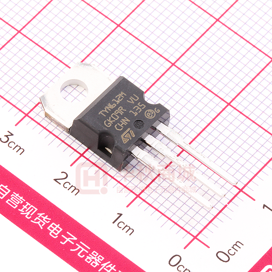

    可控硅 VRRM=600V IT(RMS)=12A TO220AB
TYN612MRG 数据手册
TYN612M 12 A SCR Main features Symbol IT(RMS) VDRM/VRRM IGT (min / max) Value 12 600 1.5 / 5 Unit A A G K A V mA K A G A K G Description The TYN612M SCR is suitable to fit modes of control found in applications such as voltage regulation circuits for motorbikes, overvoltage crowbar protection, motor control circuits in power tools and kitchen aids, inrush current limiting circuits, capacitive discharge ignition. The insulated fullpack package allows a back to back configuration. Table 1. Symbol IT(RMS) RMS on-state current (180° conduction angle) Average on-state current (180° conduction angle) Non repetitive surge peak on-state current I²t Value for fusing Critical rate of rise of on-state current IG = 2 x IGT , tr ≤ 100 ns Peak gate current Average gate power dissipation Storage junction temperature range Operating junction temperature range Maximum peak reverse gate voltage TO-220AB TYN612MRG TO-220FPAB TYN612MFP Order codes Part Numbers TYN612MRG TYN612MFP Marking TYN612M TYN612MFP Absolute ratings (limiting values) Parameter TO-220AB TO-220FPAB TO-220AB TO-220FPAB tp = 8.3 ms tp = 10 ms tp = 10 ms F = 60 Hz tp = 20 µs Tc = 105° C Tc = 70° C Tc = 105° C Tc = 70° C Tj = 25° C Tj = 25° C Tj = 125° C Tj = 125° C Tj = 125° C Value 12 A 12 8 A 8 125 A 120 72 50 4 1 - 40 to + 150 - 40 to + 125 5 A2S A/µs A W °C V Unit IT(AV) ITSM I²t dI/dt IGM PG(AV) Tstg Tj VRGM April 2007 Rev 4 1/8 www.st.com 8 Characteristics TYN612M 1 Table 2. Symbol IGT Characteristics Electrical characteristics (Tj = 25° C, unless otherwise specified) Test Conditions VD = 12 V RL = 140 Ω MIN. MAX. MIN. VGT VD = 12 V RL = 140 Ω TYP. MAX. VGD IH IL dV/dt VTM Vt0 Rd IDRM IRRM VD = VDRM IT = 500 mA IG = 1.2 IGT VD = 67 % VDRM ITM = 24 A Gate open Tj =125° C Tj = 25° C Tj = 125° C Tj = 125° C Tj = 25° C Tj = 125° C RL = 3.3 kΩ Gate open Tj = 125° C MIN. MAX. MAX. MIN. MAX. MAX. MAX. MAX. 2 mA Value 1.5 mA 5 0.5 0.7 1.3 0.2 20 40 50 1.6 0.85 30 5 V mA mA V/µs V V mΩ µA V Unit tp = 380 µs Threshold voltage Dynamic resistance VDRM = VRRM Table 3. Symbol Rth(j-c) Thermal resistance Parameter TO-220AB Junction to case (DC) TO-220FPAB TO-220AB Junction to ambient (DC) TO-220FPAB 55 4.5 55 ° C/W Value 1.3 ° C/W Unit Rth(j-a) Figure 1. Maximum average power dissipation versus average on-state current Figure 2. Average and D.C. on-state current versus case temperature (TO-220AB) D.C. P(W) 12 11 10 9 8 7 6 5 4 3 2 1 0 0 1 2 3 4 5 6 7 8 9 α = 180° IT(AV)(A) 14 13 12 11 10 9 8 7 6 5 4 3 2 α = 180° IT(AV)(A) 1 0 0 25 50 TC(°C) 75 100 125 2/8 TYN612M Characteristics Figure 3. Average and D.C. on-state current versus case temperature (TO-220FPAB) D.C. Figure 4. Relative variation of thermal impedance versus pulse duration (TO-220AB) IT(AV)(A) 14 13 12 11 10 9 8 7 6 5 4 3 2 1 0 0 25 50 75 100 125 α = 180° K=[Zth/Rth] 1.E+00 Rth(j-c) 1.E-01 Rth(j-a) TC(°C) 1.E-02 1.E-03 1.E-02 1.E-01 tp(s) 1.E+00 1.E+01 1.E+02 1.E+03 Figure 5. Relative variation of thermal impedance versus pulse duration (TO-220FPAB) Figure 6. Relative variation of gate trigger current, holding current, latching current and gate trigger voltage versus junction temperature (typical values) K=[Zth/Rth] 1.E+00 IGT, IH, IL, VGT [T j] / IGT, IH, IL, VGT [T j=25°C] 2.4 2.2 2.0 Rth(j-c) 1.8 1.6 1.4 IH & IL IGT 1.E-01 Rth(j-a) 1.2 1.0 0.8 0.6 0.4 0.2 0.0 1.E+01 1.E+02 1.E+03 VGT tp(s) 1.E-02 1.E-03 1.E-02 1.E-01 1.E+00 Tj(°C) -40 -30 -20 -10 0 10 20 30 40 50 60 70 80 90 100 110 120 130 Figure 7. Surge peak on-state current versus Figure 8. number of cycles Non-repetitive surge peak on-state current for a sinusoidal pulse with width tp < 10 ms, and corresponding values of I²t ITSM(A) 130 120 110 100 90 80 70 60 50 40 30 20 10 0 1 10 100 1000 Repetitive TC=105°C Non repetitive Tj initial=25°C t p=10m s ITSM(A), I2t (A2s) 1000 Tj initial=25°C ITSM O ne cycl e 100 I2t Number of cycles 10 0.01 0.10 tP(ms) 1.00 10.00 3/8 Ordering information scheme TYN612M Figure 9. ITM(A) 100.00 On-state characteristics (maximum values) Tj=125°C Tj max.: Vt0=0.85V Rd=0.030Ω 10.00 Tj=25°C 1.00 VTM(V) 0.10 0.0 0.5 1.0 1.5 2.0 2.5 3.0 3.5 4.0 4.5 5.0 2 Ordering information scheme TYN 6 12 M FP RG Standard SCR Voltage 6 = 600V Current 12 = 12A Sensitivity M = 5mA Package FP = TO-220FPAB Blank = TO-220AB Packing mode RG = Tube (TO-220AB) Blank = Tube (TO-220FPAB) 4/8 TYN612M Package information 3 Package information ● Epoxy meets UL94, V0 TO-220AB dimensions Dimensions Ref. Millimeters Min. A B ØI L F A I4 l3 a1 l2 c2 b2 C Table 4. Inches Min. Typ. Max. 0.625 0.147 Typ. Max. 15.20 3.75 13.00 10.00 0.61 1.23 4.40 0.49 2.40 2.40 6.20 3.75 15.90 0.598 a1 a2 B b1 b2 C c1 c2 14.00 0.511 10.40 0.393 0.88 0.024 1.32 0.048 4.60 0.173 0.70 0.019 2.72 0.094 2.70 0.094 6.60 0.244 3.85 0.147 0.551 0.409 0.034 0.051 0.181 0.027 0.107 0.106 0.259 0.151 a2 e F M b1 e c1 ØI I4 L l2 l3 M 15.80 16.40 16.80 0.622 0.646 0.661 2.65 1.14 1.14 2.60 2.95 0.104 1.70 0.044 1.70 0.044 0.102 0.116 0.066 0.066 5/8 Package information Table 5. TO-220FPAB Dimensions Dimensions Ref. Millimeters Min. A A H B TYN612M Inches Min. 0.173 0.098 0.098 0.018 0.030 0.045 0.045 0.195 0.094 0.393 Max. 0.181 0.106 0.108 0.027 0.039 0.067 0.067 0.205 0.106 0.409 Max. 4.6 2.7 2.75 0.70 1 1.70 1.70 5.20 2.7 10.4 4.4 2.5 2.5 0.45 0.75 1.15 1.15 4.95 2.4 10 B D E Dia L6 L2 L3 L5 F1 L4 F2 D L7 F F1 F2 G G1 H L2 E 16 Typ. 28.6 9.8 2.9 15.9 9.00 3.00 30.6 10.6 3.6 16.4 9.30 3.20 0.63 Typ. 1.126 0.386 0.114 0.626 0.354 0.118 1.205 0.417 0.142 0.646 0.366 0.126 F G1 G L3 L4 L5 L6 L7 Dia. In order to meet environmental requirements, ST offers these devices in ECOPACK® packages. These packages have a lead-free second level interconnect. The category of second level interconnect is marked on the inner box label, in compliance with JEDEC Standard JESD97. The maximum ratings related to soldering conditions are also marked on the inner box label. ECOPACK is an ST trademark. ECOPACK specifications are available at: www.st.com. 6/8 TYN612M Ordering information 4 Ordering information Ordering type TYN612MRG TYN612MFP Marking TYN612M TYN612MFP Package TO-220AB TO-220AB Weight 2.3 g 2.0 g Base qty Delivery mode 50 50 Tube Tube 5 Revision history Date Sep-2002 10-Fev-2005 11-Apr-2007 17-Apr-2007 Revision 1A 2 3 4 Last update. TO-220FPAB package added. Reformatted to current standards. Added typical and minimum values for VGT in Table 2. Added VGT curve in Figure 6. Description of Changes 7/8 TYN612M Please Read Carefully: Information in this document is provided solely in connection with ST products. STMicroelectronics NV and its subsidiaries (“ST”) reserve the right to make changes, corrections, modifications or improvements, to this document, and the products and services described herein at any time, without notice. All ST products are sold pursuant to ST’s terms and conditions of sale. Purchasers are solely responsible for the choice, selection and use of the ST products and services described herein, and ST assumes no liability whatsoever relating to the choice, selection or use of the ST products and services described herein. No license, express or implied, by estoppel or otherwise, to any intellectual property rights is granted under this document. If any part of this document refers to any third party products or services it shall not be deemed a license grant by ST for the use of such third party products or services, or any intellectual property contained therein or considered as a warranty covering the use in any manner whatsoever of such third party products or services or any intellectual property contained therein. UNLESS OTHERWISE SET FORTH IN ST’S TERMS AND CONDITIONS OF SALE ST DISCLAIMS ANY EXPRESS OR IMPLIED WARRANTY WITH RESPECT TO THE USE AND/OR SALE OF ST PRODUCTS INCLUDING WITHOUT LIMITATION IMPLIED WARRANTIES OF MERCHANTABILITY, FITNESS FOR A PARTICULAR PURPOSE (AND THEIR EQUIVALENTS UNDER THE LAWS OF ANY JURISDICTION), OR INFRINGEMENT OF ANY PATENT, COPYRIGHT OR OTHER INTELLECTUAL PROPERTY RIGHT. UNLESS EXPRESSLY APPROVED IN WRITING BY AN AUTHORIZED ST REPRESENTATIVE, ST PRODUCTS ARE NOT RECOMMENDED, AUTHORIZED OR WARRANTED FOR USE IN MILITARY, AIR CRAFT, SPACE, LIFE SAVING, OR LIFE SUSTAINING APPLICATIONS, NOR IN PRODUCTS OR SYSTEMS WHERE FAILURE OR MALFUNCTION MAY RESULT IN PERSONAL INJURY, DEATH, OR SEVERE PROPERTY OR ENVIRONMENTAL DAMAGE. ST PRODUCTS WHICH ARE NOT SPECIFIED AS "AUTOMOTIVE GRADE" MAY ONLY BE USED IN AUTOMOTIVE APPLICATIONS AT USER’S OWN RISK. Resale of ST products with provisions different from the statements and/or technical features set forth in this document shall immediately void any warranty granted by ST for the ST product or service described herein and shall not create or extend in any manner whatsoever, any liability of ST. ST and the ST logo are trademarks or registered trademarks of ST in various countries. Information in this document supersedes and replaces all information previously supplied. The ST logo is a registered trademark of STMicroelectronics. All other names are the property of their respective owners. © 2007 STMicroelectronics - All rights reserved STMicroelectronics group of companies Australia - Belgium - Brazil - Canada - China - Czech Republic - Finland - France - Germany - Hong Kong - India - Israel - Italy - Japan Malaysia - Malta - Morocco - Singapore - Spain - Sweden - Switzerland - United Kingdom - United States of America www.st.com 8/8
