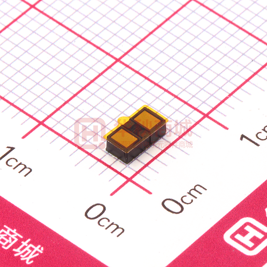

VL53L1X A new generation, long distance ranging Time-of-Flight sensor based on ST’s FlightSense™ technology Datasheet - production data Applications • • • • • Features • • Fully integrated miniature module – Size: 4.9x2.5x1.56 mm – Emitter: 940 nm invisible laser (Class1) – SPAD (single photon avalanche diode) receiving array with integrated lens – Low-power microcontroller running advanced digital firmware • Pin-to-pin compatible with the VL53L0X FlightSense™ ranging sensor • Fast and accurate long distance ranging – Up to 400 cm distance measurement – Up to 50 Hz ranging frequency • Typical full field-of-view (FoV): 27 ° • Programmable region-of-interest (ROI) size on the receiving array, allowing the sensor FoV to be reduced • Programmable ROI position on the receiving array, providing multizone operation control from the host • Easy integration – Single reflowable component – Can be hidden behind many cover window materials – Software driver and code examples for turnkey ranging – Single power supply (2v8) – I²C interface (up to 1 MHz) – Shutdown and interrupt pins February 2018 This is information on a product in full production. • • User detection (Autonomous low-power mode) to power on/off and lock/unlock devices like personal computers/laptops and the IoT Service robots and vacuum cleaners (long distance and fast obstacle detection) Drones (landing assistance, hovering, ceiling detection) Smart shelves and vending machines (goods inventory monitoring) Sanitary (robust user detection whatever the target reflectance) Smart building and smart lighting (people detection, gesture control) 1 D gesture recognition Laser assisted autofocus which enhances the camera autofocus system speed and robustness, especially in difficult scenes (low light and low contrast) and video focus tracking assistance Description The VL53L1X is a state-of-the-art, Time-of-Flight (ToF), laser-ranging sensor, enhancing the ST FlightSense™ product family. It is the fastest miniature ToF sensor on the market with accurate ranging up to 4 m and fast ranging frequency up to 50 Hz Housed in a miniature and reflowable package, it integrates a SPAD receiving array, a 940 nm invisible Class1 laser emitter, physical infrared filters, and optics to achieve the best ranging performance in various ambient lighting conditions with a range of cover window options. Unlike conventional IR sensors, the VL53L1X uses ST’s latest generation ToF technology which allows absolute distance measurement whatever the target color and reflectance. It is also possible to program the size of the ROI on the receiving array, allowing the sensor FoV to be reduced. DocID031281 Rev 2 1/35 www.st.com Contents VL53L1X Contents 1 2 Product overview . . . . . . . . . . . . . . . . . . . . . . . . . . . . . . . . . . . . . . . . . . . 4 1.1 Technical specification . . . . . . . . . . . . . . . . . . . . . . . . . . . . . . . . . . . . . . . . 4 1.2 System block diagram . . . . . . . . . . . . . . . . . . . . . . . . . . . . . . . . . . . . . . . . 4 1.3 Device pinout . . . . . . . . . . . . . . . . . . . . . . . . . . . . . . . . . . . . . . . . . . . . . . . 5 1.4 Application schematic . . . . . . . . . . . . . . . . . . . . . . . . . . . . . . . . . . . . . . . . . 6 Functional description . . . . . . . . . . . . . . . . . . . . . . . . . . . . . . . . . . . . . . . 7 2.1 System functional description . . . . . . . . . . . . . . . . . . . . . . . . . . . . . . . . . . . 7 2.2 System state machine description . . . . . . . . . . . . . . . . . . . . . . . . . . . . . . . 8 2.3 Customer manufacturing calibration flow . . . . . . . . . . . . . . . . . . . . . . . . . . 9 2.4 Ranging description . . . . . . . . . . . . . . . . . . . . . . . . . . . . . . . . . . . . . . . . . . 9 2.5 Key parameters . . . . . . . . . . . . . . . . . . . . . . . . . . . . . . . . . . . . . . . . . . . . 10 2.6 2.5.1 Distance mode . . . . . . . . . . . . . . . . . . . . . . . . . . . . . . . . . . . . . . . . . . . . 10 2.5.2 Timing budget (TB) . . . . . . . . . . . . . . . . . . . . . . . . . . . . . . . . . . . . . . . . 11 Power sequence . . . . . . . . . . . . . . . . . . . . . . . . . . . . . . . . . . . . . . . . . . . . 12 2.6.1 3 2.7 Ranging sequences . . . . . . . . . . . . . . . . . . . . . . . . . . . . . . . . . . . . . . . . . 13 2.8 Sensing array optical center . . . . . . . . . . . . . . . . . . . . . . . . . . . . . . . . . . . 14 Ranging performances . . . . . . . . . . . . . . . . . . . . . . . . . . . . . . . . . . . . . . 15 3.1 Test conditions . . . . . . . . . . . . . . . . . . . . . . . . . . . . . . . . . . . . . . . . . . . . . 15 3.2 Accuracy, repeatability, and ranging error definitions . . . . . . . . . . . . . . . . 16 3.2.1 Accuracy definition . . . . . . . . . . . . . . . . . . . . . . . . . . . . . . . . . . . . . . . . . 16 3.2.2 Repeatability definition . . . . . . . . . . . . . . . . . . . . . . . . . . . . . . . . . . . . . . 16 3.2.3 Ranging error definition . . . . . . . . . . . . . . . . . . . . . . . . . . . . . . . . . . . . . 16 3.3 Minimum ranging distance . . . . . . . . . . . . . . . . . . . . . . . . . . . . . . . . . . . . 16 3.4 Performances in dark conditions . . . . . . . . . . . . . . . . . . . . . . . . . . . . . . . 16 3.5 Performances in ambient light conditions . . . . . . . . . . . . . . . . . . . . . . . . . 17 3.6 2/35 Power up and boot sequence . . . . . . . . . . . . . . . . . . . . . . . . . . . . . . . . 12 3.5.1 Long distance mode . . . . . . . . . . . . . . . . . . . . . . . . . . . . . . . . . . . . . . . 17 3.5.2 Short distance mode . . . . . . . . . . . . . . . . . . . . . . . . . . . . . . . . . . . . . . . 17 Performances in partial ROI in dark conditions . . . . . . . . . . . . . . . . . . . . 18 DocID031281 Rev 2 VL53L1X 4 5 Contents Control interface . . . . . . . . . . . . . . . . . . . . . . . . . . . . . . . . . . . . . . . . . . . 19 4.1 I2C interface - timing characteristics . . . . . . . . . . . . . . . . . . . . . . . . . . . . . 21 4.2 I2C interface - reference registers . . . . . . . . . . . . . . . . . . . . . . . . . . . . . . 22 Electrical characteristics . . . . . . . . . . . . . . . . . . . . . . . . . . . . . . . . . . . . 23 5.1 Absolute maximum ratings . . . . . . . . . . . . . . . . . . . . . . . . . . . . . . . . . . . . 23 5.2 Recommended operating conditions . . . . . . . . . . . . . . . . . . . . . . . . . . . . 23 5.3 ESD . . . . . . . . . . . . . . . . . . . . . . . . . . . . . . . . . . . . . . . . . . . . . . . . . . . . . 23 5.4 Current consumption . . . . . . . . . . . . . . . . . . . . . . . . . . . . . . . . . . . . . . . . 24 5.5 Digital I/O electrical characteristics . . . . . . . . . . . . . . . . . . . . . . . . . . . . . 24 6 Outline drawing . . . . . . . . . . . . . . . . . . . . . . . . . . . . . . . . . . . . . . . . . . . . 25 7 Laser safety considerations . . . . . . . . . . . . . . . . . . . . . . . . . . . . . . . . . . 28 8 Packaging and labeling . . . . . . . . . . . . . . . . . . . . . . . . . . . . . . . . . . . . . 29 8.1 Product marking . . . . . . . . . . . . . . . . . . . . . . . . . . . . . . . . . . . . . . . . . . . . 29 8.2 Inner box labeling . . . . . . . . . . . . . . . . . . . . . . . . . . . . . . . . . . . . . . . . . . . 29 8.3 Packing . . . . . . . . . . . . . . . . . . . . . . . . . . . . . . . . . . . . . . . . . . . . . . . . . . 29 8.4 Tape outline drawing . . . . . . . . . . . . . . . . . . . . . . . . . . . . . . . . . . . . . . . . 30 8.5 Pb-free solder reflow process . . . . . . . . . . . . . . . . . . . . . . . . . . . . . . . . . . 31 8.6 Handling and storage precautions . . . . . . . . . . . . . . . . . . . . . . . . . . . . . . 32 8.7 8.6.1 Shock precaution . . . . . . . . . . . . . . . . . . . . . . . . . . . . . . . . . . . . . . . . . . 32 8.6.2 Part handling . . . . . . . . . . . . . . . . . . . . . . . . . . . . . . . . . . . . . . . . . . . . . 32 8.6.3 Compression force . . . . . . . . . . . . . . . . . . . . . . . . . . . . . . . . . . . . . . . . . 32 8.6.4 Moisture sensitivity level . . . . . . . . . . . . . . . . . . . . . . . . . . . . . . . . . . . . 32 Storage temperature conditions . . . . . . . . . . . . . . . . . . . . . . . . . . . . . . . . 32 9 Ordering information . . . . . . . . . . . . . . . . . . . . . . . . . . . . . . . . . . . . . . . 33 10 Acronyms and abbreviations . . . . . . . . . . . . . . . . . . . . . . . . . . . . . . . . . 33 11 ECOPACK® . . . . . . . . . . . . . . . . . . . . . . . . . . . . . . . . . . . . . . . . . . . . . . . . 33 12 Revision history . . . . . . . . . . . . . . . . . . . . . . . . . . . . . . . . . . . . . . . . . . . 34 DocID031281 Rev 2 3/35 35 Product overview VL53L1X 1 Product overview 1.1 Technical specification Table 1. Technical specification Feature 1.2 Detail Package Optical LGA12 Size 4.9 x 2.5 x 1.56 mm Operating voltage 2.6 to 3.5 V Operating temperature: -20 to 85 °C Receiver Field Of View (diagonal FOV) Programmable from 15 to 27 degrees Infrared emitter 940 nm I2C Up to 400 kHz (Fast mode) serial bus Programmable address. Default is 0x52. System block diagram Figure 1. VL53L1X block diagram 9//;PRGXOH 9//;VLOLFRQ *1' 6'$ 6LQJOH3KRWRQ $YDODQFKH'LRGH 63$' 'HWHFWLRQDUUD\ 1RQ9RODWLOH 0HPRU\ 520 $9'' ;6+87 5$0 6&/ *3,2 0LFURFRQWUROOHU $GYDQFHG 5DQJLQJ&RUH 9&6(/'ULYHU $9669&6(/ ,5 ,5 QP 4/35 DocID031281 Rev 2 $9''9&6(/ VL53L1X 1.3 Product overview Device pinout Figure 2 shows the pinout of the VL53L1X (see also Figure 18). Figure 2. VL53L1X pinout (bottom view) *1' *3,2  '1&   ;6+87   *1' 6'$   *1' 6&/   $9669&6(/ $9''   $9''9&6(/  *1' Table 2. VL53L1X pin description Note: Pin number Signal name Signal type Signal description 1 AVDDVCSEL Supply VCSEL supply, to be connected to main supply 2 AVSSVCSEL Ground VCSEL ground, to be connected to main ground 3 GND Ground To be connected to main ground 4 GND2 Ground To be connected to main ground 5 XSHUT Digital input 6 GND3 Ground 7 GPIO1 Digital output 8 DNC Digital input Do not connect, must be left floating 9 SDA Digital input/output I2C serial data 10 SCL Digital input I2C serial clock input 11 AVDD Supply Supply, to be connected to main supply 12 GND4 Ground To be connected to main ground Xshutdown pin, active low To be connected to main ground Interrupt output. Open drain output AVSSVCSEL and GND are ground pins and can be connected together in the application schematics. GND2, GND3, and GND4 are standard pins that we force to the ground domain in the application schematics to avoid possible instabilities if set to other states. DocID031281 Rev 2 5/35 35 Product overview 1.4 VL53L1X Application schematic Figure 3 shows the application schematic of the VL53L1X. Figure 3. VL53L1X schematic ,29'' $9''   +267    ;6+87 $9''9&6(/ *3,2 $9'' 6'$ $9669&6(/ 6&/ *1' '1& *1' *1' 9//; *1'    Q)  &DSDFLWRUVDV FORVHDV —) SRVVLEOHWR 9//;    Note: Capacitors on external supply AVDD should be placed as close as possible to the AVDDVCSEL and AVSSVCSEL module pins. Note: External pull up resistor values can be found in I2C-bus specification. Pull ups are typically fitted only once per bus, near the host. For suggested values see Table 3. Note: XSHUT pin must always be driven to avoid leakage current. A pull up is needed if the host state is not known. XSHUT is needed to use HW standby mode (no I2C communication). Note: XSHUT and GPIO1 pull up recommended values are 10 kOhms Note: GPIO1 to be left unconnected if not used Table 3 show recommended values for the pull up and series resistors for an AVDD of 1.8 V to 2.8 V in I2C Fast mode (up to 400 kHz). Table 3. Suggested pull up and series resistors for I2C Fast mode I2C load capacitance (CL) (1) Pull up resistor (Ohms) CL ≤ 90 pF 3.6 k 90 pF < CL ≤ 140 pF 2.4 k 140 pF < CL ≤ 270 pF 1.2 k 270 pF < CL ≤ 400 pF 0.8 k 1. For each bus line, CL is measured in the application PCB by the customer. 6/35 DocID031281 Rev 2 VL53L1X Functional description 2 Functional description 2.1 System functional description Figure 4 shows the system level functional description. The host customer application controls the VL53L1X device using an API (application programming interface). The API implementation is delivered to the customer as a driver (Bare C code). The driver shares with the customer application a set of high-level functions that allow control of the VL53L1X like initialization, ranging start/stop, and setting the system accuracy. The driver enables fast development of end user applications without the complication of direct multiple register access. The driver is structured in a way that it can be compiled on any kind of platform through a good hardware abstraction layer. A detailed description of the driver is available in the VL53L1X API user manual (UM2356). Figure 4. VL53L1X system functional description +267 8VHU $SSOLFDWLRQ 9//; GULYHU 9//; ,& DocID031281 Rev 2 7/35 35 Functional description 2.2 VL53L1X System state machine description Figure 5 shows the system state machine. Figure 5. System state machine 8/35 DocID031281 Rev 2 VL53L1X 2.3 Functional description Customer manufacturing calibration flow The VL53L1X driver includes calibration functions. To benefit from device full performances, it is recommended they be run once at the customer production line. Device calibration allows part-to-part parameter variations and cover glass presence that may affect device performances to be compensated. Calibration data stored in the host have to be loaded into the VL53L1X at each startup using a dedicated driver function. Three calibration steps are needed: RefSPAD, offset and crosstalk. RefSPAD and crosstalk calibrations have to be performed whenever the customer adds a protective cover glass on top of the VL53L1X module. Offset calibration has to be performed in all situations. It allows reflow and cover glass effects to be compensated. The detailed procedure is provided in the VL53L1X API user manual (UM2356). 2.4 Ranging description The VL53L1X software driver proposes turnkey solution to allow fast implementation and easy ranging in all customer applications: Autonomous ranging mode is the default configuration that offers the optimized VL53L1X functionalities. • Ranging is continuous, with a programmable delay between two ranging operations (called an inter-measurement period). Ranging duration (timing budget) is also programmable. • The user can set distance thresholds (below, above, inside, or outside the user-defined thresholds). An interrupt is raised only when threshold conditions are met. • ROI size and position are programmable: the user may chose a custom FoV from 4x4 SPADs (minimum size) up to 16x16 SPADs (full FoV). • A clear interrupt is mandatory to allow the next ranging data to be updated. If the ranging distance cannot be measured (in the case of no target or a weak signal), a corresponding range status is generated and can be read by the host. The VL53L1X software driver provides turnkey functions to read output results after the measurement. The main values reported are: • Ranging distance in mm • Return signal rate • Ambient signal rate • Range status Range status and output measurement definitions are provided in the VL53L1X API user manual (UM2356). DocID031281 Rev 2 9/35 35 Functional description VL53L1X 2.5 Key parameters 2.5.1 Distance mode The VL53L1X has three distance modes (DM): short, medium, and long. Long distance mode allows the longest possible ranging distance of 4 m to be reached. However, this maximum ranging distance is impacted by ambient light. Short distance mode is more immune to ambient light, but its maximum ranging distance is typically limited to 1.3 m. Table 4. Maximum distance vs. Distance mode under ambient light Distance mode Max. distance in dark (cm) Max. distance under strong ambient light (cm) Short 136 135 Medium 290 76 Long 360 73 Test conditions: timing budget = 100 ms, white target 88 %, dark = no IR ambient, ambient light = 200 kcps/SPAD. 10/35 DocID031281 Rev 2 VL53L1X 2.5.2 Functional description Timing budget (TB) The VL53L1X timing budget can be set from 20 ms up to 1000 ms. • 20 ms is the minimum timing budget and can be used only in Short distance mode. • 33 ms is the minimum timing budget which can work for all distance modes. • 140 ms is the timing budget which allows the maximum distance of 4 m (in the dark on a white chart) to be reached under Long distance mode Increasing the timing budget increases the maximum distance the device can range and improves the repeatability error. However, average power consumption augments accordingly. Figure 6. Maximum distance and repeatability error vs. timing budget Test conditions: timing budget = 33 ms, 140 ms, 200 ms, grey target 54 %, ambient light = dark. DocID031281 Rev 2 11/35 35 Functional description VL53L1X 2.6 Power sequence 2.6.1 Power up and boot sequence There are two options available for device power up/boot. Option 1: the XSHUT pin is connected and controlled from the host. This option optimizes power consumption as the VL53L1X can be completely powered off when not used, and then woken up through a host GPIO (using the XSHUT pin). Hardware (HW) standby mode is defined as the period when the power supply is present and XSHUT is low. Figure 7. Power up and boot sequence 3RZHU6XSSO\ ;6KXW 6\VWHP6WDWH Note: 3RZHU2II +:6WDQGE\ %RRW 6:6WDQGE\ Boot duration is 1.2ms max. Option 2: the XSHUT pin is not controlled by the host, it is tied to the power supply value through the pull up resistor. When the XSHUT pin is not controlled, the power up sequence is presented in Figure 8. In this case, the device goes automatically to Software (SW) standby after boot, without entering HW standby. Figure 8. Power up and boot sequence with XSHUT not controlled 3RZHU6XSSO\ ;6KXW 6\VWHP6WDWH 3RZHU2II %RRW 6:6WDQGE\ Note: Boot duration is 1.2 ms max. Note: In all cases, XSHUT has to be raised only when the power supply is tied on. 12/35 DocID031281 Rev 2 VL53L1X 2.7 Functional description Ranging sequences The following figure shows the combination of the driver commands and the system states. Figure 9. Autonomous sequence 3RZHU6XSSO\ ;6KXW *3,2 ,QWHUUXSW 'ULYHU&RPPDQG 6\VWHP6WDWH 6WDUW 5DQJLQJ 6:6WDQGE\ *HW 5DQJ ,QLW 5DQJLQJ 5DQJLQJ *HW 5DQJ &OHDU ,QW ,QWHU0HDVXUHPHQW 7LPLQJ%XGJHW 5DQJLQJ 5DQJLQJ 6WRS 5DQJ ,QWHU0HDVXUHPHQW 6:6WDQGE\ 7LPLQJ%XGJHW ,QWHU0HDVXUHPHQW3HULRG Note: Timing budget and inter measurement timings are the parameters set by the user, using a dedicated driver function. DocID031281 Rev 2 13/35 35 Functional description 2.8 VL53L1X Sensing array optical center VL53L1X module includes a lens that focus the photons on the 16x16 SPADs sensing array. The sensing array optical center specification takes into account the part-to-part variation in production. The optical center is defined by coordinates (Xo and Yo). The optical center is measured for each part during a factory test at STMicroelectronics. The coordinates are stored in the VL53L1X non-volatile memory and are readable by the customer through the software driver in the application. This helps optimize design alignment with the camera and ranging performances in the application. The green array in Figure 10: Optical center specification gives the possible location of the optical center. Table 5. Optical center specification Parameter Min. Typ. Max. Xo offset -2 0 2 Yo offset -2 0 2 Figure 10. Optical center specification  For more details please refer to VL53L1X API user manual (UM2356) 14/35 DocID031281 Rev 2 Unit SPAD VL53L1X Ranging performances 3 Ranging performances 3.1 Test conditions In all measurement tables of this specification, it is considered that: 1. The full FoV (typically 27 °) is covered or a partial FoV is covered after a specific ROI is programmed by the user (array size from 4x4 SPADs to 16x16 SPADs). 2. Charts used as targets are: grey 17 % reflectance (N4.74 Munsell), grey 54 % reflectance (N8.25 Munsell), and white 88 % reflectance (N9.5 Munsell). 3. Nominal voltage (2.8 V) and temperature (23 °C). 4. Detection rate is considered as 100 %. 5. Unless mentioned, the device is setup and controlled through the driver using the following settings: a) 6. Distance mode is long b) Timing budget is 100 ms c) No cover glass is present d) Target covers the full FoV Ambient light is defined as follows: a) Dark = no IR light in the band 940 nm ±30 nm b) 50 kcps/SPAD = lighting on a sunny day from behind a window(a) c) 200 kcps/SPAD = lighting on a sunny day from behind a window, with direct illumination on the sensor d) For reference, usual office lighting is around 5 kcps/SPAD a. kcps is kilo counts per second. kcps/SPAD is the return ambient rate measured by the VL53L1X. DocID031281 Rev 2 15/35 35 Ranging performances VL53L1X 3.2 Accuracy, repeatability, and ranging error definitions 3.2.1 Accuracy definition Accuracy = mean distance – actual distance • Mean distance is the average of 32 measured distances • Actual distance is the actual target distance Accuracy can be affected by an offset error, a temperature drift, and a voltage drift. 3.2.2 Repeatability definition Repeatability is the standard deviation of the mean ranging value of 32 measurements. It can be improved by increasing the timing budget. A typical repeatability value for VL53L1X is from ±1 % to ±0.15 % depending on the timing budget and the ambient light. 3.2.3 Ranging error definition Ranging error = accuracy + repeatability error. This ranging error value is our metrics in the following performances tables. 3.3 Minimum ranging distance The minimum ranging distance is 4 cm. Under this minimum distance, the sensor will detect a target, but the measurement will not be accurate. 3.4 Performances in dark conditions Table 6. Performances in dark conditions Parameter Max distance (cm) Target reflectance Min. value Typ. value White 88 % 260 360 (400 with TB = 140 ms) Grey 54 % 220 340 Grey 17 % 80 170 Ranging error (mm) ± 20 Test conditions (including those described in Section 3.1: Test conditions) are: 16/35 • Ambient light = dark • Timing budget = 100 ms unless mentioned • Long distance mode DocID031281 Rev 2 VL53L1X Ranging performances 3.5 Performances in ambient light conditions 3.5.1 Long distance mode Table 7. Typical performances in ambient light with long distance mode Parameter Target reflectance Dark 50 kcps/SPAD 200 kcps/SPAD White 88 % 360 166 73 Grey 54 % 340 154 69 Grey 17 % 170 114 68 ± 20 ± 25 ± 25 Max. distance (cm) Ranging error (mm) Test conditions (including those described in Section 3.1: Test conditions) are: 3.5.2 • Ambient light = dark, 50 kcps/SPAD, 200 kcps/SPAD • Distance mode = long Short distance mode Table 8. Typical performances in ambient light conditions with short distance mode Parameter Max. distance (cm) Target reflectance Dark 200 kcps/SPAD White 88 % 130 130 Grey 54 % 130 130 Grey 17% 130 120 ± 20 ± 25 Ranging error (mm) Test conditions (including those described in Section 3.1: Test conditions) are: • Ambient light = dark, 200 kcps/SPAD • Distance mode = short DocID031281 Rev 2 17/35 35 Ranging performances 3.6 VL53L1X Performances in partial ROI in dark conditions Table 9. Typical performances in partial ROI in dark conditions Parameter Target reflectance 16x16 8x8 4x4 White 88 % 360 308 170 Grey 54 % 340 254 143 Grey 17% 170 119 45 27 20 15 ± 20 ± 20 ± 20 Max. distance (cm) Diagonal FoV (degrees) Ranging error (mm) Test conditions (including those described in Section 3.1: Test conditions) are: 18/35 • Ambient light = dark • Target covers partial FoV • ROI centered on optical center • Long distance mode DocID031281 Rev 2 VL53L1X 4 Control interface Control interface This section specifies the control interface. The I2C interface uses two signals: the serial data line (SDA) and serial clock line (SCL). Each device connected to the bus uses a unique address and a simple master/slave relationships exists. Both SDA and SCL lines are connected to a positive supply voltage using pull up resistors located on the host. Lines are only actively driven low. A high condition occurs when the lines float and the pull up resistors pull them up. When no data are transmitted both lines are high. Clock signal (SCL) generation is performed by the master device. The master device initiates data transfer. The I2C bus on the VL53L1X has a maximum speed of 400 kbits/s and uses a device address of 0x52. Figure 11. Data transfer protocol Acknowledge Start condition SDA MSB SCL S 1 LSB 2 3 4 5 8 7 6 Address or data byte Ac/Am P Stop condition Information is packed in 8-bit packets (bytes) always followed by an acknowledge bit, Ac for VL53L1X acknowledge and Am for master acknowledge (host bus master). The internal data are produced by sampling SDA at a rising edge of SCL. The external data must be stable during the high period of SCL. The exceptions to this are start (S) or stop (P) conditions when SDA falls or rises respectively, while SCL is high. A message contains a series of bytes preceded by a start condition and followed by either a stop or repeated start (another start condition but without a preceding stop condition) followed by another message. The first byte contains the device address (0x52) and also specifies the data direction. If the least significant bit is low (that is, 0x52) the message is a master-write-to-the-slave. If the LSB is set (that is, 0x53) then the message is a masterread-from-the-slave. Figure 12. VL53L1X I2C device address: 0x52 LSBit MSBit 0 1 0 1 0 0 1 R/W All serial interface communications with the camera module must begin with a start condition. The VL53L1X module acknowledges the receipt of a valid address by driving the SDA wire low. The state of the read/write bit (LSB of the address byte) is stored and the next byte of data, sampled from SDA, can be interpreted. During a write sequence, the second byte received provides a 16-bit index which points to one of the internal 8-bit registers. DocID031281 Rev 2 19/35 35 Control interface VL53L1X Figure 13. VL53L1X data format (write) Start S VL53L1X acknowledges valid address ADDRESS[7:0] As Acknowledge from VL53L1X As INDEX[15:8] INDEX[7:0] As DATA[7:0] 0x52 (write) As P Stop As data are received by the slave, they are written bit-by-bit to a serial/parallel register. After each data byte has been received by the slave, an acknowledge is generated, the data are then stored in the internal register addressed by the current index. During a read message, the contents of the register addressed by the current index is read out in the byte following the device address byte. The contents of this register are parallel loaded into the serial/parallel register and clocked out of the device by the falling edge of SCL. Figure 14. VL53L1X data format (read) 0x52 (write) S ADDRESS[7:0] INDEX[15:8] As INDEX[7:0] As As P 0x53 (read) S ADDRESS[7:0] As DATA[7:0] Am P At the end of each byte, in both read and write message sequences, an acknowledge is issued by the receiving device (that is, the VL53L1X for a write and the host for a read). A message can only be terminated by the bus master, either by issuing a stop condition or by a negative acknowledge (that is, not pulling the SDA line low) after reading a complete byte during a read operation. The interface also supports auto-increment indexing. After the first data byte has been transferred, the index is automatically incremented by 1. The master can therefore send data bytes continuously to the slave until the slave fails to provide an acknowledge or the master terminates the write communication with a stop condition. If the auto-increment feature is used the master does not have to send address indexes to accompany the data bytes. Figure 15. VL53L1X data format (sequential write) 0x52 (write) S ADDRESS[7:0] DATA[7:0] 20/35 INDEX[15:8] As As DATA[7:0] DocID031281 Rev 2 INDEX[7:0] As As DATA[7:0] As P As P VL53L1X Control interface Figure 16. VL53L1X data format (sequential read) 0x52 (write) ADDRESS[7:0] S INDEX[15:8] As INDEX[7:0] As As P 0x53 (read) S ADDRESS[7:0] DATA[7:0] 4.1 DATA[7:0] As Am DATA[7:0] Am DATA[7:0] DATA[7:0] Am Am Am P I2C interface - timing characteristics Timing characteristics are shown in Table 10. Please refer to Figure 17 for an explanation of the parameters used. Table 10. I2C interface - timing characteristics for Fast mode (400 kHz) Symbol Parameter Min. Typ. Max. Unit kHz FI2C Operating frequency 0 - 400 tLOW Clock pulse width low 1.3 - - tHIGH Clock pulse width high 0.6 - - tSP Pulse width of spikes which are suppressed by the input filter - - 50 ns tBUF Bus free time between transmissions 1.3 - - ms tHD.STA Start hold time 0.26 - - tSU.STA Start set-up time 0.26 - - tHD.DAT Data in hold time 0 - 0.9 tSU.DAT Data in set-up time 50 - - tR SCL/SDA rise time - - 120 tF SCL/SDA fall time - - 120 tSU.STO Stop set-up time 0.6 - - Ci/o Input/output capacitance (SDA) - - 10 Cin Input capacitance (SCL) - - 4 CL Load capacitance - 125 400 DocID031281 Rev 2 μs μs ns μs pF 21/35 35 Control interface VL53L1X Figure 17. I2C timing characteristics stop start start ... SDA tBUF SCL tLOW tR VIH VIL tHD.STA tF VIH stop ... VIL tHD.STA tHD.DAT tHIGH tSU.DAT tSU.STA tSU.STO All timings are measured from either VIL or VIH. 4.2 I2C interface - reference registers The registers shown in the table below can be used to validate the user I2C interface. Table 11. Reference registers Note: Register name Index After fresh reset, without driver loaded Model ID 0x010F 0xEA Module Type 0x0110 0xCC Mask Revision 0x0111 0x10 The I2C read/writes can be 8,16 or 32-bit. Multi-byte reads/writes are always addressed in ascending order with MSB first as shown in Table 12. The customer must use the VL53L1X software driver for easy and efficient ranging operations to match performance and accuracy criteria. Hence full register details are not exposed. The customer should refer to the VL53L1X API user manual (UM2356). Table 12. 32-bit register example 22/35 Register address Byte Address MSB Address + 1 .. Address + 2 .. Address + 3 LSB DocID031281 Rev 2 VL53L1X Electrical characteristics 5 Electrical characteristics 5.1 Absolute maximum ratings Table 13. Absolute maximum ratings Parameter Min. Typ. Max. AVDD -0.5 - 3.6 SCL, SDA, XSHUT and GPIO1 -0.5 - 3.6 Unit V Note: Stresses above those listed in Table 13 may cause permanent damage to the device. This is a stress rating only and functional operation of the device at these or any other conditions above those indicated in the operational sections of the specification is not implied. Exposure to absolute maximum rating conditions for extended periods may affect device reliability. 5.2 Recommended operating conditions Table 14. Recommended operating conditions (1) Parameter Min. Typ. Max. 2.6 2.8 3.5 Standard mode 1.6 1.8 1.9 (3)(4) 2.6 2.8 3.5 Voltage (AVDD) IO (IOVDD) (2) 2V8 mode Ambient temperature (normal operating) -20 Unit 85 V °C 1. There are no power supply sequencing requirements. The I/Os may be high, low, or floating when AVDD is applied. The I/Os are internally failsafe with no diode connecting them to AVDD 2. XSHUT should be high level only when AVDD is on. 3. SDA, SCL, XSHUT and GPIO1 high levels have to be equal to AVDD in 2V8 mode. 4. The default driver mode is 1V8. 2V8 mode is programmable using device settings loaded by the driver. For more details please refer to the VL53L1X API user manual (UM2356). 5.3 ESD The VL53L1X is compliant with ESD values presented inTable 15 Table 15. ESD performances Parameter Specification Conditions Human body model JS-001-2012 ± 2 kV, 1500 Ohms, 100 pF JESD22-C101 ± 500 V Charged device model DocID031281 Rev 2 23/35 35 Electrical characteristics 5.4 VL53L1X Current consumption Table 16. Power consumption at ambient temperature (1) Parameter Min. Typ. Max. HW standby 3 5 7 SW standby (2) 4 6 9 uA 18 mA Inter measurement Unit 20 Ranging average (AVDD + AVDDVCSEL) (3) (4) 16 Average power consumption at 10 Hz with 33 ms timing budget 20 Average power consumption at 1 Hz with 20 ms timing budget when no target detected 0.9 Average power consumption at 1 Hz with 20 ms timing budget when target detected 1.4 mW 1. All current consumption values include silicon process variations. Temperature and voltage are nominal conditions (23 °C and AVDD 2v8). All values include AVDD and AVDDVCSEL. 2. In 2v8 (IOVDD) mode, pull ups have to be modified, then SW Standby consumption is increased by 0.6 µA. 3. Average consumption during ranging operation in long distance mode. 4. Peak current (including VCSEL) can reach 40 mA. 5.5 Digital I/O electrical characteristics Table 17. Digital I/O electrical characteristics I2C interface (SDA/SCL) Interrupt pin (GPIO1) Symbol Parameter Typ. Max. VIL Low level input voltage - 0.3 IOVDD VIH High level input voltage 0.7 IOVDD - VOL Low level output voltage (IOUT = 4 mA) - VOH High level output voltage (IOUT = 4 mA) IOVDD-0.4 - FGPIO Operating frequency (CLOAD = 20 pF) 0 108 VIL Low level input voltage -0.5 0.6 VIH High level input voltage 1.12 IOVDD+0.5 VOL Low level output voltage (IOUT = 4 mA) - Leakage current (1) - 10 Leakage current (2) - 0.15 IIL/IH 1. AVDD = 0 V 2. AVDD = 2.85 V; I/O voltage = 1.8 V 24/35 Min. DocID031281 Rev 2 0.4 Unit V - - MHz V 0.4 µA DocID031281 Rev 2 '(6&5,37,21 ,1,7,$/5(/($6(  571/HQVGLDPHWHU EHQHDWKILOWHUJODVV '$7( “ “ “ (07$SHUWXUH EHQHDWKILOWHUJODVV   &21752//(''2&80(17  ƒ 5 LQSRV 1RGUDIWRQWUDSH]RLG VKDSHGHQGV VHH QRWH   675HVWULFWHG   &RS\ULJKW670LFURHOHFWURQLFV  /LQHDU 3ODFH'HFLPDOV“ 3ODFH'HFLPDOV“ 3ODFH'HFLPDOV“ $QJXODU“GHJUHHV 'LDPHWHU  3RVLWLRQ           127,&(7KLVGRFXPHQWPD\KDYHEHHQUHYLVHGVLQFHLWZDVSULQWHG&KHFN'RFXPHQW0DQDJHPHQW6\VWHPIRUODWHVWYHUVLRQEHIRUHXVLQJRUFRS\LQJ ,QWHUSUHWGUDZLQJSHU%6 5'$QJOH3URMHFWLRQ 0DWHULDO 7KLVGUDZLQJDQGWKHLQIRUPDWLRQZLWKLQWKLVGRFXPHQWDUHWUKHSURSHUW\RI 670LFURHOHFWURQLFVDQGDUH670LFURHOHFWURQLFV&21),'(17,$/,1)250$7,21 670LFURHOHFWURQLFVUHVHUYHVDOOULJKWVDWWDFKLQJWRWKHGUDZLQJDQGWKH )LQLVK LQIRUPDWLRQ,WPXVWQRWEHFRSLHGWUDQVPLWWHGPDGHSXEOLFRUXVHGLQDQ\ PDQQHURWKHUWKDQZKLFK670LFURHOHFWURQLFVKDVJLYHQSULRUZULWWHQSHUPLVVLRQ  'LDPHWULF9LHZ 6FDOH “ “  1RWHV  'LPHQVLRQVPDUNHG DUHLQVSHFWLRQGLPHQVLRQVFKHFNHGDW24&  8QVSHFLILHGUDGLL  '(*GUDIWRQH[WHUQDOVLGHVLGHZDOOVRIPRGXOHXQOHVVVWDWHG'LPHQVLRQVJLYHQRQHGJHRI SODVWLFFDSDUHGDWXPHGWREDVHFDSVXUIDFH  3DJHVKRZVH[FOXVLRQFRQHVWREHNHSWIUHHRIPHFKDQLFDOLWHPVZKLFKZLOOLQWHUIHUHZLWK PRGXOHRSHUDWLRQ7KH\DUHQRWV\VWHPSHUIRUPDQFHFRQHV  0HWDOFRQQHFWLRQSDGVDUHHOHFWURO\WLFSODWHG7+.*ROGRYHU7+.1LFNHO “ “ “  7ROHUDQFHVXQOHVVRWKHUZLVHVWDWHG 'HF  $&7,9( '0 ^S1B` ) ( ' & % $   “ 5(9        LQSRV       3$*( '0   2)  8QDXWKRUL]HGUHSURGXFWLRQDQGFRPPXQLFDWLRQVWULFWO\SURKLELWHG     &RQQHFWLRQ7DEOH  $9''9&6(/  $9669&6(/  *1'  *1'  ;6+87 *1'   *3,2  '1&  6'$  6&/  $9''  *1'  'UDZQ -RVHSK+DQQDQ $OOGLPHQVLRQVLQPP 6FDOH 670LFURHOHFWURQLFV 6KHHW  ,PDJLQJ'LYLVLRQ 7LWOH 9//;PRGXOHRXWOLQH 'UDZLQJ1R 'DWH      5(9,6,216     ) ( ' & % $ 6   VL53L1X Outline drawing Outline drawing Figure 18. Outline drawing (page 1/3) 25/35 35 DocID031281 Rev 2             675HVWULFWHG   &RS\ULJKW670LFURHOHFWURQLFV  /LQHDU 3ODFH'HFLPDOV“ 3ODFH'HFLPDOV“ 3ODFH'HFLPDOV“ $QJXODU“GHJUHHV 'LDPHWHU  3RVLWLRQ  '((3          “ &21752//(''2&80(17  DWGDWXP$ 571.((3287&RQH  ƒ 127,&(7KLVGRFXPHQWPD\KDYHEHHQUHYLVHGVLQFHLWZDVSULQWHG&KHFN'RFXPHQW0DQDJHPHQW6\VWHPIRUODWHVWYHUVLRQEHIRUHXVLQJRUFRS\LQJ ,QWHUSUHWGUDZLQJSHU%6 5'$QJOH3URMHFWLRQ     0DWHULDO 7KLVGUDZLQJDQGWKHLQIRUPDWLRQZLWKLQWKLVGRFXPHQWDUHWUKHSURSHUW\RI 670LFURHOHFWURQLFVDQGDUH670LFURHOHFWURQLFV&21),'(17,$/,1)250$7,21 670LFURHOHFWURQLFVUHVHUYHVDOOULJKWVDWWDFKLQJWRWKHGUDZLQJDQGWKH )LQLVK LQIRUPDWLRQ,WPXVWQRWEHFRSLHGWUDQVPLWWHGPDGHSXEOLFRUXVHGLQDQ\ PDQQHURWKHUWKDQZKLFK670LFURHOHFWURQLFVKDVJLYHQSULRUZULWWHQSHUPLVVLRQ   3&%3DG/D\RXW ORRNLQJWKURXJKWRSRIPRGXOH  '((3 LQSRV  *DWHUHOLHI'((3 LQSRV 7ROHUDQFHVXQOHVVRWKHUZLVHVWDWHG 'HF  $&7,9( '0 ^S1B` ) ( ' & % $         '((3       “  26/35  ƒ  3$*( $  DWGDWXP$ '0    8QDXWKRUL]HGUHSURGXFWLRQDQGFRPPXQLFDWLRQVWULFWO\SURKLELWHG  2)  'DWH  (07.((3287&RQH 5HY  'UDZQ -RVHSK+DQQDQ $OOGLPHQVLRQVLQPP 6FDOH 670LFURHOHFWURQLFV 6KHHW  ,PDJLQJ'LYLVLRQ 7LWOH 9//;PRGXOHRXWOLQH 'UDZLQJ1R 'DWH “  “    ) ( ' & % $ Outline drawing VL53L1X Figure 19. Outline drawing (page 2/3)        5HY  3$*(   'DWH  'UDZQ -RVHSK+DQQDQ $OOGLPHQVLRQVLQPP 6FDOH 670LFURHOHFWURQLFV 6KHHW  ,PDJLQJ'LYLVLRQ 7LWOH 7--9NPEVMFPVUMJOF 'UDZLQJ1R 'DWH   & % $ DocID031281 Rev 2  675HVWULFWHG   &RS\ULJKW670LFURHOHFWURQLFV  /LQHDU 3ODFH'HFLPDOV“ 3ODFH'HFLPDOV“ 3ODFH'HFLPDOV“ $QJXODU“GHJUHHV 'LDPHWHU  3RVLWLRQ  'HF  $&7,9( '0 ^S1B` )   127,&(7KLVGRFXPHQWPD\KDYHEHHQUHYLVHGVLQFHLWZDVSULQWHG&KHFN'RFXPHQW0DQDJHPHQW6\VWHPIRUODWHVWYHUVLRQEHIRUHXVLQJRUFRS\LQJ   '0   8QDXWKRUL]HGUHSURGXFWLRQDQGFRPPXQLFDWLRQVWULFWO\SURKLELWHG  2)  ) (  (  &21752//(''2&80(17 ,QWHUSUHWGUDZLQJSHU%6 5'$QJOH3URMHFWLRQ 0DWHULDO 7KLVGUDZLQJDQGWKHLQIRUPDWLRQZLWKLQWKLVGRFXPHQWDUHWUKHSURSHUW\RI 670LFURHOHFWURQLFVDQGDUH670LFURHOHFWURQLFV&21),'(17,$/,1)250$7,21 670LFURHOHFWURQLFVUHVHUYHVDOOULJKWVDWWDFKLQJWRWKHGUDZLQJDQGWKH )LQLVK LQIRUPDWLRQ,WPXVWQRWEHFRSLHGWUDQVPLWWHGPDGHSXEOLFRUXVHGLQDQ\ PDQQHURWKHUWKDQZKLFK670LFURHOHFWURQLFVKDVJLYHQSULRUZULWWHQSHUPLVVLRQ  ' 7ROHUDQFHVXQOHVVRWKHUZLVHVWDWHG    ' & % $  VL53L1X Outline drawing The VL53L1X module is delivered with a protective liner covering the top of the cap to protect the sensor from foreign material during the assembly process. It must be removed by the customer just before mounting the cover glass. Figure 20. Outline drawing (page 3/3 27/35 35 Laser safety considerations 7 VL53L1X Laser safety considerations The VL53L1X contains a laser emitter and corresponding drive circuitry. The laser output is designed to remain within Class 1 laser safety limits under all reasonably foreseeable conditions including single faults in compliance with IEC 60825-1:2014 (third edition). The laser output remains within Class 1 limits as long as the STMicroelectronics’ recommended device settings (driver settings) are used and the operating conditions specified are respected. The laser output power must not be increased by any means and no optics should be used with the intention of focusing the laser beam. Caution: Use of controls or adjustments or performance of procedures other than those specified herein may result in hazardous radiation exposure. Figure 21. Class 1 laser product label 28/35 DocID031281 Rev 2 VL53L1X Packaging and labeling 8 Packaging and labeling 8.1 Product marking A 2-line product marking is applied on the backside of the module (i.e. on the substrate). The first line is the silicon product code, and the second line, the internal tracking code. Figure 22. Example of prototype marking 8.2 Inner box labeling The labeling follows the ST standard packing acceptance specification. The following information will be on the inner box label: 8.3 • Assembly site • Sales type • Quantity • Trace code • Marking • Bulk ID number Packing At customer/subcontractor level, it is recommended to mount the VL53L1X in a clean environment to avoid foreign material deposition. To help avoid any foreign material contamination at phone assembly level the modules are shipped in a tape and reel format with a protective liner. The packaging is vacuum-sealed and includes a desiccant. The liner is compliant with reflow at 260 °C. It must be removed during assembly of the customer device, just before mounting the cover glass. DocID031281 Rev 2 29/35 35 Packaging and labeling 8.4 VL53L1X Tape outline drawing Figure 23. Tape outline drawing 30/35 DocID031281 Rev 2 VL53L1X 8.5 Packaging and labeling Pb-free solder reflow process Table 18 and Figure 24 show the recommended and maximum values for the solder profile. Customers have to tune the reflow profile depending on the PCB, solder paste, and material used. We expect customers to follow the recommended reflow profile, which is specifically tuned for VL53L1X package. For any reason, if a customer must perform a reflow profile which is different from the recommended one (especially peak >240 °C), this new profile must be qualified by the customer at their own risk. In any case, the profile has to be within the “maximum” profile limit described in Table 18. Table 18. Recommended solder profile Parameters Recommended Maximum Units Minimum temperature (TS min) Maximum temperature (TS max) Time ts (TS min to TS max) 130 200 90-110 150 200 60 - 120 °C °C s Temperature (TL) Time (tL) Ramp up 217 55-65 2 217 55 - 65 3 °C s °C/s - 235 10 3 °C s °C/s Peak temperature (Tp) 240 245 °C Time to peak 300 300 s -4 -6 °C/s Temperature (Tp-10) Time (tp-10) Ramp up Ramp down (peak to TL) Figure 24. Solder profile Note: Temperature mentioned in Table 18 is measured at the top of the VL53L1X package. Note: The component should be limited to a maximum of three passes through this solder profile. DocID031281 Rev 2 31/35 35 Packaging and labeling Note: VL53L1X As the VL53L1X package is not sealed, only a dry reflow process should be used (such as convection reflow). Vapor phase reflow is not suitable for this type of optical component. The VL53L1X is an optical component and as such, it should be treated carefully. This would typically include using a ‘no-wash’ assembly process 8.6 Handling and storage precautions 8.6.1 Shock precaution Sensor modules house numerous internal components that are susceptible to shock damage. If a unit is subject to excessive shock, is dropped on the floor, or a tray/reel of units is dropped on the floor, it must be rejected, even if no apparent damage is visible. 8.6.2 Part handling Handling must be done with non-marring ESD safe carbon, plastic, or teflon tweezers. Ranging modules are susceptible to damage or contamination. The customer is advised to use a clean assembly process after removing the tape from the parts, and until a protective cover glass is mounted. 8.6.3 Compression force A maximum compressive load of 25 N should be applied on the module. 8.6.4 Moisture sensitivity level Moisture sensitivity is level 3 (MSL) as described in IPC/JEDEC JSTD-020-C 8.7 Storage temperature conditions Table 19. Recommended storage conditions 32/35 Parameter Min. Typ. Max. Unit Temperature (storage) -40 23 85 °C DocID031281 Rev 2 VL53L1X 9 Ordering information Ordering information Table 20. Order codes 10 Sales type Package Packing Minimum order quantity VL53L1CXV0FY/1 Optical LGA12 with liner Tape and reel 3600 pcs Acronyms and abbreviations Table 21. Acronyms and abbreviations Acronym/abbreviation ESD I2C Electrostatic discharge Inter-integrated circuit (serial bus) NVM Non volatile memory SPAD Single photon avalanche diode FoV VCSEL 11 Definition Field of view Vertical cavity surface emitting laser ECOPACK® In order to meet environmental requirements, ST offers these devices in different grades of ECOPACK® packages, depending on their level of environmental compliance. ECOPACK® specifications, grade definitions and product status are available at: www.st.com. ECOPACK® is an ST trademark. Note: The ECOPACK® grade for VL53L1X is ECOPACK®2. DocID031281 Rev 2 33/35 35 Revision history 12 VL53L1X Revision history Table 22. Document revision history 34/35 Date Revision Changes 08-Feb-2018 1 Initial release 14-Feb-2018 2 Updated Applications and Description DocID031281 Rev 2 VL53L1X IMPORTANT NOTICE – PLEASE READ CAREFULLY STMicroelectronics NV and its subsidiaries (“ST”) reserve the right to make changes, corrections, enhancements, modifications, and improvements to ST products and/or to this document at any time without notice. Purchasers should obtain the latest relevant information on ST products before placing orders. ST products are sold pursuant to ST’s terms and conditions of sale in place at the time of order acknowledgement. Purchasers are solely responsible for the choice, selection, and use of ST products and ST assumes no liability for application assistance or the design of Purchasers’ products. No license, express or implied, to any intellectual property right is granted by ST herein. Resale of ST products with provisions different from the information set forth herein shall void any warranty granted by ST for such product. ST and the ST logo are trademarks of ST. All other product or service names are the property of their respective owners. Information in this document supersedes and replaces information previously supplied in any prior versions of this document. © 2018 STMicroelectronics – All rights reserved DocID031281 Rev 2 35/35 35
