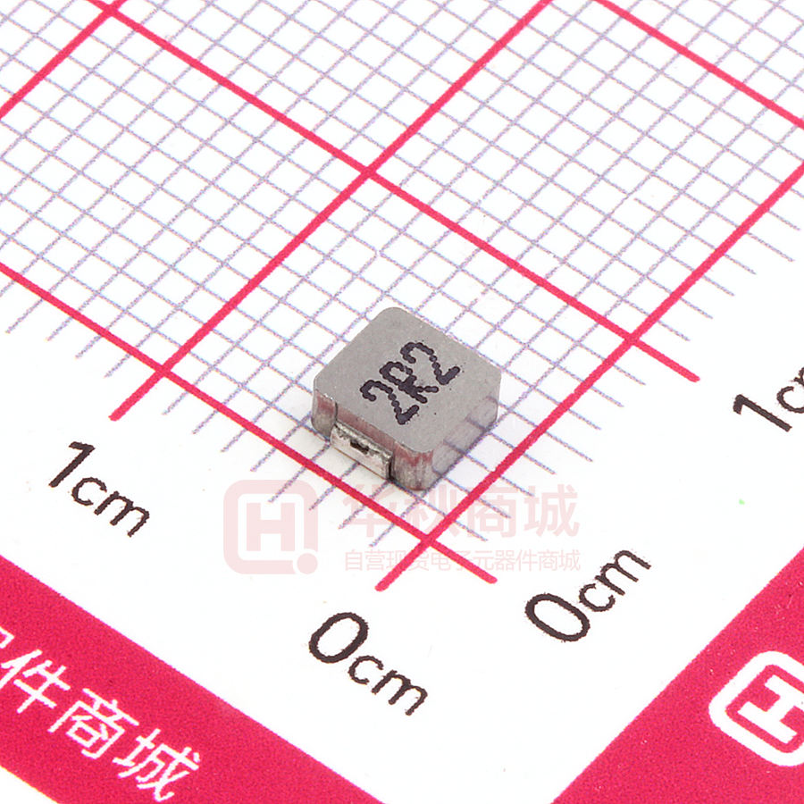

    SUMIDA(胜美达)
    SMD,4.4x4.2mm
    固定电感器 IND_4.4X4.2MM_SM 2.2µH ±20% 4.3A 4.40 x 4.20mm 2.00mm 58mΩ
0420CDMCCDS-2R2MC 数据手册
SMD Power Inductor 0420CDMCC/DS Description • Metal compound molding type construction. • Magnetically shielded. • Low audible core noise. • Suitable for large current. • L W H: 4.75 4.45 2.0mm Max. • Product weight:0.18g (Ref.) • Moisture Sensitivity Level: 1 • RoHS compliance. • Halogen Free available. RoHS × × Halogen Free Dimension - [mm] 4.4±0.35 1.8±0.2 2.8 1 . 0 ± 0 . 2 2 . 0 ± 5 . 2 52 .0 ± 2. 4 0~0.15 × × Environmental Data • Operating temperature range: -55 +125 (including coil’s self temperature rise) • Storage temperature range: -55 +125 • Solder reflow temperature: 260 peak. ℃~ ℃ ℃~ ℃ ℃ Packaging • Carrier tape and reel packaging. • 3000pcs/Reel. 0.8±0.3 Land pattern and Schematics - [mm] Applications • Ideally used in notebook, ultrabook, tablet PC, LCD display, Server application. • HDD,SSD modules application. • High current, POL converters. • Low profile, high current power supplies. • Battery powered devices. • DC/DC converters in distributed power systems. 5.2 2.2 5. 2 Page 1 of 5 Revised: 20-Nov-15 SMD Power Inductor 0420CDMCC/DS Electrical Characteristics Part No. Stamp 0420CDMCCDS-R10MC R10 0420CDMCCDS-R22MC R22 0420CDMCCDS-R33MC R33 0420CDMCCDS-R47MC R47 0420CDMCCDS-R56MC R56 0420CDMCCDS-R68MC R68 0420CDMCCDS-1R0MC 1R0 0420CDMCCDS-1R2MC 1R2 0420CDMCCDS-1R5MC 1R5 0420CDMCCDS-2R2MC 2R2 0420CDMCCDS-3R3MC 3R3 0420CDMCCDS-4R7MC 4R7 0420CDMCCDS-6R8MC 6R8 0420CDMCCDS-100MC 100 0420CDMCCDS-150MC 150 0420CDMCCDS-220MC 220 Inductance [Within] ( H) 1 μ ※ ±20% 0.22±20% 0.33±20% 0.47±20% 0.56±20% 0.68±20% 1.0±20% 1.2±20% 1.5±20% 2.2±20% 3.3±20% 4.7±20% 6.8±20% 10±20% 15±20% 22±20% D.C.R (m ) Max.(Typ.) at 25 Saturation Current (A) Max.(Typ.) (at 25 ) 2 Temperature rise current (A) (Typ.) 3 4.0(3.5) 19(22) 17.0 6.6(6.0) 15(18) 12.0 10.5(9.0) 10(12) 10.5 14(12.5) 9.5(11) 9.0 16(14) 10(12) 8.1 18(16) 8.2(9.6) 8.0 27(24) 7.0(8.0) 6.5 27(24) 7.0(8.0) 6.5 46(38) 5.7(6.7) 4.9 58(52) 5.4(6.3) 4.3 87(74) 4.0(4.7) 3.5 105(92) 2.5(3.0) 2.7 175(160) 2.3(2.7) 2.1 282(256) 2.1(2.5) 1.5 352(320) 1.6(1.9) 1.4 363(330) 1.4(1.7) 1.2 Ω ℃ 0.10 ※ ℃ ※ ※1 Measuring frequency Inductance at 100kHz ,1.0V ※2 Saturation current: The value of DC current when the inductance is over 70% of its initial value. (at 25℃ ) ※3 Temperature rise current: The actual value of DC current when temperature of coil rise is △T=40℃(Ta=25℃) Board conditions: FR4, Copper=70μm,four-layer PWB, t=1.6mm. Page 2 of 5 Revised: 20-Nov-15 SMD Power Inductor 0420CDMCC/DS Saturation Current & Temperature Rise Graph ℃ △T L (20 ) μ 1. 0420CDMCCDS-R10MC L ( H) 0.12 △T (℃) μ 60 2. 0420CDMCCDS-R22MC L ( H) 0.24 0.10 50 0.08 △T (℃) μ △T (℃) 60 3. 0420CDMCCDS-R33MC L ( H) 0.36 0.20 50 0.30 50 40 0.16 40 0.24 40 0.06 30 0.12 30 0.18 30 0.04 20 0.08 20 0.12 20 0.02 10 0.04 10 0.06 10 0 0.00 0 0.00 0.00 0 5 10 15 DC (A) 20 25 μ 4. 0420CDMCCDS-R47MC L ( H) 0.6 30 0 △T (℃) 4 8 12 16 20 DC (A) μ 60 5. 0420CDMCCDS-R56MC L ( H) 0.6 0.5 50 0.4 24 0 0 △T (℃) 60 4 8 DC (A) 12 16 μ △T (℃) 60 6. 0420CDMCCDS-R68MC L ( H) 0.90 0.5 50 0.75 50 40 0.4 40 0.60 40 0.3 30 0.3 30 0.45 30 0.2 20 0.2 20 0.30 20 0.1 10 0.1 10 0.15 10 0 0.0 0 0.00 0 0.0 0 2 4 6 8 10 DC (A) μ 12 0 △T (℃) 2 4 6 8 10 DC (A) μ 60 8. 0420CDMCCDS-1R2MC L ( H) 1.2 1.0 50 0.8 7. 0420CDMCCDS-1R0MC L ( H) 1.2 12 0 △T (℃) 2 4 6 8 DC (A) μ 60 10 △T (℃) 60 9. 0420CDMCCDS-1R5MC L ( H) 1.8 1.0 50 1.5 50 40 0.8 40 1.2 40 0.6 30 0.6 30 0.9 30 0.4 20 0.4 20 0.6 20 0.2 10 0.2 10 0.3 10 0 0.0 0 0.0 0.0 0 2 4 6 8 0 10 2 4 DC (A) 6 8 0 0 2 DC (A) μ 10. 0420CDMCCDS-2R2MC L ( H) 2.4 △T (℃) 60 4 6 8 DC (A) μ 60 11. 0420CDMCCDS-3R3MC L ( H) 3.6 2.0 50 1.6 △T (℃) μ △T (℃) 60 12. 0420CDMCCDS-4R7MC L ( H) 4.8 3.0 50 4.0 50 40 2.4 40 3.2 40 1.2 30 1.8 30 2.4 30 0.8 20 1.2 20 1.6 20 0.4 10 0.6 10 0.8 10 0 0.0 0 0.0 0.0 0 2 4 DC (A) 6 8 0 1 2 3 4 DC (A) Page 3 of 5 5 6 60 0 0 1 2 3 DC (A) Revised: 20-Nov-15 4 SMD Power Inductor 0420CDMCC/DS Saturation Current & Temperature Rise Graph ℃ △T L (20 ) μ 13. 0420CDMCCDS-6R8MC L ( H) 12 △T (℃) μ 60 14. 0420CDMCCDS-100MC L ( H) 12 10 50 8 △T (℃) μ △T (℃) 60 15. 0420CDMCCDS-150MC L ( H) 18 10 50 15 50 40 8 40 12 40 6 30 6 30 9 30 4 20 4 20 6 20 2 10 2 10 3 10 0 0 0 0 0 0 0.0 0.5 1.0 1.5 DC (A) 2.0 2.5 μ 16. 0420CDMCCDS-220MC L ( H) 24 3.0 0.0 0.5 1.0 1.5 DC (A) 2.0 2.5 3.0 0.0 0.4 0.8 1.2 1.6 DC (A) △T (℃) 60 20 50 16 40 12 30 8 20 4 10 0 0 0.0 0.4 0.8 1.2 DC (A) 1.6 2.0 Page 4 of 5 Revised: 20-Nov-15 60 2.0 SMD Power Inductor 0420CDMCC/DS Solder Reflow Condition T (℃) 300 250 Heat Endurance 260℃ 230℃ 200 0 60 120 180 240 245℃ PEAK T (s) 40s ± ℃,60~120s 170 10 100 300 ℃ 230 150 60 100 Temperature Chart 200 10 150 50 0 T (℃) 300 250 50 0 0 60 120 180 240 300 T (s) Please refer to the sales offices on our website - http://www.sumida.com Hong Kong Shanghai Shenzhen Taipei Tel.+852-2880-6781 FAX.+852-2565-9600 sales@hk.sumida.com Tel.+86-21-5836-3299 FAX.+86-21-5836-3266 shanghai.sales@cn.sumida.com Tel.+86-755-8291-0228 FAX.+86-755-8291-0338 shenzhen.sales@cn.sumida.com Tel.+886-2-8751-2737 FAX.+886-2-8751-2738 sales@tw.sumida.com Saitama(Japan) Seoul Singapore San Jose Tel.+81-48-691-7300 FAX.+81-48-691-7340 sales@jp.sumida.com Tel.+82-2-6237-0777 FAX.+82-2-6237-0778 sales@kr.sumida.com Tel.+65-6296-3388 FAX.+65-6841-4426 sales@sg.sumida.com Tel.+1-408-321-9660 FAX.+1-408-321-9308 sales@us.sumida.com Chicago Obernzell Neumarkt Tel.+1-847-545-6700 FAX. +1-847-545-6720 sales@us.sumida.com Tel.+49-8591-937-0 FAX. +49-8591-937-103 contact@eu.sumida.com Tel.+49-9181-4509-110 FAX. +49-9181-4509-310 infocomp@eu.sumida.com Page 5 of 5 Revised: 20-Nov-15
