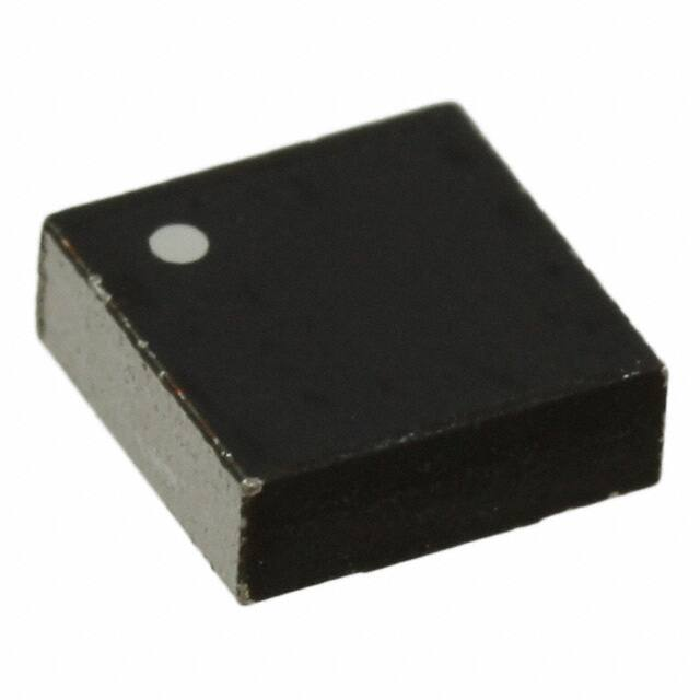

    固定电感器 Nonstandard 6.8µH ±20% 2.4A 85mΩ
0520CDMCDS-6R8MC 数据手册
SMD Power Inductor 0520CDMC/DS Description • Magnetically shielded. • L W H: 5.75 5.45 2.0 mm Max. • Product weight: 0.26g(Ref.) • Moisture Sensitivity Level: 1 • RoHS compliance. • Halogen Free available. × × RoHS Halogen Free Dimension - [mm] 5.5±0.25 2.0 Max. 1.5±0.25 2.50 1.5±0.25 × × Environmental Data • Operating temperature range: -40 ~+105 (including coil’s self temperature rise) • Storage temperature range: -40 +105 • Solder reflow temperature: 260 peak. ℃ ℃~ ℃ ℃ ℃ Packaging • Carrier tape and reel packaging. • 13.0”diameter reel • 3000pcs per reel 52 .0 ± 2 .5 Applications • Ideally used in notebook, ultrabook, tablet PC, LCD display, SSD and other low profile high current application. Land pattern and Schematics - [mm] 5.90 2.10 05 .5 Page 1 of 4 Revised: 10-Dec-13 SMD Power Inductor 0520CDMC/DS Electrical Characteristics Part Number Stamp 0520CDMCDS-R33MC R33 0520CDMCDS-R47MC R47 0520CDMCDS-R68MC R68 0520CDMCDS-1R0MC 1R0 0520CDMCDS-1R5MC 1R5 0520CDMCDS-2R2MC 2R2 0520CDMCDS-3R3MC 3R3 0520CDMCDS-4R7MC 4R7 0520CDMCDS-5R6MC 5R6 0520CDMCDS-6R8MC 6R8 0520CDMCDS-100MC 100 0520CDMCDS-150MC 150 Inductance ( H) [Within] 1 μ ※ Ω ℃ D.C.R (m ) [ within ] (at 25 ) ± 0.47±20% 0.68±20% 1.0±20% 1.5±20% 2.2±20% 3.3±20% 4.7±20% 5.6±20% 6.8±20% 10.0±20% 15.0±20% 0.33 20% ±20% 10±20% 13±20% 17±20% 24±20% 30±20% 50±20% 65±20% 75±20% 85±20% 135±20% 185±20% 8 Saturation Current (A) [Typ.] 2 Temperature rise current (A) [Typ.] 3 14.0 7.9 11.0 7.6 10.0 6.6 8.0 5.9 6.8 4.8 6.0 4.1 4.9 3.6 4.4 2.8 4.2 2.6 4.0 2.4 3.0 1.9 2.5 1.7 ※ ※ ※1. Inductance measuring condition: at 100kHz. ※2 Saturation current: The value of DC current when the inductance is over 80% of the initial value. (at 25℃ ) ※3 Temperature rise current: The actual value of DC current when the top surface temperature of test sample rise is △T= 40℃(Ta=25℃). Page 2 of 4 Revised: 10-Dec-13 SMD Power Inductor 0520CDMC/DS Saturation Current & Temperature Rise Graph ℃ △T L (20 ) μ △T (℃) 1. 0520CDMCDS-R33MC L ( H) 0.6 μ △T (℃) 2. 0520CDMCDS-R47MC L ( H) 60 0.6 0.5 50 0.4 μ △T (℃) 3. 0520CDMCDS-R68MC L ( H) 60 1.2 0.5 50 1.0 50 40 0.4 40 0.8 40 0.3 30 0.3 30 0.6 30 0.2 20 0.2 20 0.4 20 0.1 10 0.1 10 0.2 10 0.0 0 0.0 0 0.0 0 0 3 6 9 DC (A) 12 15 μ 18 0 △T (℃) 4. 0520CDMCDS-1R0MC L ( H) 1.8 4 8 DC (A) 12 16 μ 60 2.4 1.5 50 1.2 0 △T (℃) 5. 0520CDMCDS-1R5MC L ( H) 60 3 6 9 DC (A) 12 μ 15 △T (℃) 6. 0520CDMCDS-2R2MC L ( H) 60 3.0 2.0 50 2.5 50 40 1.6 40 2.0 40 0.9 30 1.2 30 1.5 30 0.6 20 0.8 20 1.0 20 0.3 10 0.4 10 0.5 10 0 0.0 0 0.0 0.0 0 3 6 9 DC (A) μ 12 15 0 △T (℃) 7. 0520CDMCDS-3R3MC L ( H) 3.6 3 6 9 DC (A) μ 12 60 6.0 3.0 50 2.4 0 15 0 △T (℃) 8. 0520CDMCDS-4R7MC L ( H) 60 2 4 6 DC (A) μ 8 10 △T (℃) 9. 0520CDMCDS-5R6MC L ( H) 60 9.0 5.0 50 7.5 50 40 4.0 40 6.0 40 1.8 30 3.0 30 4.5 30 1.2 20 2.0 20 3.0 20 0.6 10 1.0 10 1.5 10 0 0.0 0 0.0 0.0 0 2 4 DC (A) 6 8 μ 10. 0520CDMCDS-6R8MC L ( H) 12 0 △T (℃) 1 2 3 4 DC (A) 5 μ 11. 0520CDMCDS-100MC L ( H) 60 12 10 50 8 60 0 6 0 △T (℃) 1 2 3 4 DC (A) 5 μ 12. 0520CDMCDS-150MC L ( H) 6 △T (℃) 60 18 10 50 15 50 40 8 40 12 40 6 30 6 30 9 30 4 20 4 20 6 20 2 10 2 10 3 10 0 0 0 0 0 0 1 2 3 4 DC (A) 5 6 0 1 2 3 DC (A) Page 3 of 4 4 5 60 0 0 1 2 DC (A) 3 Revised: 10-Dec-13 4 SMD Power Inductor 0520CDMC/DS Solder Reflow Condition T (℃) 300 250 Heat Endurance 260℃ 230℃ 200 0 60 120 180 240 245℃ PEAK T (s) 40s ± ℃,60~120s 170 10 100 300 ℃ 230 150 60 100 Temperature Chart 200 10 150 50 0 T (℃) 300 250 50 0 0 60 120 180 240 300 T (s) Please refer to the sales offices on our website - http://www.sumida.com Hong Kong Shanghai Shenzhen Taipei Tel.+852-2880-6781 FAX.+852-2565-9600 sales@hk.sumida.com Tel.+86-21-5836-3299 FAX.+86-21-5836-3266 shanghai.sales@cn.sumida.com Tel.+86-755-8291-0228 FAX.+86-755-8291-0338 shenzhen.sales@cn.sumida.com Tel.+886-2-8751-2737 FAX.+886-2-8751-2738 sales@tw.sumida.com Saitama(Japan) Seoul Singapore San Jose Tel.+81-48-691-7300 FAX.+81-48-691-7340 sales@jp.sumida.com Tel.+82-2-6237-0777 FAX.+82-2-6237-0778 sales@kr.sumida.com Tel.+65-6296-3388 FAX.+65-6841-4426 sales@sg.sumida.com Tel.+1-408-321-9660 FAX.+1-408-321-9308 sales@us.sumida.com Chicago Obernzell Neumarkt Tel.+1-847-545-6700 FAX. +1-847-545-6720 sales@us.sumida.com Tel.+49-8591-937-0 FAX. +49-8591-937-103 contact@eu.sumida.com Tel.+49-9181-4509-110 FAX. +49-9181-4509-310 infocomp@eu.sumida.com Page 4 of 4 Revised: 10-Dec-13
