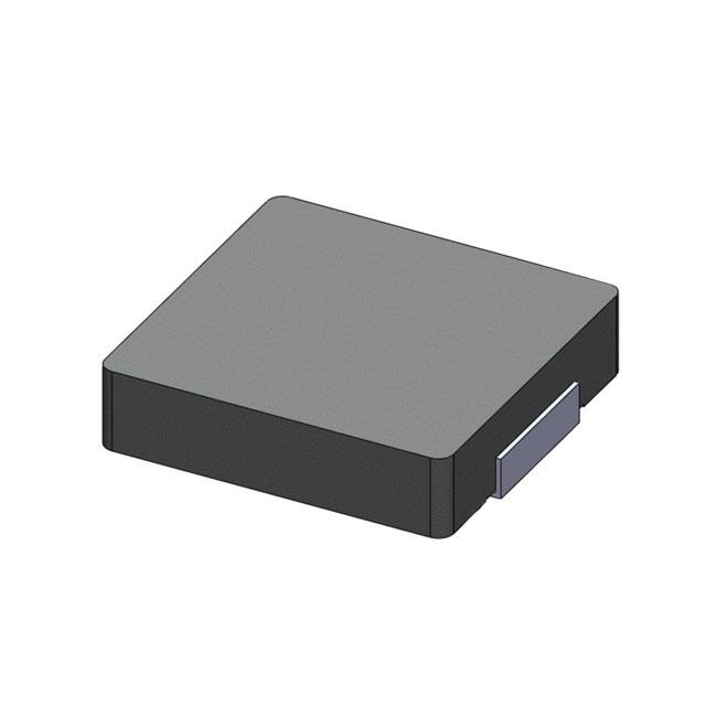

    固定电感器 Nonstandard 8.2µH ±20% 5A 54mΩ
0830CDMCCDS-8R2MC 数据手册
SMD Power Inductor 0830CDMCC/DS Recommended Type Description • Metal compound molding type construction • Magnetically shielded • Low audible core noise • Suitable for large current. • L×W×H:8.4×8.0×3.0mm Max. • Product weight: 1.0g (Ref.) • Moisture Sensitivity Level: 1 Environmental Data • Operating temperature range: -55°C~+125°C (including coil’s self temperature rise) • Storage temperature range: -55°C~+125°C Packaging • Carrier tape and reel packaging. • 1,000pcs per reel. Applications • Ideally used in notebook, ultrabook, tablet PC, LCD display, Server application • High current, POL converters • Low profile, high current power supplies • Battery powered devices. • DC/DC converter in distributed power systems Dimension - [mm] Recommended Land pattern - [mm] Wire Connection Note: This specification is subject to change without notice. Please contact your nearest sales office for updated information when placing an order. Page 1 of 6 Ver. 2021-03-05 WWW.SUMIDA.COM SMD Power Inductor 0830CDMCC/DS Recommended Type Electrical Characteristics Part Number Inductance [Within] (μH) ※1 0830CDMCCDS-R22MC 0.22 ± 20% 0830CDMCCDS-R33MC 0.33 ± 20% 0830CDMCCDS-R47MC 0.47 ± 20% 0830CDMCCDS-R68MC 0.68 ± 20% 0830CDMCCDS-R82MC 0.82 ± 20% 0830CDMCCDS-1R0MC 1.00 ± 20% 0830CDMCCDS-1R2MC 1.20 ± 20% 0830CDMCCDS-1R5MC 1.50 ± 20% 0830CDMCCDS-1R8MC 1.80 ± 20% 0830CDMCCDS-2R2MC 2.20 ± 20% 0830CDMCCDS-3R3MC 3.30 ± 20% 0830CDMCCDS-4R7MC 4.70 ± 20% 0830CDMCCDS-5R6MC 5.60 ± 20% 0830CDMCCDS-6R8MC 6.80 ± 20% 0830CDMCCDS-8R2MC 8.20 ± 20% 0830CDMCCDS-100MC 10.00 ± 20% 0830CDMCCDS-150MC 15.00 ± 20% 0830CDMCCDS-220MC 22.00 ± 20% 0830CDMCCDS-330MC 33.00 ± 20% Temperature D.C.R. at 20℃ Saturation Current Rise Current Max.(Typ.) (mΩ) (A) Max.(Typ.) ※2 (A) Max.(Typ.) ※3 2.30 (1.90) 2.60 (2.20) 3.10 (2.60) 4.30 (3.60) 4.70 (3.90) 5.40 (4.50) 6.70 (5.60) 9.40 (7.80) 8.50 (7.10) 13.00 (10.80) 19.00 (16.20) 31.00 (26.00) 35.00 (29.00) 43.00 (36.00) 54.00 (45.00) 72.00 (60.00) 100 (84.00) 145 (120) 204 (170) 30.50 (36.00) 24.00 (28.00) 20.00 (23.00) 17.60 (20.70) 15.30 (18.00) 14.50 (17.00) 13.00 (15.30) 12.50 (15.00) 10.30 (12.20) 9.90 (11.70) 8.00 (9.50) 7.30 (8.60) 5.70 (6.80) 5.40 (6.30) 5.10 (6.00) 4.60 (5.40) 4.00 (4.70) 3.30 (3.90) 2.80 (3.20) (27.00) (25.00) (23.00) (20.00) (19.00) (17.00) (16.00) (11.50) (14.00) (10.00) (9.50) (6.50) (6.30) (6.00) (5.00) (4.50) (3.60) (3.00) (2.50) ※1 Measuring frequency Inductance at 100kHz 1V ※2 Saturation current: This indicates the value of D.C. current when the inductance becomes 30% lower than its initial value. ※3 Temperature rise current: The actual value of D.C. current when the temperature of coil becomes △T=40℃ (Ta=25℃). (Test board condition: FR4, Copper=70μm, four-layer PWB t=1.6mm) Note: This specification is subject to change without notice. Please contact your nearest sales office for updated information when placing an order. Page 2 of 6 Ver. 2021-03-05 WWW.SUMIDA.COM SMD Power Inductor 0830CDMCC/DS Recommended Type Solder Reflow Condition Note: This specification is subject to change without notice. Please contact your nearest sales office for updated information when placing an order. Page 3 of 6 Ver. 2021-03-05 WWW.SUMIDA.COM SMD Power Inductor 0830CDMCC/DS Recommended Type Saturation Current & Temperature Rise Graph 1. 0830CDMCCDS-R22MC L (μH) 2. 0830CDMCCDS-R33MC △T(℃) L (μH) DC(A) L (μH) DC(A) △T(℃) L (μH) L (μH) △T(℃) DC(A) 8. 0830CDMCCDS-1R5MC △T(℃) △T(℃) 6. 0830CDMCCDS-1R0MC DC(A) 7. 0830CDMCCDS-1R2MC DC(A) L (μH) DC(A) 5. 0830CDMCCDS-R82MC △T(℃) L (μH) △T(℃) DC(A) 4. 0830CDMCCDS-R68MC L (μH) 3. 0830CDMCCDS-R47MC 9. 0830CDMCCDS-1R8MC △T(℃) DC(A) L (μH) △T(℃) DC(A) Note: This specification is subject to change without notice. Please contact your nearest sales office for updated information when placing an order. Page 4 of 6 Ver. 2021-03-05 WWW.SUMIDA.COM SMD Power Inductor 0830CDMCC/DS Recommended Type 10. 0830CDMCCDS-2R2MC L (μH) 11. 0830CDMCCDS-3R3MC △T(℃) L (μH) DC(A) L (μH) DC(A) △T(℃) L (μH) L (μH) △T(℃) DC(A) 17. 0830CDMCCDS-150MC △T(℃) △T(℃) 15. 0830CDMCCDS-8R2MC DC(A) 16. 0830CDMCCDS-100MC DC(A) L (μH) DC(A) 14. 0830CDMCCDS-6R8MC △T(℃) L (μH) △T(℃) DC(A) 13. 0830CDMCCDS-5R6MC L (μH) 12. 0830CDMCCDS-4R7MC 18. 0830CDMCCDS-220MC △T(℃) DC(A) L (μH) △T(℃) DC(A) Note: This specification is subject to change without notice. Please contact your nearest sales office for updated information when placing an order. Page 5 of 6 Ver. 2021-03-05 WWW.SUMIDA.COM SMD Power Inductor 0830CDMCC/DS Recommended Type 19. 0830CDMCCDS-330MC L (μH) △T(℃) DC(A) For sales office information, please click here to visit our website. Note: This specification is subject to change without notice. Please contact your nearest sales office for updated information when placing an order. Page 6 of 6 Ver. 2021-03-05 WWW.SUMIDA.COM
