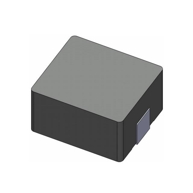

    固定电感器 IND_13.45X12.6MM_SM 4.7µH ±20% 14A 13.45 x 12.60mm 5.00mm 10mΩ
125CDMCCDS-4R7MC 数据手册
SMD Power Inductor 125CDMCC/DS Description • Metal compound molding type construction • Magnetically shielded • Low audible core noise • Suitable for large current • L×W×H:13.8×12.9×5.0mm Max. • Product weight: 4.5 g (Ref.) • Moisture Sensitivity Level: 1 Environmental Data • Operating temperature range: -55°C~+125°C (including coil’s self temperature rise) • Storage temperature range: -55°C~+125°C Packaging • Carrier tape and reel packaging • 500pcs per reel Applications • Ideally used in notebook, tablet PC, LCD display, Server application • High current, POL converters • Low profile, high current power supplies • Battery powered devices • DC/DC converters in distributed power systems Dimension - [mm] Note: This specification is subject to change without notice. Please contact your nearest sales office for updated information when placing an order. Page 1 of 6 Ver. 2021-09-15 WWW.SUMIDA.COM SMD Power Inductor 125CDMCC/DS Recommended Land pattern - [mm] Wire Connection Note: This specification is subject to change without notice. Please contact your nearest sales office for updated information when placing an order. Page 2 of 6 Ver. 2021-09-15 WWW.SUMIDA.COM SMD Power Inductor 125CDMCC/DS Electrical Characteristics Part Number Inductance [Within] (μH) ※1 125CDMCCDS-R36MC 0.36 ± 20% 125CDMCCDS-R47MC 0.47 ± 20% 125CDMCCDS-R68MC 0.68 ± 20% 125CDMCCDS-R82MC 0.82 ± 20% 125CDMCCDS-1R0MC 1.00 ± 20% 125CDMCCDS-1R5MC 1.50 ± 20% 125CDMCCDS-1R8MC 1.80 ± 20% 125CDMCCDS-2R2MC 2.20 ± 20% 125CDMCCDS-3R3MC 3.30 ± 20% 125CDMCCDS-4R7MC 4.70 ± 20% 125CDMCCDS-6R8MC 6.80 ± 20% 125CDMCCDS-8R2MC 8.20 ± 20% 125CDMCCDS-100MC 10.00 ± 20% 125CDMCCDS-150MC 15.00 ± 20% 125CDMCCDS-220MC 22.00 ± 20% 125CDMCCDS-330MC 33.00 ± 20% 125CDMCCDS-470MC 47.00 ± 20% Temperature D.C.R. at 20℃ Saturation Current Rise Current Max.(Typ.) (mΩ) (A) Max.(Typ.) ※2 (A) Max.(Typ.) ※3 0.95 (0.72) 1.10 (0.80) 1.30 (1.10) 1.80 (1.50) 1.90 (1.60) 3.30 (2.80) 3.50 (3.00) 4.20 (3.50) 7.80 (6.50) 10.00 (8.40) 18.00 (14.50) 19.00 (16.00) 22.00 (19.00) 26.00 (22.00) 40.40 (33.70) 57.00 (47.50) 97.20 (81.00) 68.00 (80.00) 53.00 (62.00) 51.00 (60.00) 42.50 (50.00) 40.00 (47.00) 32.00 (38.00) 30.00 (35.00) 29.00 (34.00) 23.00 (27.00) 19.00 (22.00) 14.00 (17.00) 13.00 (15.00) 12.00 (14.00) 9.40 (11.00) 7.20 (8.50) 6.10 (7.20) 5.40 (6.30) (40.00) (37.00) (33.00) (31.00) (28.00) (22.00) (21.00) (20.00) (17.00) (14.00) (11.00) (10.00) (9.00) (8.50) (6.50) (6.00) (4.50) ※1 Measuring frequency Inductance at 100kHz, 1V ※2 Saturation current: This indicates the actual value of D.C. current when the inductance becomes 30% lower than its initial value ※3 Temperature rise current: The actual value of D.C. current when the temperature of coil becomes △T=40℃ (Ta=25℃). (Test board condition: FR4, Copper=70μm, four-layer PWB t=1.6mm) Note: This specification is subject to change without notice. Please contact your nearest sales office for updated information when placing an order. Page 3 of 6 Ver. 2021-09-15 WWW.SUMIDA.COM SMD Power Inductor 125CDMCC/DS Solder Reflow Condition Note: This specification is subject to change without notice. Please contact your nearest sales office for updated information when placing an order. Page 4 of 6 Ver. 2021-09-15 WWW.SUMIDA.COM SMD Power Inductor 125CDMCC/DS Saturation Current & Temperature Rise Graph 1. 125CDMCCDS-R36MC L (μH) 2. 125CDMCCDS-R47MC △T(℃) L (μH) DC(A) L (μH) DC(A) △T(℃) L (μH) L (μH) △T(℃) DC(A) 8. 125CDMCCDS-2R2MC △T(℃) △T(℃) 6. 125CDMCCDS-1R5MC DC(A) 7. 125CDMCCDS-1R8MC DC(A) L (μH) DC(A) 5. 125CDMCCDS-1R0MC △T(℃) L (μH) △T(℃) DC(A) 4. 125CDMCCDS-R82MC L (μH) 3. 125CDMCCDS-R68MC 9. 125CDMCCDS-3R3MC △T(℃) DC(A) L (μH) △T(℃) DC(A) Note: This specification is subject to change without notice. Please contact your nearest sales office for updated information when placing an order. Page 5 of 6 Ver. 2021-09-15 WWW.SUMIDA.COM SMD Power Inductor 125CDMCC/DS 10. 125CDMCCDS-4R7MC L (μH) 11. 125CDMCCDS-6R8MC △T(℃) L (μH) DC(A) L (μH) DC(A) △T(℃) 15. 125CDMCCDS-220MC △T(℃) DC(A) 16. 125CDMCCDS-330MC L (μH) △T(℃) DC(A) 17. 125CDMCCDS-470MC △T(℃) DC(A) L (μH) DC(A) 14. 125CDMCCDS-150MC △T(℃) L (μH) △T(℃) DC(A) 13. 125CDMCCDS-100MC L (μH) 12. 125CDMCCDS-8R2MC L (μH) △T(℃) DC(A) For sales office information, please click here to visit our website. Note: This specification is subject to change without notice. Please contact your nearest sales office for updated information when placing an order. Page 6 of 6 Ver. 2021-09-15 WWW.SUMIDA.COM
