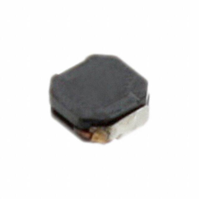

    固定电感器 Nonstandard 2.2µH ±20% 1.72A 96mΩ
CDPH28D11FHF-2R2MC 数据手册
SMD Power Inductor CDPH28D11F Description • Ferrite core construction. • Magnetically shielded. • L×W×H: 3.2×3.0×1.2mm Max. • Product weight: 34mg(Ref.) • Moisture Sensitivity Level: 1 • RoHS compliance. RoHS Dimension - [mm] 2.8±0.2 1.2 Max. 2.0 3.0±0.2 1.0 Environmental Data • Operating temperature range: -40℃~+105℃ (including coil’s self temperature rise) • Storage temperature range: -40℃~+105℃ • Solder reflow temperature: 260 ℃ peak. Packaging • Carrier tape and reel packaging. • 7.0”diameter reel • 1500pcs per reel Land pattern and Schematics - [mm] 1.8 3.6 Applications • Ideally used in Mobilephone,PDA,MP3, DSC/DVC, etc as DC-DC converter inductors. 1.2 Electrical Characteristics Part No. Stamp Inductance (μH) [ Within ] ※1 D.C.R. (mΩ) Max. (Typ.) Saturation Current (A) ※2 at 25℃ at 100℃ Temperature Rise Current (A) ※3 CDPH28D11FNP-1R0NC A 1.0±30% 62(49) 1.78(2.37) 1.60(2.00) 1.83(2.08) CDPH28D11FNP-1R2NC B 1.2±30% 73(58) 1.78(2.37) 1.60(2.00) 1.83(2.08) CDPH28D11FNP-1R5MC C 1.5±20% 86(69) 1.59(2.12) 1.45(1.85) 1.74(1.98) CDPH28D11FNP-2R2MC D 2.2±20% 96(77) 1.31(1.75) 1.15(1.45) 1.72(1.94) CDPH28D11FNP-2R7MC E 2.7±20% 116(93) 1.22(1.63) 1.10(1.40) 1.49(1.69) CDPH28D11FNP-3R3MC F 3.3±20% 128(102) 1.14(1.52) 1.05(1.30) 1.42(1.58) CDPH28D11FNP-3R9MC G 3.9±20% 144(115) 1.03(1.37) 0.90(1.10) 1.34(1.53) CDPH28D11FNP-4R7MC J 4.7±20% 184(147) 0.95(1.27) 0.65(0.85) 1.18(1.32) CDPH28D11FNP-6R8MC K 6.8±20% 300(240) 0.83(1.10) 0.60(0.75) 0.89(1.00) CDPH28D11FNP-100MC L 10.0±20% 408(326) 0.65(0.87) 0.55(0.70) 0.76(0.86) CDPH28D11FNP-120MC P 12.0±20% 453(362) 0.59(0.79) 0.50(0.60) 0.73(0.83) ※1. Inductance measuring condition: at 100kHz. ※2. Saturation current: The value of D.C. current when the inductance decreases to 70% of it’s nominal value. ※3. Temperature rise current: The value of D.C. current when the temperature rise is △t=40℃(Ta=20℃). Page 1 of 3 Revised: 10-Jan-17 SMD Power Inductor CDPH28D11F Saturation Current & Temperature Rise Graph △T L (20℃) 1. CDPH28D11FNP-1R0NC L (μH) △T (℃) L (μH) 1.2 60 1.8 60 1.8 60 1.0 50 1.5 50 1.5 50 0.8 40 1.2 40 1.2 40 0.6 30 0.9 30 0.9 30 0.4 20 0.6 20 0.6 20 0.2 10 0.3 10 0.3 10 0.0 0 0.0 0 0.0 0 0.0 0.5 1.0 1.5 DC (A) 2.0 2. CDPH28D11FNP-1R2NC 0.0 2.5 0.5 1.0 1.5 DC (A) 2.0 L (μH) 2.5 3. CDPH28D11FNP-1R5MC 0.0 0.5 1.0 1.5 DC (A) 2.0 2.5 L (μH) 2.4 60 3.0 60 3.6 60 2.0 50 2.5 50 3.0 50 1.6 40 2.0 40 2.4 40 1.2 30 1.5 30 1.8 30 0.8 20 1.0 20 1.2 20 0.4 10 0.5 10 0.6 10 0.0 0 0.0 0 0.0 0 0.4 0.8 1.2 DC (A) 1.6 2.0 △T (℃) L (μH) 0.0 0.3 0.6 0.9 1.2 1.5 1.8 DC (A) △T (℃) 0.0 0.3 0.6 0.9 1.2 1.5 1.8 DC (A) 7. CDPH28D11FNP-3R9MC L (μH) △T (℃) L (μH) 4.8 60 6 60 9.0 60 4.0 50 5 50 7.5 50 3.2 40 4 40 6.0 40 2.4 30 3 30 4.5 30 1.6 20 2 20 3.0 20 0.8 10 1 10 1.5 10 0.0 0 0 0 0.0 0 0.0 0.4 0.8 DC (A) 1.2 1.6 0.0 8. CDPH28D11FNP-4R7MC 6. CDPH28D11FNP-3R3MC △T (℃) 4. CDPH28D11FNP-2R2MC L (μH) △T (℃) 0.0 5. CDPH28D11FNP-2R7MC △T (℃) 0.3 0.6 0.9 DC (A) 1.2 1.5 L (μH) 12 60 18 60 10 50 15 50 8 40 12 40 6 30 9 30 4 20 6 20 2 10 3 10 0 0 0.0 0.2 0.4 0.6 DC (A) 0.8 1.0 L (μH) 9. CDPH28D11FNP-6R8MC △T (℃) 0 0.0 0.2 0.4 0.6 DC (A) Page 2 of 3 0.8 △T (℃) 0.0 0.2 0.4 0.6 0.8 1.0 1.2 DC (A) 10. CDPH28D11FNP-100MC L (μH) △T (℃) 0 11. CDPH28D11FNP-120MC △T (℃) 1.0 Revised: 10-Jan-17 SMD Power Inductor CDPH28D11F Solder Reflow Condition T (℃) 300 250 Heat Endurance T (℃) 300 250 260℃ 230℃ 200 100 50 0 50 0 60 120 180 240 230℃ 40s 150 60 100 0 245℃ PEAK 200 10 150 Temperature Chart 300 T (s) 170±10 ℃,60~120s 0 60 120 180 240 300 T (s) Please refer to the sales offices on our website - http://www.sumida.com Hong Kong Shanghai Shenzhen Taipei Tel.+852-2880-6781 FAX.+852-2565-9600 sales@hk.sumida.com Tel.+86-21-5836-3299 FAX.+86-21-5836-3266 shanghai.sales@cn.sumida.com Tel.+86-755-8291-0228 FAX.+86-755-8291-0338 shenzhen.sales@cn.sumida.com Tel.+886-2-8751-2737 FAX.+886-2-8751-2738 sales@tw.sumida.com Saitama(Japan) Seoul Singapore San Jose Tel.+81-48-691-7300 FAX.+81-48-691-7340 sales@jp.sumida.com Tel.+82-2-6237-0777 FAX.+82-2-6237-0778 sales@kr.sumida.com Tel.+65-6296-3388 FAX.+65-6841-4426 sales@sg.sumida.com Tel.+1-408-321-9660 FAX.+1-408-321-9308 sales@us.sumida.com Chicago Obernzell Neumarkt Tel.+1-847-545-6700 FAX. +1-847-545-6720 sales@us.sumida.com Tel.+49-8591-937-0 FAX. +49-8591-937-103 contact@eu.sumida.com Tel.+49-9181-4509-110 FAX. +49-9181-4509-310 infocomp@eu.sumida.com Page 3 of 3 Revised: 10-Jan-17
