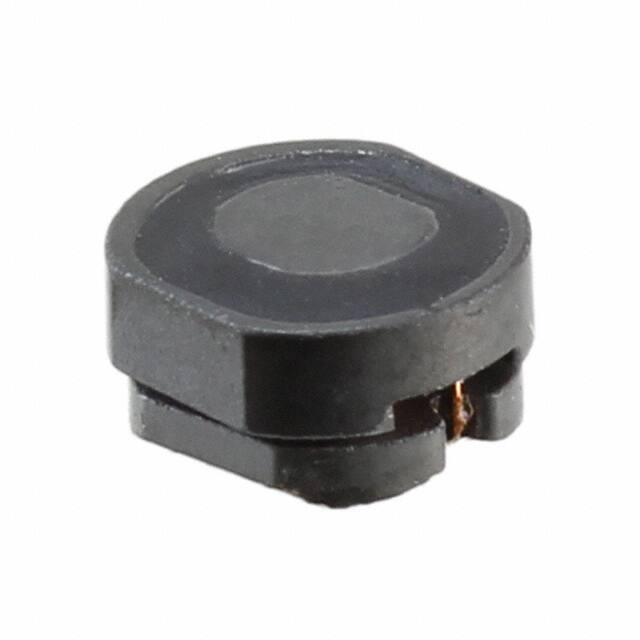

    固定电感器 Nonstandard 39µH ±15% 530mA 470mΩ 17MHz
CDR63BNP-390LC 数据手册
POWER INDUCTORS Type: CDR63,CDR63B ◆ Product Description ・6.5×5.9mm Max.(L×W), 3.6mm Max. Height.(CDR63), 3.5mm Max. Height.(CDR63B) ・Inductance range: 10~100μH(CDR63) ; 10~68μH(CDR63B) ・Rated current range: 0.3~0.8A(CDR63) ; 0.42~1.0A(CDR63B). ・In addition to the standards versions shown here, custom inductors are also available to meet your exact requirements. ◆ Feature ・Magnetically shielded construction. ・Ideally used in Notebook PC ,LCD TV ,Game machine ,HDD,DSC/DVC, etc as DC-DC Converter inductors. ・RoHS Compliance. ◆ Dimensions (mm) 5.6±0.3 3.3±0.3 4.0 φ6.2±0.3 1.2 3.2±0.3 4.9 1.45 www.sumida.com CDR63 5.6±0.3 CDR63B φ6.2±0.3 Please refer to the sales offices on our website for a representative near you 1/3 5.5 4.5 POWER INDUCTORS Type: CDR63,CDR63B ◆ Land Pattern (mm) 4.5 5.5 PART OF ELECTRODE 1.7 6.2 PART OF ELECTRODE 1.5 5.0 R 1.0 R 1.0 PART OF SILK SCREEN PART OF SILK SCREEN CDR63 CDR63B ◆ Specification(CDR63) Part name ※ CDR63NP-1ØØM□ CDR63NP-12ØM□ CDR63NP-15ØM□ CDR63NP-18ØM□ CDR63NP-22ØM□ CDR63NP-27ØM□ CDR63NP-33ØL□ CDR63NP-39ØL□ CDR63NP-47ØL□ CDR63NP-56ØL□ CDR63NP-68ØL□ CDR63NP-82ØL□ CDR63NP-1Ø1K□ Stamp A B C D E F G H J K L M N Inductance [within] ※1 10μH ± 20% 12μH ± 20% 15μH ± 20% 18μH ± 20% 22μH ± 20% 27μH ± 20% 33μH ± 15% 39μH ± 15% 47μH ± 15% 56μH ± 15% 68μH ± 15% 82μH ± 15% 100μH ± 10% D.C.R.(Ω) MAX. (at 20℃) 0.13 0.14 0.15 0.18 0.25 0.34 0.37 0.39 0.43 0.50 0.53 0.75 0.85 Rated Current(A) ※2-1 0.80 0.74 0.70 0.64 0.62 0.57 0.52 0.45 0.40 0.37 0.35 0.32 0.30 S.R.F. (MHz) [Typ.] 37.7 31.7 28.9 26.7 23.7 18.9 17.0 16.6 16.2 13.8 13.1 11.8 11.1 ※1:Measuring frequency: 10µH ~ 82µH(at 2.52 MHz) ; 100 µH (at 1 kHz). Please refer to the sales offices on our website for a representative near you www.sumida.com 2/3 POWER INDUCTORS Type: CDR63,CDR63B ◆Specification(CDR63B) Part Name ※ CDR63BNP-1ØØM□ CDR63BNP-12ØM□ CDR63BNP-15ØM□ CDR63BNP-18ØM□ CDR63BNP-22ØM□ CDR63BNP-27ØM□ CDR63BNP-33ØL□ CDR63BNP-39ØL□ CDR63BNP-47ØL□ CDR63BNP-56ØL□ CDR63BNP-68ØL□ Stamp Inductance [Within] (at 2.52 MHz) 10μH ± 20% 12μH ± 20% 15μH ± 20% 18μH ± 20% 22μH ± 20% 27μH ± 20% 33μH ± 15% 39μH ± 15% 47μH ± 15% 56μH ± 15% 68μH ± 15% D.C.R.(Ω) [Max.] (at 20℃) 0.14 0.16 0.18 0.25 0.32 0.36 0.41 0.47 0.51 0.72 0.82 Rated Current(A) ※2-2 1.00 0.94 0.86 0.78 0.76 0.64 0.61 0.53 0.50 0.46 0.42 S.R.F. (MHz) [Typ.] 35.3 32.2 29.3 26.7 23.1 20.8 18.2 17.0 15.3 14.1 12.1 A B C D E F G H J K L ※ Description of part name CDR63BNP-1ØØM□ B Box C Carrier Tape ※2-1. Rated current: The D.C. current at which the inductance decreases to 80% of it’s nominal value or when △t=40℃, whichever is lower(Ta=20℃). ※2-2. Rated current: The D.C. current at which the inductance decreases to 90% of it’s initial value or when △t=40℃, whichever is lower(Ta=20℃). Please refer to the sales offices on our website for a representative near you www.sumida.com 3/3
