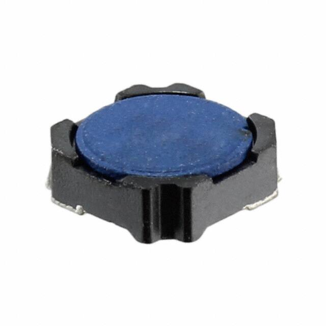

    固定电感器 Nonstandard 2.7µH ±25% 2.38A 40mΩ
CDR6D23MNNP-2R7NC 数据手册
SMD Power Inductor CDR6D23MN Description • Ferrite drum core construction. • Magnetically shielded. • L×W×H: 6.8×6.8×2.5 mm Max. • Product weight: 0.27g(Ref.) • Moisture Sensitivity Level: 1 • RoHS compliance. RoHS Environmental Data • Operating temperature range: -40℃~+105℃ (including coil’s self temperature rise) • Storage temperature range: -40℃~+105℃ • Solder reflow temperature: 260 ℃ peak. Dimension - [mm] Packaging • Carrier tape and reel packaging • 11.8”diameter reel • 1500pcs per reel Applications • Ideally used in LCD driver, DSC/DVC , Notebook PC or the other portable equipment Land pattern and Schematics - [mm] Page 1 of 5 Revised: 6-Jan-17 SMD Power Inductor CDR6D23MN Electrical Characteristics Part Name Stamp Saturation Current (A) ※2 Inductance ( μH ) [Within]※1 D.C.R. (mΩ) Max. (Typ.) (at 20℃) (at 20℃) (at 105℃) Temperature Rise Current (A)※3 CDR6D23MNNP-0R6NC 0R6 0.6μH±25% 20.0(16) 6.55 4.95 4.60 CDR6D23MNNP-1R0NC 1R0 1.0μH±25% 25.0(20) 5.15 4.00 3.90 CDR6D23MNNP-1R5NC 1R5 1.5μH±25% 28.0(22) 4.40 3.55 3.30 CDR6D23MNNP-2R0NC 2R0 2.0μH±25% 36.3(29) 3.85 3.05 2.60 CDR6D23MNNP-2R7NC 2R7 2.7μH±25% 40.0(32) 3.30 2.60 2.38 CDR6D23MNNP-3R3NC 3R3 3.3μH±25% 46.3(37) 2.95 2.30 2.25 CDR6D23MNNP-4R2NC 4R2 4.2μH±25% 52.5(42) 2.60 2.10 2.05 CDR6D23MNNP-5R1NC 5R1 5.1μH±25% 60.0(48) 2.45 1.95 1.90 CDR6D23MNNP-6R1NC 6R1 6.1μH±25% 66.3(53) 2.30 1.75 1.80 CDR6D23MNNP-7R2NC 7R2 7.2μH±25% 72.5(58) 2.10 1.60 1.70 CDR6D23MNNP-8R3NC 8R3 8.3μH±25% 80.0(64) 1.95 1.50 1.50 CDR6D23MNNP-100NC 100 10μH±25% 103.8(83) 1.75 1.40 1.30 CDR6D23MNNP-120NC 120 12μH±25% 117.5(94) 1.55 1.25 1.25 CDR6D23MNNP-150NC 150 15μH±25% 133.8(107) 1.40 1.15 1.10 CDR6D23MNNP-180NC 180 18μH±25% 158.8(127) 1.30 1.05 1.00 CDR6D23MNNP-220NC 220 22μH±25% 1.20 0.95 0.80 CDR6D23MNNP-270NC 270 27μH±25% 255.0(204) 1.05 0.85 0.75 CDR6D23MNNP-330NC 330 33μH±25% 275.0(220) 0.95 0.75 0.70 CDR6D23MNNP-390NC 390 39μH±25% 393.8(315) 0.90 0.70 0.58 CDR6D23MNNP-470NC 470 47μH±25% 456.3(365) 0.80 0.60 0.54 CDR6D23MNNP-560NC 560 56μH±25% 481.2(385) 0.75 0.58 0.51 CDR6D23MNNP-680NC 680 68μH±25% 751.3(601) 0.65 0.53 0.45 CDR6D23MNNP-820NC 820 82μH±25% 803.8(643) 0.60 0.47 0.43 CDR6D23MNNP-101NC 101 100μH±25% 903.8(723) 0.55 0.44 0.41 187.5(150) ※1. Inductance measuring condition: at 100kHz. ※2. Saturation current: The value of D.C. current when the inductance decreases to 65% of it’s nominal value. ※3. Temperature rise current: The value of D.C. current when the temperature rise is △t=40℃(Ta=20℃). Page 2 of 5 Revised: 6-Jan-17 SMD Power Inductor CDR6D23MN Saturation Current & Temperature Rise Graph L (20℃) L (μH) △T L (105℃) 1. CDR6D23MNNP-0R6NC △T (℃) L (μH) 2. CDR6D23MNNP-1R0NC △T (℃) L (μH) 3. CDR6D23MNNP-1R5NC △T (℃) 1.2 60 1.2 60 1.8 60 1.0 50 1.0 50 1.5 50 0.8 40 0.8 40 1.2 40 0.6 30 0.6 30 0.9 30 0.4 20 0.4 20 0.6 20 0.2 10 0.2 10 0.3 10 0 0.0 0 0.0 0.0 0 L (μH) 2 4 DC (A) 6 8 4. CDR6D23MNNP-2R0NC 0 △T (℃) L (μH) 2 4 DC (A) 6 5. CDR6D23MNNP-2R7NC 8 0 0 △T (℃) L (μH) 1 2 3 4 DC (A) 5 6. CDR6D23MNNP-3R3NC 6 △T (℃) 2.4 60 3.0 60 3.6 60 2.0 50 2.5 50 3.0 50 1.6 40 2.0 40 2.4 40 1.2 30 1.5 30 1.8 30 0.8 20 1.0 20 1.2 20 0.4 10 0.5 10 0.6 10 0 0.0 0 0.0 0.0 0 L (μH) 1 2 3 DC (A) 4 7. CDR6D23MNNP-4R2NC 5 0 △T (℃) L (μH) 1 2 DC (A) 3 8. CDR6D23MNNP-5R1NC 4 0 0 △T (℃) L (μH) 1 2 DC (A) 3 9. CDR6D23MNNP-6R1NC 4 △T (℃) 4.8 60 6 60 9.0 60 4.0 50 5 50 7.5 50 3.2 40 4 40 6.0 40 2.4 30 3 30 4.5 30 1.6 20 2 20 3.0 20 0.8 10 1 10 1.5 10 0 0 0 0.0 0 0.0 0.0 L (μH) 0.8 1.6 DC (A) 2.4 3.2 0.0 10. CDR6D23MNNP-7R2NC △T (℃) L (μH) 0.8 1.6 DC (A) 2.4 3.2 0.0 0.5 1.0 1.5 2.0 2.5 3.0 DC (A) 11. CDR6D23MNNP-8R3NC △T (℃) L (μH) 12. CDR6D23MNNP-100NC △T (℃) 9.0 60 9.0 60 12 60 7.5 50 7.5 50 10 50 6.0 40 6.0 40 8 40 4.5 30 4.5 30 6 30 3.0 20 3.0 20 4 20 1.5 10 1.5 10 2 10 0 0.0 0 0 0.0 0.0 0.5 1.0 1.5 2.0 2.5 3.0 DC (A) 0.0 0.5 1.0 1.5 DC (A) Page 3 of 5 2.0 2.5 0 0.0 0.4 0.8 1.2 1.6 2.0 2.4 DC (A) Revised: 6-Jan-17 SMD Power Inductor CDR6D23MN Saturation Current & Temperature Rise Graph L (20℃) L (μH) △T L (105℃) 13. CDR6D23MNNP-120NC △T (℃) L (μH) 14. CDR6D23MNNP-150NC △T (℃) L (μH) 15. CDR6D23MNNP-180NC △T (℃) 18 60 18 60 24 60 15 50 15 50 20 50 12 40 12 40 16 40 9 30 9 30 12 30 6 20 6 20 8 20 3 10 3 10 4 10 0 0 0 0 0 0.0 0.4 0.8 1.2 DC (A) 1.6 2.0 0.0 0.3 0.6 0.9 1.2 1.5 1.8 0 0.0 0.3 0.6 0.9 1.2 1.5 1.8 DC (A) DC (A) 16. CDR6D23MNNP-220NC L (μH) △T (℃) 17. CDR6D23MNNP-270NC L (μH) △T (℃) L (μH) 30 60 30 60 48 60 25 50 25 50 40 50 20 40 20 40 32 40 15 30 15 30 24 30 10 20 10 20 16 20 5 10 5 10 8 10 0 0 0 0 0 0.0 0.4 0.8 1.2 1.6 0.0 0.3 0.6 DC (A) 0.9 1.2 1.5 18. CDR6D23MNNP-330NC △T (℃) 0 0.0 0.3 DC (A) 0.6 0.9 1.2 1.5 DC (A) 19. CDR6D23MNNP-390NC L (μH) △T (℃) L (μH) 48 60 60 60 60 60 40 50 50 50 50 50 32 40 40 40 40 40 24 30 30 30 30 30 16 20 20 20 20 20 8 10 10 10 10 10 0 0 0 0 0 0 0.0 0.2 0.4 0.6 0.8 1.0 1.2 DC (A) L (μH) 0.0 22. CDR6D23MNNP-680NC △T (℃) L (μH) 20. CDR6D23MNNP-470NC 0.2 0.4 0.6 DC (A) 0.8 23. CDR6D23MNNP-820NC △T (℃) 1.0 L (μH) 0.0 △T (℃) L (μH) 21. CDR6D23MNNP-560NC △T (℃) 0.2 0.4 0.6 DC (A) 0.8 1.0 24. CDR6D23MNNP-101NC △T (℃) 90 60 90 60 120 60 75 50 75 50 100 50 60 40 60 40 80 40 45 30 45 30 60 30 30 20 30 20 40 20 15 10 15 10 20 10 0 0 0 0 0 0.0 0.2 0.4 0.6 DC (A) 0.8 1.0 0.0 0.2 0.4 DC (A) 0.6 Page 4 of 5 0.8 0 0.0 0.2 0.4 0.6 DC (A) Revised: 6-Jan-17 0.8 SMD Power Inductor CDR6D23MN Solder Reflow Condition T (℃) 300 250 Heat Endurance T (℃) 300 250 260℃ 230℃ 200 100 50 0 50 0 60 120 180 240 230℃ 40s 150 60 100 0 245℃ PEAK 200 10 150 Temperature Chart 300 T (s) 170±10 ℃,60~120s 0 60 120 180 240 300 T (s) Please refer to the sales offices on our website - http://www.sumida.com Hong Kong Shanghai Shenzhen Taipei Tel.+852-2880-6781 FAX.+852-2565-9600 sales@hk.sumida.com Tel.+86-21-5836-3299 FAX.+86-21-5836-3266 shanghai.sales@cn.sumida.com Tel.+86-755-8291-0228 FAX.+86-755-8291-0338 shenzhen.sales@cn.sumida.com Tel.+886-2-8751-2737 FAX.+886-2-8751-2738 sales@tw.sumida.com Saitama(Japan) Seoul Singapore San Jose Tel.+81-48-691-7300 FAX.+81-48-691-7340 sales@jp.sumida.com Tel.+82-2-6237-0777 FAX.+82-2-6237-0778 sales@kr.sumida.com Tel.+65-6296-3388 FAX.+65-6841-4426 sales@sg.sumida.com Tel.+1-408-321-9660 FAX.+1-408-321-9308 sales@us.sumida.com Chicago Obernzell Neumarkt Tel.+1-847-545-6700 FAX. +1-847-545-6720 sales@us.sumida.com Tel.+49-8591-937-0 FAX. +49-8591-937-103 contact@eu.sumida.com Tel.+49-9181-4509-110 FAX. +49-9181-4509-310 infocomp@eu.sumida.com Page 5 of 5 Revised: 6-Jan-17

物料型号:CDR6D23MN
器件简介: - 采用铁氧体鼓芯构造,磁屏蔽。 - 尺寸为6.8×6.8×2.5 mm,重量约为0.27g。 - 湿度敏感等级为1,符合RoHS标准。
环境数据: - 工作温度范围:-40℃至+105℃(包括线圈自身温升)。 - 存储温度范围:-40℃至+105℃。
尺寸信息: - 典型值2.3mm,最大2.5mm。
引脚分配封装信息: - 引脚为焊盘式。 - 采用载带和卷轴包装,11.8英寸直径卷轴,每卷1500个。
应用信息: - 理想用于液晶驱动器、DSC/DVC、笔记本电脑或其他便携设备。
电气特性: - 提供了不同标称电感值(从0.6μH至100μH)的电感器的电气特性,包括电感值、直流电阻(D.C.R.)、饱和电流和温升电流。
饱和电流与温升曲线图: - 展示了不同电感值在20℃和105℃下的电感值变化和温升情况。
焊接条件: - 焊接回流温度峰值260℃。
