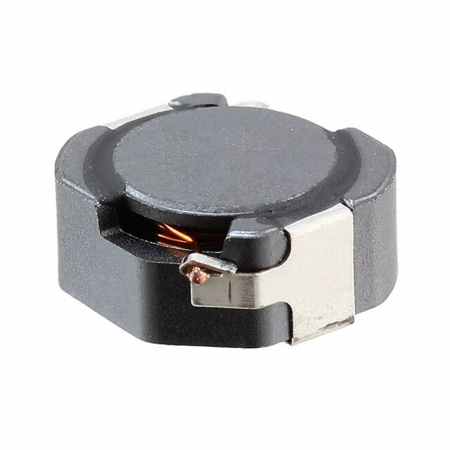

    固定电感器 Nonstandard 15µH ±25% 1.4A 135mΩ
CDR6D28MNNP-150NC 数据手册
SMD Power Inductor CDR6D28MN Description • Ferrite drum core construction. • Magnetically shielded. • L×W×H: 6.8×6.8×3.0 mm Max. • Product weight: 0.35 g(Ref.) • Moisture Sensitivity Level: 1 • RoHS compliance. RoHS Environmental Data • Operating temperature range: -40℃~+105℃ (including coil’s self temperature rise) • Storage temperature range: -40℃~+105℃ • Solder reflow temperature: 260 ℃ peak. Dimension - [mm] Packaging • Carrier tape and reel packaging • 12.9”diameter reel • 1500pcs per reel Applications • Ideally used in LCD driver, DSC/DVC , Notebook PC or the other portable equipment : Land pattern and Schematics - [mm] Page 1 of 5 Revised: 6-Jan-17 SMD Power Inductor CDR6D28MN Electrical Characteristics Part Name Stamp Saturation Current (A) ※2 Inductance (μH ) [ within ] ※1 D.C.R. (mΩ) Max. (Typ.) (at 20℃) (at 20℃) (at 105℃) Temperature Rise Current (A) ※3 CDR6D28MNNP-1R5NC 1R5 1.5μH±25% 31.5(25) 5.90 4.55 3.0 CDR6D28MNNP-2R0NC 2R0 2.0μH±25% 37.5(30) 4.75 3.90 2.9 CDR6D28MNNP-2R7NC 2R7 2.7μH±25% 43.8(35) 4.30 3.45 2.7 CDR6D28MNNP-3R6NC 3R6 3.6μH±25% 50.0(40) 3.90 3.05 2.5 CDR6D28MNNP-4R5NC 4R5 4.5μH±25% 57.5(46) 3.55 2.75 2.4 CDR6D28MNNP-5R5NC 5R5 5.5μH±25% 63.8(51) 3.15 2.50 2.2 CDR6D28MNNP-6R5NC 6R5 6.5μH±25% 70.0(56) 3.05 2.40 2.1 CDR6D28MNNP-7R7NC 7R7 7.7μH±25% 76.3(61) 2.85 2.30 2.0 CDR6D28MNNP-9R0NC 9R0 9.0μH±25% 82.5(66) 2.60 2.10 1.9 CDR6D28MNNP-100NC 100 10μH±25% 88.8(71) 2.50 2.00 1.8 CDR6D28MNNP-120NC 120 12μH±25% 120.0(96) 2.30 1.75 1.5 CDR6D28MNNP-150NC 150 15μH±25% 135.0(108) 2.10 1.55 1.4 CDR6D28MNNP-180NC 180 18μH±25% 150.0(121) 1.75 1.45 1.3 CDR6D28MNNP-220NC 220 22μH±25% 198.8(159) 1.65 1.25 1.1 CDR6D28MNNP-270NC 270 27μH±25% 231.2(185) 1.45 1.15 0.98 CDR6D28MNNP-330NC 330 33μH±25% 308.8(247) 1.25 1.05 0.94 CDR6D28MNNP-390NC 390 39μH±25% 335.0(268) 1.15 0.95 0.90 CDR6D28MNNP-470NC 470 47μH±25% 458.8(367) 1.05 0.90 0.72 CDR6D28MNNP-560NC 560 56μH±25% 501.3(401) 1.00 0.80 0.68 CDR6D28MNNP-680NC 680 68μH±25% 561.3(449) 0.90 0.75 0.65 CDR6D28MNNP-820NC 820 82μH±25% 837.5(670) 0.80 0.65 0.53 CDR6D28MNNP-101NC 101 100μH±25% 936.3(749) 0.75 0.60 0.50 CDR6D28MNNP-121NC 121 120μH±25% 1028.8(823) 0.70 0.55 0.46 ※1. Inductance measuring condition: at 100kHz. ※2. Saturation current: The value of D.C. current when the inductance decreases to 65% of it’s nominal value. ※3. Temperature rise current: The value of D.C. current when the temperature rise is △t=40℃(Ta=20℃). Page 2 of 5 Revised: 6-Jan-17 SMD Power Inductor CDR6D28MN Saturation Current & Temperature Rise Graph L (20℃) L (μH) △T L (100℃) 1. CDR6D28MNNP-1R5NC △T (℃) L (μH) 2. CDR6D28MNNP-2R0NC △T (℃) L (μH) 3. CDR6D28MNNP-2R7NC △T (℃) 1.8 60 2.4 60 3.6 60 1.5 50 2.0 50 3.0 50 1.2 40 1.6 40 2.4 40 0.9 30 1.2 30 1.8 30 0.6 20 0.8 20 1.2 20 0.3 10 0.4 10 0.6 10 0 0.0 0 0.0 0.0 0 L (μH) 2 4 DC (A) 6 8 4. CDR6D28MNNP-3R6NC 0 △T (℃) L (μH) 1 2 3 4 DC (A) 5 5. CDR6D28MNNP-4R5NC 6 0 0 △T (℃) L (μH) 1 2 3 4 DC (A) 5 6. CDR6D28MNNP-5R5NC 6 △T (℃) 4.8 60 4.8 60 6 60 4.0 50 4.0 50 5 50 3.2 40 3.2 40 4 40 2.4 30 2.4 30 3 30 1.6 20 1.6 20 2 20 0.8 10 0.8 10 1 10 0 0.0 0 0 0.0 0 L (μH) 1 2 3 DC (A) 4 7. CDR6D28MNNP-6R5NC 5 0 △T (℃) L (μH) 1 2 3 DC (A) 4 8. CDR6D28MNNP-7R7NC 0 5 0 △T (℃) L (μH) 1 2 DC (A) 3 9. CDR6D28MNNP-9R0NC 4 △T (℃) 9.0 60 9.0 60 12 60 7.5 50 7.5 50 10 50 6.0 40 6.0 40 8 40 4.5 30 4.5 30 6 30 3.0 20 3.0 20 4 20 1.5 10 1.5 10 2 10 0 0.0 0 0 0 0.0 0 L (μH) 1 2 DC (A) 3 4 0.0 0.6 1.2 1.8 2.4 3.0 3.6 DC (A) 10. CDR6D28MNNP-100NC △T (℃) L (μH) 11. CDR6D28MNNP-120NC 0.0 0.6 1.2 1.8 2.4 3.0 3.6 DC (A) △T (℃) L (μH) 12. CDR6D28MNNP-150NC △T (℃) 12 60 18 60 18 60 10 50 15 50 15 50 8 40 12 40 12 40 6 30 9 30 9 30 4 20 6 20 6 20 2 10 3 10 3 10 0 0 0 0 0 0.0 0.8 1.6 DC (A) 2.4 3.2 0 0.0 0.5 1.0 1.5 2.0 2.5 3.0 DC (A) 0.0 0.5 1.0 1.5 2.0 2.5 3.0 DC (A) Page 3 of 5 Revised: 6-Jan-17 SMD Power Inductor CDR6D28MN Saturation Current & Temperature Rise Graph L (20℃) L (μH) △T L (100℃) 13. CDR6D28MNNP-180NC △T (℃) L (μH) 14. CDR6D28MNNP-220NC △T (℃) L (μH) 15. CDR6D28MNNP-270NC △T (℃) 24 60 30 60 30 60 20 50 25 50 25 50 16 40 20 40 20 40 12 30 15 30 15 30 8 20 10 20 10 20 4 10 5 10 5 10 0 0 0 0 0 0.0 0.4 0.8 1.2 1.6 2.0 2.4 0.0 0.4 0.8 1.2 1.6 2.0 2.4 DC (A) 0 0.0 0.4 0.8 1.2 1.6 2.0 DC (A) DC (A) 16. CDR6D28MNNP-330NC L (μH) △T (℃) 17. CDR6D28MNNP-390NC L (μH) △T (℃) L (μH) 48 60 48 60 60 60 40 50 40 50 50 50 32 40 32 40 40 40 24 30 24 30 30 30 16 20 16 20 20 20 8 10 8 10 10 10 0 0 0 0 0 0.0 0.3 0.6 0.9 1.2 1.5 1.8 0.0 0.4 DC (A) 0.8 1.2 0 0.0 1.6 18. CDR6D28MNNP-470NC △T (℃) 0.3 DC (A) 1.2 1.5 19. CDR6D28MNNP-560NC L (μH) △T (℃) L (μH) 60 60 90 60 120 60 50 50 75 50 100 50 40 40 60 40 80 40 30 30 45 30 60 30 20 20 30 20 40 20 10 10 15 10 20 10 0 0 0 0 0 0 0.0 L (μH) 0.3 0.6 0.9 DC (A) 1.2 1.5 20. CDR6D28MNNP-680NC 0.6 0.9 DC (A) △T (℃) 0.0 0.2 0.4 0.6 0.8 1.0 1.2 DC (A) 22. CDR6D28MNNP-101NC △T (℃) L (μH) 23. CDR6D28MNNP-121NC 0.0 60 180 60 100 50 150 50 80 40 120 40 60 30 90 30 40 20 60 20 20 10 30 10 0 0 0.0 0.2 0.4 0.6 DC (A) 0.8 1.0 21. CDR6D28MNNP-820NC △T (℃) 0.2 0.4 0.6 DC (A) 0.8 △T (℃) 120 0 L (μH) 0 0.0 0.2 0.4 0.6 DC (A) Page 4 of 5 0.8 1.0 Revised: 6-Jan-17 1.0 SMD Power Inductor CDR6D28MN Solder Reflow Condition T (℃) 300 250 Heat Endurance T (℃) 300 250 260℃ 230℃ 200 100 50 0 50 0 60 120 180 240 230℃ 40s 150 60 100 0 245℃ PEAK 200 10 150 Temperature Chart 300 T (s) 170±10 ℃,60~120s 0 60 120 180 240 300 T (s) Please refer to the sales offices on our website - http://www.sumida.com Hong Kong Shanghai Shenzhen Taipei Tel.+852-2880-6781 FAX.+852-2565-9600 sales@hk.sumida.com Tel.+86-21-5836-3299 FAX.+86-21-5836-3266 shanghai.sales@cn.sumida.com Tel.+86-755-8291-0228 FAX.+86-755-8291-0338 shenzhen.sales@cn.sumida.com Tel.+886-2-8751-2737 FAX.+886-2-8751-2738 sales@tw.sumida.com Saitama(Japan) Seoul Singapore San Jose Tel.+81-48-691-7300 FAX.+81-48-691-7340 sales@jp.sumida.com Tel.+82-2-6237-0777 FAX.+82-2-6237-0778 sales@kr.sumida.com Tel.+65-6296-3388 FAX.+65-6841-4426 sales@sg.sumida.com Tel.+1-408-321-9660 FAX.+1-408-321-9308 sales@us.sumida.com Chicago Obernzell Neumarkt Tel.+1-847-545-6700 FAX. +1-847-545-6720 sales@us.sumida.com Tel.+49-8591-937-0 FAX. +49-8591-937-103 contact@eu.sumida.com Tel.+49-9181-4509-110 FAX. +49-9181-4509-310 infocomp@eu.sumida.com Page 5 of 5 Revised: 6-Jan-17
