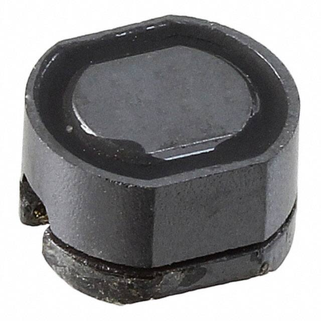

    固定电感器 Nonstandard 82µH ±15% 620mA 430mΩ 9.3MHz
CDR74BNP-820LC 数据手册
SMD Power Inductor CDR74B Description • Ferrite drum core construction. • Magnetically shielded. • L W H: 8.15 7.35 4.9 mm Max. • Product weight: 75mg(Ref.) • Moisture Sensitivity Level: 1 • RoHS compliance. RoHS × × Environmental Data • Operating temperature range: -25 +80 (including coil’s self temperature rise) • Storage temperature range: -25 +80 • Solder reflow temperature: 260 peak. ℃~ ℃ ℃~ ℃ ℃ Dimension - [mm] 4.5±0.4 7.0±0.35 6.2 5 3 . 0 ± 8 . 7 φ × × 1. 2 9. 6 Packaging • Carrier tape and reel packaging • 12.9”diameter reel • 1000pcs per reel Applications • Ideally used in Notebook PC ,LCD TV ,Game machine ,HDD ,DSC/DVC , etc as DC-DC converter inductors. Land pattern and Schematics - [mm] 7.5 PART OF ELECTRODE 0. 2 R 1.0 0. 01 PART OF SOLDER RESIST PRINTING Page 1 of 4 Revised: 19-Dec-13 SMD Power Inductor CDR74B Electrical Characteristics Part name Stamp CDR74BNP-100MC 100 CDR74BNP-120MC 120 CDR74BNP-150MC 150 CDR74BNP-180MC 180 CDR74BNP-220MC 220 CDR74BNP-270MC 270 CDR74BNP-330LC 330 CDR74BNP-390LC 390 CDR74BNP-470LC 470 CDR74BNP-560LC 560 CDR74BNP-680LC 680 CDR74BNP-820LC 820 CDR74BNP-101KC 101 CDR74BNP-121KC 121 CDR74BNP-151KC 151 CDR74BNP-181KC 181 CDR74BNP-221KC 221 CDR74BNP-271KC 271 Inductance ( H) [within] 1 μ ※ ±20% 12± 20% 15±20% 18±20% 22±20% 27±20% 33±15% 39±15% 47±15% 56±15% 68±15% 82±15% 100±10% 120±10% 150±10% 180±10% 220±10% 270±10% 10 Ω ℃ D.C.R.( ) MAX. (at 20 ) Rated Current ( ) 2 0.07 1.65 0.07 1.57 0.08 1.39 0.10 1.29 0.13 1.12 0.16 1.06 0.18 0.97 0.18 0.91 0.27 0.80 0.29 0.76 0.33 0.68 0.43 0.62 0.49 0.55 0.68 0.49 0.94 0.44 1.00 0.40 1.18 0.36 1.30 0.33 A※ ※1. Inductance measuring frequency: 10μH ~ 82μH ; at 2.52 MHz 100μH ~ 270μH ; at 1 kHz ※2. Rated current: The D.C. current at which the inductance decreases to 90% of it’s nominal value or when △t=40℃, whichever is lower (Ta=20℃). Page 2 of 4 Revised: 19-Dec-13 SMD Power Inductor CDR74B Saturation Current & Temperature Rise Graph ℃ L (20 ) μ L ( H) 12 ℃ △T L (105 ) △T (℃) 1. CDR74BNP-100MC μ L ( H) 60 18 10 50 8 2. CDR74BNP-120MC △T (℃) μ L ( H) 3. CDR74BNP-150MC △T (℃) 60 18 15 50 15 50 40 12 40 12 40 6 30 9 30 9 30 4 20 6 20 6 20 2 10 3 10 3 10 0 0 0 0 0 0.0 0.5 1.0 1.5 2.0 2.5 3.0 DC (A) μ L ( H) △T (℃) 4. CDR74BNP-180MC 0.0 0.5 1.0 1.5 2.0 2.5 3.0 DC (A) μ L ( H) 60 24 20 50 16 5. CDR74BNP-220MC △T (℃) 60 0 0.0 0.5 1.0 1.5 2.0 2.5 3.0 DC (A) μ L ( H) 6. CDR74BNP-270MC △T (℃) 60 30 20 50 25 50 40 16 40 20 40 12 30 12 30 15 30 8 20 8 20 10 20 4 10 4 10 5 10 0 0 0 0 0 0 24 0.0 μ L ( H) 0.5 1.0 1.5 DC (A) 2.0 2.5 0.0 △T (℃) 7. CDR74BNP-330LC μ L ( H) 60 48 30 50 24 0.4 0.8 1.2 DC (A) 1.6 2.0 0.0 △T (℃) 8. CDR74BNP-390LC μ L ( H) 60 0.4 0.8 1.2 DC (A) 1.6 9. CDR74BNP-470LC 2.0 △T (℃) 60 60 40 50 50 50 40 32 40 40 40 18 30 24 30 30 30 12 20 16 20 20 20 6 10 8 10 10 10 0 0 0 0 36 0 0.0 0.3 0.6 0.9 1.2 1.5 1.8 DC (A) μ L ( H) 10. CDR74BNP-560LC △T (℃) 0.0 0.3 0.6 0.9 1.2 1.5 1.8 DC (A) μ L ( H) 11. CDR74BNP-680LC 0 0.0 △T (℃) μ L ( H) 60 90 60 0.3 0.6 0.9 DC (A) 1.2 12. CDR74BNP-820LC 1.5 △T (℃) 60 60 90 50 50 75 50 75 50 40 40 60 40 60 40 30 30 45 30 45 30 20 20 30 20 30 20 10 10 15 10 15 10 0 0 0 0 60 0 0.0 0.3 0.6 0.9 DC (A) 1.2 1.5 0.0 0.3 0.6 0.9 DC (A) Page 3 of 4 1.2 1.5 0 0.0 0.2 0.4 0.6 0.8 1.0 1.2 DC (A) Revised: 19-Dec-13 SMD Power Inductor CDR74B Saturation Current & Temperature Rise Graph ℃ ℃ L (20 ) μ L ( H) △T L (105 ) △T (℃) 13. CDR74BNP-101KC μ 60 L ( H) 180 100 50 80 120 14. CDR74BNP-121KC △T (℃) μ L ( H) △T (℃) 15. CDR74BNP-151KC 60 180 150 50 150 50 40 120 40 120 40 60 30 90 30 90 30 40 20 60 20 60 20 20 10 30 10 30 10 0 0 0 0 0 0.0 μ L ( H) 240 0.2 0.4 0.6 DC (A) 0.8 16. CDR74BNP-181KC 1.0 0.0 △T (℃) 200 50 160 0.6 0.8 DC (A) μ 300 0.4 17. CDR74BNP-221KC L ( H) 60 0.2 60 0 0.0 1.0 △T (℃) μ L ( H) 0.2 0.4 DC (A) 0.6 0.8 △T (℃) 18. CDR74BNP-271KC 60 360 250 50 300 50 40 200 40 240 40 120 30 150 30 180 30 80 20 100 20 120 20 40 10 50 10 60 10 0 0 0 0 0 0 0.0 0.2 0.4 DC (A) 0.6 0.0 0.8 0.2 0.4 DC (A) 0.6 60 0.0 0.1 0.2 0.3 0.4 0.5 0.6 DC (A) 0.8 Solder Reflow Condition T (℃) 300 250 Heat Endurance 260℃ 230℃ 200 0 60 120 180 240 245℃ PEAK T (s) 40s ± ℃,60~120s 170 10 100 300 ℃ 230 150 60 100 Temperature Chart 200 10 150 50 0 T (℃) 300 250 50 0 0 60 120 180 240 300 T (s) Please refer to the sales offices on our website - http://www.sumida.com Hong Kong Shanghai Shenzhen Taipei Tel.+852-2880-6781 FAX.+852-2565-9600 sales@hk.sumida.com Tel.+86-21-5836-3299 FAX.+86-21-5836-3266 shanghai.sales@cn.sumida.com Tel.+86-755-8291-0228 FAX.+86-755-8291-0338 shenzhen.sales@cn.sumida.com Tel.+886-2-8751-2737 FAX.+886-2-8751-2738 sales@tw.sumida.com Saitama(Japan) Seoul Singapore San Jose Tel.+81-48-691-7300 FAX.+81-48-691-7340 sales@jp.sumida.com Tel.+82-2-6237-0777 FAX.+82-2-6237-0778 sales@kr.sumida.com Tel.+65-6296-3388 FAX.+65-6841-4426 sales@sg.sumida.com Tel.+1-408-321-9660 FAX.+1-408-321-9308 sales@us.sumida.com Chicago Obernzell Neumarkt Tel.+1-847-545-6700 FAX. +1-847-545-6720 sales@us.sumida.com Tel.+49-8591-937-0 FAX. +49-8591-937-103 contact@eu.sumida.com Tel.+49-9181-4509-110 FAX. +49-9181-4509-310 infocomp@eu.sumida.com Page 4 of 4 Revised: 19-Dec-13
