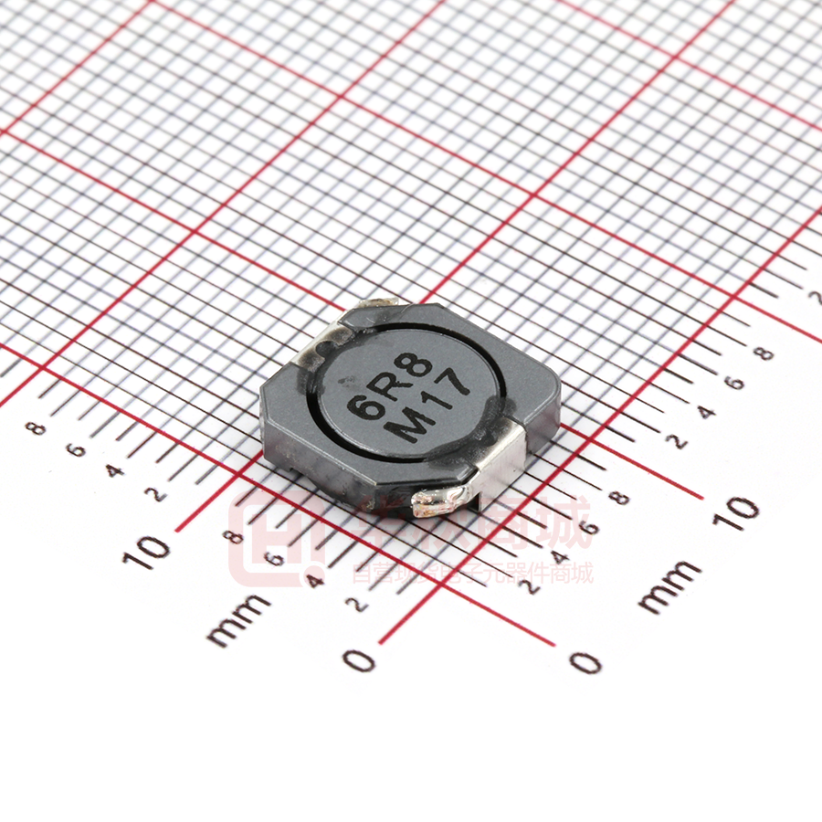

    功率电感 6.8µH ±30% IND_10.2X10MM_SM 2.80mm 10.20 x 10.00mm 35mΩ 3.6A
CDRH103RNP-6R8NC-B 数据手册
SMD Power Inductor CDRH103R Description • Ferrite drum core construction. • Magnetically shielded. • L×W×H:10.5×10.3×3.1mm Max. • Product weight: 1.0g(Ref.) • Moisture Sensitivity Level: 1 • RoHS compliance. RoHS Environmental Data • Operating temperature range: -40℃~+100℃ (including coil’s self temperature rise) • Storage temperature range: -40℃~+100℃ • Solder reflow temperature: 260 ℃ peak. .5 13 X. MA 3.0± 0.1 2.8± 0.3 10.0± 0.3 ELECTRODE 1.2±0.15 7.7±0.3 10.2±0.3 Dimension - [mm] Land pattern and Schematics - [mm] 7.3 Applications • Ideally used in Notebook PC, LCD TV,DVD, Game machine, STB ,Projector etc as DC-DC converter inductors. 1.6 3.2 1.6 Packaging • Carrier tape and reel packaging. •12.9”diameter reel. • 1000pcs per reel. 1 2 0.8μH~15μH 1 2 22μH~150μH Page 1 of 4 Revised: 6-Jan-17 SMD Power Inductor CDRH103R Electrical Characteristics Part Name Stamp Inductance (μH) [ within ] ※1 D.C.R. (mΩ) Max. (Typ.) (at 20℃) Saturation Current (A)※2 Temperature Rise Current (A) ※3 CDRH103RNP-0R8NC-B 0R8 0.8±30% 5.7(4.4) 11.2 8.30 CDRH103RNP-1R5NC-B 1R5 1.5±30% 11.0(8.5) 8.0 5.80 CDRH103RNP-2R2NC-B 2R2 2.2±30% 16.9(13) 6.7 5.10 CDRH103RNP-3R3NC-B 3R3 3.3±30% 21.0(16) 5.56 4.70 CDRH103RNP-4R7NC-B 4R7 4.7±30% 30.0(23) 4.65 4.00 CDRH103RNP-6R8NC-B 6R8 6.8±30% 35.0(27) 3.84 3.60 CDRH103RNP-8R2NC-B 8R2 8.2±30% 50.0(38) 3.54 3.00 CDRH103RNP-100NC-B 100 10±30% 59.0(45) 3.18 2.80 CDRH103RNP-150NC-B 150 15±30% 91.0(70) 2.60 2.05 CDRH103RNP-220NC-B 220 22±30% 143(110) 2.16 1.60 CDRH103RNP-330NC-B 330 33±30% 202(155) 1.74 1.35 CDRH103RNP-470NC-B 470 47±30% 299(230) 1.43 1.20 CDRH103RNP-560NC-B 560 56±30% 325(250) 1.36 1.15 CDRH103RNP-680NC-B 680 68±30% 429(330) 1.22 0.95 CDRH103RNP-820NC-B 820 82±30% 494(380) 1.14 0.80 CDRH103RNP-101NC-B 101 100±30% 683(525) 1.02 0.70 CDRH103RNP-121NC-B 121 120±30% 754(580) 0.89 0.65 CDRH103RNP-151NC-B 151 150±30% 871(670) 0.84 0.51 ※1 Inductance measuring condition: at 100kHz. ※2 The saturation current: This indicates the value of DC current when the inductance decreases to 65% of it's nominal. ※3 The temperature rise: The value of DC current when the temperature rise is △T=40℃ (Ta=20℃). Page 2 of 4 Revised: 6-Jan-17 SMD Power Inductor CDRH103R Saturation Current & Temperature Rise Graph L (20℃) L (μH) △T L (105℃) 1. CDRH103RNP-0R8NC-B △T (℃) L (μH) 2. CDRH103RNP-1R5NC-B △T (℃) L (μH) 3. CDRH103RNP-2R2NC-B △T (℃) 1.2 60 1.8 60 3.0 60 1.0 50 1.5 50 2.5 50 0.8 40 1.2 40 2.0 40 0.6 30 0.9 30 1.5 30 0.4 20 0.6 20 1.0 20 0.2 10 0.3 10 0.5 10 0.0 0 0.0 0 0.0 0 0 L (μH) 3 6 9 12 DC (A) 15 18 0 4. CDRH103RNP-3R3NC-B △T (℃) L (μH) 2 4 6 8 DC (A) 10 12 0 5. CDRH103RNP-4R7NC-B △T (℃) L (μH) 2 4 6 DC (A) 8 10 6. CDRH103RNP-6R8NC-B △T (℃) 4.8 60 6 60 9.0 60 4.0 50 5 50 7.5 50 3.2 40 4 40 6.0 40 2.4 30 3 30 4.5 30 1.6 20 2 20 3.0 20 0.8 10 1 10 1.5 10 0 0 0 0.0 0.0 0 L (μH) 2 4 DC (A) 6 8 0 7. CDRH103RNP-8R2NC-B △T (℃) 1 L (μH) 2 3 4 DC (A) 5 6 0 0 8. CDRH103RNP-100NC-B △T (℃) L (μH) 1 2 3 DC (A) 4 5 9. CDRH103RNP-150NC-B △T (℃) 12 60 12 60 18 60 10 50 10 50 15 50 8 40 8 40 12 40 6 30 6 30 9 30 4 20 4 20 6 20 2 10 2 10 3 10 0 0 0 0 0 0 0 1 2 3 DC (A) 4 5 0 1 2 3 DC (A) 4 0.0 0.6 1.2 1.8 2.4 3.0 3.6 DC (A) 10. CDRH103RNP-220NC-B L (μH ) △T (℃) L ( μH ) 24 60 48 60 60 60 20 50 40 50 50 50 16 40 32 40 40 40 12 30 24 30 30 30 8 20 16 20 20 20 4 10 8 10 10 10 0 0 0 0 0 0.0 0.6 1.2 1.8 DC (A) 2.4 3.0 0.0 11. CDRH103RNP-330NC-B 5 0.6 1.2 1.8 DC (A) Page 3 of 4 △T (℃) 2.4 12. CDRH103RNP-470NC-B L (μH ) △ T (℃) 0 0.0 0.3 0.6 0.9 1.2 1.5 1.8 DC (A) Revised: 6-Jan-17 SMD Power Inductor CDRH103R L (μH ) 13. CDRH103RNP-560NC-B △T (℃) L (μH ) 14. CDRH103RNP-680NC-B △T (℃) L (μH ) 15. CDRH103RNP-820NC-B △ T (℃) 60 60 90 60 120 60 50 50 75 50 100 50 40 40 60 40 80 40 30 30 45 30 60 30 20 20 30 20 40 20 10 10 15 10 20 10 0 0 0 0 0 0.0 L (μH ) 0.4 0.8 DC (A) 1.2 1.6 0.0 16. CDRH103RNP-101NC-B △T (℃) L (μH ) 0.3 0.6 0.9 DC (A) 1.2 17. CDRH103RNP-121NC-B 1.5 0 0.0 △T (℃) L (μH ) 0.3 0.6 0.9 DC (A) 1.2 18. CDRH103RNP-151NC-B 1.5 △ T (℃) 120 60 180 60 180 60 100 50 150 50 150 50 80 40 120 40 120 40 60 30 90 30 90 30 40 20 60 20 60 20 20 10 30 10 30 10 0 0 0 0 0 0 0.0 0.2 0.4 0.6 0.8 1.0 1.2 0.0 0.2 0.4 0.6 0.8 1.0 1.2 0.0 0.2 0.4 0.6 0.8 1.0 1.2 DC (A) DC (A) DC (A) Solder Reflow Condition T (℃) 300 250 Heat Endurance T (℃) 300 250 260℃ 230℃ 200 100 50 0 50 0 60 120 180 240 230℃ 40s 150 60 100 0 245℃ PEAK 200 10 150 Temperature Chart 300 T (s) 170±10 ℃,60~120s 0 60 120 180 240 300 T (s) Please refer to the sales offices on our website - http://www.sumida.com Hong Kong Shanghai Shenzhen Taipei Tel.+852-2880-6781 FAX.+852-2565-9600 sales@hk.sumida.com Tel.+86-21-5836-3299 FAX.+86-21-5836-3266 shanghai.sales@cn.sumida.com Tel.+86-755-8291-0228 FAX.+86-755-8291-0338 shenzhen.sales@cn.sumida.com Tel.+886-2-8751-2737 FAX.+886-2-8751-2738 sales@tw.sumida.com Saitama(Japan) Seoul Singapore San Jose Tel.+81-48-691-7300 FAX.+81-48-691-7340 sales@jp.sumida.com Tel.+82-2-6237-0777 FAX.+82-2-6237-0778 sales@kr.sumida.com Tel.+65-6296-3388 FAX.+65-6841-4426 sales@sg.sumida.com Tel.+1-408-321-9660 FAX.+1-408-321-9308 sales@us.sumida.com Chicago Obernzell Neumarkt Tel.+1-847-545-6700 FAX. +1-847-545-6720 sales@us.sumida.com Tel.+49-8591-937-0 FAX. +49-8591-937-103 contact@eu.sumida.com Tel.+49-9181-4509-110 FAX. +49-9181-4509-310 infocomp@eu.sumida.com Page 4 of 4 Revised: 6-Jan-17
