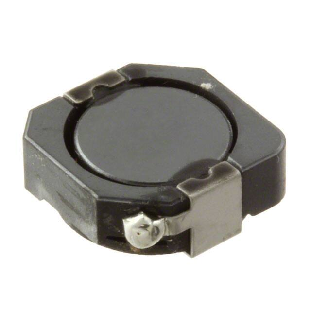

    固定电感器 Nonstandard 22µH ±20% 2.3A 70MΩ
CDRH104RT125NP-220MC 数据手册
SMD Power Inductor CDRH104R/T125 Description • Ferrite drum core construction. • Magnetically shielded. • L W H:10.5 10.3 x4.0 mm Max. • Product weight: 1.5g(Ref.) • Moisture Sensitivity Level: 1 • RoHS compliance. • Halogen Free available. • Qualified to AEC-Q200. Environmental Data • Operating temperature range: -40 ~+125 (including coil’s self temperature rise) • Storage temperature range: -40 +125 • Solder reflow temperature: 260 peak. Packaging • Carrier tape and reel packaging • 13”diameter reel • 1000pcs per reel Applications • Automotive. RoHS Halogen Free Dimension - [mm] Land pattern and Schematics - [mm] 1 . 6 Page 1 of 4 μ ~μ μ ~μ μ ~μ (1.5 H 10 H) (15 H 33 H) (47 H 330 H) Revised: 1-Jun-11 ℃ ℃ ℃ ~℃ ℃ × ×× 7 . 7 ± 0 . 3 1 . 2 ± 0 . 1 5 1.0±0.3 .x aM 5. 3 1 2.0±8.3 edortcelE 1 0 . 2 ± 0 . 3 7 . 3 1 . 6 3.0±0.01 2.3 SMD Power Inductor CDRH104R/T125 Electrical Characteristics Rated current (A) Inductance ( H) W ithin 1 1.5 25% 2.2 25% 3.6 25% 4.7 25% 6.8 25% 10 15 22 33 47 68 20% 20% 20% 20% 20% 20% 20% 20% 20% 20% D.C.R. ( ) [Max.] (at 20 ) 2 9.0m(7.2m) 11.0m(8.8m) 14.0m(11.2m) 19.1m(15.3m) 25.6m(20.5m) 36.8m(29.5m) 48.1m(38.5m) 70.0m(56.0m) 93.8m(75.0m) 136m(109m) 216m(173m) 300m(240m) 448m(358m) 694m(555m) 1.06(850m) CDRH1Ø4RT125NP-2R2PC CDRH1Ø4RT125NP-3R6PC CDRH1Ø4RT125NP-4R7PC CDRH1Ø4RT125NP-6R8PC CDRH1Ø4RT125NP-1ØØMC CDRH1Ø4RT125NP-15ØMC CDRH1Ø4RT125NP-22ØMC CDRH1Ø4RT125NP-33ØMC CDRH1Ø4RT125NP-47ØMC CDRH1Ø4RT125NP-68ØMC CDRH1Ø4RT125NP-1Ø1MC CDRH1Ø4RT125NP-151MC CDRH1Ø4RT125NP-221MC CDRH1Ø4RT125NP-331MC 2R2 3R6 4R7 6R8 100 150 220 330 470 680 101 151 221 331 100 150 220 330 1 Measuring condition: at 100kHz. 2( ) are typical value. 3 Saturation current: The value of D.C. current when the inductance decreases to 65% of it’s nominal value. Page 2 of 4 ℃ = ℃ =△ 4 Temperature rise current: The value of D.C. current when the temperature rise is ± ± ± ± ± ± ± ± ± ± ± ± ± ± ± CDRH1Ø4RT125NP-1R5PC 1R5 9.20 8.00 6.07 5.57 4.66 4.10 3.34 2.56 2.14 1.80 1.57 1.30 1.00 0.85 0.70 7.36 6.16 5.00 4.60 3.94 3.46 2.80 2.18 1.80 1.51 1.32 1.10 0.85 0.72 0.58 t 40 (Ta 20 ). Revised: 1-Jun-11 ※A 7.80 7.10 6.20 5.20 4.40 3.50 2.90 2.30 2.05 1.68 1.25 1.05 0.86 0.68 0.56 ℃ ℃ ※ ] Part No. Stamp (at 20 ) (at 125 ) (Typ.) ℃ ※ Saturation current (A) 3 Ω ※ [ μ Temperature rise current ()4 ※ ※ ※ ※ 8.1 5.1 2.1 9.0 6.0 3.0 0.0 0 01 02 03 04 05 06 0 02 04 06 08 001 021 0 01 02 03 04 05 06 4.2 0.2 6.1 2.1 8.0 4.0 0.0 0 51 03 54 06 57 09 0 01 02 03 04 05 06 4.2 0.2 6.1 2.1 8.0 4.0 0.0 0 01 02 03 04 05 06 0.3 5.2 0.2 5.1 0.1 5.0 0.0 0 01 02 03 04 05 06 9. CDRH104RT125NP-330MC H) T( ) 6.3 0.3 4.2 8.1 2.1 6.0 0.0 0 8 61 42 23 04 L( 0 01 02 03 04 05 06 8. CDRH104RT125NP-220MC H) T( ) 0 5 01 51 02 52 L( 6 0 01 02 03 04 05 06 5 4 3 2 1 0 0 2 4 6 8 01 L( 6 0 01 02 03 04 05 06 5 4 3 2 1 0 0.0 5.1 0.3 5.4 0.6 5.7 L( 0.9 5.7 0.6 5.4 0.3 5.1 0.0 0 01 02 03 04 05 06 4. CDRH104RT125NP-4R7PC H) T( ) 0 1 2 3 4 5 L( 21 0 01 02 03 04 05 06 01 8 6 4 2 0 0.0 8.0 6.1 4.2 2.3 0.4 8.4 L( 21 0 01 02 03 04 05 06 01 8 6 4 2 0 0.0 5.0 0.1 5.1 0.2 5.2 0.3 L( 81 0 01 02 03 04 05 06 51 21 SMD Power Inductor CDRH104R/T125 Saturation Current & Temperature Rise Graph L (20 ) L (125 ) △ ℃ ℃ L( 1. CDRH104RT125NP-1R5PC H) T( ) 2. CDRH104RT125NP-2R2PC H) T( ) T 3. CDRH104RT125NP-3R6PC H) T( ) ℃△ μ ℃△ μ ℃△ DC (A) 5. CDRH104RT125NP-6R8PC H) T( ) DC (A) 6. CDRH104RT125NP-100MC H) T( ) ℃△ μ 21 ℃△ μ 0.9 ℃△ μ 6 9 6 3 0 0.0 3.0 6.0 9.0 2.1 5.1 8.1 μ L( 7. CDRH104RT125NP-150MC H) T( ) ℃△ μ 84 ℃△ μ 03 10. CDRH104RT125NP-470MC L ( H) T( ) 8.4 0.4 2.3 4.2 6.1 8.0 0.0 0 01 02 03 04 05 06 0 3 6 9 21 51 81 ℃△ DC (A) DC (A) 11. CDRH104RT125NP-680MC L ( H) T( ) DC (A) DC (A) 12. CDRH104RT125NP-101MC L ( H) T( ) ℃△ μ ℃△ μ ℃△ DC (A) Page 3 of 4 DC (A) Revised: 1-Jun-11 DC (A) DC (A) DC (A) DC (A) μ μ SMD Power Inductor CDRH104R/T125 DC (A) DC (A) DC (A) Solder Reflow Condition Heat Endurance 052 003 ) ℃( T ℃062 052 003 ) ℃( T Temperature Chart KAEP ℃542 Please refer to the sales offices on our website - http://www.sumida.com Hong Kong Tel.+852-2880-6688 FAX.+852-2565-9600 sales@hk.sumida.com Shanghai Tel.+86-021-5836-3299 FAX.+86-021-5836-3266 shanghai.sales@cn.sumida.com Shenzhen Tel.+86-755-8291-0228 FAX.+86-755-8291-0338 shenzhen.sales@cn.sumida.com Taipei Tel.+886-2-8751-2737 FAX.+886-2-8751-2738 sales@tw.sumida.com Tokyo Tel.+81-3-5202-7112 FAX.+81-3-5202-7105 sales@jp.sumida.com Seoul Tel.+82-2-6237-0777 FAX.+82-2-6237-0778 sales@kr.sumida.com Singapore Tel.+65-6296-3388 FAX.+65-6296-3390 sales@sg.sumida.com San Jose Tel.+1-408-3219660 FAX.+1-408-321-9308 sales@us.sumida.com Chicago Tel.+1-847-545-6700 FAX. +1-847-545-6720 sales@us.sumida.com Obernzell Tel.+49-8591-937-0 FAX. +49-8591-937-103 contact@sumida-eu.com Neumarkt Tel.+49-9181-4509-110 FAX. +49-9181-4509-310 infocomp@eu.sumida.com Page 4 of 4 Revised: 1-Jun-11 )s( T 003 042 081 ℃± 170 10 ,60~120s ℃ 230 06 05 04 03 02 01 0 ℃△ 2.1 0.1 8.0 6.0 4.0 2.0 0.0 s04 μ μ 0 024 053 082 012 041 07 021 06 05 04 03 02 01 0 ℃△ 06 2.1 0.1 8.0 6.0 4.0 2.0 0.0 0 002 051 001 0 05 )s( T ℃032 003 μ μ 0 003 052 002 051 001 05 01 06 042 ℃△ 06 05 04 03 02 01 0 13. CDRH104RT125-151MC L ( H) T( ) L ( H) 14. CDRH104RT125-221MC T( ) L ( H) 15.CDRH104RT125-331MC T( ) 2.1 0.1 8.0 6.0 4.0 2.0 0.0 081 021 06 0 002 051 001 0 05 μ μ 081 051 021 09 06 03 0
