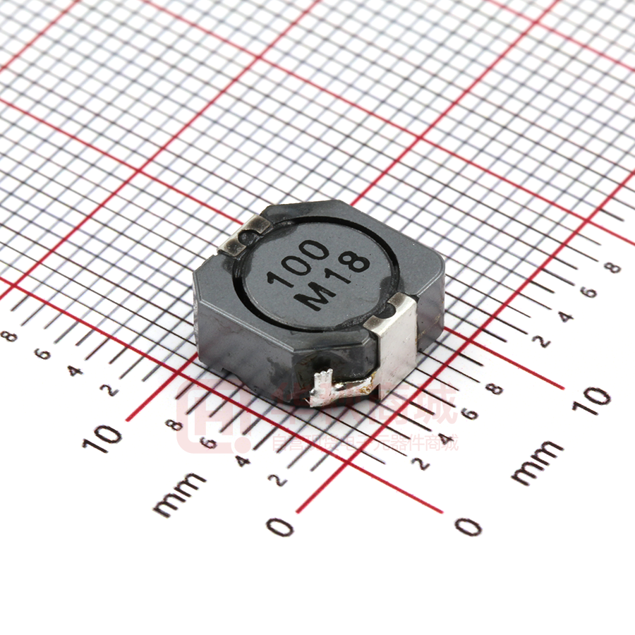

    功率电感 10µH ±30% IND_10.2X10MM_SM 4.80mm 10.20 x 10.00mm 26mΩ 5A
CDRH105RNP-100NC 数据手册
SMD Power Inductor CDRH105R Description • Ferrite drum core construction. • Magnetically shielded. • L×W×H:10.5×10.3×5.1mm Max. • Product weight: 1.8g(Ref.) • Moisture Sensitivity Level: 1 • RoHS compliance. RoHS Environmental Data • Operating temperature range: -40℃~+100℃ (including coil’s self temperature rise) • Storage temperature range: -40℃~+100℃ • Solder reflow temperature: 260 ℃ peak. Dimension - [mm] .5 13 X. MA 4.8± 0.3 10.0± 0.3 ELECTRODE 2 3.0± 0.1 1.2±0.15 7.7±0.3 10.2±0.3 1 Applications • Ideally used in Notebook PC, LCD TV,DVD, Game machine, STB ,Projector etc as DC-DC converter inductors. 1.6 7.3 1.6 Land pattern and Schematics - [mm] Packaging • Carrier tape and reel packaging. • 12.9”diameter reel. • 500pcs per reel. 3.2 1 2 (0.8μH~22μH) 1 2 (27μH~82μH) 1 2 (100μH~1.0mH) Page 1 of 6 Revised: 6-Jan-17 SMD Power Inductor CDRH105R Electrical Characteristics Part Name Stamp Inductance (μH) [ within ] ※1 D.C.R. (mΩ) Max. (Typ.) (at 20℃) Saturation Current ( A )※2 Temperature Rise Current ( A ) ※3 CDRH105RNP-0R8NC 0R8 0.8±30% 4.3 (3.3) 13.5 9.50 CDRH105RNP-1R5NC 1R5 1.5±30% 5.8 (4.5) 10.5 8.30 CDRH105RNP-2R2NC 2R2 2.2±30% 7.2 (5.6) 9.25 7.50 CDRH105RNP-3R3NC 3R3 3.3±30% 10.4 (8.0) 7.80 6.50 CDRH105RNP-4R7NC 4R7 4.7±30% 12.3 (9.5) 6.40 6.10 CDRH105RNP-6R8NC 6R8 6.8±30% 18.0 (14.0) 5.40 5.40 CDRH105RNP-8R2NC 8R2 8.2±30% 20.0 (16.0) 4.85 5.00 CDRH105RNP-100NC 100 10±30% 26.0 (20.0) 4.45 4.50 CDRH105RNP-120NC 120 12±30% 33.0 (25.0) 4.00 3.80 CDRH105RNP-150NC 150 15±30% 41.0 (32.0) 3.60 3.40 CDRH105RNP-180NC 180 18±30% 46.0 (35.0) 3.20 3.10 CDRH105RNP-220NC 220 22±30% 61.0 (47.0) 2.95 2.90 CDRH105RNP-270NC 270 27±30% 69.0 (53.0) 2.70 2.60 CDRH105RNP-330NC 330 33±30% 84.0 (65.0) 2.40 2.50 CDRH105RNP-390NC 390 39±30% 106 (82.0) 2.30 2.25 CDRH105RNP-470NC 470 47±30% 130 (100) 2.00 2.00 CDRH105RNP-560NC 560 56±30% 149 (115) 1.90 1.90 CDRH105RNP-680NC 680 68±30% 201 (155) 1.65 1.60 CDRH105RNP-820NC 820 82±30% 227 (175) 1.50 1.45 CDRH105RNP-101NC 101 100±30% 253 (195) 1.35 1.35 CDRH105RNP-121NC 121 120±30% 303 (233) 1.28 1.18 CDRH105RNP-151NC 151 150±30% 370 (285) 1.12 1.10 CDRH105RNP-181NC 181 180±30% 419 (322) 1.04 1.00 CDRH105RNP-221NC 221 220±30% 500 (385) 0.94 0.94 CDRH105RNP-271NC 271 270±30% 672 (512) 0.84 0.80 CDRH105RNP-331NC 331 330±30% 812 (625) 0.75 0.73 CDRH105RNP-391NC 391 390±30% 953 (733) 0.70 0.70 CDRH105RNP-471NC 471 470±30% 1289 (992) 0.60 0.54 CDRH105RNP-561NC 561 560±30% 1430 (1100) 0.54 0.52 CDRH105RNP-681NC 681 680±30% 1599 (1230) 0.52 0.51 CDRH105RNP-821NC 821 820±30% 1768 (1360) 0.50 0.48 CDRH105RNP-102NC 102 1989 (1530) 0.48 0.42 1000±30% ※1 Inductance measuring condition: at 100kHz. ※2 The saturation current: This indicates the value of DC current when the inductance decreases to 65% of it's nominal. ※3 The temperature rise: The value of DC current when the temperature rise is △T=40℃ (Ta=20℃). Page 2 of 6 Revised: 6-Jan-17 SMD Power Inductor CDRH105R Saturation Current & Temperature Rise Graph L (20℃) L (μH) △T L (100℃) 1. CDRH105RNP-0R8NC △T (℃) L (μH) 2. CDRH105RNP-1R5NC △T (℃) L (μH) 3. CDRH105RNP-2R2NC △T (℃) 1.2 60 1.8 60 3.0 60 1.0 50 1.5 50 2.5 50 0.8 40 1.2 40 2.0 40 0.6 30 0.9 30 1.5 30 0.4 20 0.6 20 1.0 20 0.2 10 0.3 10 0.5 10 0.0 0 0.0 0 0.0 0 0 L (μH) 3 6 9 12 DC (A) 15 4. CDRH105RNP-3R3NC 0 18 △T (℃) L (μH) 3 6 9 DC (A) 12 5. CDRH105RNP-4R7NC 15 0 △T (℃) L (μH) 3 6 9 DC (A) 12 6. CDRH105RNP-6R8NC 15 △T (℃) 4.8 60 6 60 9.0 60 4.0 50 5 50 7.5 50 3.2 40 4 40 6.0 40 2.4 30 3 30 4.5 30 1.6 20 2 20 3.0 20 0.8 10 1 10 1.5 10 0 0 0 0.0 0.0 0 L (μH) 2 4 6 DC (A) 8 7. CDRH105RNP-8R2NC 10 0 △T (℃) L (μH) 2 4 DC (A) 6 0 0 8 8. CDRH105RNP-100NC △T (℃) L (μH) 2 4 DC (A) 6 8 9. CDRH105RNP-120NC △T (℃) 12 60 12 60 18 60 10 50 10 50 15 50 8 40 8 40 12 40 6 30 6 30 9 30 4 20 4 20 6 20 2 10 2 10 3 10 0 0 0 0 0 0 0 L (μH ) 2 4 DC (A) 6 8 10. CDRH105RNP-150NC 0 △T (℃) L ( μH ) 1 2 3 4 DC (A) 5 11. CDRH105RNP-180NC 6 0 △T (℃) L (μH ) 1 2 3 DC (A) 4 12. CDRH105RNP-220NC 5 △ T (℃) 18 60 24 60 24 60 15 50 20 50 20 50 12 40 16 40 16 40 9 30 12 30 12 30 6 20 8 20 8 20 3 10 4 10 4 10 0 0 0 0 0 0 0 1 2 3 DC (A) 4 5 0 1 2 3 DC (A) Page 3 of 6 4 5 0 1 2 DC (A) 3 Revised: 6-Jan-17 4 SMD Power Inductor CDRH105R Saturation Current & Temperature Rise Graph L (20℃) L (μH) △T L (100℃) 13. CDRH105RNP-270NC △T (℃) L (μH) 14. CDRH105RNP-330NC △T (℃) 15. CDRH105RNP-390NC L (μH) △T (℃) 36 60 48 60 48 60 30 50 40 50 40 50 24 40 32 40 32 40 18 30 24 30 24 30 12 20 16 20 16 20 6 10 8 10 8 10 0 0 0 0 0 0.0 0.6 1.2 1.8 2.4 3.0 3.6 DC (A) L (μH) 16. CDRH105RNP-470NC 0.0 △T (℃) L (μH) 0.8 1.6 2.4 DC (A) 17. CDRH105RNP-560NC 0 0.0 3.2 △T (℃) 0.6 1.2 1.8 DC (A) 2.4 18. CDRH105RNP-680NC L (μH) 3.0 △T (℃) 60 60 90 60 90 60 50 50 75 50 75 50 40 40 60 40 60 40 30 30 45 30 45 30 20 20 30 20 30 20 10 10 15 10 15 10 0 0 0 0 0 0.0 L (μH) 0.5 1.0 1.5 DC (A) 2.0 19. CDRH105RNP-820NC 2.5 0.0 △T (℃) L (μH) 0.5 1.0 1.5 DC (A) 2.0 20. CDRH105RNP-101NC 2.5 0 0.0 △T (℃) L (μH) 0.4 0.8 1.2 DC (A) 1.6 21. CDRH105RNP-121NC 2.0 △T (℃) 120 60 120 60 180 60 100 50 100 50 150 50 80 40 80 40 120 40 60 30 60 30 90 30 40 20 40 20 60 20 20 10 20 10 30 10 0 0 0 0 0 0.0 0.3 0.6 0.9 1.2 1.5 1.8 DC (A) L (μH ) 22. CDRH105RNP-151NC 0.0 △T (℃) L ( μH ) 0.4 0.8 DC (A) 1.2 23. CDRH105RNP-181NC 1.6 0 0.0 △T (℃) L (μH ) 0.4 0.8 1.2 DC (A) 24. CDRH105RNP-221NC 1.6 △ T (℃) 180 60 240 60 300 60 150 50 200 50 250 50 120 40 160 40 200 40 90 30 120 30 150 30 60 20 80 20 100 20 30 10 40 10 50 10 0 0 0 0 0 0 0.0 0.3 0.6 0.9 DC (A) 1.2 1.5 0.0 0.3 0.6 0.9 DC (A) Page 4 of 6 1.2 1.5 0.0 0.2 0.4 0.6 0.8 1.0 1.2 DC (A) Revised: 6-Jan-17 SMD Power Inductor CDRH105R Saturation Current & Temperature Rise Graph L (20℃) 25. CDRH105RNP-271NC L (μH) △T L (100℃) △T (℃) 26. CDRH105RNP-331NC L (μH) △T (℃) L (μH) 27. CDRH105RNP-391NC △T (℃) 360 60 480 60 480 60 300 50 400 50 400 50 240 40 320 40 320 40 180 30 240 30 240 30 120 20 160 20 160 20 60 10 80 10 80 10 0 0 0 0 0 0.0 L (μH) 0.2 0.4 0.6 DC (A) 0.8 28. CDRH105RNP-471NC 1.0 0.0 △T (℃) 0.2 0.4 0.6 DC (A) 0.8 29. CDRH105RNP-561NC L (μH) 0 0.0 1.0 △T (℃) L (μH) 0.2 0.4 0.6 DC (A) 0.8 30. CDRH105RNP-681NC 1.0 △T (℃) 600 60 900 60 900 60 500 50 750 50 750 50 400 40 600 40 600 40 300 30 450 30 450 30 200 20 300 20 300 20 100 10 150 10 150 10 0 0 0.0 L (μH) 0.2 0.4 DC (A) 0.6 31. CDRH105RNP-821NC 0.8 0 0 0.0 △T (℃) L (μH) 0.2 0.4 DC (A) 0.6 32. CDRH105RNP-102NC 0.8 1200 60 1000 50 1000 50 800 40 800 40 600 30 600 30 400 20 400 20 200 10 200 10 0 0.2 0.4 DC (A) 0.6 △T (℃) 60 0.0 0.1 0.2 0.3 0.4 0.5 0.6 DC (A) 0 0.0 1200 0 0 0 0 0.0 0.1 0.2 0.3 0.4 0.5 0.6 DC (A) Page 5 of 6 Revised: 6-Jan-17 0.8 SMD Power Inductor CDRH105R Solder Reflow Condition T (℃) 300 250 Heat Endurance T (℃) 300 250 260℃ 230℃ 200 100 50 0 50 0 60 120 180 240 230℃ 40s 150 60 100 0 245℃ PEAK 200 10 150 Temperature Chart 300 T (s) 170±10 ℃,60~120s 0 60 120 180 240 300 T (s) Please refer to the sales offices on our website - http://www.sumida.com Hong Kong Shanghai Shenzhen Taipei Tel.+852-2880-6781 FAX.+852-2565-9600 sales@hk.sumida.com Tel.+86-21-5836-3299 FAX.+86-21-5836-3266 shanghai.sales@cn.sumida.com Tel.+86-755-8291-0228 FAX.+86-755-8291-0338 shenzhen.sales@cn.sumida.com Tel.+886-2-8751-2737 FAX.+886-2-8751-2738 sales@tw.sumida.com Saitama(Japan) Seoul Singapore San Jose Tel.+81-48-691-7300 FAX.+81-48-691-7340 sales@jp.sumida.com Tel.+82-2-6237-0777 FAX.+82-2-6237-0778 sales@kr.sumida.com Tel.+65-6296-3388 FAX.+65-6841-4426 sales@sg.sumida.com Tel.+1-408-321-9660 FAX.+1-408-321-9308 sales@us.sumida.com Chicago Obernzell Neumarkt Tel.+1-847-545-6700 FAX. +1-847-545-6720 sales@us.sumida.com Tel.+49-8591-937-0 FAX. +49-8591-937-103 contact@eu.sumida.com Tel.+49-9181-4509-110 FAX. +49-9181-4509-310 infocomp@eu.sumida.com Page 6 of 6 Revised: 6-Jan-17
