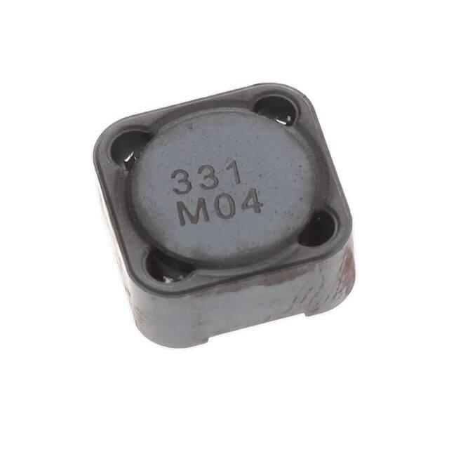

    330 µH 屏蔽 电感器 900 mA 674 毫欧最大 非标准
CDRH125L125NP-331MC 数据手册
SMD Power Inductor CDRH125/L125 Description • Ferrite drum core construction. • Magnetically shielded. • L W H: 12.3 12.3 x6.0 mm Max. • Product weight: 3.0g(Ref.) • Moisture Sensitivity Level: 1 • RoHS compliance. • Halogen Free available. • Qualified to AEC-Q200. Environmental Data • Operating temperature range: -40 ~+125 (including coil’s self temperature rise) • Storage temperature range: -40 +125 • Solder reflow temperature: 260 peak. Packaging • Carrier tape and reel packaging • 13.0”diameter reel • 500pcs per reel Applications • Automotive. 1 2 . 8 7 . 0 RoHS Halogen Free Dimension - [mm] 0.5 2.0 Land pattern and Schematics - [mm] 4.5 μ ~μ (1.2 H 47 H) ~μ (68 H 1.0mH) Page 1 of 5 Revised: 1-Jun-11 ℃ ℃ ℃ ~℃ ℃ × ×× 7 . 6 .g n i tn i rp t si s e r r e dl o s f o tr a P edortcelE .xaM 0.6 . 52 1 L/ 5 2 1H R D C f o n o is n e mi D 1 2 . 0 ± 0 . 3 3.0±0.21 2 . 9 SMD Power Inductor CDRH125/L125 Electrical Characteristics Inductance ( H) 1 D.C.R.( ) Max.(Typ.) (at 20 ) 8.5m(6.8m) 10.6m(8.5m) 12.8m(10.2m) 15.0m(12.0m) 17.5m(14.0m) 20.0m(16.0m) 25.0m(20.0m) 33.8m(27.0m) 39.5m(31.5m) 59.0m(47.0m) 93.0m(74.0m) 131m(105m) 166m(133m) 271m(217m) 394m(315m) 674m(539m) 858m(686m) 1.22(1.02) 1.90(1.58) Saturation Current (A) 2 Temperature Rise Current (A) 3 9.00 8.00 7.40 6.80 6.50 5.90 5.30 4.50 3.70 3.00 2.42 2.05 1.82 1.40 1.15 0.90 0.81 0.65 0.50 Part Name Stamp 1. Measuring condition: at 100kHz. 2. Saturation current: The value of D.C. current when the inductance decreases to 65% of it’s nominal value. Page 2 of 5 Revised: 1-Jun-11 ℃ = ℃ =△ 3. Temperature rise current: The value of D.C. current when the temperature rise is ± CDRH125L125NP-102MC 102 1000 20% ± CDRH125L125NP-681MC 681 680 20% ± CDRH125L125NP-471MC 471 470 20% ± CDRH125L125NP-331MC 331 330 20% ± CDRH125L125NP-221MC 221 220 20% ± CDRH125L125NP-151MC 151 150 20% ± CDRH125L125NP-101MC 101 100 20% ± CDRH125L125NP-680MC 680 68 20% ± CDRH125L125NP-470MC 470 47 20% ± CDRH125L125NP-330MC 330 33 20% ± CDRH125L125NP-220MC 220 22 20% ± CDRH125L125NP-150MC 150 15 20% ± CDRH125L125NP-100MC 100 10 20% ± CDRH125L125NP-6R8NC 6R8 6.8 30% ± CDRH125L125NP-5R1NC 5R1 5.1 30% ± CDRH125L125NP-3R9NC 3R9 3.9 30% ± CDRH125L125NP-2R7NC 2R7 2.7 30% ± CDRH125L125NP-1R8NC 1R8 1.8 30% ± CDRH125L125NP-1R2NC 1R2 1.2 30% 14.20 12.60 10.20 8.20 7.20 6.20 5.20 4.40 3.50 2.93 2.44 2.02 1.70 1.36 1.12 0.90 0.75 0.62 0.52 11.60 10.10 8.20 6.70 5.90 4.90 4.10 3.50 2.81 2.38 2.00 1.65 1.37 1.11 0.90 0.73 0.61 0.50 0.42 t 40 (Ta 20 ). ℃ ℃ at 20 at 125 ※ ※ Ω ℃ ※ μ ※ ※ ※ 4.2 0 01 02 03 04 05 06 0.2 6.1 2.1 8.0 4.0 0.0 0 51 03 54 06 57 0 01 02 03 04 05 06 0.3 5 .2 0. 2 5. 1 0. 1 5 .0 0 .0 0 01 02 03 04 05 0 01 02 03 04 05 06 6. 3 0.3 4 .2 8.4 0 01 02 03 04 05 0 ℃6 △ 0.4 2.3 4.2 6.1 8.0 0.0 0 4 8 21 61 02 6 0 01 02 03 04 05 06 5 4 3 2 1 0 0 3 6 9 21 51 0 01 02 03 04 05 06 0 .9 5 .7 0 .6 5. 4 0. 3 5. 1 0.0 0 2 4 6 8 01 0.9 0 01 02 03 04 05 06 5. 7 0 .6 5 .4 0. 3 5 .1 0.0 0. 0 5. 1 0. 3 5. 4 0. 6 5. 7 0 01 02 03 04 05 06 0 .9 5 .7 0. 6 5.4 0.3 5 .1 0 .0 0 1 2 3 4 5 0 01 02 03 04 05 06 21 01 8 6 4 2 0 0. 0 8. 0 6. 1 4. 2 2. 3 0. 4 21 0 01 02 03 04 05 01 8 6 4 2 0 0 .0 5 .0 0 .1 5 .1 0 .2 5 .2 0 . 5 1 5. 2 1 0 .0 1 0 01 02 03 04 05 0 ℃6 △ 5.7 0. 5 5 .2 0.0 0.0 4.0 8.0 2.1 6.1 0.2 81 0 01 02 03 04 05 06 SMD Power Inductor CDRH125/L125 Saturation Current & Temperature Rise Graph L (20 ) L (125 ) △ ℃ 1. CDRH125L125NP-1R2NC 2. CDRH125L125NP-1R8NC H) T( ) T L( H) 3. CDRH125L125NP-2R7NC ℃06 △ μ 0 .3 ℃ L( H) μ 4.2 ℃ △ T( ) L( 4. CDRH125L125NP-3R9NC 51 21 DC (A) 5. CDRH125L125NP-5R1NC H) T( ) DC (A) L( 6. CDRH125L125NP-6R8NC H) T( ) ℃△ μ 0. 9 L( ℃△ μ6 9 6 3 0 0.0 3.0 6.0 9.0 2.1 5.1 μ 8.1 L( H) ℃△ μ8.4 L( H) 7. CDRH125L125NP-100MC DC (A) T( ) T( ) L( 8. CDRH125L125NP-150MC H) DC (A) T( ) μ 42 L( ℃△ μ 81 ℃△ μ 21 L( 10. CDRH125L125NP-330MC H) T( ) DC (A) L( 11. CDRH125L125NP-470MC H) T( ) DC (A) L( H) 12. CDRH125L125NP-680MC H) T( ) ℃△ μ 09 ℃△ μ 06 ℃△ DC (A) 8. 1 Page 3 of 5 DC (A) 2.1 6 .0 0. 0 0 6 21 81 42 03 9. CDRH125L125NP-220MC Revised: 1-Jun-11 DC (A) DC (A) DC (A) DC (A) T( ) T( ) μ 63 6 .0 0 01 02 03 04 05 06 5 .0 4. 0 3. 0 0 9. 0 0 01 02 03 04 05 06 5 7. 0 06 .0 5 4. 0 03 .0 51 . 0 0 0. 0 0 051 003 054 006 057 2. 1 0 01 02 03 04 05 0.1 8 .0 6. 0 4.0 2 .0 0. 0 0 001 002 003 004 005 0 01 02 03 04 05 06 2.1 0.1 8.0 6.0 4.0 2.0 0.0 0 06 021 081 042 003 8.1 0 01 02 03 04 05 06 5.1 2.1 9.0 6.0 3.0 8 .1 0 01 02 03 04 05 5 .1 2 .1 9. 0 6 .0 3 .0 0.0 0 04 08 021 061 002 0 .0 0 03 06 09 02 1 05 1 4.2 0 01 02 03 04 05 06 0.2 6.1 2.1 8.0 4.0 0.0 0 02 04 06 08 001 SMD Power Inductor CDRH125/L125 L (20 ) L (125 ) △ ℃ 13. CDRH125L125NP-101MC 14. CDRH125L125NP-151MC T L( H) 15. CDRH125L125NP-221MC ℃△ 0 μ42 06℃ △ L( μ081 ℃ L( H) ℃△ μ021 L( H) 16. CDRH125L125NP-331MC DC (A) T( ) T( ) L( H) H) 17. CDRH125L125NP-471MC μ009 06℃ △ T( ) L( DC (A) T( ) H) 18. CDRH125L125NP-681MC ℃△ μ006 ℃△ μ063 L( H) 19. CDRH125L125NP102MC ℃△ DC (A) DC (A) T( ) DC (A) Page 4 of 5 2. 0 1.0 0 .0 0 00 2 00 4 00 6 00 8 00 01 00 μ21 Revised: 1-Jun-11 DC (A) DC (A) T( ) T( ) SMD Power Inductor CDRH125/L125 Solder Reflow Condition Heat Endurance 052 003 ) ℃( T ℃062 052 003 ) ℃( T Temperature Chart KAEP ℃542 Please refer to the sales offices on our website - http://www.sumida.com Hong Kong Tel.+852-2880-6688 FAX.+852-2565-9600 sales@hk.sumida.com Shanghai Tel.+86-021-5836-3299 FAX.+86-021-5836-3266 shanghai.sales@cn.sumida.com Shenzhen Tel.+86-755-8291-0228 FAX.+86-755-8291-0338 shenzhen.sales@cn.sumida.com Taipei Tel.+886-2-8751-2737 FAX.+886-2-8751-2738 sales@tw.sumida.com Tokyo Tel.+81-3-5202-7112 FAX.+81-3-5202-7105 sales@jp.sumida.com Seoul Tel.+82-2-6237-0777 FAX.+82-2-6237-0778 sales@kr.sumida.com Singapore Tel.+65-6296-3388 FAX.+65-6296-3390 sales@sg.sumida.com San Jose Tel.+1-408-3219660 FAX.+1-408-321-9308 sales@us.sumida.com Chicago Tel.+1-847-545-6700 FAX. +1-847-545-6720 sales@us.sumida.com Obernzell Tel.+49-8591-937-0 FAX. +49-8591-937-103 contact@sumida-eu.com Neumarkt Tel.+49-9181-4509-110 FAX. +49-9181-4509-310 infocomp@eu.sumida.com Page 5 of 5 Revised: 1-Jun-11 )s( T 003 042 081 ℃± 021 170 10 ,60~120s ℃ s04 06 0 002 051 001 0 05 )s( T 003 ℃032 01 06 042 081 021 06 230 0 002 051 001 0 05
