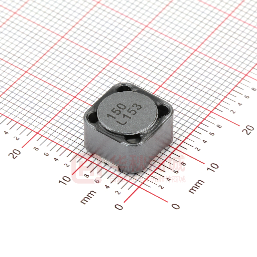

SMD Power Inductor CDRH127/LD Description • Ferrite drum core construction. • Magnetically shielded. • L×W×H: 12.3×12.3×8.0 mm Max. • Product weight: 3.6g(Ref.) • Moisture Sensitivity Level: 1 • RoHS compliance. RoHS Dimension - [mm] 7.6 12.0±0.3 12.0± 0.3 MAX.8.0 12.0±0.2 5.0±0.2 0.2 ELECTRODE TERMINAL 12.8 2.9 5.4 7.0 Packaging • Carrier tape and reel packaging • 13”diameter reel • 500pcs per reel Applications • Ideally used in Notebook PC, LCD TV,DVD, Game machine, STB ,Projector etc as DC-DC converter inductors. Land pattern and Schematics - [mm] DIMENSION OF CDRH127/LD Environmental Data • Operating temperature range: -40℃~+100℃ (including coil’s self temperature rise) • Storage temperature range: -40℃~+100℃ • Solder reflow temperature: 260 ℃ peak. PART OF SILK SCREEN 1.0μ H 2.4μ H~ 56μ H 68μ H~ 150μ H 180μ H~ 1 mH Page 1 of 6 Revised: 6-Jan-17 SMD Power Inductor CDRH127/LD Electrical Characteristics Part Name Stamp Inductance (μH) [ within ] ※1 D.C.R.(Ω) Max. (Typ.) (at 20℃) Rated Current (A) ※2 CDRH127/LDNP-1R0NC 1R0 1.0±30% 6.5m(5.0m) 14.0 CDRH127/LDNP-2R4NC 2R4 2.4±30% 10.5m(8.1m) 10.3 CDRH127/LDNP-3R5NC 3R5 3.5±30% 12.4m(9.5m) 9.30 CDRH127/LDNP-4R6NC 4R6 4.6±30% 13.8m(10.6m) 9.10 CDRH127/LDNP-5R8NC 5R8 5.8±30% 16.2m(12.4m) 8.60 CDRH127/LDNP-7R4NC 7R4 7.4±30% 17.7m(13.6m) 7.40 CDRH127/LDNP-100MC 100 10±20% 19.5m(15.0m) 6.70 CDRH127/LDNP-120MC 120 12±20% 21.3m(16.4m) 6.45 CDRH127/LDNP-150MC 150 15±20% 26.4m(20.3m) 5.65 CDRH127/LDNP-180MC 180 18±20% 28.0m(21.5m) 5.10 CDRH127/LDNP-220MC 220 22±20% 36.4m(28.0m) 4.70 CDRH127/LDNP-270MC 270 27±20% 41.6m(32.0m) 4.20 CDRH127/LDNP-330MC 330 33±20% 53.3m(41.0m) 3.90 CDRH127/LDNP-390MC 390 39±20% 60.5m(46.5m) 3.50 CDRH127/LDNP-470MC 470 47±20% 78.0m(60.0m) 3.25 CDRH127/LDNP-560MC 560 56±20% 90.0m(69.0m) 2.90 CDRH127/LDNP-680MC 680 68±20% 120m(92.0m) 2.60 CDRH127/LDNP-820MC 820 82±20% 119m(91.0m) 2.40 CDRH127/LDNP-101MC 101 100±20% 151m (119m) 2.10 CDRH127/LDNP-121MC 121 120±20% 169m (130m) 1.90 CDRH127/LDNP-151MC 151 150±20% 227m (174m) 1.80 CDRH127/LDNP-181MC 181 180±20% 299m (230m) 1.55 CDRH127/LDNP-221MC 221 220±20% 338m (260m) 1.45 CDRH127/LDNP-271MC 271 270±20% 419m (322m) 1.30 CDRH127/LDNP-331MC 331 330±20% 471m (362m) 1.20 CDRH127/LDNP-391MC 391 390±20% 572m (440m) 1.10 CDRH127/LDNP-471MC 471 470±20% 741m (570m) 1.00 CDRH127/LDNP-561MC 561 560±20% 852m (655m) 0.95 CDRH127/LDNP-681MC 681 680±20% 1.13 (870m) 0.85 CDRH127/LDNP-821MC 821 820±20% 1.24 (950m) 0.75 CDRH127/LDNP-102MC 102 1000±20% 1.50 (1.15) 0.70 ※1. Inductance Measuring condition: at 100 kHz. ※2. Rated current: The DC current at which the inductance decreases to 75% of its nominal value or when △t=40℃, whichever is lower . Page 2 of 6 Revised: 6-Jan-17 SMD Power Inductor CDRH127/LD Saturation Current & Temperature Rise Graph L (20℃) L (μH) △T L (100℃) 1. CDRH127/LDNP-1R0NC △T (℃) L (μH) 2. CDRH127/LDNP-2R4NC △T (℃) L (μH) 3. CDRH127/LDNP-3R5NC △T (℃) 1.8 60 3.6 60 4.8 60 1.5 50 3.0 50 4.0 50 1.2 40 2.4 40 3.2 40 0.9 30 1.8 30 2.4 30 0.6 20 1.2 20 1.6 20 0.3 10 0.6 10 0.8 10 0.0 0 0.0 0 0.0 0 0 L (μH) 5 10 15 20 DC (A) 25 4. CDRH127/LDNP-4R6NC 30 0 △T (℃) L (μH) 4 8 12 DC (A) 16 5. CDRH127/LDNP-5R8NC 20 0 △T (℃) L (μH) 4 8 DC (A) 12 16 6. CDRH127/LDNP-7R4NC △T (℃) 6 60 9.0 60 9.0 60 5 50 7.5 50 7.5 50 4 40 6.0 40 6.0 40 3 30 4.5 30 4.5 30 2 20 3.0 20 3.0 20 1 10 1.5 10 1.5 10 0 0.0 0 0.0 0 0 3 L (μH) 6 9 DC (A) 12 7. CDRH127/LDNP-100MC 15 0 △T (℃) L (μH) 3 6 9 DC (A) 12 8. CDRH127/LDNP-120MC 0 15 0 △T (℃) L (μH) 2 4 6 8 DC (A) 10 9. CDRH127/LDNP-150MC 12 △T (℃) 12 60 18 60 18 60 10 50 15 50 15 50 8 40 12 40 12 40 6 30 9 30 9 30 4 20 6 20 6 20 2 10 3 10 3 10 0 0 0 0 0 0 L (μH) 2 4 6 DC (A) 8 10. CDRH127/LDNP-180MC 10 0 △T (℃) L (μH) 2 4 DC (A) 6 11. CDRH127/LDNP-220MC 8 0 0 △T (℃) L (μH) 2 4 DC (A) 6 8 12. CDRH127/LDNP-270MC △T (℃) 24 60 24 60 30 60 20 50 20 50 25 50 16 40 16 40 20 40 12 30 12 30 15 30 8 20 8 20 10 20 4 10 4 10 5 10 0 0 0 0 0 0 2 4 DC (A) 6 8 0 2 4 DC (A) Page 3 of 6 6 8 0 0 1 2 3 4 DC (A) 5 Revised: 6-Jan-17 6 SMD Power Inductor CDRH127/LD Saturation Current & Temperature Rise Graph L (20℃) L (μH) △T L (100℃) 13. CDRH127/LDNP-330MC △T (℃) L (μH) 14. CDRH127/LDNP-390MC △T (℃) L (μH) 15. CDRH127/LDNP-470MC △T (℃) 36 60 48 60 48 60 30 50 40 50 40 50 24 40 32 40 32 40 18 30 24 30 24 30 12 20 16 20 16 20 6 10 8 10 8 10 0 0 0 0 0 0 0 L (μH) 1 2 3 4 DC (A) 5 16. CDRH127/LDNP-560MC 6 0 △T (℃) L (μH) 1 2 3 DC (A) 4 17. CDRH127/LDNP-680MC 5 0 △T (℃) L (μH) 1 2 3 DC (A) 4 18. CDRH127/LDNP-820MC 5 △T (℃) 60 60 90 60 90 60 50 50 75 50 75 50 40 40 60 40 60 40 30 30 45 30 45 30 20 20 30 20 30 20 10 10 15 10 15 10 0 0 0 0 0 0 L (μH) 1 2 DC (A) 3 19. CDRH127/LDNP-101MC 4 0 △T (℃) L (μH) 1 2 DC (A) 3 20. CDRH127/LDNP-121MC 4 0 0.0 △T (℃) L (μH) 0.8 1.6 2.4 DC (A) 21. CDRH127/LDNP-151MC 3.2 △T (℃) 120 60 180 60 180 60 100 50 150 50 150 50 80 40 120 40 120 40 60 30 90 30 90 30 40 20 60 20 60 20 20 10 30 10 30 10 0 0 0 0 0 0.0 L (μH) 0.8 1.6 DC (A) 2.4 22. CDRH127/LDNP-181MC 3.2 0.0 0.5 1.0 1.5 2.0 2.5 3.0 DC (A) △T (℃) L (μH) 23. CDRH127/LDNP-221MC 0 0.0 0.5 1.0 1.5 2.0 2.5 3.0 DC (A) △T (℃) L (μH) 24. CDRH127/LDNP-271MC △T (℃) 240 60 300 60 300 60 200 50 250 50 250 50 160 40 200 40 200 40 120 30 150 30 150 30 80 20 100 20 100 20 40 10 50 10 50 10 0 0 0 0 0 0.0 0.4 0.8 1.2 1.6 2.0 2.4 DC (A) 0.0 0.6 1.2 DC (A) Page 4 of 6 1.8 2.4 0 0.0 0.3 0.6 0.9 1.2 1.5 1.8 DC (A) Revised: 6-Jan-17 SMD Power Inductor CDRH127/LD Saturation Current & Temperature Rise Graph L (20℃) L (μH) △T L (100℃) 25. CDRH127/LDNP-331MC △T (℃) L (μH) 26. CDRH127/LDNP-391MC △T (℃) L (μH) 27. CDRH127/LDNP-471MC △T (℃) 360 60 480 60 600 60 300 50 400 50 500 50 240 40 320 40 400 40 180 30 240 30 300 30 120 20 160 20 200 20 60 10 80 10 100 10 0 0 0 0.0 L (μH) 0.4 0.8 DC (A) 1.2 1.6 28. CDRH127/LDNP-561MC 0 0.0 △T (℃) L (μH) 0.4 0.8 DC (A) 1.2 29. CDRH127/LDNP-681MC 0 1.6 0 0.0 △T (℃) L (μH) 0.3 0.6 0.9 DC (A) 1.2 30. CDRH127/LDNP-821MC 1.5 △T (℃) 600 60 900 60 900 60 500 50 750 50 750 50 400 40 600 40 600 40 300 30 450 30 450 30 200 20 300 20 300 20 100 10 150 10 150 10 0 0 0.0 0.2 0.4 0.6 0.8 1.0 1.2 DC (A) L (μH) 31. CDRH127/LDNP-102MC 0 0 0.0 0.2 0.4 0.6 0.8 1.0 1.2 DC (A) 0 0 0.0 0.2 0.4 0.6 DC (A) 0.8 △T (℃) 1200 60 1000 50 800 40 600 30 400 20 200 10 0 0 0.0 0.2 0.4 0.6 DC (A) 0.8 1.0 Page 5 of 6 Revised: 6-Jan-17 1.0 SMD Power Inductor CDRH127/LD Solder Reflow Condition T (℃) 300 250 Heat Endurance T (℃) 300 250 260℃ 230℃ 200 100 50 0 50 0 60 120 180 240 230℃ 40s 150 60 100 0 245℃ PEAK 200 10 150 Temperature Chart 300 T (s) 170±10 ℃,60~120s 0 60 120 180 240 300 T (s) Please refer to the sales offices on our website - http://www.sumida.com Hong Kong Shanghai Shenzhen Taipei Tel.+852-2880-6781 FAX.+852-2565-9600 sales@hk.sumida.com Tel.+86-21-5836-3299 FAX.+86-21-5836-3266 shanghai.sales@cn.sumida.com Tel.+86-755-8291-0228 FAX.+86-755-8291-0338 shenzhen.sales@cn.sumida.com Tel.+886-2-8751-2737 FAX.+886-2-8751-2738 sales@tw.sumida.com Saitama(Japan) Seoul Singapore San Jose Tel.+81-48-691-7300 FAX.+81-48-691-7340 sales@jp.sumida.com Tel.+82-2-6237-0777 FAX.+82-2-6237-0778 sales@kr.sumida.com Tel.+65-6296-3388 FAX.+65-6841-4426 sales@sg.sumida.com Tel.+1-408-321-9660 FAX.+1-408-321-9308 sales@us.sumida.com Chicago Obernzell Neumarkt Tel.+1-847-545-6700 FAX. +1-847-545-6720 sales@us.sumida.com Tel.+49-8591-937-0 FAX. +49-8591-937-103 contact@eu.sumida.com Tel.+49-9181-4509-110 FAX. +49-9181-4509-310 infocomp@eu.sumida.com Page 6 of 6 Revised: 6-Jan-17

物料型号:CDRH127/LD
器件简介: - 采用铁氧体鼓芯构造,具有磁屏蔽功能。 - 尺寸为12.3×12.3×8.0 mm,重量约3.6克。 - 湿度敏感度等级为1,符合RoHS标准。
引脚分配:文档中未明确提供引脚分配信息。
参数特性: - 工作温度范围:-40℃至+100℃(包括线圈自身温升)。 - 存储温度范围:-40℃至+100℃。 - 焊接回流温度:260℃峰值。 - 包装:采用载带和卷轴包装,每卷500件。
功能详解: - 适用于笔记本电脑、液晶电视、DVD播放器、游戏机、机顶盒、投影仪等作为DC-DC转换器电感。
应用信息: - 电感值范围从1.0μH至1mH。
封装信息: - 尺寸图和封装规格在文档中有详细说明。
