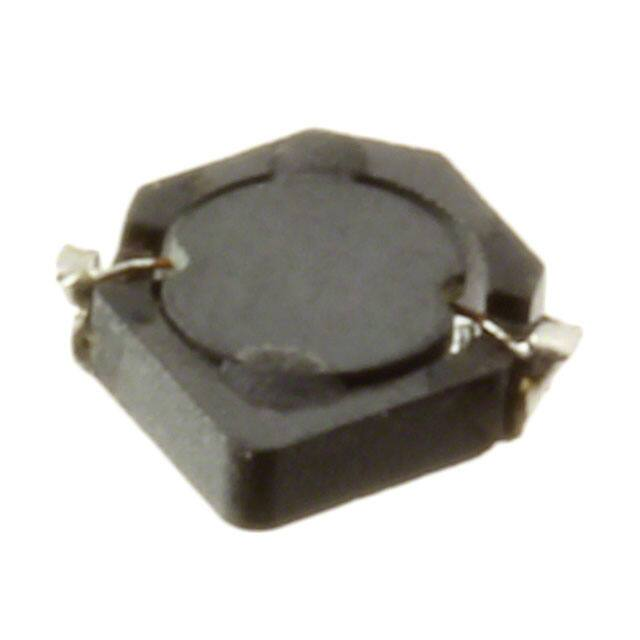

    固定电感器 Nonstandard 4.7µH ±25% 640mA 220mΩ
CDRH2D09NP-4R7MC 数据手册
SMD Power Inductor CDRH2D09 Description • Ferrite drum core construction. • Magnetically shielded. • L×W×H:3.2×3.2×1.0 mm Max. • Product weight: 28mg(Ref.) • Moisture Sensitivity Level: 1 • RoHS compliance. RoHS Environmental Data • Operating temperature range: -40℃~+105℃ (including coil’s self temperature rise) • Storage temperature range: -40℃~+105℃ • Solder reflow temperature: 260 ℃ peak. Dimension - [mm] E) ※3.0±0.2 1 2( 2. 0. φ 0. 7 ※3.0±0.2 3. 3± 0 EL E 1. CT R OD MAX.1.0 1 Applications • Ideally used in Mobilephone,PDA,MP3, DSC/DVC, etc as DC-DC converter inductors. 7 1. 3 4. 1. 3 Land pattern and Schematics - [mm] Packaging • Carrier tape and reel packaging • 7.0”diameter reel • 1500pcs per reel 3 1. 2 Page 1 of 4 Revised: 6-Jan-17 SMD Power Inductor CDRH2D09 Electrical Characteristics Part Name Stamp Saturation Current (A)※2 Inductance (μH) [ within ] ※1 D.C.R .(mΩ) [ within ] (at 20℃) at 20℃ at 100℃ Temperature Rise Current (A) ※3 CDRH2D09NP-1R2MC A 1.2±25% 70±25% 0.80 0.59 1.24 CDRH2D09NP-1R5MC B 1.5±25% 78±25% 0.73 0.52 1.15 CDRH2D09NP-1R8MC C 1.8±25% 98±25% 0.65 0.48 1.06 CDRH2D09NP-2R2MC D 2.2±25% 120±25% 0.60 0.44 1.05 CDRH2D09NP-2R5MC E 2.5±25% 135±25% 0.53 0.40 0.98 CDRH2D09NP-3R0MC F 3.0±25% 150±25% 0.47 0.36 0.84 CDRH2D09NP-3R9MC G 3.9±25% 205±25% 0.45 0.33 0.72 CDRH2D09NP-4R7MC H 4.7±25% 220±25% 0.41 0.30 0.64 CDRH2D09NP-5R6MC J 5.6±25% 320±25% 0.37 0.27 0.59 CDRH2D09NP-6R8MC K 6.8±25% 340±25% 0.33 0.24 0.53 CDRH2D09NP-8R2MC L 8.2±25% 390±25% 0.30 0.22 0.46 CDRH2D09NP-100MC M 10±25% 450±25% 0.28 0.20 0.42 ※1. Inductance measuring condition: at 100kHz. ※2. Saturation current: The value of D.C. current when the inductance decreases to 65% of it’s nominal value. ※3. Temperature rise current: The value of D.C. current when the temperature rise is △t=40℃(Ta=20℃). Page 2 of 4 Revised: 6-Jan-17 SMD Power Inductor CDRH2D09 Saturation Current & Temperature Rise Graph L (20℃) L (μH) 1. CDRH2D09NP-1R2MC △T L (105℃) △T (℃) L (μH) 2. CDRH2D09NP-1R5MC △T (℃) 3. CDRH2D09NP-1R8MC L (μH) △T (℃) 1.8 60 2.4 60 2.4 60 1.5 50 2.0 50 2.0 50 1.2 40 1.6 40 1.6 40 0.9 30 1.2 30 1.2 30 0.6 20 0.8 20 0.8 20 0.3 10 0.4 10 0.4 10 0.0 0 0.0 0 0.0 0 0.0 0.3 0.6 0.9 DC (A) 1.2 4. CDRH2D09NP-2R2MC L (μH) 1.5 0.0 0.2 0.4 0.6 0.8 1.0 1.2 DC (A) △T (℃) L (μH) 5. CDRH2D09NP-2R5MC 0.0 0.2 0.4 0.6 0.8 1.0 1.2 DC (A) △T (℃) 6. CDRH2D09NP-3R0MC L (μH) △T (℃) 2.4 60 3.0 60 3.6 60 2.0 50 2.5 50 3.0 50 1.6 40 2.0 40 2.4 40 1.2 30 1.5 30 1.8 30 0.8 20 1.0 20 1.2 20 0.4 10 0.5 10 0.6 10 0.0 0 0.0 0 0.0 0.0 0.2 0.4 0.6 0.8 1.0 1.2 DC (A) L (μH) 7. CDRH2D09NP-3R9MC 0.0 0.2 0.4 0.6 0.8 1.0 1.2 DC (A) △T (℃) 8. CDRH2D09NP-4R7MC L (μH) 0 0.0 △T (℃) L (μH) 0.2 0.4 0.6 DC (A) 0.8 9. CDRH2D09NP-5R6MC 1.0 △T (℃) 4.8 60 6 60 9.0 60 4.0 50 5 50 7.5 50 3.2 40 4 40 6.0 40 2.4 30 3 30 4.5 30 1.6 20 2 20 3.0 20 0.8 10 1 10 1.5 10 0.0 0 0 0 0.0 0 0.0 L (μH) 0.2 0.4 0.6 DC (A) 10. CDRH2D09NP-6R8MC 0.8 0.0 △T (℃) 0.2 0.4 DC (A) 0.6 11. CDRH2D09NP-8R2MC L (μH) 0.8 △T (℃) 0.0 0.1 0.2 0.3 0.4 0.5 0.6 DC (A) L (μH) 12. CDRH2D09NP-100MC △T (℃) 9.0 60 12 60 12 60 7.5 50 10 50 10 50 6.0 40 8 40 8 40 4.5 30 6 30 6 30 3.0 20 4 20 4 20 1.5 10 2 10 2 10 0.0 0 0 0 0 0 0.0 0.1 0.2 0.3 0.4 0.5 0.6 DC (A) 0.0 0.1 0.2 0.3 DC (A) Page 3 of 4 0.4 0.5 0.0 0.1 0.2 0.3 DC (A) 0.4 Revised: 6-Jan-17 0.5 SMD Power Inductor CDRH2D09 Solder Reflow Condition T (℃) 300 250 Heat Endurance T (℃) 300 250 260℃ 230℃ 200 100 50 0 50 0 60 120 180 240 230℃ 40s 150 60 100 0 245℃ PEAK 200 10 150 Temperature Chart 300 T (s) 170±10 ℃,60~120s 0 60 120 180 240 300 T (s) Please refer to the sales offices on our website - http://www.sumida.com Hong Kong Shanghai Shenzhen Taipei Tel.+852-2880-6781 FAX.+852-2565-9600 sales@hk.sumida.com Tel.+86-21-5836-3299 FAX.+86-21-5836-3266 shanghai.sales@cn.sumida.com Tel.+86-755-8291-0228 FAX.+86-755-8291-0338 shenzhen.sales@cn.sumida.com Tel.+886-2-8751-2737 FAX.+886-2-8751-2738 sales@tw.sumida.com Saitama(Japan) Seoul Singapore San Jose Tel.+81-48-691-7300 FAX.+81-48-691-7340 sales@jp.sumida.com Tel.+82-2-6237-0777 FAX.+82-2-6237-0778 sales@kr.sumida.com Tel.+65-6296-3388 FAX.+65-6841-4426 sales@sg.sumida.com Tel.+1-408-321-9660 FAX.+1-408-321-9308 sales@us.sumida.com Chicago Obernzell Neumarkt Tel.+1-847-545-6700 FAX. +1-847-545-6720 sales@us.sumida.com Tel.+49-8591-937-0 FAX. +49-8591-937-103 contact@eu.sumida.com Tel.+49-9181-4509-110 FAX. +49-9181-4509-310 infocomp@eu.sumida.com Page 4 of 4 Revised: 6-Jan-17
