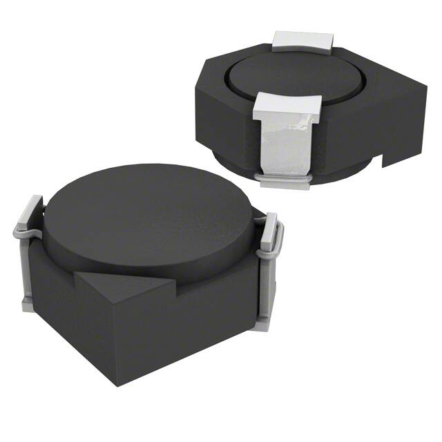

SMD Power Inductor CDRH2D14 Description • Ferrite drum core construction. • Magnetically shielded. • L×W×H:3.2×3.2×1.55mm Max. • Product weight: 46mg(Ref.) • Moisture Sensitivity Level: 1 • RoHS compliance. RoHS Dimension - [mm] ① Packaging • Carrier tape and reel packaging • 7.0”diameter reel • 1000pcs per reel ② ELECTRODE Land pattern and Schematics - [mm] Applications • Ideally used in Mobilephone,PDA,MP3, DSC/DVC, etc. as DC-DC converter inductors. 7 1. 3 4. 1. 3 Environmental Data • Operating temperature range: -40℃~+100℃ (including coil’s self temperature rise) • Storage temperature range: -40℃~+100℃ • Solder reflow temperature: 260 ℃ peak. 3 1. 1 2 (0.21μH~2.7μH) 1 2 (3.3μH~12μH) Page 1 of 4 Revised: 6-Jan-17 SMD Power Inductor CDRH2D14 Electrical Characteristics Part Name Stamp Saturation Current (A)※2 Inductance (μH) [ within ] ※1 D.C.R. (mΩ) Max. (Typ.) (at 20℃) at 20℃ at 100℃ Temperature Rise Current (A) ※3 CDRH2D14NP-R21NC N 0.21±35% 21(16) 3.80 2.70 4.74 CDRH2D14NP-R36NC P 0.36±35% 26(20) 3.25 2.55 4.10 CDRH2D14NP-R60NC Q 0.60±35% 33(25) 2.20 1.75 3.45 CDRH2D14NP-R82NC R 0.82±35% 39(30) 2.10 1.68 2.85 CDRH2D14NP-1R2NC S 1.2±30% 49(38) 1.95 1.35 2.75 CDRH2D14NP-1R5NC A 1.5±30% 63(50) 1.80 1.20 2.00 CDRH2D14NP-1R8NC B 1.8±30% 75(60) 1.65 1.10 1.80 CDRH2D14NP-2R2NC C 2.2±30% 94(75) 1.50 1.00 1.60 CDRH2D14NP-2R7NC D 2.7±30% 106(85) 1.35 0.90 1.40 CDRH2D14NP-3R3NC E 3.3±30% 125(100) 1.20 0.82 1.24 CDRH2D14NP-3R9NC F 3.9±30% 138(110) 1.10 0.75 1.12 CDRH2D14NP-4R7NC G 4.7±30% 169(135) 1.00 0.68 1.00 CDRH2D14NP-5R6NC H 5.6±30% 188(150) 0.95 0.60 0.98 CDRH2D14NP-6R8NC J 6.8±30% 213(170) 0.85 0.56 0.92 CDRH2D14NP-8R2NC K 8.2±30% 281(225) 0.80 0.51 0.80 CDRH2D14NP-100NC L 10±30% 294(235) 0.70 0.46 0.76 CDRH2D14NP-120NC M 12±30% 394(315) 0.62 0.42 0.64 ※1 Inductance measuring condition: at 100 kHz. ※2 Saturation current: The DC current at which the inductance decreases to 65% of it's nominal value. ※3 Temperature rise current: The DC current at which the temperature rise is △T=40℃.(Ta=20℃) Page 2 of 4 Revised: 6-Jan-17 SMD Power Inductor CDRH2D14 Saturation Current & Temperature Rise Graph L (20℃) 1. CDRH2D14NP-R21NC L (μH) △T L (100℃) △T (℃) L (μH) 2. CDRH2D14NP-R36NC △T (℃) L (μH) 3. CDRH2D14NP-R60NC △T (℃) 0.30 60 0.6 60 1.2 60 0.25 50 0.5 50 1.0 50 0.20 40 0.4 40 0.8 40 0.15 30 0.3 30 0.6 30 0.10 20 0.2 20 0.4 20 0.05 10 0.1 10 0.2 10 0 0.0 0 0.0 0.00 0 L (μH) 1 2 3 DC (A) 4 5 4. CDRH2D14NP-R82NC 6 0 △T (℃) L (μH) 1 2 3 DC (A) 4 5. CDRH2D14NP-1R2NC 5 0 0.0 0.6 1.2 1.8 2.4 3.0 3.6 DC (A) △T (℃) L (μH) 6. CDRH2D14NP-1R5NC △T (℃) 1.2 60 1.8 60 1.8 60 1.0 50 1.5 50 1.5 50 0.8 40 1.2 40 1.2 40 0.6 30 0.9 30 0.9 30 0.4 20 0.6 20 0.6 20 0.2 10 0.3 10 0.3 10 0.0 0 0.0 0 0.0 0 0.0 0.5 1.0 1.5 2.0 2.5 3.0 DC (A) L (μH) 7. CDRH2D14NP-1R8NC 0.0 0.5 1.0 1.5 2.0 2.5 3.0 DC (A) △T (℃) L (μH) 8. CDRH2D14NP-2R2NC 0.0 △T (℃) L (μH) 0.5 1.0 1.5 DC (A) 2.0 9. CDRH2D14NP-2R7NC 2.5 △T (℃) 2.4 60 3.0 60 3.0 60 2.0 50 2.5 50 2.5 50 1.6 40 2.0 40 2.0 40 1.2 30 1.5 30 1.5 30 0.8 20 1.0 20 1.0 20 0.4 10 0.5 10 0.5 10 0.0 0 0.0 0 0.0 0 0.0 L (μH) 0.4 0.8 1.2 DC (A) 1.6 10. CDRH2D14NP-3R3NC 2.0 0.0 0.3 0.6 0.9 1.2 1.5 1.8 DC (A) △T (℃) L (μH) 11. CDRH2D14NP-3R9NC 0.0 △T (℃) L (μH) 0.4 0.8 1.2 DC (A) 12. CDRH2D14NP-4R7NC 1.6 △T (℃) 4.8 60 4.8 60 6 60 4.0 50 4.0 50 5 50 3.2 40 3.2 40 4 40 2.4 30 2.4 30 3 30 1.6 20 1.6 20 2 20 0.8 10 0.8 10 1 10 0 0.0 0 0 0.0 0.0 0.3 0.6 0.9 DC (A) 1.2 1.5 0.0 0.3 0.6 0.9 DC (A) Page 3 of 4 1.2 1.5 0 0.0 0.3 0.6 0.9 DC (A) 1.2 Revised: 6-Jan-17 1.5 SMD Power Inductor CDRH2D14 Saturation Current & Temperature Rise Graph L (20℃) 13. CDRH2D14NP-5R6NC L (μH) △T L (100℃) L (μH) △T (℃) 14. CDRH2D14NP-6R8NC L (μH) △T (℃) 15. CDRH2D14NP-8R2NC △T (℃) 6 60 9.0 60 9.0 60 5 50 7.5 50 7.5 50 4 40 6.0 40 6.0 40 3 30 4.5 30 4.5 30 2 20 3.0 20 3.0 20 1 10 1.5 10 1.5 10 0 0.0 0 0.0 0 0.0 0.2 0.4 0.6 0.8 DC (A) 1.0 1.2 16. CDRH2D14NP-100NC L (μH) 0.0 0.2 0.4 0.6 0.8 1.0 1.2 DC (A) L (μH) △T (℃) 17. CDRH2D14NP-120NC 60 18 60 10 50 15 50 8 40 12 40 6 30 9 30 4 20 6 20 2 10 3 10 0 0 0.0 0.2 0.4 0.6 DC (A) 0.8 0.4 0.6 DC (A) 0.8 1.0 0 0.0 1.0 0.2 △T (℃) 12 0 0 0.0 0.2 0.4 0.6 DC (A) 0.8 1.0 Solder Reflow Condition T (℃) 300 250 Heat Endurance T (℃) 300 250 260℃ 230℃ 200 100 50 0 50 0 60 120 180 240 230℃ 40s 150 60 100 0 245℃ PEAK 200 10 150 Temperature Chart 300 T (s) 170±10 ℃,60~120s 0 60 120 180 240 300 T (s) Please refer to the sales offices on our website - http://www.sumida.com Hong Kong Shanghai Shenzhen Taipei Tel.+852-2880-6781 FAX.+852-2565-9600 sales@hk.sumida.com Tel.+86-21-5836-3299 FAX.+86-21-5836-3266 shanghai.sales@cn.sumida.com Tel.+86-755-8291-0228 FAX.+86-755-8291-0338 shenzhen.sales@cn.sumida.com Tel.+886-2-8751-2737 FAX.+886-2-8751-2738 sales@tw.sumida.com Saitama(Japan) Seoul Singapore San Jose Tel.+81-48-691-7300 FAX.+81-48-691-7340 sales@jp.sumida.com Tel.+82-2-6237-0777 FAX.+82-2-6237-0778 sales@kr.sumida.com Tel.+65-6296-3388 FAX.+65-6841-4426 sales@sg.sumida.com Tel.+1-408-321-9660 FAX.+1-408-321-9308 sales@us.sumida.com Chicago Obernzell Neumarkt Tel.+1-847-545-6700 FAX. +1-847-545-6720 sales@us.sumida.com Tel.+49-8591-937-0 FAX. +49-8591-937-103 contact@eu.sumida.com Tel.+49-9181-4509-110 FAX. +49-9181-4509-310 infocomp@eu.sumida.com Page 4 of 4 Revised: 6-Jan-17

物料型号:CDRH2D14
器件简介: - 采用铁氧体鼓芯构造。 - 磁屏蔽。 - 尺寸:3.2×3.2×1.55mm。 - 产品重量:46mg。 - 湿度敏感等级:1。 - 符合RoHS标准。
引脚分配:文档中未明确提供引脚分配信息。
参数特性: - 工作温度范围:-40℃~+100℃。 - 存储温度范围:-40℃~+100℃。 - 焊接回流温度:260℃峰值。
功能详解: - 适用于移动电话、PDA、MP3、DSC/DVC等作为DC-DC转换器电感器。
应用信息: - 理想用于移动电话、PDA、MP3、DSC/DVC等设备。
封装信息: - 采用载带和卷轴包装。 - 7英寸直径卷轴。 - 每卷1000件。
