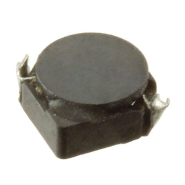

SMD Power Inductor
CDRH3D16/HP
Description
• Ferrite drum core construction.
• Magnetically shielded.
• L×W×H:4.0×4.0×1.8 mm Max.
• Product weight: 80mg (Ref.)
• Moisture Sensitivity Level: 1
• RoHS compliance.
