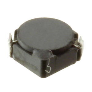

POWER INDUCTORS Type: CDRH3D16, CDRH3D16/HP, CDRH3D16/LD ◆ Product Description ・4.0×4.0mm Max.(L×W),1.80mm Max.Height. ・Inductance range: 0.26~33μH (CDRH3D16), 1.7~33μH (CDRH3D16/HP), 3.3~47μH (CDRH3D16/LD). ・Rated current range:0.32~3.6A(CDRH3D16),0.41~2.0A(CDRH3D16/HP), 0.21~0.8A (CDRH3D16/LD). ・In addition to the standards versions shown here, custom inductors are also available to meet your exact requirements. ◆ Feature ・Magnetically shielded construction. ・Ideally used in Mobilephone,PDA,MP3,DSC/DVC,Portable DVD,etc as DC-DC Converter inductors. ・RoHS Compliance. ◆ Dimensions (mm) φ ※ 3.8± 0.2 8± 2. 1 0. ① MA X. 1. 4 ② ※ 3.8± 0.2 MAX.1.8 E LECTRODE ※ Not including terminal dimension # (0.26μH~4.7μH)ARE MANAGED WITH STANDARD MAX.5.4 ◆ Land Pattern (mm) 1. 5 ELECTRODE Please refer to the sales offices on our website for a representative near you www.sumida.com # 4 ± 0. MA 2 X. 5. 2 4. 1. 1 ± 0. 2 5. 2 4 2. 4 1. 1/3 POWER INDUCTORS Type: CDRH3D16, CDRH3D16/HP, CDRH3D16/LD ◆ Specification(CDRH3D16) Part Name ※ CDRH3D16NP-R26N□ CDRH3D16NP-R47N□ CDRH3D16NP-ØR7N□ CDRH3D16NP-1R1N□ CDRH3D16NP-1R5N□ CDRH3D16NP-2R2N□ CDRH3D16NP-3R3N□ CDRH3D16NP-4R7N□ CDRH3D16NP-6R8N□ CDRH3D16NP-1ØØN□ CDRH3D16NP-15ØN□ CDRH3D16NP-22ØN□ CDRH3D16NP-33ØN□ Stamp R S T U A C E G I K M O Q Inductance (μH) [Within] 100kHz/1V 0.26±35% 0.47±35% 0.70±35% 1.10±35% 1.50±30% 2.20±30% 3.30±30% 4.70±30% 6.80±30% 10.0±30% 15.0±30% 22.0±30% 33.0±30% D.C.R.(mΩ) Max.(Typ.) (at 20℃) 27.5(21) 35( 27) 43( 33) 50( 38) 52( 40) 72( 55) 85( 65) 105( 80) 170(130) 210(160) 295(225) 430(330) 675(520) Rated current (mA) ※1 3600 2750 2250 1900 1550 1200 1100 900 730 550 450 400 320 ※1 Rated current: The DC current at which the inductance decreases to 65% of it's nominal value or when △t=30℃, whichever is lower(Ta=20℃). ◆ Specification(CDRH3D16/HP) Part Name ※ CDRH3D16/HPNP-1R7N□ CDRH3D16/HPNP-2R2N□ CDRH3D16/HPNP-3R3N□ CDRH3D16/HPNP-4R7N□ CDRH3D16/HPNP-6R8N□ CDRH3D16/HPNP-1ØØM□ CDRH3D16/HPNP-15ØM□ CDRH3D16/HPNP-22ØM□ CDRH3D16/HPNP-33ØM□ Stamp A C E G J L N P Q Inductance (μH) [Within] 100kHz/1V 1.7±30% 2.2±30% 3.3±30% 4.7±30% 6.8±30% 10±20% 15±20% 22±20% 33±20% D.C.R. (mΩ) Max.(Typ.) (at 20℃) 51(41) 59(47) 85(68) 116(93) 180(145) 230(185) 410(328) 610(488) 870(695) Saturation Current (A)※1 (at 20℃) 2.0 1.75 1.4 1.2 1.0 0.84 0.65 0.55 0.46 (at105℃) 1.5 1.3 1.1 0.9 0.72 0.62 0.52 0.43 0.35 Temperature Rise current (A) ※2 2.40 2.30 1.80 1.50 1.10 1.00 0.75 0.52 0.41 Please refer to the sales offices on our website for a representative near you www.sumida.com 2/3 POWER INDUCTORS Type: CDRH3D16, CDRH3D16/HP, CDRH3D16/LD ◆ Specification (CDRH3D16/LD) Part Name ※ Inductance (μH) [Within] 100kHz/1V 3.3±30% 3.9±30% 4.7±30% 5.6±30% 6.8±30% 8.2±30% 10±30% 12±30% 15±30% 18±30% 22±30% 27±30% 33±30% 39±30% 47±30% D.C.R.(mΩ) Max.(Typ.) (at 20℃) 66(53) 81(65) 91(73) 102(82) 130(104) 140(112) 190(152) 205(164) 272(218) 327(262) 356(285) 470(377) 560(446) 700(558) 775(630) Saturation Current (A)※1 at 20℃ 0.80 0.75 0.68 0.62 0.58 0.51 0.46 0.42 0.38 0.34 0.31 0.28 0.26 0.24 0.21 at 100℃ 0.52 0.44 0.43 0.38 0.34 0.32 0.27 0.26 0.23 0.21 0.18 0.17 0.16 0.15 0.13 2.00 1.75 1.72 1.64 1.30 1.28 1.07 0.98 0.87 0.76 0.66 0.60 0.55 0.47 0.45 Temperature Rise current (A) ※2 Stamp CDRH3D16/LDNP-3R3N□ CDRH3D16/LDNP-3R9N□ CDRH3D16/LDNP-4R7N□ CDRH3D16/LDNP-5R6N□ CDRH3D16/LDNP-6R8N□ CDRH3D16/LDNP-8R2N□ CDRH3D16/LDNP-1ØØN□ CDRH3D16/LDNP-12ØN□ CDRH3D16/LDNP-15ØN□ CDRH3D16/LDNP-18ØN□ CDRH3D16/LDNP-22ØN□ CDRH3D16/LDNP-27ØN□ CDRH3D16/LDNP-33ØN□ CDRH3D16/LDNP-39ØN□ CDRH3D16/LDNP-47ØN□ A B C D E F G H J K L M N P Q ※ Description of Part Name CDRH3D16/LDNP-3R3N□ B C Box Carrier Tape ※1.Saturation Current: The DC current at which the inductance decreases to 65% of it's nominal value ※2 Temperature rise current:The DC current at which the temperature rise is △t=40℃.(Ta=20℃) Please refer to the sales offices on our website for a representative near you www.sumida.com 3/3
