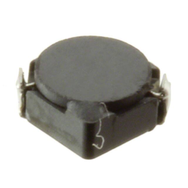

    固定电感器 Nonstandard 470nH ±35% 2.75A 35mΩ
CDRH3D16NP-R47NC 数据手册
SMD Power Inductor CDRH3D16 Description • Ferrite drum core construction. • Magnetically shielded. • L×W×H:4.0×4.0×1.8 mm Max. • Product weight: 80mg (Ref.) • Moisture Sensitivity Level: 1 • RoHS compliance. RoHS Dimension - [mm] 1 0. ① ② ※3.8±0.2 MA X. 1. 4 Packaging • Carrier tape and reel packaging • 7.0”diameter reel • 1000pcs per reel 4 ± 0. MA 2 X. 5. 2 ※ 3.8± 0.2 φ 8± 2. Environmental Data • Operating temperature range: -40℃~+100℃ (including coil’s self temperature rise) • Storage temperature range: -40℃~+100℃ • Solder reflow temperature: 260 ℃ peak. 1. # 4. MAX.1.8 1± 0. 2 ELECTRODE # (0.26μ H~ 4.7μ H)ARE MANAGED WITH STANDARD MAX.5.4 Land pattern and Schematics - [mm] 2 5. 1 Applications • Ideally used in Mobile phone, PDA, MP3, DSC/DVC, Portable DVD, etc as DC-DC converter inductors. 1 1. 5 4 2. 2 2 (0.26μH~4.7μH) (6.8μH~33μH) 4 1. Page 1 of 4 Revised: 9-Jan-17 SMD Power Inductor CDRH3D16 Electrical Characteristics Part Name Stamp Inductance (μH) [ within ] ※1 D.C.R. (mΩ) Max. (Typ.) (at 20℃) Rated Current (A) ※2 CDRH3D16NP-R26NC R 0.26±35% 27.5(21) 3.60 CDRH3D16NP-R47NC S 0.47±35% 35( 27) 2.75 CDRH3D16NP-0R7NC T 0.7±35% 43( 33) 2.25 CDRH3D16NP-1R1NC U 1.1±35% 50( 38) 1.90 CDRH3D16NP-1R5NC A 1.5±30% 52( 40) 1.55 CDRH3D16NP-2R2NC C 2.2±30% 72( 55) 1.20 CDRH3D16NP-3R3NC E 3.3±30% 85( 65) 1.10 CDRH3D16NP-4R7NC G 4.7±30% 105( 80) 0.90 CDRH3D16NP-6R8NC I 6.8±30% 170(130) 0.73 CDRH3D16NP-100NC K 10±30% 210(160) 0.55 CDRH3D16NP-150NC M 15±30% 295(225) 0.45 CDRH3D16NP-220NC O 22±30% 430(330) 0.40 CDRH3D16NP-330NC Q 33±30% 675(520) 0.32 ※1. Inductance measuring condition: at 100kHz. ※2. Rated current: The DC current at which the inductance decreases to 65% of its nominal value or when △t=30℃, whichever is lower (Ta=20℃). Page 2 of 4 Revised: 9-Jan-17 SMD Power Inductor CDRH3D16 Saturation Current & Temperature Rise Graph L (20℃) L (μH) △T L (105℃) 1. CDRH3D16NP-R26NC △T (℃) L (μH) 2. CDRH3D16NP-R47NC △T (℃) 3. CDRH3D16NP-0R7NC L (μH) △T (℃) 0.6 60 0.6 60 1.2 60 0.5 50 0.5 50 1.0 50 0.4 40 0.4 40 0.8 40 0.3 30 0.3 30 0.6 30 0.2 20 0.2 20 0.4 20 0.1 10 0.1 10 0.2 10 0.0 0 0.0 0 0.0 0 0 1 2 3 4 DC (A) 5 4. CDRH3D16NP-1R1NC L (μH) 6 0 △T (℃) L (μH) 1 2 DC (A) 3 5. CDRH3D16NP-1R5NC 4 0.0 0.5 1.0 1.5 2.0 2.5 3.0 DC (A) △T (℃) L (μH) 6. CDRH3D16NP-2R2NC △T (℃) 1.8 60 1.8 60 2.4 60 1.5 50 1.5 50 2.0 50 1.2 40 1.2 40 1.6 40 0.9 30 0.9 30 1.2 30 0.6 20 0.6 20 0.8 20 0.3 10 0.3 10 0.4 10 0.0 0 0.0 0 0.0 0 0.0 L (μH) 0.5 1.0 1.5 DC (A) 2.0 7. CDRH3D16NP-3R3NC 2.5 0.0 △T (℃) 0.4 0.8 1.2 DC (A) 1.6 8. CDRH3D16NP-4R7NC L (μH) 2.0 0.0 0.3 0.6 0.9 1.2 1.5 1.8 DC (A) △T (℃) L (μH) 9. CDRH3D16NP-6R8NC △T (℃) 3.6 60 6 60 9.0 60 3.0 50 5 50 7.5 50 2.4 40 4 40 6.0 40 1.8 30 3 30 4.5 30 1.2 20 2 20 3.0 20 0.6 10 1 10 1.5 10 0 0 0 0.0 0.0 0.0 0.3 0.6 0.9 1.2 1.5 1.8 DC (A) L (μH) 10. CDRH3D16NP-100NC 0.0 △T (℃) 0.3 0.6 0.9 DC (A) 1.2 11. CDRH3D16NP-150NC L (μH) 1.5 0 0.0 0.2 0.4 0.6 0.8 1.0 1.2 DC (A) △T (℃) L (μH) 12. CDRH3D16NP-220NC △T (℃) 12 60 18 60 24 60 10 50 15 50 20 50 8 40 12 40 16 40 6 30 9 30 12 30 4 20 6 20 8 20 2 10 3 10 4 10 0 0 0 0 0 0.0 0.2 0.4 0.6 DC (A) 0.8 1.0 0.0 0.2 0.4 DC (A) 0.6 Page 3 of 4 0.8 0 0.0 0.2 0.4 0.6 DC (A) Revised: 9-Jan-17 0.8 SMD Power Inductor CDRH3D16 Saturation Current & Temperature Rise Graph L (20℃) L (μH) 13. CDRH3D16NP-330NC L (105℃) △T 260℃ T (℃) 300 250 △T (℃) 36 60 30 50 24 40 18 30 12 20 6 10 0 0 0.0 0.1 0.2 0.3 0.4 0.5 0.6 DC (A) Solder Reflow Condition T (℃) 300 250 Heat Endurance 230℃ 200 100 50 0 50 0 60 120 180 240 230℃ 40s 150 60 100 0 245℃ PEAK 200 10 150 Temperature Chart 300 T (s) 170±10 ℃,60~120s 0 60 120 180 240 300 T (s) Please refer to the sales offices on our website - http://www.sumida.com Hong Kong Shanghai Shenzhen Taipei Tel.+852-2880-6781 FAX.+852-2565-9600 sales@hk.sumida.com Tel.+86-21-5836-3299 FAX.+86-21-5836-3266 shanghai.sales@cn.sumida.com Tel.+86-755-8291-0228 FAX.+86-755-8291-0338 shenzhen.sales@cn.sumida.com Tel.+886-2-8751-2737 FAX.+886-2-8751-2738 sales@tw.sumida.com Saitama(Japan) Seoul Singapore San Jose Tel.+81-48-691-7300 FAX.+81-48-691-7340 sales@jp.sumida.com Tel.+82-2-6237-0777 FAX.+82-2-6237-0778 sales@kr.sumida.com Tel.+65-6296-3388 FAX.+65-6841-4426 sales@sg.sumida.com Tel.+1-408-321-9660 FAX.+1-408-321-9308 sales@us.sumida.com Chicago Obernzell Neumarkt Tel.+1-847-545-6700 FAX. +1-847-545-6720 sales@us.sumida.com Tel.+49-8591-937-0 FAX. +49-8591-937-103 contact@eu.sumida.com Tel.+49-9181-4509-110 FAX. +49-9181-4509-310 infocomp@eu.sumida.com Page 4 of 4 Revised: 9-Jan-17
