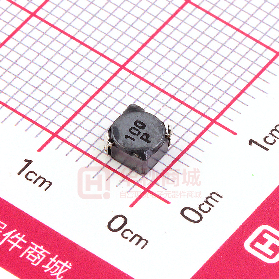

SMD Power Inductor CDRH4D22/HP Description • Ferrite drum core construction. • Magnetically shielded. • L×W×H:5.0×5.0×2.4 mm Max. • Product weight: 0.2g(Ref.) • Moisture Sensitivity Level: 1 • RoHS compliance. RoHS Environmental Data • Operating temperature range: -40℃~+100℃ (including coil’s self temperature rise) • Storage temperature range: -40℃~+100℃ • Solder reflow temperature: 260 ℃ peak. Dimension - [mm] 6. 9 Ma x. 4.5 1.5 ※ 4.7±0.3 4.5 (2.2) 2.4 Max. ※ 4.7± 0.3 Electrode terminal Packaging • Carrier tape and reel packaging • 12.9”diameter reel • 2000pcs per reel Applications • Ideally used in Mobile phone,PDA,MP3, HDD,DSC/DVC, Portable Computers, etc as DC-DC converter inductors. Land pattern and Schematics - [mm] 1.9 1.5 1.9 5.3 ① ② (1.2μH~5.2μH) ① ② (6.3μH~100μH) Page 1 of 5 Revised: 13-Sep-17 SMD Power Inductor CDRH4D22/HP Electrical Characteristics Part Name Stamp Saturation Current ( A ) ※2 Inductance (μH) [ within ] ※1 D.C.R. (mΩ) Max. (Typ.) (at 20℃) at 20℃ at 100℃ Temperature Rise Current (A) ※3 CDRH4D22HPNP-1R2NC 1R2 1.2±25% 26.5(21.2) 4.20 3.40 3.20 CDRH4D22HPNP-1R5NC 1R5 1.5±25% 31.3(25.0) 3.90 3.20 3.00 CDRH4D22HPNP-2R2NC 2R2 2.2±25% 44.3(35.4) 3.20 2.50 2.40 CDRH4D22HPNP-2R7NC 2R7 2.7±25% 57.8(46.3) 2.80 2.35 2.20 CDRH4D22HPNP-3R5NC 3R5 3.5±25% 65.1(52.0) 2.50 2.10 2.00 CDRH4D22HPNP-4R7NC 4R7 4.7±25% 82.6(66.0) 2.20 1.80 1.80 CDRH4D22HPNP-5R2NC 5R2 5.2±25% 92.8(74.3) 2.00 1.65 1.70 CDRH4D22HPNP-6R3NC 6R3 6.3±25% 110.0(87.9) 1.85 1.50 1.40 CDRH4D22HPNP-8R2NC 8R2 8.2±25% 128.3(102.6) 1.65 1.40 1.35 CDRH4D22HPNP-100MC 100 10±20% 143.8(115.0) 1.50 1.20 1.30 CDRH4D22HPNP-120MC 120 12±20% 187.2(150.0) 1.30 1.10 1.10 CDRH4D22HPNP-150MC 150 15±20% 212.9(170.3) 1.20 1.00 0.85 CDRH4D22HPNP-180MC 180 18±20% 238.7(191.0) 1.10 0.90 0.80 CDRH4D22HPNP-220MC 220 22±20% 267.0(213.6) 1.05 0.85 0.75 CDRH4D22HPNP-270MC 270 27±20% 393.9(315.0) 0.90 0.75 0.70 CDRH4D22HPNP-330MC 330 33±20% 448.9(359.0) 0.80 0.68 0.65 CDRH4D22HPNP-390MC 390 39±20% 667.9(534.3) 0.75 0.60 0.52 CDRH4D22HPNP-470MC 470 47±20% 723.3(578.6) 0.70 0.56 0.50 CDRH4D22HPNP-560MC 560 56±20% 810.0(648.2) 0.65 0.52 0.48 CDRH4D22HPNP-680MC 680 68±20% 913.0(730.4) 0.60 0.48 0.45 CDRH4D22HPNP-820MC 820 82±20% 1221(977.0) 0.55 0.45 0.40 CDRH4D22HPNP-101MC 101 100±20% 1370(1096.0) 0.48 0.38 0.35 ※1. Inductance measuring condition: at 100kHz. ※2. Saturation current: The value of D.C. current when the inductance decreases to 65% of it’s nominal value. ※3. Temperature rise current: The value of D.C. current when the temperature rise is △t=40℃(Ta=20℃). Page 2 of 5 Revised: 13-Sep-17 SMD Power Inductor CDRH4D22/HP Saturation Current & Temperature Rise Graph L (20℃) L (μH) △T L (105℃) 1. CDRH4D22HPNP-1R2NC △T (℃) L (μH) 2. CDRH4D22HPNP-1R5NC △T (℃) 3. CDRH4D22HPNP-2R2NC L (μH) △T (℃) 1.8 60 1.8 60 2.4 60 1.5 50 1.5 50 2.0 50 1.2 40 1.2 40 1.6 40 0.9 30 0.9 30 1.2 30 0.6 20 0.6 20 0.8 20 0.3 10 0.3 10 0.4 10 0.0 0 0.0 0 0.0 0 0 1 2 3 DC (A) 4 5 0 1 2 3 DC (A) 4 0.0 0.6 1.2 1.8 2.4 3.0 3.6 DC (A) 4. CDRH4D22HPNP-2R7NC L (μH) △T (℃) L (μH) 3.0 60 4.8 60 6 60 2.5 50 4.0 50 5 50 2.0 40 3.2 40 4 40 1.5 30 2.4 30 3 30 1.0 20 1.6 20 2 20 0.5 10 0.8 10 1 10 0.0 0 0.0 0 0 0 0.0 0.5 1.0 1.5 2.0 2.5 3.0 DC (A) L (μH) 7. CDRH4D22HPNP-5R2NC 5. CDRH4D22HPNP-3R5NC 5 △T (℃) 0.0 0.5 1.0 1.5 2.0 2.5 3.0 DC (A) △T (℃) L (μH) 6. CDRH4D22HPNP-4R7NC 0.0 8. CDRH4D22HPNP-6R3NC L (μH) △T (℃) L (μH) 0.5 1.0 1.5 DC (A) 2.0 9. CDRH4D22HPNP-8R2NC △T (℃) 2.5 △T (℃) 6 60 9.0 60 9.0 60 5 50 7.5 50 7.5 50 4 40 6.0 40 6.0 40 3 30 4.5 30 4.5 30 2 20 3.0 20 3.0 20 1 10 1.5 10 1.5 10 0 0 0.0 0 0.0 0 0.0 0.4 0.8 1.2 1.6 2.0 2.4 DC (A) 0.0 0.4 0.8 1.2 1.6 2.0 2.4 DC (A) 10. CDRH4D22HPNP-100MC 11. CDRH4D22HPNP-120MC L (μH) △T (℃) L (μH) L (μH) △T (℃) 0.0 0.4 0.8 1.2 DC (A) 1.6 12. CDRH4D22HPNP-150MC 2.0 △T (℃) 12 60 12 60 18 60 10 50 10 50 15 50 8 40 8 40 12 40 6 30 6 30 9 30 4 20 4 20 6 20 2 10 2 10 3 10 0 0 0 0 0 0.0 0.3 0.6 0.9 1.2 1.5 1.8 DC (A) 0.0 0.4 0.8 1.2 DC (A) Page 3 of 5 1.6 0 0.0 0.3 0.6 0.9 DC (A) 1.2 Revised: 13-Sep-17 1.5 SMD Power Inductor CDRH4D22/HP Saturation Current & Temperature Rise Graph L (20℃) △T L (105℃) 13. CDRH4D22HPNP-180MC L (μH) △T (℃) L (μH) 24 60 24 60 36 60 20 50 20 50 30 50 16 40 16 40 24 40 12 30 12 30 18 30 8 20 8 20 12 20 4 10 4 10 6 10 0 0 0 0 0 0 0.0 0.3 0.6 0.9 DC (A) 1.2 1.5 14. CDRH4D22HPNP-220MC △T (℃) 15. CDRH4D22HPNP-270MC L (μH) △T (℃) 0.0 0.2 0.4 0.6 0.8 1.0 1.2 DC (A) 0.0 0.2 0.4 0.6 0.8 1.0 1.2 DC (A) 16. CDRH4D22HPNP-330MC L (μH) △T (℃) L (μH) 36 60 48 60 60 60 30 50 40 50 50 50 24 40 32 40 40 40 18 30 24 30 30 30 12 20 16 20 20 20 6 10 8 10 10 10 0 0 0 0 0 0.0 L (μH) 0.2 0.4 0.6 DC (A) 0.8 19. CDRH4D22HPNP-560MC 1.0 17. CDRH4D22HPNP-390MC △T (℃) 0.0 △T (℃) 0.2 0.4 0.6 DC (A) 0.8 1.0 L (μH) 18. CDRH4D22HPNP-470MC △T (℃) 0 0.0 20. CDRH4D22HPNP-680MC L (μH) △T (℃) L (μH) 0.2 0.4 0.6 DC (A) 21. CDRH4D22HPNP-820MC 0.8 △T (℃) 90 60 90 60 120 60 75 50 75 50 100 50 60 40 60 40 80 40 45 30 45 30 60 30 30 20 30 20 40 20 15 10 15 10 20 10 0 0 0 0 0 0 0.0 L (μH) 0.2 0.4 0.6 DC (A) 22. CDRH4D22HPNP-101MC 0.8 0.0 0.2 0.4 0.6 DC (A) 0.8 0.0 0.1 0.2 0.3 0.4 0.5 0.6 DC (A) △T (℃) 120 60 100 50 80 40 60 30 40 20 20 10 0 0 0.0 0.1 0.2 0.3 0.4 0.5 0.6 DC (A) Page 4 of 5 Revised: 13-Sep-17 SMD Power Inductor CDRH4D22/HP Solder Reflow Condition T (℃) 300 250 Heat Endurance T (℃) 300 250 260℃ 230℃ 200 100 50 0 50 0 60 120 180 240 230℃ 40s 150 60 100 0 245℃ PEAK 200 10 150 Temperature Chart 300 T (s) 170±10 ℃,60~120s 0 60 120 180 240 300 T (s) Please refer to the sales offices on our website - http://www.sumida.com Hong Kong Shanghai Shenzhen Taipei Tel.+852-2880-6781 FAX.+852-2565-9600 sales@hk.sumida.com Tel.+86-21-5836-3299 FAX.+86-21-5836-3266 shanghai.sales@cn.sumida.com Tel.+86-755-8291-0228 FAX.+86-755-8291-0338 shenzhen.sales@cn.sumida.com Tel.+886-2-8751-2737 FAX.+886-2-8751-2738 sales@tw.sumida.com Saitama(Japan) Seoul Singapore San Jose Tel.+81-48-691-7300 FAX.+81-48-691-7340 sales@jp.sumida.com Tel.+82-2-6237-0777 FAX.+82-2-6237-0778 sales@kr.sumida.com Tel.+65-6296-3388 FAX.+65-6841-4426 sales@sg.sumida.com Tel.+1-408-321-9660 FAX.+1-408-321-9308 sales@us.sumida.com Chicago Obernzell Neumarkt Tel.+1-847-545-6700 FAX. +1-847-545-6720 sales@us.sumida.com Tel.+49-8591-937-0 FAX. +49-8591-937-103 contact@eu.sumida.com Tel.+49-9181-4509-110 FAX. +49-9181-4509-310 infocomp@eu.sumida.com Page 5 of 5 Revised: 13-Sep-17
