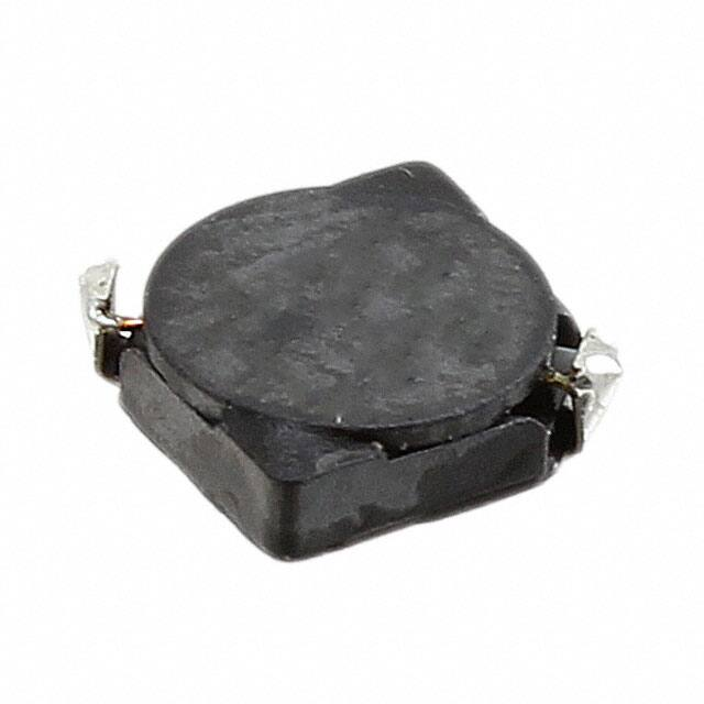

    固定电感器 Nonstandard 47µH ±30% 540mA 595mΩ
CDRH5D18NP-470NC 数据手册
SMD Power Inductor CDRH5D18 Description • Ferrite drum core construction. • Magnetically shielded. • L×W×H:6.0×6.0×2.0 mm Max. • Product weight: 220mg(Ref.) • Moisture Sensitivity Level: 1 • RoHS compliance. RoHS Environmental Data • Operating temperature range: -40℃~+100℃ (including coil’s self temperature rise) • Storage temperature range: -40℃~+100℃ • Solder reflow temperature: 260 ℃ peak. Dimension - [mm] . φ (1.8) 2.0 Max. ※5.7± 0.3 6 4. 2.0 5.5 x Ma ※ 5.7±0.3 2 8. 5.5 Electrode terminal Applications • Ideally used in Mobile phone, MP3,PDA,HDD, DSC/DVC, Game machine, etc as DC-DC converter inductors. Land pattern and Schematics - [mm] 2.0 2.15 6.3 2.15 Packaging • Carrier tape and reel packaging • 13.0”diameter reel • 2000pcs per reel 2.2μH 3.3μH~100μH Page 1 of 5 Revised: 9-Jan-17 SMD Power Inductor CDRH5D18 Electrical Characteristics STAMP INDUCTANCE (μH ) [WITHIN]※1 D.C.R. (Ω) [MAX.] (TYP.) (at 20℃)※2 RATED CURRENT (A) ※2 CDRH5D18NP-2R2NC 2R2 2.2μH±30% 37m (27m) 2.4 CDRH5D18NP-3R3NC 3R3 3.3μH±30% 47m (35m) 2.0 CDRH5D18NP-4R1NC 4R1 4.1μH ± 30% 57m (42m) 1.95 CDRH5D18NP-5R4NC 5R4 5.4μH ± 30% 76m (56m) 1.60 CDRH5D18NP-6R2NC 6R2 6.2μH ± 30% 96m (71m) 1.40 CDRH5D18NP-8R9NC 8R9 8.9μH ± 30% 116m (86m) 1.25 CDRH5D18NP-100NC 100 10μH ± 30% 124m (92m) 1.20 CDRH5D18NP-120NC 120 12μH ± 30% 153m (113m) 1.10 CDRH5D18NP-150NC 150 15μH ± 30% 196m (145m) 0.97 CDRH5D18NP-180NC 180 18μH ± 30% 210m (155m) 0.85 CDRH5D18NP-220NC 220 22μH ± 30% 290m (215m) 0.80 CDRH5D18NP-270NC 270 27μH ± 30% 330m (245m) 0.75 CDRH5D18NP-330NC 330 33μH ± 30% 385m (285m) 0.65 CDRH5D18NP-390NC 390 39μH ± 30% 520m (385m) 0.57 CDRH5D18NP-470NC 470 47μH ± 30% 595m (440m) 0.54 CDRH5D18NP-560NC 560 56μH ± 30% 665m (493m) 0.50 CDRH5D18NP-680NC 680 68μH ± 30% 840m (622m) 0.43 CDRH5D18NP-820NC 820 82μH ± 30% 978m (725m) 0.41 CDRH5D18NP-101NC 101 100μH ± 30% 1.2 (895m) 0.36 PART NO. ※1. Inductance measuring condition: at 10kHz. ※2. Rated current: The DC current at which the inductance decreases to 65% of it’s nominal value or when △t=30℃, whichever is lower (Ta=20℃). Page 2 of 5 Revised: 9-Jan-17 SMD Power Inductor CDRH5D18 Saturation Current & Temperature Rise Graph L (20℃) L (μH) △T L (105℃) 1. CDRH5D18NP-2R2NC △T (℃) L (μH) 2. CDRH5D18NP-3R3NC △T (℃) 3. CDRH5D18NP-4R1NC L (μH) △T (℃) 2.4 60 4.8 60 6 60 2.0 50 4.0 50 5 50 1.6 40 3.2 40 4 40 1.2 30 2.4 30 3 30 0.8 20 1.6 20 2 20 0.4 10 0.8 10 1 10 0.0 0 0.0 0 0 0 0 1 2 DC (A) 3 0.0 4 0.5 1.0 1.5 2.0 2.5 3.0 0.0 0.5 DC (A) 4. CDRH5D18NP-5R4NC L (μH) △T (℃) L (μH) 5. CDRH5D18NP-6R2NC △T (℃) L (μH) 1.0 1.5 DC (A) 2.0 6. CDRH5D18NP-8R9NC 2.5 △T (℃) 6 60 9.0 60 12 60 5 50 7.5 50 10 50 4 40 6.0 40 8 40 3 30 4.5 30 6 30 2 20 3.0 20 4 20 1 10 1.5 10 2 10 0 0.0 0 0 0 0.0 L (μH) 0.5 1.0 1.5 DC (A) 2.0 7. CDRH5D18NP-100NC 2.5 0.0 0.4 0.8 1.2 1.6 2.0 2.4 DC (A) △T (℃) 8. CDRH5D18NP-120NC L (μH) 0 0.0 △T (℃) L (μH) 0.4 0.8 1.2 DC (A) 1.6 9. CDRH5D18NP-150NC 2.0 △T (℃) 12 60 18 60 18 60 10 50 15 50 15 50 8 40 12 40 12 40 6 30 9 30 9 30 4 20 6 20 6 20 2 10 3 10 3 10 0 0 0 0 0 0 0.0 L (μH) 0.4 0.8 1.2 DC (A) 1.6 10. CDRH5D18NP-180NC 2.0 0.0 0.3 0.6 0.9 1.2 1.5 1.8 DC (A) △T (℃) 11. CDRH5D18NP-220NC L (μH) 0.0 △T (℃) L (μH) 0.3 0.6 0.9 DC (A) 1.2 12. CDRH5D18NP-270NC 1.5 △T (℃) 24 60 30 60 36 60 20 50 25 50 30 50 16 40 20 40 24 40 12 30 15 30 18 30 8 20 10 20 12 20 4 10 5 10 6 10 0 0 0 0 0 0.0 0.3 0.6 0.9 DC (A) 1.2 1.5 0.0 0.2 0.4 0.6 0.8 1.0 1.2 DC (A) Page 3 of 5 0 0.0 0.2 0.4 0.6 0.8 1.0 1.2 DC (A) Revised: 9-Jan-17 SMD Power Inductor CDRH5D18 Saturation Current & Temperature Rise Graph L (20℃) L (μH) 13. CDRH5D18NP-330NC △T L (105℃) △T (℃) L (μH) 14. CDRH5D18NP-390NC △T (℃) 15. CDRH5D18NP-470NC L (μH) △T (℃) 36 60 48 60 60 60 30 50 40 50 50 50 24 40 32 40 40 40 18 30 24 30 30 30 12 20 16 20 20 20 6 10 8 10 10 10 0 0 0 0 0 0 0.0 0.2 0.4 0.6 0.8 1.0 1.2 DC (A) 16. CDRH5D18NP-560NC L (μH) 0.0 △T (℃) L (μH) 0.2 0.4 0.6 DC (A) 0.8 17. CDRH5D18NP-680NC 1.0 0.0 △T (℃) L (μH) 0.2 0.4 0.6 DC (A) 0.8 18. CDRH5D18NP-820NC 1.0 △T (℃) 60 60 90 60 90 60 50 50 75 50 75 50 40 40 60 40 60 40 30 30 45 30 45 30 20 20 30 20 30 20 10 10 15 10 15 10 0 0 0 0 0 0 0.0 L (μH) 0.2 0.4 0.6 DC (A) 19. CDRH5D18NP-101NC 0.8 0.0 △T (℃) 120 60 100 50 80 40 60 30 40 20 20 10 0 0 0.2 0.4 0.6 DC (A) 0.8 0.0 0.2 0.4 0.6 DC (A) L (μH) 0.0 0.1 0.2 0.3 0.4 0.5 0.6 DC (A) Page 4 of 5 Revised: 9-Jan-17 0.8 SMD Power Inductor CDRH5D18 Solder Reflow Condition T (℃) 300 250 Heat Endurance T (℃) 300 250 260℃ 230℃ 200 100 50 0 50 0 60 120 180 240 230℃ 40s 150 60 100 0 245℃ PEAK 200 10 150 Temperature Chart 300 T (s) 170±10 ℃,60~120s 0 60 120 180 240 300 T (s) Please refer to the sales offices on our website - http://www.sumida.com Hong Kong Shanghai Shenzhen Taipei Tel.+852-2880-6781 FAX.+852-2565-9600 sales@hk.sumida.com Tel.+86-21-5836-3299 FAX.+86-21-5836-3266 shanghai.sales@cn.sumida.com Tel.+86-755-8291-0228 FAX.+86-755-8291-0338 shenzhen.sales@cn.sumida.com Tel.+886-2-8751-2737 FAX.+886-2-8751-2738 sales@tw.sumida.com Saitama(Japan) Seoul Singapore San Jose Tel.+81-48-691-7300 FAX.+81-48-691-7340 sales@jp.sumida.com Tel.+82-2-6237-0777 FAX.+82-2-6237-0778 sales@kr.sumida.com Tel.+65-6296-3388 FAX.+65-6841-4426 sales@sg.sumida.com Tel.+1-408-321-9660 FAX.+1-408-321-9308 sales@us.sumida.com Chicago Obernzell Neumarkt Tel.+1-847-545-6700 FAX. +1-847-545-6720 sales@us.sumida.com Tel.+49-8591-937-0 FAX. +49-8591-937-103 contact@eu.sumida.com Tel.+49-9181-4509-110 FAX. +49-9181-4509-310 infocomp@eu.sumida.com Page 5 of 5 Revised: 9-Jan-17
