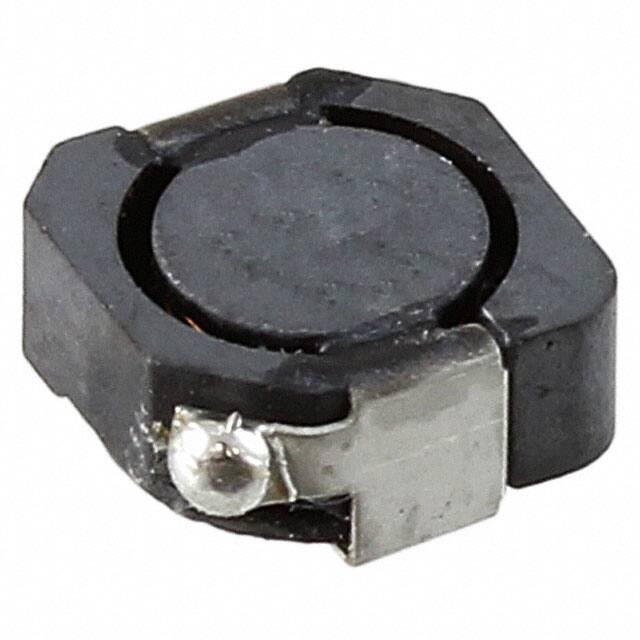

    固定电感器 Nonstandard 22µH ±20% 900mA 266mΩ
CDRH5D28RH125NP-220MC 数据手册
SMD Power Inductor CDRH5D28R/H125 Description • Ferrite drum core construction. • Magnetically shielded. • L W H: 6.3 6.2 x3.0 mm Max. • Product weight:0.35g(Ref.) • Moisture Sensitivity Level: 1 • RoHS compliance. • Halogen Free available. • Qualification to AEC-Q200. Environmental Data • Operating temperature range: -40 ~+125 (including coil’s self temperature rise) • Storage temperature range: -40 +125 • Solder reflow temperature: 260 peak. Packaging • Carrier tape and reel packaging • 13.0”diameter reel • 2000pcs per reel RoHS Halogen Free Dimension - [mm] 0 . 9 1.0 ±0.2 2.0±8.2 3.0 ± 9.5 Land pattern and Schematics - [mm] Applications • Automotive and other high temperature, high reliability application. 2 .2 μ ~μ (1.0 H 10 H) (15 H 100 H) Page 1 of 4 Revised: 1-Aug-11 ℃ ℃ ℃ ~℃ ℃ × ×× 4 . 1 0 . 9 .x a M 2. 8 μ ~μ 1 . 4 3 . 7 1 . 4 6 . 0 ± 0 . 3 SMD Power Inductor CDRH5D28R/H125 Electrical Characteristics Inductance [ H] 100kHz D.C.R. (m ) [Max.] (at 20 ) 17.0(13.5) 20.0(16.0) 27.0(21.5) 35.5(28.5) 54.0(43.0) 77.5(62.0) 121(97.0) 148(118) 266(213) 334(267) 500(400) 685(548) 1020(815) Saturation current (A) 1 CDRH5D28RH125NP-1R5PC CDRH5D28RH125NP-2R4PC CDRH5D28RH125NP-3R3PC CDRH5D28RH125NP-4R7PC CDRH5D28RH125NP-6R8PC CDRH5D28RH125NP-1ØØMC CDRH5D28RH125NP-15ØMC CDRH5D28RH125NP-22ØMC CDRH5D28RH125NP-33ØMC CDRH5D28RH125NP-47ØMC CDRH5D28RH125NP-68ØMC CDRH5D28RH125NP-1Ø1MC 1R5 2R4 3R3 4R7 6R8 100 150 220 330 470 680 101 1.5 2.4 3.3 4.7 6.8 10 15 22 33 47 68 100 1. Saturation current: The value of D.C. current when the inductance decreases to 65% of it’s nominal value. Page 2 of 4 ℃ = ℃ =△ 2. Temperature rise current: The value of D.C. current when the temperature rise is ± ± ± ± ± ± ± ± ± ± ± ± ± CDRH5D28RH125NP-1RØPC 1R0 1.0 25% 25% 25% 25% 25% 25% 7.10 6.50 5.30 4.30 3.70 3.08 2.46 2.08 1.70 1.41 1.16 0.95 0.80 20% 20% 20% 20% 20% 20% 20% ℃ (at20 ) (at125 ) Typ. 5.60 5.10 4.00 3.40 2.89 2.44 1.93 1.63 1.33 1.12 0.91 0.74 0.62 4.10 3.60 3.20 2.72 2.20 1.80 1.40 1.24 0.90 0.80 0.64 0.54 0.46 t 40 (Ta 20 ). Revised: 1-Aug-11 ※A Part No. Stamp ℃ ※ Temperature rise current ( ) 2 ℃ Ω μ ※ ※ SMD Power Inductor CDRH5D28R/H125 Saturation Current & Temperature Rise Graph 1. CDRH5D28RH125NP-1R0PC L ( H) T( ) 2. CDRH5D28RH125NP-1R5PC L ( H) T( ) DC (A) DC (A) DC (A) DC (A) DC (A) DC (A) DC (A) DC (A) DC (A) DC (A) DC (A) DC (A) Page 3 of 4 Revised: 1-Aug-11 06 05 04 03 02 01 ℃△ 0 0.1 8.0 6.0 4.0 2.0 0.0 μ 0 09 57 06 54 03 51 06 05 04 03 02 01 ℃△ 0 5.1 2.1 9.0 6.0 3.0 0.0 μ 10. CDRH5D28RH125NP-330MC L ( H) T( ) 11. CDRH5D28RH125NP-470MC L ( H) T( ) 12. CDRH5D28RH125NP-680MC L ( H) T( ) 06 05 04 03 02 01 ℃△ 0 0.2 5.1 0.1 5.0 0.0 μ 5 0 03 52 02 51 01 06 05 04 03 02 01 ℃△ 0 4.2 0.2 6.1 2.1 8.0 4.0 0.0 μ 7. CDRH5D28RH125NP-100MC L ( H) T( ) 8. CDRH5D28RH125NP-150MC L ( H) T( ) 9. CDRH5D28RH125NP-220MC L ( H) T( ) 06 05 04 03 02 01 ℃△ 0.3 5.2 0.2 5.1 0.1 5.0 0.0 0 0.0 μ 0.9 5.7 0.6 5.4 0.3 5.1 06 05 04 03 02 01 ℃△ 0 4 3 2 1 μ 4. CDRH5D28RH125NP-3R3PC T( ) L ( H) 5. CDRH5D28RH125NP-4R7PC L ( H) T( ) 6. CDRH5D28RH125NP-6R8PC T( ) L ( H) 06 05 04 03 02 01 ℃△ 0 6 5 4 3 2 1 0 μ 0.3 5.2 0.2 5.1 0.1 5.0 0.0 06 05 04 03 02 01 ℃△ 0 8 6 4 △ 2 0 ℃ 0 L (20 ) μ 8.1 5.1 2.1 9.0 6.0 3.0 0.0 9 6 3 0 0 81 51 21 06 05 04 03 02 01 6 5 4 3 2 1 0 06 05 04 03 02 01 06 05 04 03 02 01 06 05 04 03 02 01 06 05 04 03 02 01 ℃△ ℃△ ℃△ ℃△ 0 0 0 0 5.1 5 8 0.3 5.2 0.2 5.1 0.1 5.0 0.0 2.1 4 6 ℃ L (125 ) T 3. CDRH5D28RH125NP-2R4PC L ( H) T( ) 9.0 3 4 6.0 2 2 3.0 1 0 0 0.0 μ μ μ μ 2.1 0.1 8.0 6.0 4.0 2.0 0.0 6.3 0.3 4.2 8.1 2.1 6.0 0.0 8 6 4 2 0 7 0 24 53 82 12 41 21 01 SMD Power Inductor CDRH5D28R/H125 Saturation Current & Temperature Rise Graph 13. CDRH5D28RH125NP-101MC T( ) L ( H) DC (A) Solder Reflow Condition Heat Endurance 052 003 )℃( T ℃062 052 003 )℃( T Please refer to the sales offices on our website - http://www.sumida.com Hong Kong Tel.+852-2880-6688 FAX.+852-2565-9600 sales@hk.sumida.com Shanghai Tel.+86-021-5836-3299 FAX.+86-021-5836-3266 shanghai.sales@cn.sumida.com Shenzhen Tel.+86-755-8291-0228 FAX.+86-755-8291-0338 shenzhen.sales@cn.sumida.com Taipei Tel.+886-2-8751-2737 FAX.+886-2-8751-2738 sales@tw.sumida.com Tokyo Tel.+81-3-5202-7112 FAX.+81-3-5202-7105 sales@jp.sumida.com Seoul Tel.+82-2-6237-0777 FAX.+82-2-6237-0778 sales@kr.sumida.com Singapore Tel.+65-6296-3388 FAX.+65-6296-3390 sales@sg.sumida.com San Jose Tel.+1-408-3219660 FAX.+1-408-321-9308 sales@us.sumida.com Chicago Tel.+1-847-545-6700 FAX. +1-847-545-6720 sales@us.sumida.com Obernzell Tel.+49-8591-937-0 FAX. +49-8591-937-103 contact@sumida-eu.com Neumarkt Tel.+49-9181-4509-110 FAX. +49-9181-4509-310 infocomp@eu.sumida.com Page 4 of 4 Revised: 1-Aug-11 )s( T 003 042 081 ℃± 170 10 ,60~120s ℃ KAEP ℃542 s04 021 06 0 002 051 001 0 05 △ )s( T ℃032 003 ℃ L (20 ) 01 06 042 ℃△ 06 05 04 03 02 01 0 0.1 081 8.0 ℃ L (125 ) T 021 6.0 4.0 06 2.0 0 0.0 002 051 001 0 05 μ 0 08 06 04 02 021 001 Temperature Chart 230
