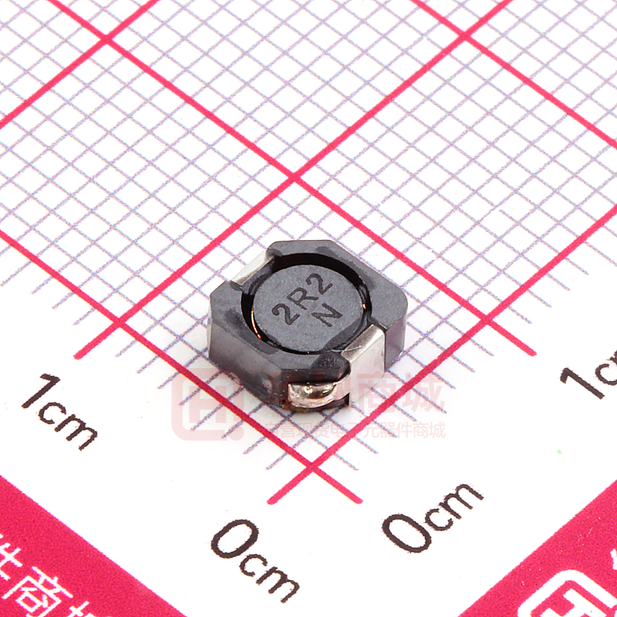

SMD Power Inductor CDRH5D28R/HP Description • Ferrite drum core construction. • Magnetically shielded. • L×W×H:6.3×6.2×3.0 mm Max. • Product weight: 0.4g(Ref.) • Moisture Sensitivity Level: 1 • RoHS compliance. RoHS Environmental Data • Operating temperature range: -40℃~+105℃ (including coil’s self temperature rise) • Storage temperature range: -40℃~+105℃ • Solder reflow temperature: 260 ℃ peak. Dimension - [mm] 8. 5.9±0.3 2.8±0.2 2 Ma 2 x. 2.0±0.1 Electrode 0 .6 ±0 . 15 4. 7 ±0 .3 6.0 ±0 .3 1 Packaging • Carrier tape and reel packaging • 13.0”diameter reel • 2000pcs per reel Applications • Ideally used in Notebook PC,HDD,DSC/DVC, LCD TV ,Game machine etc. as DC-DC converter inductors. 1.0 4.6 1.0 Land pattern and Schematics - [mm] 2.1 1 1 2 2 (2.2μH~10μH) (12μH~47μH) Page 1 of 4 Revised: 9-Jan-17 SMD Power Inductor CDRH5D28R/HP Electrical Characteristics Part Name Stamp Saturation Current (A) ※2 Inductance (μH) [ within ] ※1 D.C.R. (mΩ) [Max.] (Typ.) (at 20℃) at 20℃ at 105℃ Temperature Rise Current (A) ※3 CDRH5D28RHPNP-2R2NC 2R2 2.2±25% 24.8(19.8) 5.50 4.50 3.80 CDRH5D28RHPNP-3R0NC 3R0 3.0±25% 31.8(25.4) 4.70 3.90 3.35 CDRH5D28RHPNP-4R7NC 4R7 4.7±25% 43.1(34.5) 3.70 3.05 2.80 CDRH5D28RHPNP-5R6NC 5R6 5.6±25% 47.9(38.3) 3.30 2.65 2.70 CDRH5D28RHPNP-6R8NC 6R8 6.8±25% 61.3(49.0) 3.10 2.55 2.50 CDRH5D28RHPNP-8R2NC 8R2 8.2±25% 88.4(70.7) 2.70 2.30 1.90 CDRH5D28RHPNP-100MC 100 10.0±20% 93.0(74.4) 2.45 2.05 1.85 CDRH5D28RHPNP-120MC 120 12.0±20% 115(92.1) 2.30 2.00 1.60 CDRH5D28RHPNP-150MC 150 144(115) 2.05 1.65 1.40 CDRH5D28RHPNP-180MC 180 18.0±20% 161(128) 1.90 1.55 1.35 CDRH5D28RHPNP-220MC 220 22.0±20% 213(171) 1.75 1.42 1.20 CDRH5D28RHPNP-270MC 270 27.0±20% 277(221) 1.60 1.30 1.00 CDRH5D28RHPNP-330MC 330 33.0±20% 314(251) 1.35 1.10 0.90 CDRH5D28RHPNP-470MC 470 47.0±20% 379(303) 1.20 1.00 0.85 15.0±20% ※1. Inductance measuring condition: at 100kHz. ※2. Saturation current: The value of D.C. current when the inductance decreases to 65% of it’s nominal value. ※3. Temperature rise current: The value of D.C. current when the temperature rise is △t=40℃(Ta=20℃). Page 2 of 4 Revised: 9-Jan-17 SMD Power Inductor CDRH5D28R/HP Saturation Current & Temperature Rise Graph L (20℃) △T L (105℃) 1. CDRH5D28RHPNP-2R2NC L (μH) △T (℃) 2. CDRH5D28RHPNP-3R0NC L (μH) △T (℃) 3. CDRH5D28RHPNP-4R7NC L (μH) △T (℃) 3.0 60 3.6 60 6 60 2.5 50 3.0 50 5 50 2.0 40 2.4 40 4 40 1.5 30 1.8 30 3 30 1.0 20 1.2 20 2 20 0.5 10 0.6 10 1 10 0.0 0 0.0 0 0 0 0 2 4 DC (A) 6 8 0 1 2 3 4 DC (A) 5 6 0 2 3 DC (A) 4 5 4. CDRH5D28RHPNP-5R6NC L (μH) △T (℃) L (μH) 6 60 9.0 60 12 60 5 50 7.5 50 10 50 4 40 6.0 40 8 40 3 30 4.5 30 6 30 2 20 3.0 20 4 20 1 10 1.5 10 2 10 0 0.0 0 0 0 0 L (μH) 1 2 DC (A) 3 4 5. CDRH5D28RHPNP-6R8NC △T (℃) 1 0 7. CDRH5D28RHPNP-100MC △T (℃) 1 2 DC (A) 3 L (μH) 4 6. CDRH5D28RHPNP-8R2NC △T (℃) 0 0.0 0.6 1.2 1.8 2.4 3.0 3.6 DC (A) 8. CDRH5D28RHPNP-120MC L (μH) △T (℃) L (μH) 9. CDRH5D28RHPNP-150MC △T (℃) 12 60 18 60 18 60 10 50 15 50 15 50 8 40 12 40 12 40 6 30 9 30 9 30 4 20 6 20 6 20 2 10 3 10 3 10 0 0 0 0 0 0 0.0 0.5 1.0 1.5 2.0 2.5 3.0 DC (A) L (μH) 0.0 0.5 1.0 1.5 2.0 2.5 3.0 DC (A) 10. CDRH5D28RHPNP-180MC △T (℃) 0.0 11. CDRH5D28RHPNP-220MC L (μH) △T (℃) L (μH) 0.5 1.0 1.5 DC (A) 2.0 2.5 12. CDRH5D28RHPNP-270MC △T (℃) 24 60 30 60 30 60 20 50 25 50 25 50 16 40 20 40 20 40 12 30 15 30 15 30 8 20 10 20 10 20 4 10 5 10 5 10 0 0 0 0 0 0 0.0 0.4 0.8 1.2 1.6 2.0 2.4 DC (A) 0.0 0.4 0.8 1.2 DC (A) Page 3 of 4 1.6 2.0 0.0 0.4 0.8 1.2 DC (A) 1.6 Revised: 9-Jan-17 2.0 SMD Power Inductor CDRH5D28R/HP Saturation Current & Temperature Rise Graph L (20℃) △T L (105℃) 13. CDRH5D28RHPNP-330MC L (μH) △T (℃) 14. CDRH5D28RHPNP-470MC L (μH) △T (℃) 36 60 60 60 30 50 50 50 24 40 40 40 18 30 30 30 12 20 20 20 6 10 10 10 0 0 0 0 0.0 0.3 0.6 0.9 1.2 1.5 1.8 DC (A) 0.0 0.3 0.6 0.9 DC (A) 1.2 1.5 Solder Reflow Condition T (℃) 300 250 Heat Endurance T (℃) 300 250 260℃ 230℃ 200 100 50 0 50 0 60 120 180 240 230℃ 40s 150 60 100 0 245℃ PEAK 200 10 150 Temperature Chart 300 T (s) 170±10 ℃,60~120s 0 60 120 180 240 300 T (s) Please refer to the sales offices on our website - http://www.sumida.com Hong Kong Shanghai Shenzhen Taipei Tel.+852-2880-6781 FAX.+852-2565-9600 sales@hk.sumida.com Tel.+86-21-5836-3299 FAX.+86-21-5836-3266 shanghai.sales@cn.sumida.com Tel.+86-755-8291-0228 FAX.+86-755-8291-0338 shenzhen.sales@cn.sumida.com Tel.+886-2-8751-2737 FAX.+886-2-8751-2738 sales@tw.sumida.com Saitama(Japan) Seoul Singapore San Jose Tel.+81-48-691-7300 FAX.+81-48-691-7340 sales@jp.sumida.com Tel.+82-2-6237-0777 FAX.+82-2-6237-0778 sales@kr.sumida.com Tel.+65-6296-3388 FAX.+65-6841-4426 sales@sg.sumida.com Tel.+1-408-321-9660 FAX.+1-408-321-9308 sales@us.sumida.com Chicago Obernzell Neumarkt Tel.+1-847-545-6700 FAX. +1-847-545-6720 sales@us.sumida.com Tel.+49-8591-937-0 FAX. +49-8591-937-103 contact@eu.sumida.com Tel.+49-9181-4509-110 FAX. +49-9181-4509-310 infocomp@eu.sumida.com Page 4 of 4 Revised: 9-Jan-17
