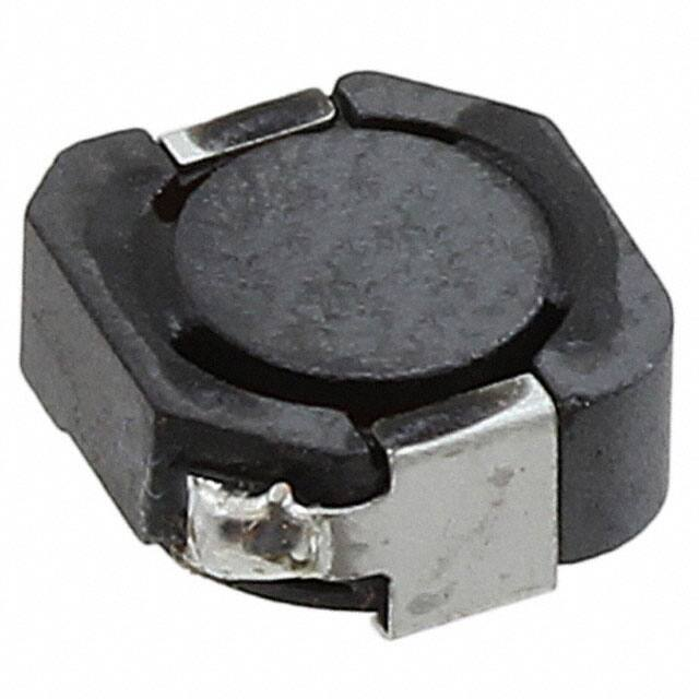

    固定电感器 Nonstandard 100µH ±30% 400mA 520mΩ
CDRH5D28RNP-101NC 数据手册
SMD Power Inductor CDRH5D28R Description • Ferrite drum core construction. • Magnetically shielded. • L×W×H:6.3×6.2×3.0 mm Max. • Product weight: 0.4g(Ref.) • Moisture Sensitivity Level: 1 • RoHS compliance. RoHS Environmental Data • Operating temperature range: -40℃~+100℃ (including coil’s self temperature rise) • Storage temperature range: -40℃~+100℃ • Solder reflow temperature: 260 ℃ peak. Dimension - [mm] 2 2 . 8± 0 . 2 5 . 9± 0 . 3 2.0± 0.1 Electrode 0 . 6± 0 . 1 5 4 . 7± 0 . 3 6 . 0± 0 . 3 1 Applications • Ideally used in Notebook PC,HDD,DSC/DVC, LCD TV ,Game machine etc. as converter inductors. Land pattern and Schematics - [mm] 1.0 1.0 2.1 4.6 Packaging • Carrier tape and reel packaging • 13.0”diameter reel • 2000pcs per reel 1 2 (2.5μH~10μH) 1 2 (12μH~100μH) Page 1 of 5 Revised: 9-Jan-17 SMD Power Inductor CDRH5D28R Electrical Characteristics Part Name Stamp Inductance (μH) [ within ] ※1 D.C.R. (mΩ) [Max.] (Typ.) (at 20℃) Rated Current (A) ※2 CDRH5D28RNP-2R5NC 2R5 2.5±30% 17.6(13) 2.60 CDRH5D28RNP-3R3NC 3R3 3.3±30% 20.3(15) 2.30 CDRH5D28RNP-4R0NC 4R0 4.0±30% 27.0(20) 2.10 CDRH5D28RNP-5R0NC 5R0 5.0±30% 31.1(23) 1.85 CDRH5D28RNP-6R0NC 6R0 6.0±30% 41.9(31) 1.70 CDRH5D28RNP-8R0NC 8R0 8.0±30% 49.9(37) 1.50 CDRH5D28RNP-100NC 100 10±30% 54.0(40) 1.30 CDRH5D28RNP-120NC 120 12±30% 71.6(53) 1.20 CDRH5D28RNP-150NC 150 15±30% 82.4(61) 1.10 CDRH5D28RNP-180NC 180 18±30% 101.5(75) 1.05 CDRH5D28RNP-220NC 220 22±30% 119.0(88) 0.95 CDRH5D28RNP-270NC 270 27±30% 146.0(108) 0.85 CDRH5D28RNP-330NC 330 33±30% 182.5(135) 0.76 CDRH5D28RNP-390NC 390 39±30% 209.5(155) 0.68 CDRH5D28RNP-470NC 470 47±30% 229.5(170) 0.60 CDRH5D28RNP-560NC 560 56±30% 305.0(226) 0.55 CDRH5D28RNP-680NC 680 68±30% 351.0(260) 0.48 CDRH5D28RNP-820NC 820 82±30% 418.5(310) 0.45 CDRH5D28RNP-101NC 101 100±30% 520.0(385) 0.40 ※1. Inductance measuring condition: at 100kHz. ※2. Rated current: The DC current at which the inductance decreases to 65% of it’s nominal value or when △t=30℃,whichever is lower (Ta=20℃). Page 2 of 5 Revised: 9-Jan-17 SMD Power Inductor CDRH5D28R Saturation Current & Temperature Rise Graph L (20℃) L (μH) △T L (105℃) 1. CDRH5D28RNP-2R5NC △T (℃) L (μH) 2. CDRH5D28RNP-3R3NC △T (℃) 3. CDRH5D28RNP-4R0NC L (μH) △T (℃) 3.6 60 4.8 60 4.8 60 3.0 50 4.0 50 4.0 50 2.4 40 3.2 40 3.2 40 1.8 30 2.4 30 2.4 30 1.2 20 1.6 20 1.6 20 0.6 10 0.8 10 0.8 10 0.0 0 0.0 0 0.0 0 0 1 2 3 DC (A) 4 4. CDRH5D28RNP-5R0NC L (μH) 5 0 △T (℃) L (μH) 1 2 DC (A) 3 5. CDRH5D28RNP-6R0NC 4 0 △T (℃) L (μH) 1 2 DC (A) 3 6. CDRH5D28RNP-8R0NC 4 △T (℃) 6 60 9.0 60 12 60 5 50 7.5 50 10 50 4 40 6.0 40 8 40 3 30 4.5 30 6 30 2 20 3.0 20 4 20 1 10 1.5 10 2 10 0 0.0 0 0 0 0.0 0.6 1.2 1.8 2.4 3.0 3.6 DC (A) L (μH) 7. CDRH5D28RNP-100NC 0.0 0.5 1.0 1.5 2.0 2.5 3.0 DC (A) △T (℃) 8. CDRH5D28RNP-120NC L (μH) 0 0.0 0.5 1.0 1.5 2.0 2.5 3.0 DC (A) △T (℃) L (μH) 9. CDRH5D28RNP-150NC △T (℃) 12 60 18 60 18 60 10 50 15 50 15 50 8 40 12 40 12 40 6 30 9 30 9 30 4 20 6 20 6 20 2 10 3 10 3 10 0 0 0 0 0 0 0.0 L (μH) 0.5 1.0 1.5 DC (A) 2.0 10. CDRH5D28RNP-180NC 2.5 0.0 0.4 0.8 1.2 1.6 2.0 2.4 DC (A) △T (℃) 0.0 0.4 0.8 1.2 1.6 2.0 2.4 DC (A) 11. CDRH5D28RNP-220NC L (μH) △T (℃) L (μH) 12. CDRH5D28RNP-270NC △T (℃) 24 60 30 60 36 60 20 50 25 50 30 50 16 40 20 40 24 40 12 30 15 30 18 30 8 20 10 20 12 20 4 10 5 10 6 10 0 0 0 0 0 0.0 0.3 0.6 0.9 1.2 1.5 1.8 DC (A) 0.0 0.4 0.8 1.2 DC (A) Page 3 of 5 1.6 0 0.0 0.3 0.6 0.9 DC (A) 1.2 Revised: 9-Jan-17 1.5 SMD Power Inductor CDRH5D28R Saturation Current & Temperature Rise Graph L (20℃) L (μH) 13. CDRH5D28RNP-330NC △T L (105℃) △T (℃) L (μH) 14. CDRH5D28RNP-390NC △T (℃) 15. CDRH5D28RNP-470NC L (μH) △T (℃) 36 60 48 60 60 60 30 50 40 50 50 50 24 40 32 40 40 40 18 30 24 30 30 30 12 20 16 20 20 20 6 10 8 10 10 10 0 0 0 0 0 0.0 0.3 0.6 0.9 DC (A) 1.2 16. CDRH5D28RNP-560NC L (μH) 1.5 0.0 △T (℃) L (μH) 0.3 0.6 0.9 DC (A) 1.2 17. CDRH5D28RNP-680NC 1.5 0 0.0 △T (℃) L (μH) 0.3 0.6 0.9 DC (A) 1.2 18. CDRH5D28RNP-820NC 1.5 △T (℃) 60 60 90 60 90 60 50 50 75 50 75 50 40 40 60 40 60 40 30 30 45 30 45 30 20 20 30 20 30 20 10 10 15 10 15 10 0 0 0 0 0 0.0 0.2 0.4 0.6 0.8 1.0 1.2 DC (A) L (μH) 19. CDRH5D28RNP-101NC 0.0 60 100 50 80 40 60 30 40 20 20 10 0 0 0.2 0.4 0.6 DC (A) 0.4 0.6 DC (A) 0.8 1.0 0 0.0 0.2 0.4 0.6 DC (A) △T (℃) 120 0.0 0.2 0.8 Page 4 of 5 Revised: 9-Jan-17 0.8 SMD Power Inductor CDRH5D28R Solder Reflow Condition T (℃) 300 250 Heat Endurance T (℃) 300 250 260℃ 230℃ 200 100 50 0 50 0 60 120 180 240 230℃ 40s 150 60 100 0 245℃ PEAK 200 10 150 Temperature Chart 300 T (s) 170±10 ℃,60~120s 0 60 120 180 240 300 T (s) Please refer to the sales offices on our website - http://www.sumida.com Hong Kong Shanghai Shenzhen Taipei Tel.+852-2880-6781 FAX.+852-2565-9600 sales@hk.sumida.com Tel.+86-21-5836-3299 FAX.+86-21-5836-3266 shanghai.sales@cn.sumida.com Tel.+86-755-8291-0228 FAX.+86-755-8291-0338 shenzhen.sales@cn.sumida.com Tel.+886-2-8751-2737 FAX.+886-2-8751-2738 sales@tw.sumida.com Saitama(Japan) Seoul Singapore San Jose Tel.+81-48-691-7300 FAX.+81-48-691-7340 sales@jp.sumida.com Tel.+82-2-6237-0777 FAX.+82-2-6237-0778 sales@kr.sumida.com Tel.+65-6296-3388 FAX.+65-6841-4426 sales@sg.sumida.com Tel.+1-408-321-9660 FAX.+1-408-321-9308 sales@us.sumida.com Chicago Obernzell Neumarkt Tel.+1-847-545-6700 FAX. +1-847-545-6720 sales@us.sumida.com Tel.+49-8591-937-0 FAX. +49-8591-937-103 contact@eu.sumida.com Tel.+49-9181-4509-110 FAX. +49-9181-4509-310 infocomp@eu.sumida.com Page 5 of 5 Revised: 9-Jan-17
