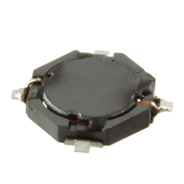

    固定电感器 Nonstandard 10µH ±30% 1.1A 165mΩ
CDRH6D12NP-100NC 数据手册
SMD Power Inductor CDRH6D12 Description • Ferrite drum core construction. • Magnetically shielded. • L×W×H:6.7×6.7×1.5 mm Max. • Product weight:165mg(Ref.) • Moisture Sensitivity Level: 1 • RoHS compliance. RoHS Environmental Data • Operating temperature range: -40℃~+100℃ (including coil’s self temperature rise) • Storage temperature range: -40℃~+100℃ • Solder reflow temperature: 260 ℃ peak. Dimension - [mm] MAX.1.5 6.5± 0.2 3 6.5±0.2 2 4 5. 0 1 0 2. 8 6. Packaging • Carrier tape and reel packaging • 13.0”diameter reel • 1000pcs per reel Applications • Ideally used in Mobile phone, MP3, PDA , HDD,DSC/DVC, etc as DC-DC converter inductors. ELECTRODE TERMINAL 4 2. 4. 7. 8 3 Land pattern and Schematics - [mm] 2 3 2 3 1 4 1 4 (1.0μH~22μH) (33μH~68μH) Page 1 of 4 Revised: 9-Jan-17 SMD Power Inductor CDRH6D12 Electrical Characteristics D.C.R. (mΩ) Max. (Typ.) (at 20℃) Saturation Current (A)※2 Temperature Rise Current (A) ※3 1.0±30% 37.5(30.0) 3.50 2.80 1R5 1.5±30% 41.3(33.0) 2.80 2.50 CDRH6D12NP-2R2NC 2R2 2.2±30% 50.0(40.0) 2.50 2.30 CDRH6D12NP-2R6NC 2R6 2.6±30% 56.3(45.0) 2.30 2.10 CDRH6D12NP-3R3NC 3R3 3.3±30% 62.5(50.0) 2.20 1.90 CDRH6D12NP-4R2NC 4R2 4.2±30% 75.0(60.0) 1.90 1.80 CDRH6D12NP-6R4NC 6R4 6.4±30% 119.0(95.0) 1.50 1.40 CDRH6D12NP-100NC 100 10.0±30% 165.0(132.0) 1.20 1.10 CDRH6D12NP-150NC 150 15.0±30% 243.8(195.0) 0.95 0.90 CDRH6D12NP-220NC 220 22.0±30% 325.0(260.0) 0.80 0.75 CDRH6D12NP-330NC 330 33.0±30% 500.0(400.0) 0.65 0.60 CDRH6D12NP-470NC 470 47.0±30% 675.0(540.0) 0.55 0.50 CDRH6D12NP-680NC 680 68.0±30% 918.8(735.0) 0.45 0.40 Part Name Stamp CDRH6D12NP-1R0NC 1R0 CDRH6D12NP-1R5NC Inductance (μH) [within] ※1 ※1. Inductance measuring condition: at 100kHz. ※2. Saturation current: The value of D.C. current when the inductance decreases to 65% of it’s nominal value. ※3. Temperature rise current: The value of D.C. current when the temperature rise is △t=40℃(Ta=20℃). Page 2 of 4 Revised: 9-Jan-17 SMD Power Inductor CDRH6D12 Saturation Current & Temperature Rise Graph L (20℃) L (μH) △T L (105℃) 1. CDRH6D12NP-1R0NC △T (℃) L (μH) 2. CDRH6D12NP-1R5NC △T (℃) 3. CDRH6D12NP-2R2NC L (μH) △T (℃) 1.2 60 1.8 60 2.4 60 1.0 50 1.5 50 2.0 50 0.8 40 1.2 40 1.6 40 0.6 30 0.9 30 1.2 30 0.4 20 0.6 20 0.8 20 0.2 10 0.3 10 0.4 10 0.0 0 0.0 0 0.0 0 0 1 2 3 DC (A) 4 4. CDRH6D12NP-2R6NC L (μH) 5 0.0 0.6 1.2 1.8 2.4 3.0 3.6 DC (A) △T (℃) L (μH) 5. CDRH6D12NP-3R3NC 0.0 △T (℃) L (μH) 0.6 1.2 1.8 DC (A) 2.4 6. CDRH6D12NP-4R2NC 3.0 △T (℃) 3.0 60 4.8 60 4.8 60 2.5 50 4.0 50 4.0 50 2.0 40 3.2 40 3.2 40 1.5 30 2.4 30 2.4 30 1.0 20 1.6 20 1.6 20 0.5 10 0.8 10 0.8 10 0.0 0 0.0 0 0.0 0 0.0 L (μH) 0.6 1.2 1.8 DC (A) 2.4 7. CDRH6D12NP-6R4NC 3.0 0.0 △T (℃) 0.6 1.2 1.8 DC (A) 2.4 8. CDRH6D12NP-100NC L (μH) 3.0 0.0 △T (℃) L (μH) 0.4 0.8 1.2 DC (A) 1.6 9. CDRH6D12NP-150NC 2.0 △T (℃) 9.0 60 12 60 18 60 7.5 50 10 50 15 50 6.0 40 8 40 12 40 4.5 30 6 30 9 30 3.0 20 4 20 6 20 1.5 10 2 10 3 10 0.0 0 0 0 0 0 0.0 0.3 0.6 0.9 1.2 1.5 1.8 DC (A) L (μH) 10. CDRH6D12NP-220NC 0.0 △T (℃) 0.3 0.6 0.9 DC (A) 1.2 11. CDRH6D12NP-330NC L (μH) 1.5 0.0 0.2 0.4 0.6 0.8 1.0 1.2 DC (A) △T (℃) L (μH) 12. CDRH6D12NP-470NC △T (℃) 24 60 36 60 60 60 20 50 30 50 50 50 16 40 24 40 40 40 12 30 18 30 30 30 8 20 12 20 20 20 4 10 6 10 10 10 0 0 0 0 0 0 0.0 0.2 0.4 0.6 DC (A) 0.8 1.0 0.0 0.2 0.4 0.6 DC (A) Page 3 of 4 0.8 1.0 0.0 0.1 0.2 0.3 0.4 0.5 0.6 DC (A) Revised: 9-Jan-17 SMD Power Inductor CDRH6D12 Saturation Current & Temperature Rise Graph L (20℃) L (μH) 13. CDRH6D12NP-680NC L (105℃) △T 260℃ T (℃) 300 250 △T (℃) 90 60 75 50 60 40 45 30 30 20 15 10 0 0 0.0 0.1 0.2 0.3 0.4 0.5 0.6 DC (A) Solder Reflow Condition T (℃) 300 250 Heat Endurance 230℃ 200 100 50 0 50 0 60 120 180 240 230℃ 40s 150 60 100 0 245℃ PEAK 200 10 150 Temperature Chart 300 T (s) 170±10 ℃,60~120s 0 60 120 180 240 300 T (s) Please refer to the sales offices on our website - http://www.sumida.com Hong Kong Shanghai Shenzhen Taipei Tel.+852-2880-6781 FAX.+852-2565-9600 sales@hk.sumida.com Tel.+86-21-5836-3299 FAX.+86-21-5836-3266 shanghai.sales@cn.sumida.com Tel.+86-755-8291-0228 FAX.+86-755-8291-0338 shenzhen.sales@cn.sumida.com Tel.+886-2-8751-2737 FAX.+886-2-8751-2738 sales@tw.sumida.com Saitama(Japan) Seoul Singapore San Jose Tel.+81-48-691-7300 FAX.+81-48-691-7340 sales@jp.sumida.com Tel.+82-2-6237-0777 FAX.+82-2-6237-0778 sales@kr.sumida.com Tel.+65-6296-3388 FAX.+65-6841-4426 sales@sg.sumida.com Tel.+1-408-321-9660 FAX.+1-408-321-9308 sales@us.sumida.com Chicago Obernzell Neumarkt Tel.+1-847-545-6700 FAX. +1-847-545-6720 sales@us.sumida.com Tel.+49-8591-937-0 FAX. +49-8591-937-103 contact@eu.sumida.com Tel.+49-9181-4509-110 FAX. +49-9181-4509-310 infocomp@eu.sumida.com Page 4 of 4 Revised: 9-Jan-17
