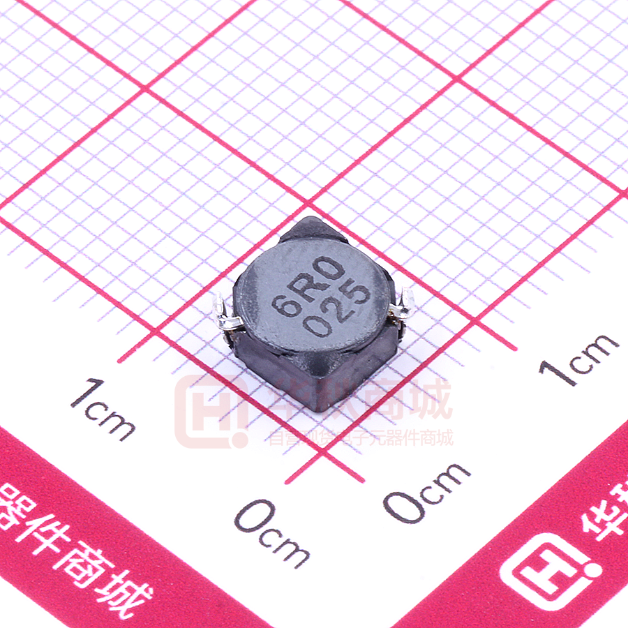

SMD Power Inductor CDRH6D28 Description • Ferrite drum core construction. • Magnetically shielded. • L×W×H:7.0×7.0×3.0 mm Max. • Product weight: 0.44g(Ref.) • Moisture Sensitivity Level: 1 • RoHS compliance. RoHS Dimension - [mm] .5 .9 X MA ※ 6.7±0.3 4 5. φ 2.0 6.5 ① ② ※6.7± 0.3 (2.8) MAX.3.0 6.5 Electrode Environmental Data • Operating temperature range: -40℃~+100℃ (including coil’s self temperature rise) • Storage temperature range: -40℃~+100℃ • Solder reflow temperature: 260 ℃ peak. Packaging • Carrier tape and reel packaging • 13”diameter reel • 1500pcs per reel Applications • Ideally used in MP3, PDA ,HDD,DSC/DVC, Notebook PC etc as DC-DC converter inductors. 2.65 2.0 2.65 Land pattern and Schematics - [mm] 7.3 ① ② ① ② (3.0μH~6.0μH) (7.3μH~100μH) Page 1 of 5 Revised: 9-Jan-17 SMD Power Inductor CDRH6D28 Electrical Characteristics Part Name Stamp Inductance (μH) [within] ※1 D.C.R.(Ω) Max. (Typ.) (at 20℃) Rated Current (A) ※2 CDRH6D28NP-3R0NC 3R0 3.0±30% 24m (18m) 3.00 CDRH6D28NP-3R9NC 3R9 3.9±30% 27m (20m) 2.60 CDRH6D28NP-5R0NC 5R0 5.0±30% 31m (23m) 2.40 CDRH6D28NP-6R0NC 6R0 6.0±30% 35m (26m) 2.25 CDRH6D28NP-7R3NC 7R3 7.3±30% 54m (40m) 2.10 CDRH6D28NP-8R6NC 8R6 8.6±30% 58m (43m) 1.85 CDRH6D28NP-100NC 100 10±30% 65m (48m) 1.70 CDRH6D28NP-120NC 120 12±30% 70m (52m) 1.55 CDRH6D28NP-150NC 150 15±30% 84m (62m) 1.40 CDRH6D28NP-180NC 180 18±30% 95m (70m) 1.32 CDRH6D28NP-220NC 220 22±30% 128m (95m) 1.20 CDRH6D28NP-270NC 270 27±30% 142m(105m) 1.05 CDRH6D28NP-330NC 330 33±30% 165m(122m) 0.97 CDRH6D28NP-390NC 390 39±30% 210m(156m) 0.86 CDRH6D28NP-470NC 470 47±30% 238m(176m) 0.80 CDRH6D28NP-560NC 560 56±30% 277m(205m) 0.73 CDRH6D28NP-680NC 680 68±30% 304m(225m) 0.65 CDRH6D28NP-820NC 820 82±30% 390m(290m) 0.60 CDRH6D28NP-101NC 101 100±30% 535m(397m) 0.54 ※1. Inductance measuring condition: at 100kHz. ※2. Rated current: The DC current at which the inductance decreases to 65% of it's nominal value or when △t=30℃, whichever is lower (Ta=20℃). Page 2 of 5 Revised: 9-Jan-17 SMD Power Inductor CDRH6D28 Saturation Current & Temperature Rise Graph L (20℃) L (μH) △T L (105℃) 1. CDRH6D28NP-3R0NC △T (℃) L (μH) 2. CDRH6D28NP-3R9NC △T (℃) 3. CDRH6D28NP-5R0NC L (μH) △T (℃) 3.6 60 6 60 6 60 3.0 50 5 50 5 50 2.4 40 4 40 4 40 1.8 30 3 30 3 30 1.2 20 2 20 2 20 0.6 10 1 10 1 10 0.0 0 0 0 0 0 0 1 2 3 DC (A) 4 4. CDRH6D28NP-6R0NC L (μH) 5 0 △T (℃) 1 L (μH) 2 3 DC (A) 4 5. CDRH6D28NP-7R3NC 5 0 △T (℃) L (μH) 1 2 3 DC (A) 4 6. CDRH6D28NP-8R6NC 5 △T (℃) 9.0 60 9.0 60 12 60 7.5 50 7.5 50 10 50 6.0 40 6.0 40 8 40 4.5 30 4.5 30 6 30 3.0 20 3.0 20 4 20 1.5 10 1.5 10 2 10 0 0.0 0 0 0.0 0 L (μH) 1 2 DC (A) 3 7. CDRH6D28NP-100NC 4 0.0 0.6 1.2 1.8 2.4 3.0 3.6 DC (A) △T (℃) 8. CDRH6D28NP-120NC L (μH) 0 0.0 0.5 1.0 1.5 2.0 2.5 3.0 DC (A) △T (℃) L (μH) 9. CDRH6D28NP-150NC △T (℃) 12 60 18 60 18 60 10 50 15 50 15 50 8 40 12 40 12 40 6 30 9 30 9 30 4 20 6 20 6 20 2 10 3 10 3 10 0 0 0 0 0 0 0.0 0.5 1.0 1.5 2.0 2.5 3.0 DC (A) L (μH) 10. CDRH6D28NP-180NC 0.0 △T (℃) 0.5 1.0 1.5 DC (A) 2.0 11. CDRH6D28NP-220NC L (μH) 2.5 0.0 △T (℃) L (μH) 0.5 1.0 1.5 DC (A) 2.0 12. CDRH6D28NP-270NC 2.5 △T (℃) 24 60 30 60 30 60 20 50 25 50 25 50 16 40 20 40 20 40 12 30 15 30 15 30 8 20 10 20 10 20 4 10 5 10 5 10 0 0 0 0 0 0 0.0 0.4 0.8 1.2 DC (A) 1.6 2.0 0.0 0.4 0.8 1.2 DC (A) Page 3 of 5 1.6 2.0 0.0 0.4 0.8 1.2 DC (A) 1.6 Revised: 9-Jan-17 2.0 SMD Power Inductor CDRH6D28 Saturation Current & Temperature Rise Graph L (20℃) L (μH) 13. CDRH6D28NP-330NC △T L (105℃) △T (℃) L (μH) 14. CDRH6D28NP-390NC △T (℃) 15. CDRH6D28NP-470NC L (μH) △T (℃) 36 60 60 60 60 60 30 50 50 50 50 50 24 40 40 40 40 40 18 30 30 30 30 30 12 20 20 20 20 20 6 10 10 10 10 10 0 0 0 0 0 0 0.0 0.3 0.6 0.9 1.2 1.5 1.8 DC (A) 16. CDRH6D28NP-560NC L (μH) 0.0 △T (℃) L (μH) 0.4 0.8 1.2 DC (A) 17. CDRH6D28NP-680NC 1.6 0.0 △T (℃) L (μH) 0.3 0.6 0.9 DC (A) 1.2 18. CDRH6D28NP-820NC 1.5 △T (℃) 90 60 90 60 120 60 75 50 75 50 100 50 60 40 60 40 80 40 45 30 45 30 60 30 30 20 30 20 40 20 15 10 15 10 20 10 0 0 0 0 0 0 0.0 L (μH) 0.3 0.6 0.9 DC (A) 1.2 19. CDRH6D28NP-101NC 0.0 1.5 60 100 50 80 40 60 30 40 20 20 10 0 0 0.2 0.4 0.6 DC (A) 0.8 0.6 0.9 DC (A) 1.2 1.5 0.0 0.2 0.4 0.6 0.8 1.0 1.2 DC (A) △T (℃) 120 0.0 0.3 1.0 Page 4 of 5 Revised: 9-Jan-17 SMD Power Inductor CDRH6D28 Solder Reflow Condition T (℃) 300 250 Heat Endurance T (℃) 300 250 260℃ 230℃ 200 100 50 0 50 0 60 120 180 240 230℃ 40s 150 60 100 0 245℃ PEAK 200 10 150 Temperature Chart 300 T (s) 170±10 ℃,60~120s 0 60 120 180 240 300 T (s) Please refer to the sales offices on our website - http://www.sumida.com Hong Kong Shanghai Shenzhen Taipei Tel.+852-2880-6781 FAX.+852-2565-9600 sales@hk.sumida.com Tel.+86-21-5836-3299 FAX.+86-21-5836-3266 shanghai.sales@cn.sumida.com Tel.+86-755-8291-0228 FAX.+86-755-8291-0338 shenzhen.sales@cn.sumida.com Tel.+886-2-8751-2737 FAX.+886-2-8751-2738 sales@tw.sumida.com Saitama(Japan) Seoul Singapore San Jose Tel.+81-48-691-7300 FAX.+81-48-691-7340 sales@jp.sumida.com Tel.+82-2-6237-0777 FAX.+82-2-6237-0778 sales@kr.sumida.com Tel.+65-6296-3388 FAX.+65-6841-4426 sales@sg.sumida.com Tel.+1-408-321-9660 FAX.+1-408-321-9308 sales@us.sumida.com Chicago Obernzell Neumarkt Tel.+1-847-545-6700 FAX. +1-847-545-6720 sales@us.sumida.com Tel.+49-8591-937-0 FAX. +49-8591-937-103 contact@eu.sumida.com Tel.+49-9181-4509-110 FAX. +49-9181-4509-310 infocomp@eu.sumida.com Page 5 of 5 Revised: 9-Jan-17

物料型号:CDRH6D28
器件简介: - 采用铁氧体鼓芯构造,具有磁屏蔽功能。 - 尺寸为7.0×7.0×3.0 mm,产品重量约为0.44克。 - 湿度敏感等级为1,符合RoHS标准。
引脚分配:文档中未提供具体的引脚分配信息。
参数特性: - 工作温度范围:-40℃至+100℃(包括线圈自身温升)。 - 存储温度范围:-40℃至+100℃。 - 焊接回流温度:260℃峰值。
功能详解: - 该电感器理想用于MP3、PDA、硬盘驱动器、数字相机/摄像机、笔记本电脑等设备的DC-DC转换器。
应用信息: - 适用于DC-DC转换器的电感器,提供多种电感值(3.0μH至100μH)。
封装信息: - 采用载带和卷轴包装,13英寸直径卷轴,每卷1500件。
电气特性表提供了不同型号的电感值、直流电阻(D.C.R.)、额定电流等参数。例如,CDRH6D28NP-3R0NC型号的电感值为3.0±30%,直流电阻最大值为24mΩ(典型值18mΩ),额定电流为3.00A。
饱和电流与温升曲线图展示了不同型号在不同直流电流下的电感值变化和温升情况。
