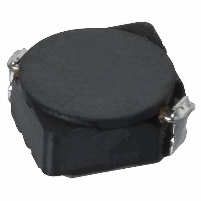

    固定电感器 Nonstandard 10µH ±30% 2A 38mΩ
CDRH6D38-100NC 数据手册
SMD Power Inductor CDRH6D38 Description • Ferrite drum core construction. • Magnetically shielded. • L×W×H:7.0×7.0×4.0 mm Max. • Product weight: 0.6g(Ref.) • Moisture Sensitivity Level: 1 • RoHS compliance. RoHS Environmental Data • Operating temperature range: -40℃~+100℃ (including coil’s self temperature rise) • Storage temperature range: -40℃~+100℃ • Solder reflow temperature: 260 ℃ peak. Dimension - [mm] 5 ※ 6.7±0.3 4 5. φ 6.5 ① 2.0 9. X. MA ② (3.8) ※6.7±0.3 6.5 MAX 4.0 Applications • Ideally used in Game machine, HDD, Notebook PC, Projector, PDA, etc as DC-DC converter inductors. ELECTRODE Land pattern and Schematics - [mm] 2.0 2.65 7.3 2.65 Packaging • Carrier tape and reel packaging • 13”diameter reel • 1000pcs per reel 1 2 (3.3μH~15μH) 1 2 (18μH~100μH) Page 1 of 4 Revised: 9-Jan-17 SMD Power Inductor CDRH6D38 Electrical Characteristics Part Name Stamp Inductance ( μH ) [ within ] ※1 D.C.R.(Ω) Max. (Typ.) (at 20℃) Rated Current (A) ※2 CDRH6D38NP-3R3NC 3R3 3.3±30% 20m (15m) 3.50 CDRH6D38NP-5R0NC 5R0 5.0±30% 24m (18m) 2.90 CDRH6D38NP-6R2NC 6R2 6.2±30% 27m (20m) 2.50 CDRH6D38NP-7R4NC 7R4 7.4±30% 31m (23m) 2.30 CDRH6D38NP-8R7NC 8R7 8.7±30% 34m (25m) 2.20 CDRH6D38NP-100NC 100 10±30% 38m (28m) 2.00 CDRH6D38NP-120NC 120 12±30% 53m (39m) 1.70 CDRH6D38NP-150NC 150 15±30% 57m (42m) 1.60 CDRH6D38NP-180NC 180 18±30% 92m (68m) 1.50 CDRH6D38NP-220NC 220 22±30% 96m (71m) 1.30 CDRH6D38NP-270NC 270 27±30% 109m (81m) 1.20 CDRH6D38NP-330NC 330 33±30% 124m (92m) 1.10 CDRH6D38NP-390NC 390 39±30% 138m(102m) 1.00 CDRH6D38NP-470NC 470 47±30% 155m(115m) 0.95 CDRH6D38NP-560NC 560 56±30% 202m(150m) 0.85 CDRH6D38NP-680NC 680 68±30% 234m(173m) 0.75 CDRH6D38NP-820NC 820 82±30% 324m(240m) 0.70 CDRH6D38NP-101NC 101 100±30% 358m(265m) 0.65 ※1. Inductance measuring condition: at 100kHz. ※2. Rated current: The DC current at which the inductance decreases to 65% of it's nominal value or when △t=30℃, whichever is lower (Ta=20℃). Page 2 of 4 Revised: 9-Jan-17 SMD Power Inductor CDRH6D38 Saturation Current & Temperature Rise Graph L (20℃) L (μH) △T L (105℃) 1. CDRH6D38NP-3R3NC △T (℃) L (μH) 2. CDRH6D38NP-5R0NC △T (℃) 3. CDRH6D38NP-6R2NC L (μH) △T (℃) 3.6 60 6 60 9.0 60 3.0 50 5 50 7.5 50 2.4 40 4 40 6.0 40 1.8 30 3 30 4.5 30 1.2 20 2 20 3.0 20 0.6 10 1 10 1.5 10 0.0 0 0 0 0.0 0 0 1 2 3 4 DC (A) 5 4. CDRH6D38NP-7R4NC L (μH) 6 0 △T (℃) 1 L (μH) 2 3 DC (A) 4 5. CDRH6D38NP-8R7NC 5 0 △T (℃) L (μH) 1 2 3 DC (A) 4 6. CDRH6D38NP-100NC 5 △T (℃) 9.0 60 12 60 12 60 7.5 50 10 50 10 50 6.0 40 8 40 8 40 4.5 30 6 30 6 30 3.0 20 4 20 4 20 1.5 10 2 10 2 10 0.0 0 0 0 0 0 0 L (μH) 1 2 3 DC (A) 4 7. CDRH6D38NP-120NC 5 0 △T (℃) 1 2 DC (A) 3 8. CDRH6D38NP-150NC L (μH) 4 0 △T (℃) L (μH) 1 2 DC (A) 3 9. CDRH6D38NP-180NC 4 △T (℃) 18 60 18 60 24 60 15 50 15 50 20 50 12 40 12 40 16 40 9 30 9 30 12 30 6 20 6 20 8 20 3 10 3 10 4 10 0 0 0 0 0 0 0.0 0.5 1.0 1.5 2.0 2.5 3.0 DC (A) L (μH) 10. CDRH6D38NP-220NC 0.0 0.5 1.0 1.5 2.0 2.5 3.0 DC (A) △T (℃) 11. CDRH6D38NP-270NC L (μH) 0.0 △T (℃) L (μH) 0.5 1.0 1.5 DC (A) 2.0 12. CDRH6D38NP-330NC 2.5 △T (℃) 30 60 30 60 36 60 25 50 25 50 30 50 20 40 20 40 24 40 15 30 15 30 18 30 10 20 10 20 12 20 5 10 5 10 6 10 0 0 0 0 0 0 0.0 0.5 1.0 1.5 DC (A) 2.0 2.5 0.0 0.4 0.8 1.2 1.6 2.0 2.4 DC (A) Page 3 of 4 0.0 0.4 0.8 1.2 DC (A) 1.6 Revised: 9-Jan-17 2.0 SMD Power Inductor CDRH6D38 Saturation Current & Temperature Rise Graph L (20℃) L (μH) △T L (105℃) 13. CDRH6D38NP-390NC △T (℃) L (μH) 14. CDRH6D38NP-470NC 15. CDRH6D38NP-560NC L (μH) △T (℃) △T (℃) 48 60 60 60 60 60 40 50 50 50 50 50 32 40 40 40 40 40 24 30 30 30 30 30 16 20 20 20 20 20 8 10 10 10 10 10 0 0 0 0 0 0 0.0 0.4 0.8 1.2 DC (A) 1.6 16. CDRH6D38NP-680NC L (μH) 2.0 0.0 0.3 0.6 0.9 1.2 1.5 1.8 DC (A) △T (℃) L (μH) 17. CDRH6D38NP-820NC 0.0 L (μH) △T (℃) 0.3 0.6 0.9 DC (A) 1.2 1.5 18. CDRH6D38NP-101NC △T (℃) 90 60 120 60 120 60 75 50 100 50 100 50 60 40 80 40 80 40 45 30 60 30 60 30 30 20 40 20 40 20 15 10 20 10 20 10 0 0 0 0 0 0.0 0.3 0.6 0.9 DC (A) 1.2 1.5 0.0 0.2 0.4 0.6 0.8 1.0 1.2 DC (A) 0 0.0 0.2 0.4 0.6 0.8 1.0 1.2 DC (A) Solder Reflow Condition T (℃) 300 250 Heat Endurance T (℃) 300 250 260℃ 230℃ 200 100 50 0 50 0 60 120 180 240 230℃ 40s 150 60 100 0 245℃ PEAK 200 10 150 Temperature Chart 300 T (s) 170±10 ℃,60~120s 0 60 120 180 240 300 T (s) Please refer to the sales offices on our website - http://www.sumida.com Hong Kong Shanghai Shenzhen Taipei Tel.+852-2880-6781 FAX.+852-2565-9600 sales@hk.sumida.com Tel.+86-21-5836-3299 FAX.+86-21-5836-3266 shanghai.sales@cn.sumida.com Tel.+86-755-8291-0228 FAX.+86-755-8291-0338 shenzhen.sales@cn.sumida.com Tel.+886-2-8751-2737 FAX.+886-2-8751-2738 sales@tw.sumida.com Saitama(Japan) Seoul Singapore San Jose Tel.+81-48-691-7300 FAX.+81-48-691-7340 sales@jp.sumida.com Tel.+82-2-6237-0777 FAX.+82-2-6237-0778 sales@kr.sumida.com Tel.+65-6296-3388 FAX.+65-6841-4426 sales@sg.sumida.com Tel.+1-408-321-9660 FAX.+1-408-321-9308 sales@us.sumida.com Chicago Obernzell Neumarkt Tel.+1-847-545-6700 FAX. +1-847-545-6720 sales@us.sumida.com Tel.+49-8591-937-0 FAX. +49-8591-937-103 contact@eu.sumida.com Tel.+49-9181-4509-110 FAX. +49-9181-4509-310 infocomp@eu.sumida.com Page 4 of 4 Revised: 9-Jan-17
