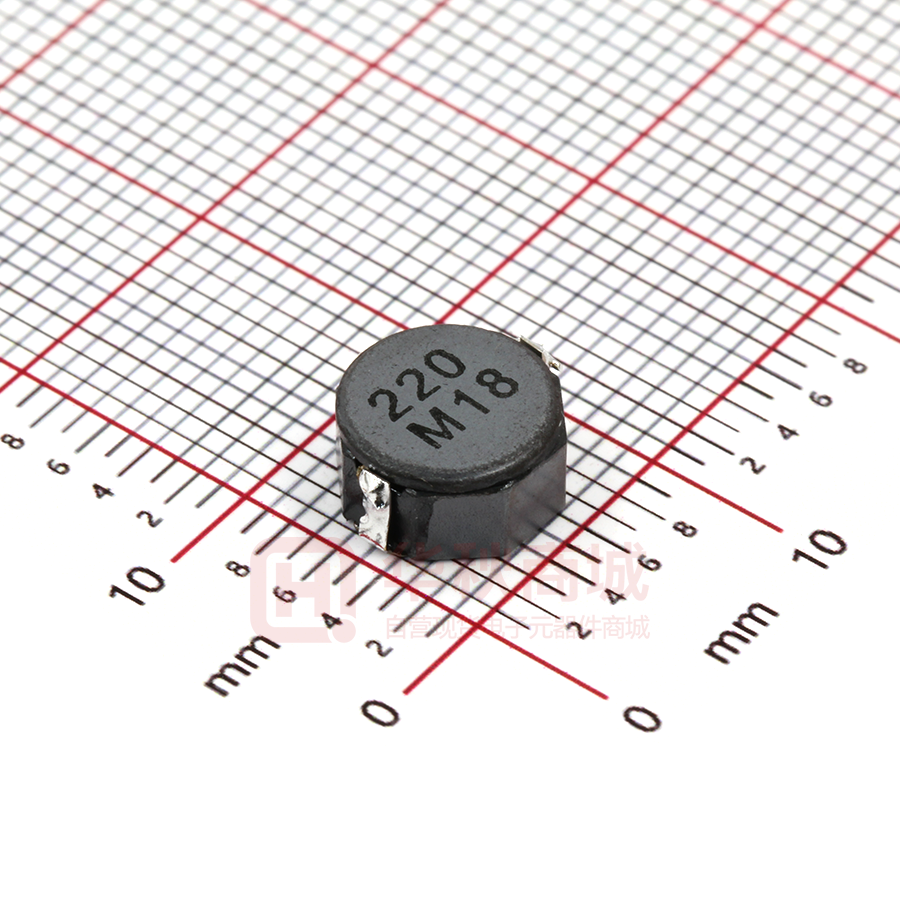

    功率电感 22µH ±30% 60mΩ IND_8X8MM_SM
CDRH8D43NP-220NC 数据手册
SMD Power Inductor CDRH8D43 Description • Ferrite drum core construction. • Magnetically shielded. • L×W×H:8.3×8.3×4.5 mm Max. • Product weight: 0.93g(Ref.) • Moisture Sensitivity Level: 1 • RoHS compliance. RoHS Environmental Data • Operating temperature range: -40℃~+100℃ (including coil’s self temperature rise) • Storage temperature range: -40℃~+100℃ • Solder reflow temperature: 260 ℃ peak. 2.5 8.0±0.3 Dimension - [mm] 2 1 6.3 ( 4.3) MAX 4.5 8.0± 0.3 1.2 Packaging • Carrier tape and reel packaging • 13”diameter reel • 500pcs per reel Applications • Ideally used in Mobile phone, MP3, PDA , HDD,DSC/DVC, etc as DC-DC converter inductors. Land pattern and Schematics - [mm] 10.1 2.8 6.1 2.0 1 2 (0.68μH~15μH) 1 2 (22μH~100μH) Page 1 of 4 Revised: 13-Sep-17 SMD Power Inductor CDRH8D43 Electrical Characteristics Part Name Stamp Inductance (μH) [ within ] ※1 D.C.R. (mΩ) Max. (Typ.) (at 20℃) Saturation Current (A) ※2 (Typ.) Temperature Rise Current (A) ※3 CDRH8D43NP-R68NC R68 0.68±35% 9.5(7.0) 9.0(10.80) 7.60 CDRH8D43NP-1R2NC 1R2 1.2±35% 12.2(9.0) 8.0(10.50) 7.00 CDRH8D43NP-2R0NC 2R0 2.0±30% 14(11) 7.0(9.00) 6.30 CDRH8D43NP-3R9NC 3R9 3.9±30% 19(15) 5.9(7.50) 4.90 CDRH8D43NP-4R7NC 4R7 4.7±30% 22(17) 5.6(7.20) 4.60 CDRH8D43NP-6R8NC 6R8 6.8±30% 25(20) 4.4(5.80) 4.30 CDRH8D43NP-100NC 100 10±30% 36(29) 4.0(5.50) 3.50 CDRH8D43NP-150NC 150 15±30% 53(42) 2.9(3.60) 2.55 CDRH8D43NP-220NC 220 22±30% 75(60) 2.6(3.25) 2.10 CDRH8D43NP-330NC 330 33±30% 125(100) 2.2(2.60) 1.55 CDRH8D43NP-470NC 470 47±30% 150(120) 1.8(2.25) 1.42 CDRH8D43NP-680NC 680 68±30% 240(190) 1.5(1.76) 1.15 CDRH8D43NP-101NC 101 100±30% 360(290) 1.3(1.55) 0.88 ※1. Inductance measuring conditions at 100kHz. ※2. Saturation current: The DC current at which the inductance decreases to 65% of its nominal value. ※3. Temperature rise current: The actual DC current at which the temperature rise is △t=40℃.(Ta=20℃) Page 2 of 4 Revised: 13-Sep-17 SMD Power Inductor CDRH8D43 Saturation Current & Temperature Rise Graph L (20℃) L (μH) △T L (100℃) 1. CDRH8D43NP-R68NC △T (℃) L (μH) 2. CDRH8D43NP-1R2NC △T (℃) 3. CDRH8D43NP-2R0NC L (μH) △T (℃) 1.2 60 1.8 60 2.4 60 1.0 50 1.5 50 2.0 50 0.8 40 1.2 40 1.6 40 0.6 30 0.9 30 1.2 30 0.4 20 0.6 20 0.8 20 0.2 10 0.3 10 0.4 10 0.0 0 0.0 0 0.0 0 0 2 4 6 DC (A) 8 4. CDRH8D43NP-3R9NC L (μH) 10 0 △T (℃) L (μH) 3 6 9 DC (A) 12 5. CDRH8D43NP-4R7NC 15 0 △T (℃) 2 4 6 DC (A) 8 6. CDRH8D43NP-6R8NC L (μH) 10 △T (℃) 4.8 60 6 60 9.0 60 4.0 50 5 50 7.5 50 3.2 40 4 40 6.0 40 2.4 30 3 30 4.5 30 1.6 20 2 20 3.0 20 0.8 10 1 10 1.5 10 0 0 0 0.0 0.0 0 L (μH) 2 4 DC (A) 6 8 7. CDRH8D43NP-100NC 0 △T (℃) 2 4 DC (A) 6 8. CDRH8D43NP-150NC L (μH) 8 0 0 △T (℃) L (μH) 1 2 3 4 DC (A) 5 9. CDRH8D43NP-220NC 6 △T (℃) 12 60 18 60 24 60 10 50 15 50 20 50 8 40 12 40 16 40 6 30 9 30 12 30 4 20 6 20 8 20 2 10 3 10 4 10 0 0 0 0 0 0 L (μH) 1 2 3 4 DC (A) 5 10. CDRH8D43NP-330NC 6 0 △T (℃) 1 2 3 DC (A) 11. CDRH8D43NP-470NC L (μH) 4 0 0.0 0.6 1.2 1.8 2.4 3.0 3.6 DC (A) △T (℃) L (μH) 12. CDRH8D43NP-680NC △T (℃) 36 60 60 60 90 60 30 50 50 50 75 50 24 40 40 40 60 40 18 30 30 30 45 30 12 20 20 20 30 20 6 10 10 10 15 10 0 0 0 0 0 0.0 0.5 1.0 1.5 2.0 2.5 3.0 DC (A) 0.0 0.4 0.8 1.2 1.6 2.0 2.4 DC (A) Page 3 of 4 0 0.0 0.3 0.6 0.9 1.2 1.5 1.8 DC (A) Revised: 13-Sep-17 SMD Power Inductor CDRH8D43 Saturation Current & Temperature Rise Graph L (20℃) L (μH) 13. CDRH8D43NP-101NC 60 100 50 80 40 60 30 40 20 20 10 0 0 0.4 0.8 1.2 DC (A) △T 260℃ T (℃) 300 250 △T (℃) 120 0.0 L (100℃) 1.6 Solder Reflow Condition T (℃) 300 250 Heat Endurance 230℃ 200 100 50 0 50 0 60 120 180 240 230℃ 40s 150 60 100 0 245℃ PEAK 200 10 150 Temperature Chart 300 T (s) 170±10 ℃,60~120s 0 60 120 180 240 300 T (s) Please refer to the sales offices on our website - http://www.sumida.com Hong Kong Shanghai Shenzhen Taipei Tel.+852-2880-6781 FAX.+852-2565-9600 sales@hk.sumida.com Tel.+86-21-5836-3299 FAX.+86-21-5836-3266 shanghai.sales@cn.sumida.com Tel.+86-755-8291-0228 FAX.+86-755-8291-0338 shenzhen.sales@cn.sumida.com Tel.+886-2-8751-2737 FAX.+886-2-8751-2738 sales@tw.sumida.com Saitama(Japan) Seoul Singapore San Jose Tel.+81-48-691-7300 FAX.+81-48-691-7340 sales@jp.sumida.com Tel.+82-2-6237-0777 FAX.+82-2-6237-0778 sales@kr.sumida.com Tel.+65-6296-3388 FAX.+65-6841-4426 sales@sg.sumida.com Tel.+1-408-321-9660 FAX.+1-408-321-9308 sales@us.sumida.com Chicago Obernzell Neumarkt Tel.+1-847-545-6700 FAX. +1-847-545-6720 sales@us.sumida.com Tel.+49-8591-937-0 FAX. +49-8591-937-103 contact@eu.sumida.com Tel.+49-9181-4509-110 FAX. +49-9181-4509-310 infocomp@eu.sumida.com Page 4 of 4 Revised: 13-Sep-17

物料型号: - 型号以CDRH8D43NP开头,后跟不同的数值以表示不同的电感值。
器件简介: - 该器件采用铁氧体鼓芯结构,具有磁屏蔽功能。 - 尺寸为8.3×8.3×4.5毫米,重量约为0.93克。 - 符合RoHS标准,对湿度敏感程度为1级。
引脚分配: - 文档中未直接提供引脚分配图,但通常SMD电感的引脚分配会在其封装图或应用电路图中显示。
参数特性: - 电感值范围从0.68μH到680μH。 - DCR(直流电阻)最大值和典型值在20°C时给出。 - 饱和电流是指电感值降低到标称值65%时的直流电流。 - 温升电流是指在环境温度20°C时,电感温度上升40℃时的实际直流电流。
功能详解: - 该电感器适用于移动电话、MP3、PDA、硬盘驱动器、DSC/DVC等设备的DC-DC转换器。
应用信息: - 主要应用于移动设备和便携式电子产品中的电源转换。
封装信息: - 采用带式卷轴包装,每卷500个。 - 包装规格为13英寸直径卷。
环境数据: - 工作温度范围为-40℃至+100℃,包括线圈自身温度上升。 - 存储温度范围为-40℃至+100℃。 - 焊接回流温度峰值为260℃。
电气特性: - 提供了不同型号的电感值、DCR、饱和电流和温升电流等参数。
焊接条件: - 提供了焊接耐热温度图表,以及回流焊条件。
