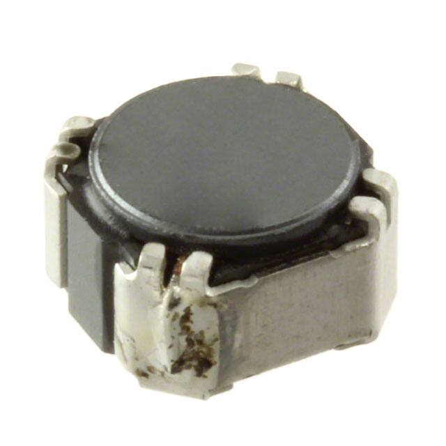

    固定电感器 Nonstandard 47µH ±20% 1A 188mΩ
CDRH8D48/ANP-470MC 数据手册
SMD Power Inductor CDRH8D48/A Description • Ferrite drum core construction. • Magnetically shielded. • L W H: 8.5 8.5 5.0 mm Max. • Product weight:1.1g(Ref.) • Moisture Sensitivity Level: 1 • RoHS compliance. • Qualification to AEC-Q200. RoHS × × Dimension - [mm] 3 0. 8± 1. Max.5.0(Typ.4.8) 8.0±0.5 7.0±0.5 3.0±0.5 1. 65 ± 0. 3 5. 0 ± .08 02 2. .1 x Ma 5 5 . 0 . 0 ±± 0 0 . 3 . 7 9. (5 1±.8 ) 0. 5 Electrode 1. 65 ± 0. 3 Land pattern and Schematics - [mm] 8 .9 2. 3. 5 0 9. 8 × × Environmental Data • Operating temperature range: -40 +125 (including coil’s self temperature rise). +85 • Storage temperature range: -40 • Solder reflow temperature: 260 peak. ℃~ ℃ ℃~ ℃ ℃ Packaging • Carrier tape and reel packaging • 14.5”diameter reel • 1000pcs per reel Applications • Automotive and other high temperature, high reliability application. 2 .3 45 ° 3. 2 Page 1 of 4 Revised: 7-Jan-14 SMD Power Inductor CDRH8D48/A Electrical Characteristics Part No. Stamp CDRH8D48/ANP-100MC 100 CDRH8D48/ANP-120MC 120 CDRH8D48/ANP-150MC 150 CDRH8D48/ANP-180MC 180 CDRH8D48/ANP-220MC 220 CDRH8D48/ANP-270MC 270 CDRH8D48/ANP-330MC 330 CDRH8D48/ANP-390MC 390 CDRH8D48/ANP-470MC 470 CDRH8D48/ANP-560MC 560 CDRH8D48/ANP-680MC 680 CDRH8D48/ANP-820MC 820 CDRH8D48/ANP-101MC 101 CDRH8D48/ANP-121MC 121 CDRH8D48/ANP-151MC 151 Inductance [ H] [Within] 1 μ ※ 10μH±20% 12μH±20% 15μH±20% 18μH±20% 22μH±20% 27μH±20% 33μH±20% 39μH±20% 47μH±20% 56μH±20% 68μH±20% 82μH±20% 100μH±20% 120μH±20% 150μH±20% Ω ℃ D.C.R. (m ) [Max.](Typ.) (at 20 ) Rated current (A) (at 125 ) 2 38(30) 2.26 50(40) 1.87 63(50) 1.62 75(60) 1.58 88(70) 1.45 106(85) 1.33 125(100) 1.20 156(125) 1.06 188(150) 1.00 238(190) 0.89 275(220) 0.82 312(250) 0.73 394(315) 0.70 438(350) 0.63 580(465) 0.58 ℃※ ※1. Inductance measuring condition: at 100 kHz. ※2. Rated current: The DC current at which the inductance decreases to 65% of its nominal value or when △t=30℃, whichever is lower . Page 2 of 4 Revised: 7-Jan-14 SMD Power Inductor CDRH8D48/A Saturation Current & Temperature Rise Graph ℃ L (20 ) μ ℃ △T L (125 ) △T (℃) 1. CDRH8D48/ANP-100MC L ( H) 12 μ △T (℃) 2. CDRH8D48/ANP-120MC L ( H) 60 18 10 50 8 μ L ( H) △T (℃) 3. CDRH8D48/ANP-150MC 60 24 15 50 20 50 40 12 40 16 40 6 30 9 30 12 30 4 20 6 20 8 20 2 10 3 10 4 10 0 0 0 0 0 0 0.0 0.6 1.2 1.8 2.4 3.0 3.6 DC (A) μ △T (℃) 4. CDRH8D48/ANP-180MC L ( H) 24 0.0 0.5 1.0 1.5 2.0 2.5 3.0 DC (A) μ 60 30 20 50 16 0.0 △T (℃) 5. CDRH8D48/ANP-220MC L ( H) 60 μ L ( H) 0.5 1.0 1.5 2.0 DC (A) 2.5 △T (℃) 6. CDRH8D48/ANP-270MC 60 36 25 50 30 50 40 20 40 24 40 12 30 15 30 18 30 8 20 10 20 12 20 4 10 5 10 6 10 0 0 0 0 0 0 0.0 0.5 μ 1.0 1.5 DC (A) 2.0 2.5 △T (℃) 7. CDRH8D48/ANP-330MC L ( H) 48 0.0 0.4 0.8 1.2 1.6 2.0 2.4 DC (A) μ 60 60 40 50 32 0.0 △T (℃) 8. CDRH8D48/ANP-390MC L ( H) 60 μ L ( H) 0.4 0.8 1.2 1.6 DC (A) 2.0 △T (℃) 9. CDRH8D48/ANP-470MC 60 60 50 50 50 50 40 40 40 40 40 24 30 30 30 30 30 16 20 20 20 20 20 8 10 10 10 10 10 0 0 0 0 0 0.0 0.4 μ 0.8 1.2 DC (A) 1.6 2.0 10. CDRH8D48/ANP-560MC L ( H) 90 △T (℃) 0.0 0.3 0.6 0.9 1.2 1.5 1.8 DC (A) μ 11. CDRH8D48/ANP-680MC L ( H) 60 90 75 50 60 60 0 0.0 △T (℃) μ L ( H) 0.4 0.8 1.2 DC (A) 1.6 12. CDRH8D48/ANP-820MC △T (℃) 60 120 75 50 100 50 40 60 40 80 40 45 30 45 30 60 30 30 20 30 20 40 20 15 10 15 10 20 10 0 0 0 0 0 0.0 0.3 0.6 0.9 DC (A) 1.2 1.5 0.0 0.3 0.6 0.9 DC (A) Page 3 of 4 1.2 1.5 60 0 0.0 0.2 0.4 0.6 0.8 1.0 1.2 DC (A) Revised: 7-Jan-14 SMD Power Inductor CDRH8D48/A Saturation Current & Temperature Rise Graph ℃ ℃ L (20 ) μ 120 △T L (125 ) 13. CDRH8D48/ANP-101MC L ( H) △T (℃) μ 14. CDRH8D48/ANP-121MC L ( H) 60 180 100 50 80 △T (℃) μ 15. CDRH8D48/ANP-151MC L ( H) △T (℃) 60 180 150 50 150 50 40 120 40 120 40 60 30 90 30 90 30 40 20 60 20 60 20 20 10 30 10 30 10 0 0 0 0 0.0 0.2 0.4 0.6 0.8 1.0 1.2 DC (A) 0 0.0 0.2 0.4 0.6 DC (A) 0.8 1.0 60 0 0.0 0.2 0.4 0.6 DC (A) 0.8 1.0 Solder Reflow Condition T (℃) 300 250 Heat Endurance 260℃ 230℃ 200 0 60 120 180 240 245℃ PEAK T (s) 40s ± ℃,60~120s 170 10 100 300 ℃ 230 150 60 100 Temperature Chart 200 10 150 50 0 T (℃) 300 250 50 0 0 60 120 180 240 300 T (s) Please refer to the sales offices on our website - http://www.sumida.com Hong Kong Shanghai Shenzhen Taipei Tel.+852-2880-6781 FAX.+852-2565-9600 sales@hk.sumida.com Tel.+86-21-5836-3299 FAX.+86-21-5836-3266 shanghai.sales@cn.sumida.com Tel.+86-755-8291-0228 FAX.+86-755-8291-0338 shenzhen.sales@cn.sumida.com Tel.+886-2-8751-2737 FAX.+886-2-8751-2738 sales@tw.sumida.com Saitama(Japan) Seoul Singapore San Jose Tel.+81-48-691-7300 FAX.+81-48-691-7340 sales@jp.sumida.com Tel.+82-2-6237-0777 FAX.+82-2-6237-0778 sales@kr.sumida.com Tel.+65-6296-3388 FAX.+65-6841-4426 sales@sg.sumida.com Tel.+1-408-321-9660 FAX.+1-408-321-9308 sales@us.sumida.com Chicago Obernzell Neumarkt Tel.+1-847-545-6700 FAX. +1-847-545-6720 sales@us.sumida.com Tel.+49-8591-937-0 FAX. +49-8591-937-103 contact@eu.sumida.com Tel.+49-9181-4509-110 FAX. +49-9181-4509-310 infocomp@eu.sumida.com Page 4 of 4 Revised: 7-Jan-14
