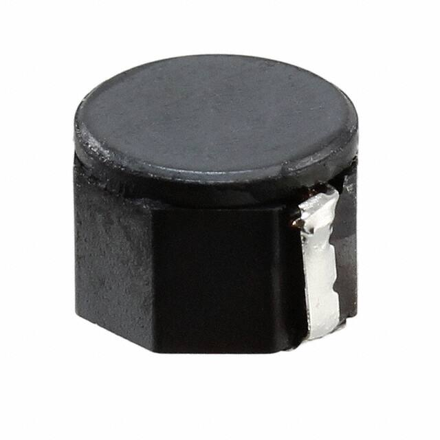

    固定电感器 Nonstandard 47µH ±30% 2.2A 90.5mΩ
CDRH8D58/LDNP-470NC 数据手册
SMD Power Inductor CDRH8D58/LD Description • Ferrite drum core construction. • Magnetically shielded. • L×W×H:8.3×8.3×6.0 mm Max. • Product weight: 1.3g(Ref.) • Moisture Sensitivity Level: 1 • RoHS compliance. RoHS Environmental Data • Operating temperature range: -40℃~+105℃ (including coil’s self temperature rise) • Storage temperature range: -40℃~+105℃ • Solder reflow temperature: 260 ℃ peak. Dimension - [mm] Packaging • Carrier tape and reel packaging • 13”diameter reel • 500pcs per reel Applications • Ideally used in Notebook PC, Game machine, DVD, LCD TV ,STB etc as DC-DC converter inductors. Land pattern and Schematics - [mm] (2.8μH~10μH) (15.0μH~47.0μH) (68μH~100μH) Page 1 of 4 Revised: 9-Jan-17 SMD Power Inductor CDRH8D58/LD Electrical Characteristics Part Name Stamp Saturation Current (A)※2 Inductance (μH) [ within ] ※1 D.C.R. (mΩ) Max. (Typ.) (at 20℃) at 20℃ at 100℃ Temperature Rise Current (A) ※3 CDRH8D58/LDNP-2R8NC 2R8 2.8±30% 15.0(12) 4.7 4.0 6.90 CDRH8D58/LDNP-3R9NC 3R9 3.9±30% 16.3(13) 4.1 3.5 6.30 CDRH8D58/LDNP-5R0NC 5R0 5.0±30% 17.5(14) 3.8 3.1 6.00 CDRH8D58/LDNP-6R2NC 6R2 6.2±30% 20.0(16) 3.3 2.7 5.50 CDRH8D58/LDNP-100NC 100 10±30% 25.6(20.5) 2.6 2.2 4.50 CDRH8D58/LDNP-150NC 150 15±30% 36.3(29.0) 2.3 1.9 3.60 CDRH8D58/LDNP-220NC 220 22±30% 45.3(36.2) 1.7 1.4 3.30 CDRH8D58/LDNP-330NC 330 33±30% 65.3(52.2) 1.5 1.3 2.70 CDRH8D58/LDNP-470NC 470 47±30% 90.5(72.4) 1.2 1.0 2.20 CDRH8D58/LDNP-680NC 680 68±30% 130(104) 1.0 0.9 1.70 CDRH8D58/LDNP-101NC 101 100±30% 175(140) 0.8 0.7 1.40 ※1. Inductance measuring conditions at 100kHz. ※2. Saturation current: The DC current at which the inductance decreases to 65% of its nominal value. ※3. Temperature rise current: The DC current at which the temperature rise is △t=40℃.(Ta=20℃) Page 2 of 4 Revised: 9-Jan-17 SMD Power Inductor CDRH8D58/LD Saturation Current & Temperature Rise Graph L (20℃) L (μH) △T L (100℃) 1. CDRH8D58/LDNP-2R8NC △T (℃) L (μH) 2. CDRH8D58/LDNP-3R9NC △T (℃) 3. CDRH8D58/LDNP-5R0NC L (μH) △T (℃) 6 60 6 60 6 60 5 50 5 50 5 50 4 40 4 40 4 40 3 30 3 30 3 30 2 20 2 20 2 20 1 10 1 10 1 10 0 0 0 0 0 0 0 2 4 DC (A) 6 8 0 2 4 DC (A) 6 8 1 2 3 4 DC (A) 5 L (μH) 9.0 60 12 60 18 60 7.5 50 10 50 15 50 6.0 40 8 40 12 40 4.5 30 6 30 9 30 3.0 20 4 20 6 20 1.5 10 2 10 3 10 0 0 0 0 0 L (μH) 1 2 3 4 DC (A) 5 7. CDRH8D58/LDNP-220NC 6 0 △T (℃) 1 2 3 DC (A) 4 △T (℃) L (μH) 5 6. CDRH8D58/LDNP-150NC 6 4. CDRH8D58/LDNP-6R2NC L (μH) △T (℃) 0.0 5. CDRH8D58/LDNP-100NC 0 △T (℃) 0 0.0 0.6 1.2 1.8 2.4 3.0 3.6 DC (A) 8. CDRH8D58/LDNP-330NC L (μH) △T (℃) L (μH) 9. CDRH8D58/LDNP-470NC △T (℃) 30 60 48 60 60 60 25 50 40 50 50 50 20 40 32 40 40 40 15 30 24 30 30 30 10 20 16 20 20 20 5 10 8 10 10 10 0 0 0 0 0 0 0.0 0.6 1.2 1.8 2.4 3.0 3.6 DC (A) L (μH) 0.0 0.5 1.0 1.5 2.0 2.5 3.0 DC (A) 10. CDRH8D58/LDNP-680NC △T (℃) 0.0 1.0 1.5 DC (A) 2.0 11. CDRH8D58/LDNP-101NC L (μH) △T (℃) 90 60 120 60 75 50 100 50 60 40 80 40 45 30 60 30 30 20 40 20 15 10 20 10 0 0 0 0 0.0 0.3 0.6 0.9 1.2 1.5 1.8 DC (A) 0.5 0.0 0.3 0.6 0.9 DC (A) Page 3 of 4 1.2 1.5 Revised: 9-Jan-17 2.5 SMD Power Inductor CDRH8D58/LD Solder Reflow Condition T (℃) 300 250 Heat Endurance T (℃) 300 250 260℃ 230℃ 200 100 50 0 50 0 60 120 180 240 230℃ 40s 150 60 100 0 245℃ PEAK 200 10 150 Temperature Chart 300 T (s) 170±10 ℃,60~120s 0 60 120 180 240 300 T (s) Please refer to the sales offices on our website - http://www.sumida.com Hong Kong Shanghai Shenzhen Taipei Tel.+852-2880-6781 FAX.+852-2565-9600 sales@hk.sumida.com Tel.+86-21-5836-3299 FAX.+86-21-5836-3266 shanghai.sales@cn.sumida.com Tel.+86-755-8291-0228 FAX.+86-755-8291-0338 shenzhen.sales@cn.sumida.com Tel.+886-2-8751-2737 FAX.+886-2-8751-2738 sales@tw.sumida.com Saitama(Japan) Seoul Singapore San Jose Tel.+81-48-691-7300 FAX.+81-48-691-7340 sales@jp.sumida.com Tel.+82-2-6237-0777 FAX.+82-2-6237-0778 sales@kr.sumida.com Tel.+65-6296-3388 FAX.+65-6841-4426 sales@sg.sumida.com Tel.+1-408-321-9660 FAX.+1-408-321-9308 sales@us.sumida.com Chicago Obernzell Neumarkt Tel.+1-847-545-6700 FAX. +1-847-545-6720 sales@us.sumida.com Tel.+49-8591-937-0 FAX. +49-8591-937-103 contact@eu.sumida.com Tel.+49-9181-4509-110 FAX. +49-9181-4509-310 infocomp@eu.sumida.com Page 4 of 4 Revised: 9-Jan-17

物料型号:SMD Power Inductor CDRH8D58/LD
器件简介:采用铁氧体鼓芯结构,具有磁屏蔽功能,尺寸为8.3×8.3×6.0mm,重量约1.3g,符合RoHS标准。
引脚分配:文档中未提供具体的引脚分配信息。
参数特性:工作温度范围为-40℃至+105℃,存储温度范围同样为-40℃至+105℃,峰值焊接温度为260℃。
功能详解:该电感器适用于笔记本电脑、游戏机、DVD、液晶电视、机顶盒等DC-DC转换器。
应用信息:电感值范围从2.8μH至680μH,具体型号包括2R8、3R9、5R0、6R2、100、150、220、330、470和680μH。
封装信息:采用载带和卷轴包装,卷轴直径为13英寸,每卷500个。
电气特性:包括电感值、直流电阻、饱和电流和温升电流等参数,具体数值根据型号不同而有所变化。
