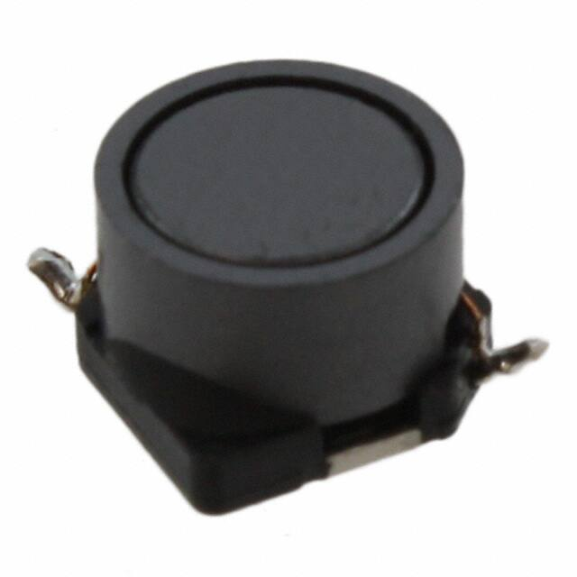

    固定电感器 Nonstandard 470µH ±20% 380mA 1.416Ω
CDRR75NP-471MC 数据手册
SMD Power Inductor CDRR75 Description • Ferrite drum core construction. • Magnetically shielded. • L W H: 7.2 7.2 4.8 mm Max. • Product weight:0.6 g(Ref.) • Moisture Sensitivity Level: 1 • RoHS compliance. • Halogen Free available. • Qualification to AEC-Q200. Environmental Data • Operating temperature range: -40 ~+125 (including coil’s self temperature rise) • Storage temperature range: -40 +125 • Solder reflow temperature: 260 peak. Packaging • Carrier tape and reel packaging • 13.0”diameter reel • 1000pcs per reel RoHS Halogen Free Dimension - [mm] 0 .2 1 . 0 5 3.0± 5.4 Land pattern and Schematics - [mm] Applications • For consumer electronics :HDD, personal computer, LCD display, etc. • For automotive: ABS, SRS airbag, HID/LED, car audio, car navigation, LCD display, etc. 2.2 S Page 1 of 4 Revised: 27-Jul-11 ℃ ℃ ℃ ~℃ ℃ ×× ×× 1 4 . 9 1.0 2 1 . 5 4 . 9 1 . 5 3.0± 9.6 6 . 9 ± 0 . 3 SMD Power Inductor CDRR75 Electrical Characteristics CDRR75NP-4R7MC CDRR75NP-6R8MC CDRR75NP-1ØØMC CDRR75NP-15ØMC CDRR75NP-22ØMC CDRR75NP-33ØMC CDRR75NP-47ØMC CDRR75NP-68ØMC CDRR75NP-1Ø1MC CDRR75NP-151MC CDRR75NP-221MC CDRR75NP-331MC CDRR75NP-471MC CDRR75NP-681MC CDRR75NP-1Ø2MC 4R7 6R8 100 150 220 330 470 680 101 151 221 331 471 681 102 4.7 6.8 10 15 22 33 47 68 100 150 220 330 470 680 1000 20% 1. Measuring condition: at 100 kHz. 2. Saturation current: The value of D.C. current when the inductance decreases to 90% of it’s nominal value. Page 2 of 4 ℃ = ℃ =△ 3. Temperature rise current: The value of D.C. current when the temperature rise is ± ± ± ± ± ± ± ± ± ± ± ± ± ± ± ± CDRR75NP-3R3MC 3R3 3.3 20% 20% 20% 34m (27m) 39m (31m) 43m (34m) 57m (45m) 63m (50m) 85m (68m) 0.119 (95m) 0.190 (0.152) 0.256 (0.205) 0.315 (0.252) 0.485 (0.388) 0.721 (0.577) 1.050 (0.842) 1.416 (1.180) 1.866 (1.555) 3.056 (2.546) 2.10(2.64) 2.04(2.55) 1.80(2.25) 1.55(1.94) 1.46(1.83) 1.32(1.65) 1.15(1.44) 0.96(1.21) 0.76(0.96) 0.60(0.75) 0.53(0.67) 0.44(0.55) 0.36(0.46) 0.29(0.37) 0.25(0.32) 0.20(0.26) 0.16(0.20) 0.14(0.16) 1.30(1.63) 1.02(1.28) 0.94(1.18) 0.74(0.93) 0.60(0.75) 0.48(0.60) 0.43(0.54) 0.35(0.44) 0.29(0.37) 0.25(0.31) 0.20(0.26) 0.16(0.20) 0.12(0.15) 0.10(0.13) 20% 20% 20% 20% 20% 20% 20% 20% 20% 20% 20% 20% t 40 (Ta 20 Revised: 27-Jul-11 ℃ ). ℃ (at 20 ) (at 105 ) 3.30(3.76) 2.80(3.20) 2.55(2.90) 2.40(2.73) 2.07(2.38) 1.70(1.93) 1.39(1.59) 1.08(1.25) 0.93(1.06) 0.83(0.94) 0.66(0.75) 0.54(0.62) 0.45(0.52) 0.38(0.43) 0.31(0.36) 0.22(0.26) ※ ※ μ Part No. Stamp ※ ℃ Ω Inductance ( H) [Within] 1 D.C.R. ( ) [Max.](Typ.) (at 20 ) Saturation current (A) 2 Temperature rise current (A) 3 ※ ※ ※ 8.0 0 01 02 03 04 05 06 6.0 4.0 2.0 0.0 0 05 001 051 002 052 003 0 01 02 03 04 05 06 8.0 6.0 4.0 2.0 0.0 0 03 06 09 021 051 081 0 01 02 03 04 05 06 0.1 8.0 6.0 2.1 0.1 8.0 6.0 4.0 2.0 0.0 0 01 02 03 04 05 06 0 51 03 54 06 57 09 0 01 02 03 04 05 06 5.1 2.1 9.0 6.0 3.0 0.0 0 01 02 03 04 05 06 0 01 02 03 04 05 06 6.1 2.1 8.0 4.0 0.2 0 01 02 03 04 05 06 6.1 2.1 8.0 4.0 0.0 0 5 01 51 02 52 03 0 01 02 03 04 05 06 5.2 0.2 5.1 0.1 5.0 0.0 0 3 6 9 21 51 81 0 01 02 03 04 05 06 0.3 5.2 0.2 5.1 0.1 5.0 0.0 0 2 4 6 8 01 21 0.3 5.2 0.2 5.1 0.1 5.0 0.0 0 01 02 03 04 05 06 0.0 5.1 0.3 5.4 0.6 5.7 0.9 0 01 02 03 04 05 06 6.3 0.3 4.2 8.1 2.1 6.0 0.0 0 1 2 3 4 5 6 0 01 02 03 04 05 06 4 3 2 1 SMD Power Inductor CDRR75 Saturation Current & Temperature Rise Graph L (20 ) L (125 ) △ ℃ ℃ L ( H) 1. CDRR75NP-3R3MC T( ) L ( H) 2. CDRR75NP-4R7MC T T( ) L ( H) 3. CDRR75NP-6R8MC ℃△ μ ℃△ μ ℃△ L ( H) 4. CDRR75NP-100MC DC (A) T( ) L ( H) 5. CDRR75NP-150MC DC (A) T( ) L ( H) 6. CDRR75NP-220MC ℃△ μ ℃△ μ ℃△ L ( H) 7. CDRR75NP-33OMC DC (A) T( ) L ( H) 8. CDRR75NP-470MC DC (A) T( ) L ( H) 9. CDRR75NP-680MC ℃△ μ ℃△ μ ℃△ L ( H) 10. CDRR75NP-101MC DC (A) T( ) L ( H) 11. CDRR75NP-151MC DC (A) T( ) L ( H) 12. CDRR75NP-221MC ℃△ μ ℃△ μ ℃△ DC (A) 4.0 Page 3 of 4 DC (A) 2.0 0.0 0 02 04 06 08 001 021 Revised: 27-Jul-11 DC (A) DC (A) DC (A) DC (A) T( ) T( ) T( ) T( ) μ 0.0 0 8 61 42 23 04 84 μ μ 0 0.0 8.0 6.1 4.2 2.3 0.4 8.4 μ SMD Power Inductor CDRR75 Saturation Current & Temperature Rise Graph 13. CDRR75NP-331MC 14. CDRR75NP-471MC DC (A) DC (A) DC (A) DC (A) Solder Reflow Condition Heat Endurance 052 003 )℃( T ℃062 052 003 )℃( T Please refer to the sales offices on our website - http://www.sumida.com Hong Kong Tel.+852-2880-6688 FAX.+852-2565-9600 sales@hk.sumida.com Shanghai Tel.+86-021-5836-3299 FAX.+86-021-5836-3266 shanghai.sales@cn.sumida.com Shenzhen Tel.+86-755-8291-0228 FAX.+86-755-8291-0338 shenzhen.sales@cn.sumida.com Taipei Tel.+886-2-8751-2737 FAX.+886-2-8751-2738 sales@tw.sumida.com Tokyo Tel.+81-3-5202-7112 FAX.+81-3-5202-7105 sales@jp.sumida.com Seoul Tel.+82-2-6237-0777 FAX.+82-2-6237-0778 sales@kr.sumida.com Singapore Tel.+65-6296-3388 FAX.+65-6296-3390 sales@sg.sumida.com San Jose Tel.+1-408-3219660 FAX.+1-408-321-9308 sales@us.sumida.com Chicago Tel.+1-847-545-6700 FAX. +1-847-545-6720 sales@us.sumida.com Obernzell Tel.+49-8591-937-0 FAX. +49-8591-937-103 contact@sumida-eu.com Neumarkt Tel.+49-9181-4509-110 FAX. +49-9181-4509-310 infocomp@eu.sumida.com Page 4 of 4 Revised: 27-Jul-11 )s( T 003 042 081 ℃± 170 10 ,60~120s ℃ KAEP ℃542 s04 021 06 0 002 051 001 0 05 )s( T ℃032 003 01 06 042 06 05 04 03 02 01 ℃△ L ( H) 16. CDRR75NP-102MC T( ) Temperature Chart 230 ℃△ 06 05 04 03 02 01 0 4.0 3.0 2.0 1.0 0.0 μ 0 009 057 006 054 003 051 ℃△ 06 05 04 03 02 01 0 5.0 4.0 3.0 2.0 1.0 0.0 μ 0 006 005 004 003 002 001 06 05 04 03 02 01 ℃△ 0 0 081 L ( H) T( ) L ( H) △ ℃ L (20 ) 03.0 52.0 02.0 51.0 01.0 50.0 00.0 6.0 5.0 4.0 3.0 2.0 1.0 0.0 ℃ L (125 ) T T( ) L ( H) 15. CDRR107NP-681MC T( ) 021 06 0 0021 0001 008 006 004 002 0 002 051 001 μ μ 0 0 05 063 003 042 081 021 06
