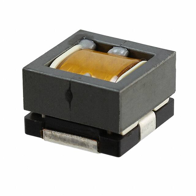

    固定电感器 Nonstandard 1µH ±20% 20A 1.2mΩ
CEPH149NP-1R0MC 数据手册
Power Inductor< SMD Type : CEPH Series> Type:CEPH149 ◆Product Description ・15.0×15.0mm Max.(L×W),10.0mm Max. Height. ・Inductance range: 1.0~2.4μH. ・Rated current range: 10~20A ・In addition to the standards versions shown here, custom inductors are also available to meet your exact requirements. ◆ Feature ・High Current Inductors ・Mn-Zn core used, ideally used in computer CPU,Server,etc power supply. ・RoHS Compliance ◆ Dimensions (mm) 1 4. 6 ± 0. 4 9 .6 ± 0 .4 4 .0 ± 0 .3 1 4 .6 ± 0 . 4 8. 0 ± 0. 4 ( 5 .5 ) ◆ Land Pattern (mm) 4.4 ' A ◆ Schematics(Bottom) ③ 2. 8 2.8 ② 1 5. 6 9.4 8.4 ① A D I M E N TI O N O F C E P H 14 9 Please refer to the sales offices on our website for a representative near you www.sumida.com ( 1 0 .0 ) 1/2 Power Inductor< SMD Type : CEPH Series> Type:CEPH149 ◆ Specification Inductance Part Name Stamp [Within] 100 kHz. CEPH149NP-1RØMC CEPH149NP-1R6MC CEPH149NP-2R4MC 1R0M 1R6M 2R4M 1.0μH ± 20% 1.6μH ± 20% 2.4μH ± 20% D.C.R.(mΩ) Max.(Typ.) (at 20℃) 1.2(0.99) 1.5(1.24) 1.5(1.24) Rated current (A) ※1 20.0 15.5 10.0 ※1 Rated current: The DC current at which the inductance decreases to 90 % of it's initial value or when △t=40℃, whichever is lower(Ta=20℃). Please refer to the sales offices on our website for a representative near you www.sumida.com 2/2
