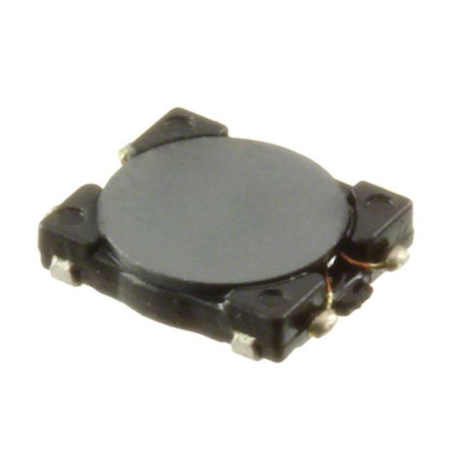

    固定电感器 Nonstandard 4.7µH ±20% 1.2A 106mΩ
CMD5D13NP-4R7MC 数据手册
Power Transformers Type: CMD5D13 ◆ Product Description ・7.4×5.8mm Max.(L×W),1.5mm Max. Height. ・Inductance range: 3.3~47μH. ・Rated current range: 0.35~1.25A. ・4 Terminal pins’ type gives a flexible design as inductors or transformers(SEPIC,ZETA circuit). ・In addition to the standards versions used as power inductors shown here, custom designs as transformers(SEPIC,ZETA circuit) and inductors are also available. ◆ Feature ・Magnetically unshielded construction. ・Ideally used in portable devices such as Mobilephone,DSC/DVC,MP3,PDA, etc as DC-DC Converter inductors, specially suitable for White LED drive. ・RoHS Compliance. ◆ Dimensions (mm) 1.5 Max. φ5.5±0.3 2 . 0 ± 0 . 6 5.5±0.3 2 . 0 ± 6 . 0 4 . 0 ± 0 . 7 ※ 3 . 0 ± 5 . 4 4.2±0.4 ◆ Land Pattern (mm) 1.1 ◆ Schematics(Bottom) 3.4 (2) S (2) (3) 2 3 1 4 S (3) S 2 3 1 4 6 . 3 4 . 1 (1) (4) (1) (4) μ ~15μH) (22μH~47μH) “S" is winding start. (3.3 H Terminal Pins(1#) and (4#),(2#) and (3#) are short connected when used as an inductor. Please refer to the sales offices on our website for a representative near you www.sumida.com 1/2 Power Transformers Type: CMD5D13 ◆ Specification Inductance Part No. ※ Stamp □ CMD5D13NP-4R7M□ CMD5D13NP-6R8M□ CMD5D13NP-100M□ CMD5D13NP-150M□ CMD5D13NP-220M□ CMD5D13NP-330M□ CMD5D13NP-470M□ CMD5D13NP-3R3M 3R3 4R7 6R8 100 150 220 330 470 Ω ℃ 100kHz/1V D.C.R.(m ) Max.(Typ.) (at 20 ) Saturation Current A 1 ( )※ Temperature Rise current (A) 2 3.3 20% 81 (65) 1.90 1.25 106 (85) 1.50 1.20 144 (115) 1.40 0.90 187 (150) 1.00 0.85 300 (240) 0.95 0.57 431 (345) 0.80 0.54 637 (510) 0.70 0.38 875 (700) 0.55 0.35 (μH)[Within] ± 4.7±20% 6.8±20% 10±20% 15±20% 22±20% 33±20% 47±20% ※ Terminal Pins(1#) and (4#),(2#) and (3#) are short connected when measuring. ※ Description of Part Name CMD5D13NP-3R3M□ B Box C Carrier Tape ※1.Saturation current: The DC current at which the inductance decreases to 90% of it’s initial value. ※2.Temperature rise current: The DC current at which the temperature rise is △t=40℃.(Ta=20℃) Please refer to the sales offices on our website for a representative near you www.sumida.com 2/2
