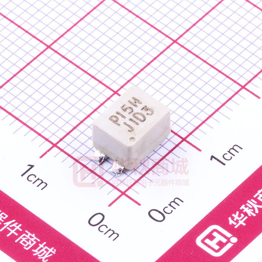

CPFC74NP-PS10H2A15
CPFC74NP-PS10H2A15
    SUMIDA(胜美达)
    CHOKE_7X5.7MM_SM
    共模电感 1.5A 120mΩ 700Ω CHOKE_7X5.7MM_SM
CPFC74NP-PS10H2A15 数据手册
DC COMMON MODE CHOKE COIL Type: CPFC74 ◆ Product Description ・9.5×5.7mm Max.(L×W), 5.1mm Max. Height . ◆ Feature ・Ideally used in CAN BUS ,AV,OA equipment. ・RoHS Compliance ◆ Dimensions (mm) 0.15 1.3±0.1 2.54±0.15 5.5±0.2 7.0±0.2 5.08 MAX. 6.4±0.2 9.5 MAX. * Dimension does not include solder used on coil. ◆ Land Pattern (mm) 1.6 1.8 ◆ Schematics (Bottom) ② 2.54 ③ ② ③ or ① ④ ① ④ 6.7 9.9 MARK OF POLARITY MARK OF POLARITY ◆ Specification (For CAN bus) Part Name. Stamp Insulation Impedance (Ω) Resistance (L1,L2 Parallel) (MΩ)(Coil-Coil) (10~100MHz) (DC80V 1min) 1000 MIN. 800 MIN. 100 MIN. 100 MIN. Withstanding Voltage (coil-coil) (5sec) 200V DC 200V DC D.C.R. (Ω) (1-2)at 20℃ (3-4) short ※ 0.6 MAX. 0.5 MAX. CPFC74NP-CB1ØM4 CPFC74NP-CBØ8M6 C10M C08M ※ D.C.R. is measured by 2 lines as series because impedance will be deteriorated when D.C.R. is measured by 1 line. Please refer to the sales offices on our website for a representative near you www.sumida.com 1/2 DC COMMON MODE CHOKE COIL Type: CPFC74 ◆ Specification (For Power supply) Impedance (Ω) Stamp (L1,L2 Parallel) Insulation Resistance (MΩ)(Coil-Coil) (DC100V 1min.) 10 MIN. 10 MIN. 10 MIN. 10 MIN. Withstanding Voltage (Coil-Coil) (5sec) D.C.125V D.C.125V D.C.125V D.C.125V D.C.R. (mΩ) (1-2)at 20℃ (3-4) Short ※2 120 120 120 60 Rated Current (1-2)(A) (3-4) Short ※1 1.5 2.0 2.5 3.0 Part Name. CPFC74NP-PS1ØH2A15 CPFC74NP-PSØ2H2A2Ø CPFC74NP-PSØ3H2A25 CPFC74NP-PSØ1H2A3Ø P15H P20H P25H P30H 700 MIN. (100 MHz) 200 MIN. (20~300MHz) 300 MIN. (160 MHz) 100 MIN. ※1: Rated current: The DC current at which the temperature rise is △t=40℃.(Ta=20℃). ※2: D.C.R is measured by 2 lines as series because impedance will be deteriorated when D.C.R. is measured by 1 line. Please refer to the sales offices on our website for a representative near you www.sumida.com 2/2
