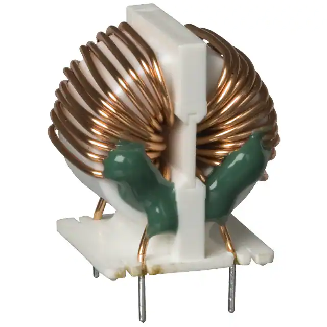

AC COMMON MODE COIL Type: PFC2225B ◆ Product Description ・25.0×20.0mm Max.(L×W), 27.0mm Max. Height . ・Inductance range: 0.8mH~7mH ・Rated current range:3.0A~8.0A ・In addition to the standard versions of parameters shown here, custom designs are available to meet your exact requirements. ◆ Feature ・Safety standard conformance such as UL. ・Ideally used in TV, VCRs, OA devices. ・RoHS Compliance ◆ Dimensions (mm) (A1:10.0) (B1:16.0) (B2:15.0) ( A2:1 4.0) 25.0 MAX. 20.0 MAX. B 1 : 1 6 .0 A1:10.0 5.0 ± 2.0 φ WIRE SIZE±0.1 B 2 : 1 5. 0 27.0 MAX. NO SOLDER PROCESSING 1.5 MAX. AD HESI VE A2:14.0 * Wiring-channel position for terminals of part name 801,152 and dimension A1,B1 * Wiring-channel position for terminals of part name 402,502,702,502B,702B and dimension A2,B2 * Dimension does not include solder used on coil. ◆ Schematics (Bottom) ② ③ ① ④ * Winding start is #1,#4 or #2,#3. * #1, #2:should have same polarity. Please refer to the sales offices on our website for a representative near you www.sumida.com 1/2 AC COMMON MODE COIL Type: PFC2225B ◆ Specification Part Name Stamp Inductance Inductance [MIN.](mH) Balance (1-2) or ( 4-3) [MAX.](μH) 1kHz/0.1V D.C.R. (mΩ) [MAX.] (1-2) or (4-3) (at 20℃) Rated current (50/60Hz) (Arms)(1-4) (2and 3 To Be Shorted)※1 PFC2225BNP-8Ø1 801 0.8 50 12.5 8.0 PFC2225BNP-152 152 1.5 80 26.0 5.0 PFC2225BNP-4Ø2 402 4.0 100 54.0 4.0 PFC2225BNP-5Ø2 502 5.0 150 81.0 3.0 PFC2225BNP-7Ø2 702 7.0 200 135.0 2.5 PFC2225BNP-5Ø2B 502B 5.0 150 61.0 3.5 PFC2225BNP-7Ø2B 702B 7.0 200 70.0 3.0 ※1. Rated current: The AC current at which the temperature rise is △t=60℃.(Ta=20℃). Please refer to the sales offices on our website for a representative near you www.sumida.com 2/2
