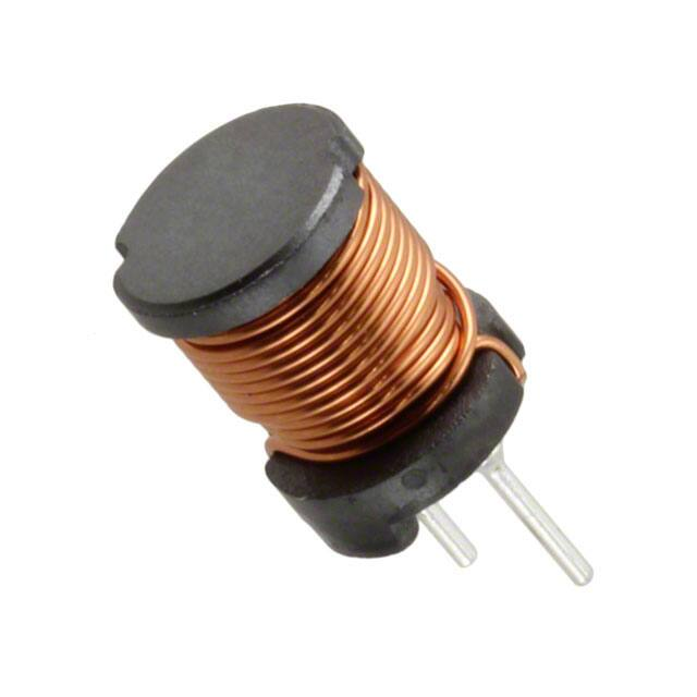

PIN Power Inductor
RCH8011
Description
• Ferrite drum core construction.
• Magnetically unshielded.
• L×W×H: 8.3×8.3×10.8mm Max.
• Product weight: 1.6 g(Ref.)
• Moisture Sensitivity Level: 1
• RoHS compliance.
RoHS
Environmental Data
• Operating temperature range: -30℃~+100℃
(including coil’s self temperature rise)
• Storage temperature range: -30℃~+100℃
MAX.10.8
5.0
1.0
5.0±0.3
+0.1
φ0.7-0.05
Dimension - [mm]
φ7.8±0.5
Packaging
• Box packaging.
Applications
• Ideally used in Printers, LCD TV, DVD, Copy
Machine, Mainboard of the compounding
machines etc. as DC-DC Converter inductors.
Schematics - [mm]
Page 1 of 5
Revised: 10-Jan-17
PIN Power Inductor
RCH8011
