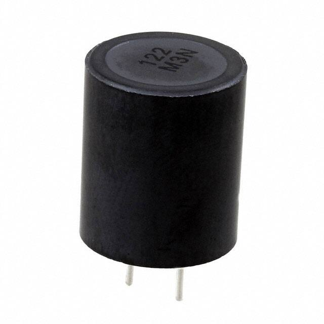

    固定电感器 Radial, Vertical Cylinder 1.5mH ±15% 720mA 1.4Ω
RCP1317NP-152L 数据手册
POWER INDUCTORS < Pin Type: RCP Series > Type: RCP1317 ◆ Product Description ・13.5mm Max.φ, 17.5mm Max.height. ・Inductance range :33μH~4.7mH. ・Rated Current Range: 0.37~3.6A. ◆ Feature ・Magnetically shielded construction. ・Ideally Used in Printers, LCD TV, Copy Machine, Mainboard of the compounding machines, etc as Power Supplies’s Inductors or DC-DC Converter inductors. ・RoHS Compliance ◆ Dimensions (mm) 5.0±0.5 17.5 MAX. 4.8±1.0 13.5 MAX. Please refer to the sales offices on our website for a representative near you www.sumida.com φ0.7±0.1 1/2 POWER INDUCTORS < Pin Type: RCP Series > Type: RCP1317 ◆ Specification Part No. Stamp Inductance (at 1 kHz) 33μH±20% 47μH±20% 68μH±20% 82μH±20% 100μH±20% 120μH±15% 150μH±15% 180μH±15% 220μH±15% 270μH±15% 330μH±15% 390μH±15% 470μH±15% 560μH±15% 680μH±15% 820μH±15% 1.0mH±15% 1.2mH±15% 1.5mH±15% 1.8mH±15% 2.2mH±15% 2.7mH±15% 3.3mH±15% 3.9mH±15% 4.7mH±15% D.C.R.(Ω) Max.(Typ.) (at 20℃) 58m (46m) 69m (55m) 101m (81m) 110m (88m) 125m (100m) 139m (116m) 195m (156m) 213m (171m) 278m (223m) 0.33 (0.26) 0.36 (0.29) 0.44 (0.35) 0.53 (0.42) 0.59 (0.47) 0.78 (0.62) 0.95 (0.76) 1.18 (0.94) 1.28 (1.07) 1.40 (1.16) 2.00 (1.70) 2.28 (1.90) 3.07 (2.56) 3.31 (2.76) 4.52 (3.77) 5.02 (4.18) Saturation current※1 (at 20℃) 4.80 4.30 3.30 3.10 2.80 2.60 2.40 2.20 1.90 1.70 1.60 1.45 1.35 1.25 1.12 1.02 0.90 0.80 0.72 0.68 0.62 0.58 0.51 0.47 0.43 (at 100℃) 4.40 3.80 3.00 2.70 2.50 2.30 2.10 1.80 1.70 1.60 1.40 1.28 1.17 1.05 0.95 0.85 0.70 0.65 0.60 0.56 0.52 0.50 0.45 0.42 0.37 Temperature rise current (A)※2 3.60 3.30 2.60 2.50 2.30 2.20 1.90 1.80 1.60 1.55 1.50 1.30 1.15 1.10 1.00 0.85 0.82 0.74 0.72 0.58 0.52 0.48 0.45 0.42 0.37 RCP1317NP-33ØM RCP1317NP-47ØM RCP1317NP-68ØM RCP1317NP-82ØM RCP1317NP-1Ø1M RCP1317NP-121L RCP1317NP-151L RCP1317NP-181L RCP1317NP-221L RCP1317NP-271L RCP1317NP-331L RCP1317NP-391L RCP1317NP-471L RCP1317NP-561L RCP1317NP-681L RCP1317NP-821L RCP1317NP-1Ø2L RCP1317NP-122L RCP1317NP-152L RCP1317NP-182L RCP1317NP-222L RCP1317NP-272L RCP1317NP-332L RCP1317NP-392L RCP1317NP-472L 330 470 680 820 101 121 151 181 221 271 331 391 471 561 681 821 102 122 152 182 222 272 332 392 472 ※1.Saturation current: The D.C. current at which the inductance decreases to 65% of it’s initial value. ※2.Temperature rise current: The D.C. current at which the temperature rise is △T=40℃(Ta=20℃). Please refer to the sales offices on our website for a representative near you www.sumida.com 2/2
