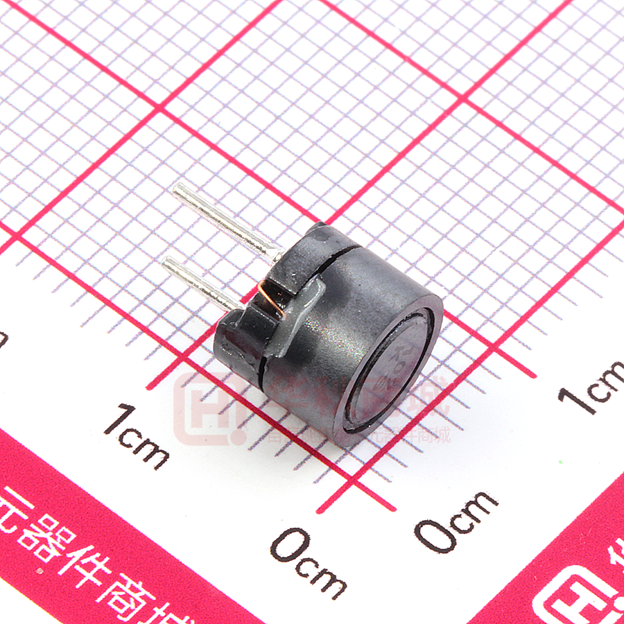

    固定电感器 IND_D7.8X7.5MM_TM 1mH ±10% 230mA Φ7.80 x 7.50mm 7.50mm 2.72Ω
RCR875DNP-102K 数据手册
PIN Power Inductor RCR-875D Description • Ferrite drum core construction. • Magnetically shielded. • L×W×H: 8.3×8.3×7.5mm Max. • Product weight: 1.3g(Ref.) • Moisture Sensitivity Level: 1 • RoHS compliance. RoHS Environmental Data • Operating temperature range: -40℃~+85℃ (including coil’s self temperature rise) • Storage temperature range: -40℃~+85℃ MAX.7.5 ± 1.0 5.0 5.0±0.3 +0.1 φ0.7-0.05 Dimension - [mm] φ 7.8± 0.5 Packaging • Box packaging. Applications • Ideally used in Printers, LCD TV, DVD, Copy Machine, Mainboard of the compounding machines etc. as DC-DC Converter inductors. Schematics - [mm] Page 1 of 7 Revised: 10-Jan-17 PIN Power Inductor RCR-875D Electrical Characteristics Part Name Stamp Inductance (μH ) [Within] ※1 D.C.R. (Ω) [Max.] at 20℃ Rated Current (mA) ※2 RCR875DNP-1R2L RCR875DNP-1R7L RCR875DNP-2R3L RCR875DNP-3R0L 1R2L 1R7L 2R3L 3R0L 1.2μH ± 15% 1.7μH ± 15% 2.3μH ± 15% 3.0μH ± 15% 18 m 22 m 25 m 28m 4140 3750 3450 3250 RCR875DNP-3R9L RCR875DNP-4R7L RCR875DNP-5R6L 3R9L 4R7L 5R6L 3.9μH ± 15% 4.7μH ± 15% 5.6μH ± 15% 31m 35m 39m 3080 2940 2820 RCR875DNP-7R0L RCR875DNP-8R2L RCR875DNP-100L RCR875DNP-120L 7R0L 8R2L 100L 120L 7.0μH ± 15% 8.2μH ± 15% 10μH ± 15% 12μH ± 15% 43m 47m 50m 54m 2680 2550 2400 2250 RCR875DNP-150L RCR875DNP-180L 150L 180L 15μH ± 15% 18μH ± 15% 62m 71m 1950 1780 RCR875DNP-220L RCR875DNP-270L RCR875DNP-330L RCR875DNP-390L 220L 270L 330L 390L 22μH ± 15% 27μH ± 15% 33μH ± 15% 39μH ± 15% 0.08 0.10 0.14 0.15 1600 1400 1300 1200 RCR875DNP-470L RCR875DNP-560K RCR875DNP-680K RCR875DNP-820K 470L 560K 680K 820K 47μH ± 15% 56μH ± 10% 68μH ± 10% 82μH ± 10% 0.17 0.19 0.21 0.27 1100 990 890 810 RCR875DNP-101K RCR875DNP-121K RCR875DNP-151K RCR875DNP-181K 101K 121K 151K 181K 100μH ± 10% 120μH ± 10% 150μH ± 10% 180μH ± 10% 0.32 0.36 0.51 0.57 740 670 600 550 RCR875DNP-221K RCR875DNP-271K RCR875DNP-331K RCR875DNP-391K 221K 271K 331K 391K 220μH ± 10% 270μH ± 10% 330μH ± 10% 390μH ± 10% 0.76 0.86 0.97 1.28 500 450 410 370 RCR875DNP-471K RCR875DNP-561K RCR875DNP-681K RCR875DNP-821K 471K 561K 681K 821K 470μH ± 10% 560μH ± 10% 680μH ± 10% 820μH ± 10% 1.44 1.61 2.07 2.33 340 310 280 260 RCR875DNP-102K RCR875DNP-122K RCR875DNP-152K RCR875DNP-182K 102K 122K 152K 182K 1.0 mH ± 10% 1.2 mH ± 10% 1.5 mH ± 10% 1.8 mH ± 10% 2.72 3.98 4.50 6.81 230 210 190 170 RCR875DNP-222K RCR875DNP-272K RCR875DNP-332K RCR875DNP-392K 222K 272K 332K 392K 2.2 mH ± 10% 2.7 mH ± 10% 3.3 mH ± 10% 3.9 mH ± 10% 7.56 8.54 9.74 12.9 160 140 130 120 RCR875DNP-472K RCR875DNP-562K RCR875DNP-682K RCR875DNP-822K 472K 562K 682K 822K 4.7 mH ± 10% 5.6 mH ± 10% 6.8 mH ± 10% 8.2 mH ± 10% 14.7 20.4 23.0 30.6 110 99 89 81 RCR875DNP-103K 103K 10 mH ± 10% 35.0 74 ※1:Inductance Measuring frequency: 100μH ~ 10 mH(1kHz); 1.2μH ~ 82μH( 2.52 MHz) ※2:Rated current: The DC current at which the inductance decreases 90% of it’s initial value or when △t=40℃,whichever is lower (Ta=20℃). Page 2 of 7 Revised: 10-Jan-17 PIN Power Inductor RCR-875D Saturation Current & Temperature Rise Graph L (20℃) △T L (100℃) 1. RCR875DNP-1R2L L (μH) 1.8 △T (℃) 60 L (μH) 1.8 2. RCR875DNP-1R7L △T (℃) 60 L (μH) 3.6 3. RCR875DNP-2R3L △T (℃) 60 1.5 50 1.5 50 3.0 50 1.2 40 1.2 40 2.4 40 0.9 30 0.9 30 1.8 30 0.6 20 0.6 20 1.2 20 0.3 10 0.3 10 0.6 10 0 0.0 0 0.0 0.0 0 2 4 6 8 DC (A) 10 4. RCR875DNP-3R0L L (μH) 3.6 12 0 △T (℃) 60 L (μH) 4.8 2 4 6 DC (A) 8 10 5. RCR875DNP-3R9L 0 12 0 △T (℃) 60 L (μH) 6 2 4 6 8 DC (A) 6. RCR875DNP-4R7L 10 △T (℃) 60 3.0 50 4.0 50 5 50 2.4 40 3.2 40 4 40 1.8 30 2.4 30 3 30 1.2 20 1.6 20 2 20 0.6 10 0.8 10 1 10 0 0.0 0 0 0.0 0 2 4 6 DC (A) 8 7. RCR875DNP-5R6L L (μH) 6 0 △T (℃) 60 L (μH) 12 2 4 6 DC (A) 0 8 8. RCR875DNP-7R0L 0 △T (℃) 60 2 L (μH) 12 4 6 DC (A) 8 9. RCR875DNP-8R2L △T (℃) 60 5 50 10 50 10 50 4 40 8 40 8 40 3 30 6 30 6 30 2 20 4 20 4 20 1 10 2 10 2 10 0 0 0 0 0 0 2 4 6 DC (A) 8 10. RCR875DNP-100L L (μH) 12 0 △T (℃) 60 L (μH) 12 1 2 3 DC (A) 4 5 11. RCR875DNP-120L 6 0 0 △T (℃) 60 L (μH) 18 1 2 3 DC (A) 4 5 12. RCR875DNP-150L 6 △T (℃) 60 10 50 10 50 15 50 8 40 8 40 12 40 6 30 6 30 9 30 4 20 4 20 6 20 2 10 2 10 3 10 0 0 0 0 0 0 1 2 DC (A) 3 4 5 0 1 2 3 DC (A) Page 3 of 7 4 5 0 0 1 2 3 DC (A) Revised: 10-Jan-17 4 PIN Power Inductor RCR-875D Saturation Current & Temperature Rise Graph L (20℃) △T L (100℃) 13. RCR875DNP-180L L (μH) 18 △T (℃) 60 L (μH) 24 14. RCR875DNP-220L △T (℃) 60 L (μH) 36 15. RCR875DNP-270L △T (℃) 60 15 50 20 50 30 50 12 40 16 40 24 40 9 30 12 30 18 30 6 20 8 20 12 20 3 10 4 10 6 10 0 0 0 0 0 0 1 2 3 DC (A) 4 16. RCR875DNP-330L L (μH) 36 0 △T (℃) 60 L (μH) 48 1 2 3 DC (A) 17. RCR875DNP-390L 4 0 0.0 △T (℃) 60 L (μH) 60 0.5 1.0 1.5 DC (A) 2.0 2.5 18. RCR875DNP-470L 3.0 △T (℃) 60 30 50 40 50 50 50 24 40 32 40 40 40 18 30 24 30 30 30 12 20 16 20 20 20 6 10 8 10 10 10 0 0 0 0 0 0.0 0.5 1.0 1.5 DC (A) 2.0 2.5 19. RCR875DNP-560K L (μH) 60 3.0 0.0 △T (℃) 60 L (μH) 90 0.5 1.0 1.5 2.0 DC (A) 20. RCR875DNP-680K 2.5 0 0.0 △T (℃) 60 L (μH) 90 0.5 1.0 1.5 DC (A) 2.0 21. RCR875DNP-820K 2.5 △T (℃) 60 50 50 75 50 75 50 40 40 60 40 60 40 30 30 45 30 45 30 20 20 30 20 30 20 10 10 15 10 15 10 0 0 0 0 0 0.0 0.5 1.0 DC (A) 1.5 22. RCR875DNP-101K L (μH) 120 2.0 0.0 △T (℃) 60 L (μH) 180 0.5 1.0 DC (A) 1.5 23. RCR875DNP-121K 2.0 0 0.0 △T (℃) 60 L (μH) 180 0.3 0.6 0.9 DC (A) 1.2 24. RCR875DNP-151K 1.5 △T (℃) 60 100 50 150 50 150 50 80 40 120 40 120 40 60 30 90 30 90 30 40 20 60 20 60 20 20 10 30 10 30 10 0 0 0 0 0 0.0 0.3 0.6 0.9 DC (A) 1.2 1.5 0.0 0.3 0.6 0.9 DC (A) Page 4 of 7 1.2 1.5 0 0.0 0.2 0.4 0.6 0.8 1.0 DC (A) Revised: 10-Jan-17 1.2 PIN Power Inductor RCR-875D Saturation Current & Temperature Rise Graph L (20℃) △T L (100℃) 25. RCR875DNP-181K L (μH) 180 △T (℃) 60 L (μH) 240 26. RCR875DNP-221K △T (℃) 60 L (μH) 360 27. RCR875DNP-271K △T (℃) 60 150 50 200 50 300 50 120 40 160 40 240 40 90 30 120 30 180 30 60 20 80 20 120 20 30 10 40 10 60 10 0 0 0 0 0 0.0 0.2 0.4 0.6 0.8 DC (A) 1.0 28. RCR875DNP-331K L (μH) 360 1.2 0.0 △T (℃) 60 L (μH) 480 0.2 0.4 0.6 0.8 DC (A) 29. RCR875DNP-391K 1.0 0 0.0 △T (℃) 60 L (μH) 480 0.2 0.4 0.6 0.8 DC (A) 30. RCR875DNP-471K 1.0 △T (℃) 60 300 50 400 50 400 50 240 40 320 40 320 40 180 30 240 30 240 30 120 20 160 20 160 20 60 10 80 10 80 10 0 0 0 0 0 0.0 0.2 0.4 DC (A) 0.6 31. RCR875DNP-561K L (μH) 600 0.8 0.0 △T (℃) 60 L (μH) 900 0.2 0.4 0.6 DC (A) 32. RCR875DNP-681K 0.8 0 0.0 △T (℃) 60 L (μH) 900 0.2 0.4 DC (A) 0.6 33. RCR875DNP-821K 0.8 △T (℃) 60 500 50 750 50 750 50 400 40 600 40 600 40 300 30 450 30 450 30 200 20 300 20 300 20 100 10 150 10 150 10 0 0 0.0 0.2 0.4 0.6 DC (A) 34. RCR875DNP-102K L (μH) 1200 0.8 0 0 0.0 △T (℃) 60 L (μH) 1200 0.1 0.2 0.3 DC (A) 0.4 0.5 35. RCR875DNP-122K 0.6 0 0 0.0 △T (℃) 60 L (μH) 1800 0.1 0.2 0.3 DC (A) 0.4 0.5 36. RCR875DNP-152K 0.6 △T (℃) 60 1000 50 1000 50 1500 50 800 40 800 40 1200 40 600 30 600 30 900 30 400 20 400 20 600 20 200 10 200 10 300 10 0 0 0.0 0.1 0.2 DC (A) 0.3 0.4 0.5 0 0 0.0 0.1 0.2 0.3 DC (A) Page 5 of 7 0.4 0.5 0 0 0.0 0.1 0.2 DC (A) 0.3 Revised: 10-Jan-17 0.4 PIN Power Inductor RCR-875D Saturation Current & Temperature Rise Graph L (20℃) 37. RCR875DNP-182K L (μH) 2400 △T L (100℃) △T (℃) 60 L (μH) 2400 38. RCR875DNP-222K △T (℃) 60 L (μH) 3600 39. RCR875DNP-272K △T (℃) 60 2000 50 2000 50 3000 50 1600 40 1600 40 2400 40 1200 30 1200 30 1800 30 800 20 800 20 1200 20 400 10 400 10 600 10 0 0 0.0 0.1 0.2 0.3 DC (A) 40. RCR875DNP-332K L (μH) 3600 0 0.4 0 0.0 △T (℃) 60 L (μH) 4800 0.1 DC (A) 0.2 41. RCR875DNP-392K 0 0.3 0 0.0 △T (℃) 60 L (μH) 4800 0.1 DC (A) 0.2 42. RCR875DNP-472K 0.3 △T (℃) 60 3000 50 4000 50 4000 50 2400 40 3200 40 3200 40 1800 30 2400 30 2400 30 1200 20 1600 20 1600 20 600 10 800 10 800 10 0 0 0.0 0.1 DC (A) 0.2 43. RCR875DNP-562K L (μH) 6000 0 0.3 0 0 0.00 0.05 0.10 0.15 0.20 0.25 DC (A) △T (℃) 60 L (μH) 9000 44. RCR875DNP-682K △T (℃) 60 0 0.00 0.05 0.10 0.15 0.20 0.25 DC (A) L (μH) 9000 45. RCR875DNP-822K △T (℃) 60 5000 50 7500 50 7500 50 4000 40 6000 40 6000 40 3000 30 4500 30 4500 30 2000 20 3000 20 3000 20 1000 10 1500 10 1500 10 0 0 0.00 0.05 0.10 DC (A) 0.15 46. RCR875DNP-103K L (μH) 12000 0.20 0 0.00 0.05 0.10 DC (A) 0.15 0.20 0 0 0.00 0.05 0.10 DC (A) 0.15 △T (℃) 60 10000 50 8000 40 6000 30 4000 20 2000 10 0 0 0 0.00 0.03 0.06 0.09 0.12 0.15 DC (A) Page 6 of 7 Revised: 10-Jan-17 0.20 PIN Power Inductor RCR-875D Please refer to the sales offices on our website - http://www.sumida.com Hong Kong Shanghai Shenzhen Taipei Tel.+852-2880-6781 FAX.+852-2565-9600 sales@hk.sumida.com Tel.+86-21-5836-3299 FAX.+86-21-5836-3266 shanghai.sales@cn.sumida.com Tel.+86-755-8291-0228 FAX.+86-755-8291-0338 shenzhen.sales@cn.sumida.com Tel.+886-2-8751-2737 FAX.+886-2-8751-2738 sales@tw.sumida.com Saitama(Japan) Seoul Singapore San Jose Tel.+81-48-691-7300 FAX.+81-48-691-7340 sales@jp.sumida.com Tel.+82-2-6237-0777 FAX.+82-2-6237-0778 sales@kr.sumida.com Tel.+65-6296-3388 FAX.+65-6841-4426 sales@sg.sumida.com Tel.+1-408-321-9660 FAX.+1-408-321-9308 sales@us.sumida.com Chicago Obernzell Neumarkt Tel.+1-847-545-6700 FAX. +1-847-545-6720 sales@us.sumida.com Tel.+49-8591-937-0 FAX. +49-8591-937-103 contact@eu.sumida.com Tel.+49-9181-4509-110 FAX. +49-9181-4509-310 infocomp@eu.sumida.com Page 7 of 7 Revised: 10-Jan-17
