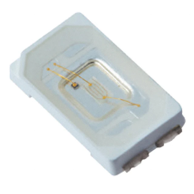

Part Number: XZCB25X143S
5.6mm x 3.0mm SURFACE MOUNT LED LAMP
Features
5.6mm x 3.0mm x 0.77mm SMD LED
IR-reflow compatible
Standard Package: 2,000pcs / Reel
ATTENTION
OBSERVE PRECAUTIONS
FOR HANDLING
ELECTROSTATIC
DISCHARGE
SENSITIVE
DEVICES
White SMD package with silicone resin
MSL (Moisture Sensitivity Level): 2a
RoHS compliant
Typical Applications
Entertainment and accent lighting
Architectural lighting
Ideal substitute for halogen and florescent lighting
Automotive interior and exterior lighting
Specialty lighting (Markers, Beacon, Pathway)
Package Schematics
Notes:
1. All dimensions are in millimeters (inches).
2. Tolerance is ±0.25(0.01") unless otherwise noted.
3. The specifications, characteristics and technical data described in the datasheet are subject to change without prior notice.
Sep 29,2016
XDSB6359
V3-Z
Layout: Maggie L.
P. 1/7
Handling Precautions
Compare to epoxy encapsulant that is hard and brittle, silicone is softer and flexible. Although its characteristic
significantly reduces thermal stress, it is more susceptible to damage by external mechanical force.
As a result, special handling precautions need to be observed during assembly using silicone encapsulated
LED products. Failure to comply might lead to damage and premature failure of the LED.
1. Handle the component along the side surfaces by using forceps or appropriate tools.
2. Do not directly touch or handle the silicone lens surface. It may damage the internal circuitry.
3. Do not stack together assembled PCBs containing exposed LEDs. Impact may scratch the silicone lens or
