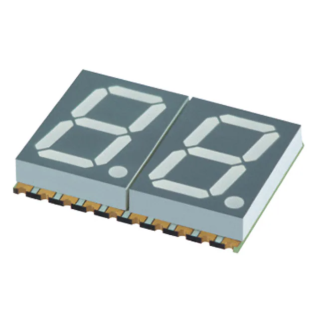

XZFCBD14A2 数据手册
Part Number: XZFCBD14A2 SURFACE MOUNT DISPLAY Features Package Schematics ● 0.56 inch digit height ● Robust package ● Low power consumption ● Standard configuration: Gray face w/ white segments ● Standard Package: 200pcs/ Reel ● MSL (Moisture Sensitivity Level): 2a ● RoHS Compliant ATTENTION OBSERVE PRECAUTIONS FOR HANDLING ELECTROSTATIC DISCHARGE SENSITIVE DEVICES Absolute Maximum Ratings (TA=25°C) Notes: 1. All dimensions are in millimeters (inches), Tolerance is ±0.25(0.01")unless otherwise noted. 2. Specifications are subject to change without notice. 3.The gap between the reflector and PCB shall not exceed 0.25mm. Blue (InGaN) Unit Operating Characteristics (TA=25°C) Blue (InGaN) Unit Reverse Voltage VR 5 V Forward Voltage (Typ.) (IF=10mA) VF 3 V Forward Current IF 30 mA Forward Voltage (Max.) (IF=10mA) VF 4 V Forward Current (Peak) 1/10 Duty Cycle 0.1ms Pulse Width Reverse Current (Max.) (VR=5V) IR 50 uA iFS 150 mA λP 460* nm Power Dissipation PD 120 mW Wavelength of Peak Emission CIE127-2007* (Typ.) (IF=10mA) Operating Temperature TA -40 ~ +85 Tstg -40 ~ +85 Wavelength of Dominant Emission CIE127-2007* (Typ.) (IF=10mA) λD 465* nm Spectral Line Full Width At Half-Maximum (Typ.) (IF=10mA) △λ 25 nm C 100 pF Storage Temperature Electrostatic Discharge Threshold (HBM) 250 °C V A Relative Humidity between 40% and 60% is recommended in ESD-protected work areas to reduce static build up during assembly process (Reference JEDEC/JESD625-A and JEDEC/J-STD-033) Part Number XZFCBD14A2 Emitting Color Blue Emitting Material InGaN Capacitance (Typ.) (VF=0V, f=1MHz) Luminous Intensity Wavelength CIE127-2007* CIE127-2007* (IF=10mA) nm ucd λP min. typ. 5600* 14990* *Luminous intensity value and wavelength are in accordance with CIE127-2007 standards. Oct 13,2016 Description Common Anode, Rt.Hand Decimal. 460* XDSB5554 V4-Z Layout: Maggie L. P. 1/4 Part Number: XZFCBD14A2 SURFACE MOUNT DISPLAY Blue ™ Blue LED is recommended for reflow soldering and soldering profile is shown below. Oct 13,2016 XDSB5554 V4-Z Layout: Maggie L. P. 2/4 Part Number: XZFCBD14A2 SURFACE MOUNT DISPLAY ™ Recommended Soldering Pattern (Units : mm; Tolerance: ±0.15) ™ Tape Specification (Units : mm) ™ Reel Dimension Remarks: If special sorting is required (e.g. binning based on forward voltage, Luminous intensity / luminous flux, or wavelength), the typical accuracy of the sorting process is as follows: 1. Wavelength: +/-1nm 2. Luminous intensity / luminous flux: +/-15% 3. Forward Voltage: +/-0.1V Note: Accuracy may depend on the sorting parameters. Oct 13,2016 XDSB5554 V4-Z Layout: Maggie L. P. 3/4 Part Number: XZFCBD14A2 SURFACE MOUNT DISPLAY PACKING & LABEL SPECIFICATIONS TERMS OF USE 1. Data presented in this document reflect statistical figures and should be treated as technical reference only. 2. Contents within this document are subject to improvement and enhancement changes without notice. 3. The product(s) in this document are designed to be operated within the electrical and environmental specifications indicated on the datasheet. User accepts full risk and responsibility when operating the product(s) beyond their intended specifications. 4. The product(s) described in this document are intended for electronic applications in which a person’s life is not reliant upon the LED. Please consult with a SunLED representative for special applications where the LED may have a direct impact on a person’s life. 5. The contents within this document may not be altered without prior consent by SunLED. 6. Additional technical notes are available at http://www.SunLEDusa.com/TechnicalNotes.asp Oct 13,2016   XDSB5554 V4-Z Layout: Maggie L. P. 4/4
