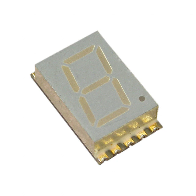

Part Number: XZFMG10A SURFACE MOUNT DISPLAY Features Package Schematics ● 0.4 inch digit height ● Robust package ● Low power consumption ● Standard configuration: Gray face w/ white segments ● Standard Package: 400pcs/ Reel ● MSL (Moisture Sensitivity Level): 2a ● RoHS compliant Notes: 1. All dimensions are in millimeters (inches), Tolerance is ±0.25(0.01")unless otherwise noted. 2. Specifications are subject to change without notice. 3.The gap between the reflector and PCB shall not exceed 0.25mm. Absolute Maximum Ratings (TA=25°C) Green (GaP) Unit Operating Characteristics (TA=25°C) Green (GaP) Unit Reverse Voltage VR 5 V Forward Voltage (Typ.) (IF=10mA) VF 2 V Forward Current IF 25 mA Forward Voltage (Max.) (IF=10mA) VF 2.4 V Forward Current (Peak) 1/10 Duty Cycle 0.1ms Pulse Width iFS 140 mA Reverse Current (Max.) (VR=5V) IR 10 μA Power Dissipation PD 62.5 mW Wavelength of Peak Emission CIE127-2007* (Typ.) (IF=10mA) λP 565* nm Operating Temperature TA -40 ~ +85 λD 568* nm Tstg -40 ~ +85 Wavelength of Dominant Emission CIE127-2007* (Typ.) (IF=10mA) Spectral Line Full Width At Half-Maximum (Typ.) (IF=10mA) △λ 30 nm C 15 pF Storage Temperature °C A Relative Humidity between 40% and 60% is recommended in ESD-protected work areas to reduce static build up during assembly process (Reference JEDEC/JESD625-A and JEDEC/J-STD-033) Capacitance (Typ.) (VF=0V, f=1MHz) Part Number XZFMG10A Emitting Color Green Emitting Material GaP Luminous Intensity CIE127-2007* (IF=10mA) ucd min. typ. 2200 560* 4690 1190* Wavelength CIE127-2007* nm λP Description 565* Common Anode, Rt.Hand Decimal. *Luminous intensity value and wavelength are in accordance with CIE127-2007 standards. Feb 21,2019 XDSA9133 V7-X Layout: Maggie L. P. 1/4 Part Number: XZFMG10A SURFACE MOUNT DISPLAY Green Relative Radiant Intensity 100% 80% Ta = 25 °C 60% 40% 20% 0% 350 400 450 500 550 600 Wavelength (nm) 650 700 750 800 Relative Intensity Vs. CIE Wavelength ™ Green LED is recommended for reflow soldering and soldering profile is shown below. Feb 21,2019 XDSA9133 V7-X Layout: Maggie L. P. 2/4 Part Number: XZFMG10A SURFACE MOUNT DISPLAY ™ Recommended Soldering Pattern (Units : mm; Tolerance: ±0.15) ™ Tape Specification (Units : mm) ™ Reel Dimension Remarks: If special sorting is required (e.g. binning based on forward voltage, Luminous intensity / luminous flux, or wavelength), the typical accuracy of the sorting process is as follows: 1. Wavelength: +/-1nm 2. Luminous intensity / luminous flux: +/-15% 3. Forward Voltage: +/-0.1V Note: Accuracy may depend on the sorting parameters. Feb 21,2019 XDSA9133 V7-X Layout: Maggie L. P. 3/4 Part Number: XZFMG10A SURFACE MOUNT DISPLAY PACKING & LABEL SPECIFICATIONS TERMS OF USE 1. Data presented in this document reflect statistical figures and should be treated as technical reference only. 2. Contents within this document are subject to improvement and enhancement changes without notice. 3. The product(s) in this document are designed to be operated within the electrical and environmental specifications indicated on the datasheet. User accepts full risk and responsibility when operating the product(s) beyond their intended specifications. 4. The product(s) described in this document are intended for electronic applications in which a person’s life is not reliant upon the LED. Please consult with a SunLED representative for special applications where the LED may have a direct impact on a person’s life. 5. The contents within this document may not be altered without prior consent by SunLED. 6.When any special process such as potting is required for LED assembly, please consult with SunLED representative before proceeding. 7. Additional technical notes are available at https://www.SunLEDusa.com/TechnicalNotes.asp Feb 21,2019 XDSA9133 V7-X Layout: Maggie L. P. 4/4
