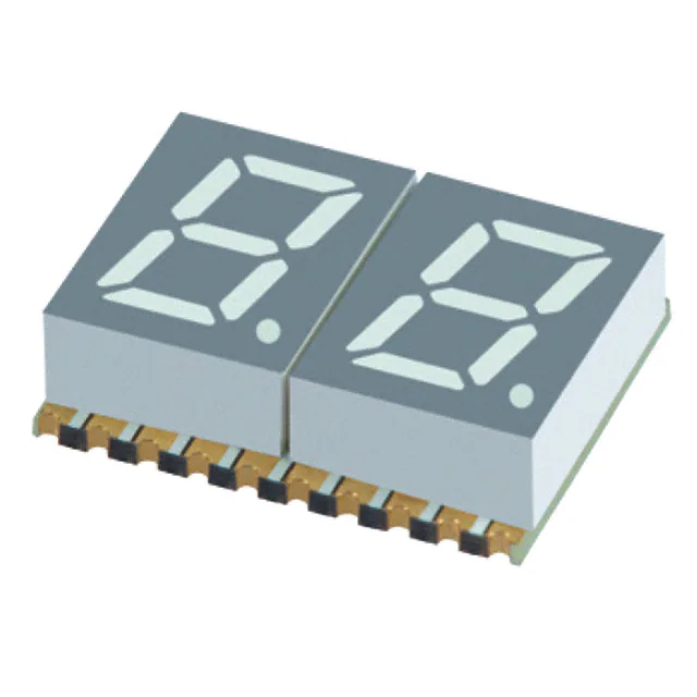

Part Number: XZFMYK07C2 SURFACE MOUNT DISPLAY Features Package Schematics ● 0.3 inch digit height ● Robust package ● Low power consumption ● Standard configuration: Gray face w/ white segments ● Standard Package: 300pcs/ Reel ● MSL (Moisture Sensitivity Level): 2a ● RoHS Compliant MYK Notes: 1. All dimensions are in millimeters (inches), Tolerance is ±0.25(0.01")unless otherwise noted. 2. Specifications are subject to change without notice. 3.The gap between the reflector and PCB shall not exceed 0.25mm. Absolute Maximum Ratings (TA=25°C) MYK (AlGaInP) Unit Reverse Voltage VR 5 V Forward Current IF 30 mA Forward Current (Peak) 1/10 Duty Cycle 0.1ms Pulse Width iFS Power Dissipation PD 75 Operating Temperature TA -40 ~ +85 Tstg -40 ~ +85 Storage Temperature 175 mA mW °C Operating Characteristics (TA=25°C) XZFMYK07C2 Emitting Color Yellow Emitting Material AlGaInP Unit Forward Voltage (Typ.) (IF=10mA) VF 1.95 V Forward Voltage (Max.) (IF=10mA) VF 2.5 V Reverse Current (Max.) (VR=5V) IR 10 uA Wavelength of Peak Emission CIE127-2007* (Typ.) (IF=10mA) λP 590* nm Wavelength of Dominant Emission CIE127-2007* (Typ.) (IF=10mA) λD 590* nm Spectral Line Full Width At Half-Maximum (Typ.) (IF=10mA) △λ 20 nm C 20 pF Capacitance (Typ.) (VF=0V, f=1MHz) Part Number MYK (AlGaInP) Luminous Intensity CIE127-2007* (IF=10mA) ucd min. typ. 21000 5600* 35990 12990* *Luminous intensity value and wavelength are in accordance with CIE127-2007 standards. Jan 07,2014 Wavelength CIE127-2007* nm λP Description 590* Common Cathode, Rt.Hand Decimal. XDSA9186 V6-X Layout: Maggie L. P. 1/4 Part Number: XZFMYK07C2 SURFACE MOUNT DISPLAY  MYK LED is recommended for reflow soldering and soldering profile is shown below. Jan 07,2014 XDSA9186 V6-X Layout: Maggie L. P. 2/4 Part Number: XZFMYK07C2 SURFACE MOUNT DISPLAY  Recommended Soldering Pattern (Units : mm; Tolerance: ±0.15)  Tape Specification (Units : mm)  Reel Dimension Remarks: If special sorting is required (e.g. binning based on forward voltage, Luminous intensity / luminous flux, or wavelength), the typical accuracy of the sorting process is as follows: 1. Wavelength: +/-1nm 2. Luminous intensity / luminous flux: +/-15% 3. Forward Voltage: +/-0.1V Note: Accuracy may depend on the sorting parameters. Jan 07,2014 XDSA9186 V6-X Layout: Maggie L. P. 3/4 Part Number: XZFMYK07C2 SURFACE MOUNT DISPLAY PACKING & LABEL SPECIFICATIONS TERMS OF USE 1. Data presented in this document reflect statistical figures and should be treated as technical reference only. 2. Contents within this document are subject to improvement and enhancement changes without notice. 3. The product(s) in this document are designed to be operated within the electrical and environmental specifications indicated on the datasheet. User accepts full risk and responsibility when operating the product(s) beyond their intended specifications. 4. The product(s) described in this document are intended for electronic applications in which a person’s life is not reliant upon the LED. Please consult with a SunLED representative for special applications where the LED may have a direct impact on a person’s life. 5. The contents within this document may not be altered without prior consent by SunLED. 6. Additional technical notes are available at http://www.SunLEDusa.com/TechnicalNotes.asp   Jan 07,2014 XDSA9186 V6-X Layout: Maggie L. P. 4/4
