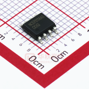

NCEP0114AS
  • 1+5
  • 10+4
  • 100+3.5
  • 1000+2.5
  • 5000+2.08
库存:14
