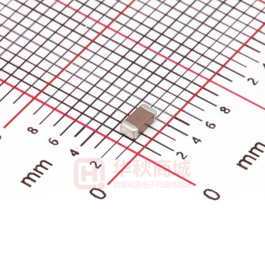

    贴片电容(MLCC) 1206 2.2nF ±10% 630V X7R
SMK316B7222KFHT 数据手册
Spec Sheet Medium-High Voltage Multilayer Ceramic Capacitors for Automotive Body & Chassis and Infotainment MCASS31QHB7222KTNA1J (Previous PN: SMK316B7222KFHT) Features Item Summary 2200pF±10%, 630V, X7R, 1206/3216 (EIA/JIS) Lifecycle Stage Mass Production Standard packaging quantity (minimum) Taping Embossed 3000pcs Products characteristics table External Dimensions 2200 pF ± 10 % Dimension L 3.2 ±0.15 mm Case Size (EIA/JIS) 1206/3216 Dimension W 1.6 ±0.15 mm Rated Voltage 630 V Dimension T 1.15 ±0.10 mm Dimension e 0.50 +0.35/-0.25 mm Capacitance tanδ (max) 2.5 % Temperature Characteristic (EIA) X7R Operating Temp. Range (EIA) -55 to +125 ℃ High Temperature Loading 120 % (% Rated Voltage) Insulation Resistance (min) 10 GΩ RoHS Compliance (10 subst.) Yes REACH Compliance (209 subst.) Yes Halogen Free Yes Soldering Reflow 2021.12.28 The data is reference only. Electrical characteristics vary depending on environment or measurement condition. TAIYO YUDEN reserves the right to make change to the data at any time without notice. Before making final selection, please check product specification. http://www.ty-top.com Powered by TCPDF (www.tcpdf.org) Multi Layer Ceramic Capacitor -Electrical Characteristics Data- 21QA07 RoHS compliance product ○MCASS31QHB7222KTNA1J_(SMK316B7222KFHT) 630V 3216 X7R 2200pF +/- 10% t=1.25mmMAX 630V 1206 X7R 2200pF +/- 10% t=0.049inchMAX DC Bias Char. Capacitance Freq. 20 1000000 0 100000 dC/C[%] Capacitance[pF] -20 10000 -40 -60 1000 -80 100 0.001 0.01 0.1 -100 0 100 200 300 400 500 DC Bias Voltage[V] 600 Capacitance Temp. 10 1 10 100 1000 10000 Frequency[MHz] Impedance,ESR Freq. 1000000 100000 0 10000 ESR Z Z,ESR[OHM] dC/C[%] 1000 -10 -20 100 10 1 0.1 -30 -55 -35 -15 5 25 45 65 85 105 125 Temperature[degreeC] 0.01 0.001 0.01 0.1 1 10 100 1000 10000 Frequency[MHz] 部品特性は設置環境、測定条件等により変化する場合があります。本データをご使用される際は実際の製品特性に対する参考 データとしてご活用ください。また、本データは予告無く追加・削除及び変更を行う場合があります。ご注文の際は、納入仕様書の ご確認をお願いします。 The data is reference only. Electrical characteristics vary depending on environment or measurement condition. TAIYO YUDEN reserves the right to make change to the data at any time without notice. Before making final selection, please check product specification. ■ Notice for TAIYO YUDEN Products Please read this notice before using the TAIYO YUDEN products. ⚠ REMINDERS ■ Pre-Evaluation in the Actual Equipment and Conditions Please conduct validation and verification of our products in actual conditions of mounting and operating environment before using our products. ■ Limited Application 1. Equipment Intended for Use Our products are intended for general-purpose and standard use in general electronic equipment for consumer (e.g., AV equipment, OA equipment, home electric appliances, office equipment, information and communication equipment including, without limitation, mobile phone, and PC) and other equipment specified in the product catalog or the individual product specification sheets, or the equipment approved separately by TAIYO YUDEN. TAIYO YUDEN has the product series intended for use in the following equipment. Therefore, when using our products for these equipment, please check available applications specified in the product catalog or the individual product specification sheets and use the corresponding products. Product Series Quality Category Application Grade *3 Equipment *1 (Part Number Code *2) Automotive Electronic Equipment (POWERTRAIN, SAFETY) A 1 Automotive Automotive Electronic Equipment (BODY & CHASSIS, INFOTAINMENT) C 2 Industrial Telecommunications Infrastructure and Industrial Equipment B 2 Medical Devices classified as GHTF Class C (Japan Class III) M 2 Medical Medical Devices classified as GHTF Classes A or B (Japan Classes I or II) L 3 Consumer General Electronic Equipment S 3 *Notes: 1. Based on the general specifications required for electronic components for such equipment, which are recognized by TAIYO YUDEN, the use of each product series for the equipment is recommended. Please be sure to contact TAIYO YUDEN before using our products for equipment other than those covered by the product series. 2. On each of our part number, the 2nd code from the left is a code indicating the “Category” as shown in the above table. For details, please check the explanatory materials regarding the part numbering system of each of our products. 3. Each product series is assigned a “Quality Grade” from 1 to 3 in order of higher quality. Please do not incorporate a product into any equipment with a higher Quality Grade than the Quality Grade of such product without the prior written consent of TAIYO YUDEN. 2. Equipment Requiring Inquiry Please be sure to contact TAIYO YUDEN for further information before using our products for the following equipment (excluding intended equipment as specified in the product catalog or the individual product specification sheets) which may cause loss of human life, bodily injury, serious property damage and/or serious public impact due to a failure or defect of the products and/or malfunction attributed thereto. (1) Transportation equipment (automotive powertrain control system, train control system, and ship control system, etc.) (2) Traffic signal equipment (3) Disaster prevention equipment, crime prevention equipment (4) Medical devices classified as GHTF Class C (Japan Class III) (5) Highly public information network equipment, data-processing equipment (telephone exchange, and base station, etc.) (6) Any other equipment requiring high levels of quality and/or reliability equal to the equipment listed above 3. Equipment Prohibited for Use Please do not incorporate our products into the following equipment requiring extremely high levels of safety and/or reliability. (1) Aerospace equipment (artificial satellite, rocket, etc.) (2) Aviation equipment *1 (3) Medical devices classified as GHTF Class D (Japan Class IV), implantable medical devices *2 (4) Power generation control equipment (nuclear power, hydroelectric power, thermal power plant control system, etc.) (5) Undersea equipment (submarine repeating equipment, etc.) (6) Military equipment (7) Any other equipment requiring extremely high levels of safety and/or reliability equal to the equipment listed above *Notes: 1. There is a possibility that our products can be used only for aviation equipment that does not directly affect the safe operation of aircraft (e.g., in-flight entertainment, cabin light, electric seat, cooking equipment) if such use meets requirements specified separately by TAIYO YUDEN. Please be sure to contact TAIYO YUDEN for further information before using our products for such aviation equipment. 2. Implantable medical devices contain not only internal unit which is implanted in a body, but also external unit which is connected to the internal unit. 4. Limitation of Liability Please note that unless you obtain prior written consent of TAIYO YUDEN, TAIYO YUDEN shall not be in any way responsible for any damages incurred by you or third parties arising from use of our products for any equipment that is not intended for use by TAIYO YUDEN, or any equipment requiring inquiry to TAIYO YUDEN or prohibited for use by TAIYO YUDEN as described above. ■ Safety Design When using our products for high safety and/or reliability-required equipment or circuits, please fully perform safety and/or reliability evaluation. In addition, please install (i) systems equipped with a protection circuit and a protection device and/or (ii) systems equipped with a redundant circuit or other system to prevent an unsafe status in the event of a single fault for a failsafe design to ensure safety. ■ Intellectual Property Rights Information contained in this spec sheet is intended to convey examples of typical performances and/or applications of our products and is not intended to make any warranty with respect to the intellectual property rights or any other related rights of TAIYO YUDEN or any third parties nor grant any license under such rights. ■ Limited Warranty Please note that the scope of warranty for our products is limited to the delivered our products themselves conforming to the product specifications specified in the individual product specification sheets, and TAIYO YUDEN shall not be in any way responsible for any damages resulting from a failure or defect in our products. Notwithstanding the foregoing, if there is a written agreement (e.g., supply and purchase agreement, quality assurance agreement) signed by TAIYO YUDEN and your company, TAIYO YUDEN will warrant our products in accordance with such agreement, provided, however, that our products shall be used for general-purpose and standard use in the equipment specified in the product catalog or the individual product specification sheets. ■ TAIYO YUDEN’s Official Sales Channel The contents of this spec sheet are applicable to our products which are purchased from our sales offices or authorized distributors (hereinafter “TAIYO YUDEN’s official sales channel”). Please note that the contents of this spec sheet are not applicable to our products purchased from any seller other than TAIYO YUDEN’s official sales channel. ■ Caution for Export Some of our products may require specific procedures for export according to “U.S. Export Administration Regulations”, “Foreign Exchange and Foreign Trade Control Law” of Japan, and other applicable regulations. Should you have any questions on this matter, please contact our sales staff.
