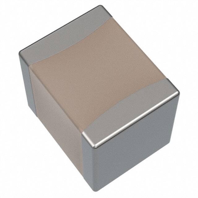

    4.7 µF ±20% 25V 陶瓷电容器 X7R 1210(3225 公制)
TMF325B7475MMHP 数据手册
Spec Sheet Multilayer Ceramic Capacitors TMF325B7475MMHP Features Item Summary 4.7uF±20%, 25V, X7R, 1210/3225 (EIA/JIS) Lifecycle Stage New PN available AEC-Q200 qualified Standard packaging quantity (minimum) Taping Embossed 1000pcs Products characteristics table External Dimensions 4.7 uF ± 20 % Dimension L 3.2 ±0.30 mm Case Size (EIA/JIS) 1210/3225 Dimension W 2.5 ±0.20 mm Rated Voltage 25 V Dimension T 2.5 ±0.20 mm Dimension e 0.60 ±0.30 mm Capacitance tanδ (max) 5% Temperature Characteristic (EIA) X7R Operating Temp. Range (EIA) -55 to +125 ℃ High Temperature Loading 200 % (% Rated Voltage) Insulation Resistance (min) 100 MΩ·μF RoHS Compliance (10 subst.) Yes REACH Compliance (223 subst.) Yes Halogen Free Yes Soldering Reflow 2022.05.25 The data is reference only. Electrical characteristics vary depending on environment or measurement condition. TAIYO YUDEN reserves the right to make change to the data at any time without notice. Before making final selection, please check product specification. http://www.ty-top.com Powered by TCPDF (www.tcpdf.org) Multi Layer Ceramic Capacitor -Electrical Characteristics Data- 17QA08 RoHS compliance product ○TMF325B7475MMHP 25V 3225 X7R 4.7uF +/- 20% t=2.7mmMAX 25V 1210 X7R 4.7uF +/- 20% t=0.106inchMAX TMF325B7475MMHP Capacitance Freq. 1000 Capacitance[uF] 100 10 1 0.1 0.001 0.01 0.1 1 10 100 1000 10000 Frequency[MHz] TMF325B7475MMHP DC Bias Char. TMF325B7475MMHP Impedance,ESR Freq. 10 1000 0 100 -10 10 Z,ESR[OHM] dC/C[%] ESR -20 -30 -40 Z 1 0.1 0.01 -50 0 5 10 15 20 DC Bias Voltage[V] 0.001 0.001 0.01 0.1 1 10 100 1000 10000 Frequency[MHz] 25 TMF325B7475MMHP Capacitance Temp. TMF325B7475MMHP Ripple Current 10 100 dTemp.[degreeC] dC/C[%] 0 -10 -20 10 10kHz 100kHz 1MHz -30 1 -55 -35 -15 5 25 45 65 85 105 125 Temperature[degreeC] 0 0.5 1 1.5 2 2.5 3 3.5 Ripple Current[Arms] 4 4.5 部品特性は設置環境、測定条件等により変化する場合があります。本データをご使用される際は実際の製品特性に対する参考 データとしてご活用ください。また、本データは予告無く追加・削除及び変更を行う場合があります。ご注文の際は、納入仕様書の ご確認をお願いします。 The data is reference only. Electrical characteristics vary depending on environment or measurement condition. TAIYO YUDEN reserves the right to make change to the data at any time without notice. Before making final selection, please check product specification. ■Notice for TAIYO YUDEN Products  Please read this notice before using the TAIYO YUDEN products.  ! ■ REMINDERS   Please  conduct  validation  and  verification  of  our  products  in  actual  condition  of  mounting  and  operating  environment  before  using  our  products. ■ The product listed in this spec sheet is intended for use in general electronic equipment (e.g., AV equipment, OA equipment, home electric  appliances, office equipment, information and communication equipment including, without limitation, mobile phone, and PC). Please be sure  to contact TAIYO YUDEN for further information before using the products for any equipment which may directly cause loss of human life or  bodily  injury  (e.g.,  transportation  equipment  including,  without  limitation,  automotive  powertrain  control  system,  train  control  system,  and  ship control system, traffic signal equipment, disaster prevention equipment, medical equipment classified as Class I, II or III by IMDRF, highly  public information network equipment including, without limitation, telephone exchange, and base station).  Please  do  not  incorporate  our  products  into  any  equipment  requiring  high  levels  of  safety  and/or  reliability  (e.g.,  aerospace  equipment,  aviation equipment, medical equipment classified as Class IV by IMDRF, nuclear control equipment, undersea equipment, military equipment).  When our products are used even for high safety and/or reliability‐required devices or circuits of general electronic equipment, it is strongly  recommended to perform a thorough safety evaluation prior to use of our products and to install a protection circuit as necessary.  Please note that unless you obtain prior written consent of TAIYO YUDEN, TAIYO YUDEN shall not be in any way responsible for any damages  incurred by you or third parties arising from use of the product listed in this spec sheet for any equipment requiring inquiry to TAIYO YUDEN or  prohibited for use by TAIYO YUDEN as described above. ■ Information contained in this spec sheet is intended to convey examples of typical performances and/or applications of our products and is not  intended to make any warranty with respect to the intellectual property rights or any other related rights of TAIYO YUDEN or any third parties  nor grant any license under such rights.  ■ Please note that the scope of warranty for our products is limited to the delivered our products themselves and TAIYO YUDEN shall not be in  any  way  responsible  for  any  damages  resulting  from  a  fault  or  defect  in  our  products.  Notwithstanding  the  foregoing,  if  there  is  a  written  agreement (e.g., supply and purchase agreement, quality assurance agreement) signed by TAIYO YUDEN and your company, TAIYO YUDEN will  warrant our products in accordance with such agreement.  ■ The  contents  of  this  spec  sheet  are  applicable  to  our  products  which  are  purchased  from  our  sales  offices  or  authorized  distributors  (hereinafter  “TAIYO  YUDEN’s  official  sales  channel”).  Please  note  that  the  contents  of  this  spec  sheet  are  not  applicable  to  our  products  purchased from any seller other than TAIYO YUDEN’s official sales channel. ■ Caution for Export  The product listed in this spec sheet may require specific procedures for export according to “U.S. Export Administration Regulations”, “Foreign  Exchange and Foreign Trade Control Law” of Japan, and other applicable regulations. Should you have any questions on this matter, please  contact our sales staff.
