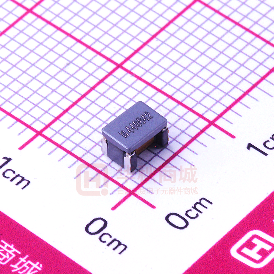

TDK EMC Technology Common mode Filters for CAN(Controller Area Network) SHAPES AND DIMENSIONS FEATURES Operating temperature range from -40℃ to +125℃. Non-soldered internal construction provides excellent heat resistance – to ensure effective circuit board mounting. Robust lead frame termination – provides sound and flexible mechanical construction. Lead free soldering applicable 3.2±0.2 AEC-Q200 compliant APPLICATION This SMD type product is effective in reducing noise associated with the internal communication networks used within automotive vehicles. (CAN-bus system) (3) (4) 2 3 2.8±0.2 ACT45C - 510 - 2P - TL - 000 (2) 4 4.5±0.2 PRODUCT IDENTIFICATION (1) 1 (5) 0.7±0.1 0.65±0.1 (1) Series name (2) Inductance typ. Value (3) Numbers of lines 2P : 2 lines (4)Packing style Unit : mm TL : Taping ∅ 330mm reel 2,500pcs. RECOMMENDED PATTERN 3.4 (5)Control mark EQUIVALENT CIRCUIT 1 4 2 3 1.6 3.2 5.9 Unit : mm No directionality ELECTRICAL CHARACTERISTICS Part No. ACT45C-110-2P ACT45C-220-2P ACT45C-510-2P ACT45C-101-2P Common-mode/Z/ (∧) at10MHz 300min.(600typ.) 500min. (1200typ.) 1000min. (2800typ.) 2000min.(5800typ.) at100kHz DC resistance (∧)max. Rated current DC(A)max. Rated voltage DC(V)max. Insulation Resistance (M∧)min. 0.05 0.08 0.15 0.20 0.6 1.0 1.0 2.0 0.25 0.2 0.2 0.15 50 50 50 50 10 10 10 10 Common-mode L (µΗ) typ. Stray L (µΗ) typ. at100kHz 11+50/-30% 22+50/-30% 51+50/-30% 100+50/-30% TDK EMC Technology Common mode Filters for CAN(Controller Area Network) /Z/ vs. FREQUENCY CHARACTERISTICS ACT45C-110-2P ACT45C-220-2P 100000 100000 Impedance(ohm) Impedance(ohm) Common-mode 10000 10000 Common-mode 1000 1000 100 100 Differential-mode Differential-mode 10 10 1 10 100 1 1000 10 100 1000 Frequency(MHz) Frequency(MHz) ACT45C-510-2P ACT45C-101-2P 100000 100000 Common-mode Common-mode 10000 Impedance(ohm) Impedance(ohm) 10000 1000 100 1000 Differential-mode 100 Differential-mode 10 10 1 10 100 Frequency(MHz) 1000 1 10 100 Frequency(MHz) 1000
