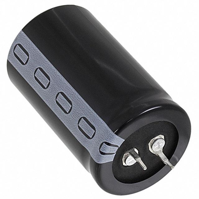

    2200 µF 100 V 铝电解电容器 径向,Can - 卡入式 56 毫欧 105°C 时为 5000 小时
B41505A9228M000 数据手册
Aluminum electrolytic capacitors Snap-in capacitors Series/Type: B41505 Date: December 2016 © EPCOS AG 2016. Reproduction, publication and dissemination of this publication, enclosures hereto and the information contained therein without EPCOS' prior express consent is prohibited. EPCOS AG is a TDK Group Company. Snap-in capacitors B41505 Excellent performance  105 °C Long-life grade capacitors Applications Professional power supplies Features Long useful life High reliability Outstanding ripple current capability Low ESR Capacitors pass the needle flame test according to IEC 60695-11-5 for all flame exposure times up to 120 s RoHS-compatible Construction Charge/discharge-proof, polar Aluminum case, fully insulated with PVC Snap-in solder pins to hold component in place on PC-board Minus pole marking on case surface Minus pole not insulated from case Overload protection by safety vent on the base Terminals Standard version with 2 terminals, 2 lengths available: 6.3 and 4.5 mm 3 terminals to ensure correct insertion: length 4.5 mm Please read Cautions and warnings and Important notes at the end of this document. Page 2 of 17 B41505 Excellent performance  105 °C Specifications and characteristics in brief Rated voltage VR Surge voltage VS Rated capacitance CR Capacitance tolerance 10 ... 100 V DC 1.15  VR 560 ... 33000 μF ±20%  M Dissipation factor tan δ (20 °C, 100 Hz) VR = 10 V DC: tan δ ≤ 0.20 VR = 16 V DC: tan δ ≤ 0.15 VR = 25 V DC: tan δ ≤ 0.11 VR = 35 V DC: tan δ ≤ 0.10 VR = 50 V DC: tan δ ≤ 0.08 VR = 63 ... 100 V DC: tan δ ≤ 0.06 Leakage current Ileak (5 min, 20 °C) Self-inductance ESL Approx. 20 nH 1) Useful life 105 °C; VR; IAC,R 85 °C; VR; IAC,max 40 °C; VR; 2.1  IAC,R Load life test 105 °C; VR; IAC,R Voltage endurance test 105 °C; VR Vibration resistance test Characteristics at low temperature > 5000 h > 12000 h > 25000 h 4000 h 2000 h Requirements: ΔC/C ≤ 45% of initial value tan δ ≤ 3 times initial specified limit Ileak ≤ initial specified limit Post test requirements: ΔC/C ≤ 20% of initial value tan δ ≤ 2 times initial specified limit Ileak ≤ initial specified limit Post test requirements: ΔC/C ≤ 15% of initial value tan δ ≤ 1.3 times initial specified limit Ileak ≤ initial specified limit To IEC 60068-2-6, test Fc: Frequency range 10 Hz ... 55 Hz, displacement amplitude 0.35 mm, acceleration max. 5 g, duration 3 × 2 h. Capacitor mounted by its body which is rigidly clamped to the work surface. Max. impedance Z -25 °C / Z 20 °C 2 ratio at 120 Hz Z -40 °C / Z 20 °C 3 IEC climatic category To IEC 60068-1: 40/105/56 (40 °C/+105 °C/56 days damp heat test) Sectional specification IEC 60384-4 1) Refer to chapter "General technical information, 5 Useful life" on how to interpret useful life. Please read Cautions and warnings and Important notes at the end of this document. Page 3 of 17 B41505 Excellent performance  105 °C Dimensional drawings Snap-in capacitors with standard insulation (PVC) Snap-in terminals, length (6.3 ±1) mm. Also available in a shorter version with a length of (4.5 1) mm. Safety vent on the base. Snap-in capacitors are also available with 3 terminals (length (4.5 1) mm). Safety vent on the base. Dimensions (mm) d +1 l ±2 22 25 22 30 22 35 22 40 25 25 25 30 25 35 25 40 Dimensions (mm) d +1 l ±2 30 25 30 30 30 35 30 40 30 45 30 50 35 35 35 40 35 45 35 50 Approx. weight (g) Packing units (pcs.) 9 12 15 18 13 17 19 22 160 160 160 160 130 130 130 130 Please read Cautions and warnings and Important notes at the end of this document. Page 4 of 17 Approx. weight (g) Packing units (pcs.) 17 23 29 36 41 46 36 41 56 70 80 80 80 80 80 80 60 60 60 60 B41505 Excellent performance  105 °C Ordering codes for terminal styles and insulation features Identification in 3rd block of ordering code Snap-in capacitors Terminal version Insulation version PVC Standard terminals 6.3 mm M000 Short terminals 4.5 mm M007 3 terminals 4.5 mm M002 Ordering examples: B41505A5109M007 B41505A5109M002 } } snap-in capacitor with short terminals snap-in capacitor with 3 terminals Please read Cautions and warnings and Important notes at the end of this document. Page 5 of 17 B41505 Excellent performance  105 °C Overview of available types The capacitance and voltage ratings listed below are available in different case sizes upon request. Other voltage and capacitance ratings are also available upon request. VR (V DC) 10 16 25 35 50 63 80 100 Case dimensions d × l (mm) CR (μF) 560 25 × 25 680 22 × 35 22 × 25 1000 25 × 25 25 × 35 30 × 30 30 × 25 1200 1500 22 × 35 25 × 35 30 × 40 2200 22 × 25 22 × 35 25 × 35 30 × 30 30 × 35 30 × 50 3300 22 × 30 25 × 25 25 × 35 30 × 40 35 × 35 35 × 50 22 × 30 25 × 25 22 × 40 30 × 35 35 × 35 35 × 45 35 × 50 4700 6800 22 × 25 22 × 30 25 × 30 25 × 40 30 × 50 10000 22 × 30 25 × 30 25 × 40 30 × 40 35 × 45 15000 22 × 40 25 × 40 30 × 40 35 × 40 35 × 45 18000 22000 30 × 35 33000 30 × 45 30 × 40 Please read Cautions and warnings and Important notes at the end of this document. Page 6 of 17 B41505 Excellent performance  105 °C Technical data and ordering codes CR 100 Hz 20 °C μF Case dimensions d×l mm VR = 10 V DC 22 × 25 6800 22 × 30 10000 22 × 40 15000 30 × 35 22000 30 × 45 33000 VR = 16 V DC 22 × 30 6800 25 × 30 10000 25 × 40 15000 30 × 40 22000 VR = 25 V DC 22 × 30 4700 25 × 25 4700 25 × 30 6800 25 × 40 10000 30 × 40 15000 VR = 35 V DC 22 × 25 2200 22 × 30 3300 25 × 25 3300 22 × 40 4700 25 × 40 6800 30 × 40 10000 35 × 40 15000 35 × 45 18000 VR = 50 V DC 22 × 35 2200 25 × 35 3300 30 × 35 4700 30 × 50 6800 35 × 45 10000 ESRtyp 100 Hz 20 °C mΩ Zmax 10 kHz 20 °C mΩ IAC,max 100 Hz 60 °C A IAC,max 100 Hz 85 °C A IAC,R1) Ordering code 100 Hz (composition see 105 °C below) A 74 53 37 26 19 78 56 39 28 20 3.6 4.6 5.9 7.7 10.2 2.8 3.6 4.6 6.0 7.8 1.4 1.8 2.3 3.0 3.9 B41505A3688M00# B41505A3109M00# B41505A3159M00# B41505A3229M00# B41505A3339M00# 46 34 24 17 49 36 26 18 4.6 5.6 7.1 9.4 3.6 4.4 5.6 7.0 1.8 2.2 2.8 3.5 B41505A4688M00# B41505A4109M00# B41505A4159M00# B41505A4229M00# 53 53 41 30 22 57 57 43 32 23 4.1 4.1 4.8 6.4 8.2 3.2 3.2 3.8 5.0 6.4 1.6 1.6 1.9 2.5 3.2 B41505A5478M00# B41505F5478M00# B41505A5688M00# B41505A5109M00# B41505A5159M00# 85 56 56 45 35 26 19 17 90 60 60 48 37 28 20 18 2.8 3.8 3.8 4.8 5.9 7.4 9.4 11.1 2.2 3.0 3.0 3.8 4.6 5.8 7.6 8.6 1.1 1.5 1.5 1.9 2.3 2.9 3.8 4.3 B41505A7228M00# B41505A7338M00# B41505F7338M00# B41505A7478M00# B41505A7688M00# B41505A7109M00# B41505A7159M00# B41505A7189M00# 85 56 42 33 25 90 60 45 35 26 3.6 4.6 5.6 7.4 9.4 2.8 3.6 4.4 5.8 7.2 1.4 1.8 2.2 2.9 3.6 B41505A6228M00# B41505A6338M00# B41505A6478M00# B41505A6688M00# B41505A6109M00# Composition of ordering code # = Terminal style 0 = snap-in standard terminals (6.3 mm) 2 = snap-in 3 terminals (4.5 mm) 7 = snap-in short terminals (4.5 mm) 1) 120-Hz conversion factor of ripple current: IAC (120 Hz) = 1.03  IAC (100 Hz) Please read Cautions and warnings and Important notes at the end of this document. Page 7 of 17 B41505 Excellent performance  105 °C Technical data and ordering codes CR 100 Hz 20 °C μF Case dimensions d×l mm VR = 63 V DC 22 × 25 1000 22 × 35 1500 25 × 35 2200 30 × 30 2200 30 × 40 3300 35 × 35 4700 35 × 50 6800 VR = 80 V DC 25 × 25 1000 30 × 25 1200 25 × 35 1500 30 × 35 2200 35 × 35 3300 35 × 45 4700 VR = 100 V DC 25 × 25 560 22 × 35 680 25 × 35 1000 30 × 30 1000 30 × 40 1500 30 × 50 2200 35 × 50 3300 IAC,max 100 Hz 85 °C A IAC,R2) Ordering code 100 Hz (composition see 105 °C below) A 2.6 3.6 4.3 4.6 5.9 6.9 9.4 2.0 2.8 3.4 3.6 4.6 5.4 7.2 1.0 1.4 1.7 1.8 2.3 2.7 3.6 B41505A8108M00# B41505A8158M00# B41505A8228M00# B41505F8228M00# B41505A8338M00# B41505A8478M00# B41505A8688M00# 133 110 89 60 48 34 3.3 3.8 4.6 5.1 7.1 8.5 2.6 3.0 3.6 4.0 5.6 6.8 1.3 1.5 1.8 2.0 2.8 3.4 B41505A0108M00# B41505A0128M00# B41505A0158M00# B41505A0228M00# B41505A0338M00# B41505A0478M00# 190 156 106 106 70 60 40 2.6 3.1 3.6 3.8 4.8 5.9 7.7 2.0 2.4 2.8 3.0 3.8 4.6 6.0 1.0 1.2 1.4 1.5 1.9 2.3 3.0 B41505A9567M00# B41505A9687M00# B41505A9108M00# B41505F9108M00# B41505A9158M00# B41505A9228M00# B41505A9338M00# ESRtyp 100 Hz 20 °C mΩ Zmax 10 kHz 20 °C mΩ 149 100 68 80 53 42 29 159 106 72 85 56 45 31 125 104 83 56 45 32 178 146 100 100 66 56 38 IAC,max 100 Hz 60 °C A Composition of ordering code # = Terminal style 0 = snap-in standard terminals (6.3 mm) 2 = snap-in 3 terminals (4.5 mm) 7 = snap-in short terminals (4.5 mm) 2) 120-Hz conversion factor of ripple current: IAC (120 Hz) = 1.03  IAC (100 Hz) Please read Cautions and warnings and Important notes at the end of this document. Page 8 of 17 B41505 Excellent performance  105 °C Useful life1) depending on ambient temperature TA under ripple current operating conditions Frequency factor of permissible ripple current IAC versus frequency f Frequency characteristic of ESR Typical behavior 1) Refer to chapter "General technical information, 5 Useful life" on how to interpret useful life. Please read Cautions and warnings and Important notes at the end of this document. Page 9 of 17 B41505 Excellent performance  105 °C Impedance Z versus frequency f Typical behavior at 20 °C Please read Cautions and warnings and Important notes at the end of this document. Page 10 of 17 B41505 Excellent performance  105 °C Cautions and warnings Personal safety The electrolytes used by EPCOS have been optimized both with a view to the intended application and with regard to health and environmental compatibility. They do not contain any solvents that are detrimental to health, e.g. dimethyl formamide (DMF) or dimethyl acetamide (DMAC). Furthermore, some of the high-voltage electrolytes used by EPCOS are self-extinguishing. As far as possible, EPCOS does not use any dangerous chemicals or compounds to produce operating electrolytes, although in exceptional cases, such materials must be used in order to achieve specific physical and electrical properties because no alternative materials are currently known. We do, however, restrict the amount of dangerous materials used in our products to an absolute minimum. Materials and chemicals used in EPCOS aluminum electrolytic capacitors are continuously adapted in compliance with the EPCOS Corporate Environmental Policy and the latest EU regulations and guidelines such as RoHS, REACH/SVHC, GADSL, and ELV. MDS (Material Data Sheets) are available on the EPCOS website for all types listed in the data book. MDS for customer specific capacitors are available upon request. MSDS (Material Safety Data Sheets) are available for all of our electrolytes upon request. Nevertheless, the following rules should be observed when handling aluminum electrolytic capacitors: No electrolyte should come into contact with eyes or skin. If electrolyte does come into contact with the skin, wash the affected areas immediately with running water. If the eyes are affected, rinse them for 10 minutes with plenty of water. If symptoms persist, seek medical treatment. Avoid inhaling electrolyte vapor or mists. Workplaces and other affected areas should be well ventilated. Clothing that has been contaminated by electrolyte must be changed and rinsed in water. Please read Cautions and warnings and Important notes at the end of this document. Page 11 of 17 B41505 Excellent performance  105 °C Product safety The table below summarizes the safety instructions that must be observed without fail. A detailed description can be found in the relevant sections of chapter "General technical information". Topic Polarity Reverse voltage Mounting position of screwterminal capacitors Robustness of terminals Mounting of single-ended capacitors Soldering Soldering, cleaning agents Upper category temperature Passive flammability Safety information Reference chapter "General technical information" Make sure that polar capacitors are connected 1 with the right polarity. "Basic construction of aluminum electrolytic capacitors" Voltages of opposite polarity should be prevented 3.1.6 by connecting a diode. "Reverse voltage" Screw terminal capacitors must not be mounted 11.1. with terminals facing down unless otherwise "Mounting positions of specified. capacitors with screw terminals" The following maximum tightening torques must 11.3 not be exceeded when connecting screw "Mounting torques" terminals: M5: 2.5 Nm M6: 4.0 Nm The internal structure of single-ended capacitors 11.4 might be damaged if excessive force is applied to "Mounting the lead wires. considerations for Avoid any compressive, tensile or flexural stress. single-ended capacitors" Do not move the capacitor after soldering to PC board. Do not pick up the PC board by the soldered capacitor. Do not insert the capacitor on the PC board with a hole space different to the lead space specified. Do not exceed the specified time or temperature 11.5 limits during soldering. "Soldering" Do not allow halogenated hydrocarbons to come 11.6 into contact with aluminum electrolytic capacitors. "Cleaning agents" Do not exceed the upper category temperature. 7.2 "Maximum permissible operating temperature" Avoid external energy, e.g. fire. 8.1 "Passive flammability" Please read Cautions and warnings and Important notes at the end of this document. Page 12 of 17 B41505 Excellent performance  105 °C Topic Safety information Active flammability Maintenance Avoid overload of the capacitors. Storage Make periodic inspections of the capacitors. Before the inspection, make sure that the power supply is turned off and carefully discharge the capacitors. Do not apply excessive mechanical stress to the capacitor terminals when mounting. Do not store capacitors at high temperatures or high humidity. Capacitors should be stored at +5 to +35 °C and a relative humidity of ≤ 75%. Breakdown strength Do not damage the insulating sleeve, especially of insulating when ring clips are used for mounting. sleeves Reference chapter "General technical information" 8.2 "Active flammability" 10 "Maintenance" 7.3 "Shelf life and storage conditions" Reference chapter "Capacitors with screw terminals" "Screw terminals  accessories" Display of ordering codes for EPCOS products The ordering code for one and the same product can be represented differently in data sheets, data books, other publications and the website of EPCOS, or in order-related documents such as shipping notes, order confirmations and product labels. The varying representations of the ordering codes are due to different processes employed and do not affect the specifications of the respective products. Detailed information can be found on the Internet under www.epcos.com/orderingcodes. Please read Cautions and warnings and Important notes at the end of this document. Page 13 of 17 B41505 Excellent performance  105 °C Symbols and terms Symbol English German C CR CS CS,T Cf d dmax ESL ESR ESRf Capacitance Rated capacitance Series capacitance Series capacitance at temperature T Capacitance at frequency f Case diameter, nominal dimension Maximum case diameter Self-inductance Equivalent series resistance Equivalent series resistance at frequency f Equivalent series resistance at temperature T Frequency Current Alternating current (ripple current) Root-mean-square value of alternating current Ripple current at frequency f Maximum permissible ripple current Rated ripple current Leakage current Operating leakage current Case length, nominal dimension Maximum case length (without terminals and mounting stud) Resistance Insulation resistance Balancing resistance Temperature Temperature difference Ambient temperature Case temperature Capacitor base temperature Time Period Service life (operating hours) Kapazität Nennkapazität Serienkapazität Serienkapazität bei Temperatur T Kapazität bei Frequenz f Gehäusedurchmesser, Nennmaß Maximaler Gehäusedurchmesser Eigeninduktivität Ersatzserienwiderstand Ersatzserienwiderstand bei Frequenz f ESRT f I IAC IAC,RMS IAC,f IAC,max IAC,R Ileak Ileak,op l lmax R Rins Rsymm T ΔT TA TC TB t Δt tb Please read Cautions and warnings and Important notes at the end of this document. Ersatzserienwiderstand bei Temperatur T Frequenz Strom Wechselstrom Wechselstrom, Effektivwert Wechselstrom bei Frequenz f Maximal zulässiger Wechselstrom Nennwechselstrom Reststrom Betriebsreststrom Gehäuselänge, Nennmaß Maximale Gehäuselänge (ohne Anschlüsse und Gewindebolzen) Widerstand Isolationswiderstand Symmetrierwiderstand Temperatur Temperaturdifferenz Umgebungstemperatur Gehäusetemperatur Temperatur des Gehäusebodens Zeit Zeitraum Brauchbarkeitsdauer (Betriebszeit) Page 14 of 17 B41505 Excellent performance  105 °C Symbol V VF Vop VR VS XC XL Z ZT tan δ λ ε0 εr ω English Voltage Forming voltage Operating voltage Rated voltage, DC voltage Surge voltage Capacitive reactance Inductive reactance Impedance Impedance at temperature T Dissipation factor Failure rate Absolute permittivity Relative permittivity Angular velocity; 2  π  f German Spannung Formierspannung Betriebsspannung Nennspannung, Gleichspannung Spitzenspannung Kapazitiver Blindwiderstand Induktiver Blindwiderstand Scheinwiderstand Scheinwiderstand bei Temperatur T Verlustfaktor Ausfallrate Elektrische Feldkonstante Dielektrizitätszahl Kreisfrequenz; 2  π  f Note All dimensions are given in mm. Please read Cautions and warnings and Important notes at the end of this document. Page 15 of 17 Important notes The following applies to all products named in this publication: 1. Some parts of this publication contain statements about the suitability of our products for certain areas of application. These statements are based on our knowledge of typical requirements that are often placed on our products in the areas of application concerned. We nevertheless expressly point out that such statements cannot be regarded as binding statements about the suitability of our products for a particular customer application. As a rule we are either unfamiliar with individual customer applications or less familiar with them than the customers themselves. For these reasons, it is always ultimately incumbent on the customer to check and decide whether a product with the properties described in the product specification is suitable for use in a particular customer application. 2. We also point out that in individual cases, a malfunction of electronic components or failure before the end of their usual service life cannot be completely ruled out in the current state of the art, even if they are operated as specified. In customer applications requiring a very high level of operational safety and especially in customer applications in which the malfunction or failure of an electronic component could endanger human life or health (e.g. in accident prevention or life-saving systems), it must therefore be ensured by means of suitable design of the customer application or other action taken by the customer (e.g. installation of protective circuitry or redundancy) that no injury or damage is sustained by third parties in the event of malfunction or failure of an electronic component. 3. The warnings, cautions and product-specific notes must be observed. 4. In order to satisfy certain technical requirements, some of the products described in this publication may contain substances subject to restrictions in certain jurisdictions (e.g. because they are classed as hazardous). Useful information on this will be found in our Material Data Sheets on the Internet (www.tdk-electronics.tdk.com/material). Should you have any more detailed questions, please contact our sales offices. 5. We constantly strive to improve our products. Consequently, the products described in this publication may change from time to time. The same is true of the corresponding product specifications. Please check therefore to what extent product descriptions and specifications contained in this publication are still applicable before or when you place an order. We also reserve the right to discontinue production and delivery of products. Consequently, we cannot guarantee that all products named in this publication will always be available. The aforementioned does not apply in the case of individual agreements deviating from the foregoing for customer-specific products. 6. Unless otherwise agreed in individual contracts, all orders are subject to our General Terms and Conditions of Supply. 7. Our manufacturing sites serving the automotive business apply the IATF 16949 standard. The IATF certifications confirm our compliance with requirements regarding the quality management system in the automotive industry. Referring to customer requirements and customer specific requirements (“CSR”) TDK always has and will continue to have the policy of respecting individual agreements. Even if IATF 16949 may appear to support the acceptance of unilateral requirements, we hereby like to emphasize that only requirements mutually agreed upon can and will be implemented in our Quality Management System. For clarification purposes we like to point out that obligations from IATF 16949 shall only become legally binding if individually agreed upon. Page 16 of 17 Important notes 8. The trade names EPCOS, CeraCharge, CeraDiode, CeraLink, CeraPad, CeraPlas, CSMP, CTVS, DeltaCap, DigiSiMic, ExoCore, FilterCap, FormFit, LeaXield, MiniBlue, MiniCell, MKD, MKK, MotorCap, PCC, PhaseCap, PhaseCube, PhaseMod, PhiCap, PowerHap, PQSine, PQvar, SIFERRIT, SIFI, SIKOREL, SilverCap, SIMDAD, SiMic, SIMID, SineFormer, SIOV, ThermoFuse, WindCap are trademarks registered or pending in Europe and in other countries. Further information will be found on the Internet at www.tdk-electronics.tdk.com/trademarks. Release 2018-10 Page 17 of 17
